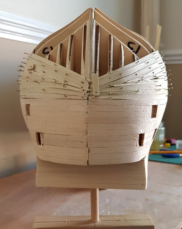

#129 Posted : 19 June 2019 11:34:01
Joined: 29/12/2018
Posts: 223
Points: 671
Location: Lancashire
Since my last post ive only managed 30mins here and there and ive been learning bits at a time..
All the planks in the photo are only pinned in place as you may well suss out..
This is if i see something not right i can have another go....
Ant62 attached the following image(s):

Erik A
#130 Posted : 19 June 2019 23:20:13
Joined: 06/07/2018
Posts: 106
Points: 308
Location: New Zealand
looking good.
i had mine with the fairing all done and ready to plank then decided to infill with balsa at the bow and the first couple of side frames bow and stern. balsa is easy to sand by hand and doesnt take long at all.

#135 Posted : 21 June 2019 07:28:57
Hi Ant62
Looking at your build it looks like what is called crowding thats when the planks are to thin at the end resulting in splinter like plank, you may well have to put a few drop planks to reduce the number of planks running forward.
Trev.

Ant62
#137 Posted : 22 June 2019 08:59:17
Joined: 29/12/2018
Posts: 223
Points: 671
tf64 wrote:
Hi Ant62
Trev.
I agree....
I did think it was a struggle though....
At least they are not fixed perminently..

z8000783
#138 Posted : 22 June 2019 10:41:31
Groups: Unapproved
Joined: 24/05/2010
Posts: 1,761
Points: 5,351
Location: London & Greece
Have a look at Stage 32 for making dropper planks.

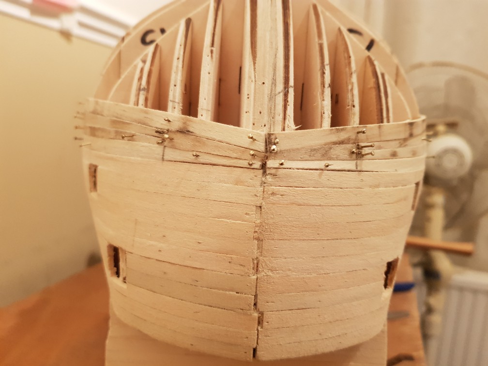

#139 Posted : 15 November 2019 14:29:29
Joined: 29/12/2018
Posts: 223
Points: 671
Hi all...
Back on the Victory build today...
I had to suspend the subscription due to a temp move while the repairs where carried out on our property and various other issues and hopefully back home by christmas so i can get the boxes back to being delivered but i wont hold my breath...
Anyway im back onto the the planking of the bow with a clear head and boy it does you good to leave the build alone and have clearer thoughts.
So ive managed to bend two bow planks and also do the drop planks etc....
Pics soon..

Ant62
#140 Posted : 15 November 2019 20:40:08
Joined: 29/12/2018
Posts: 223
Points: 671
Latest picture of todays few hrs on the bow..
