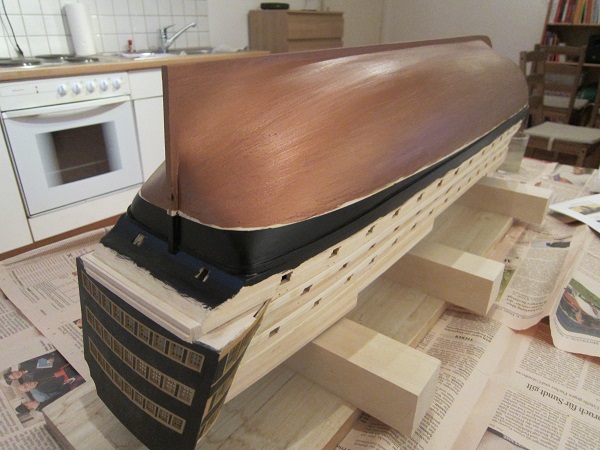

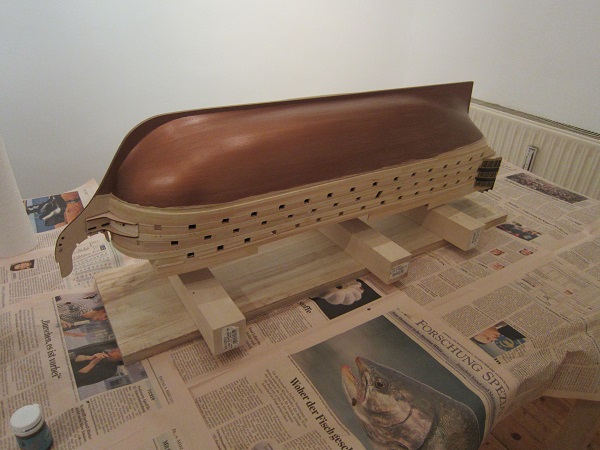

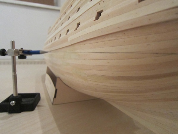

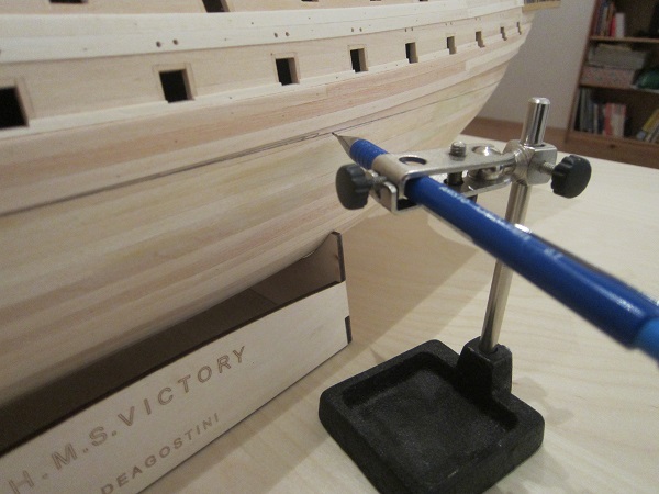

Here`s a little update:
Finally i started my first attempts to draw a water-line, which turned out easier than i had feared:
Next steps will be painting the lower hull - and then the coming half of a year is reserved for copper tiling :)

Job well done, Walter. Good clean lines, she looks awesome. Keep it up
Rgds, Hans

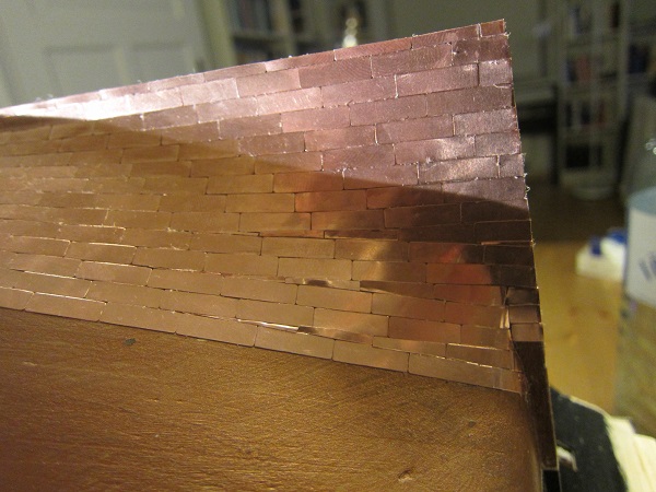

#128 Posted : 17 March 2013 18:26:18

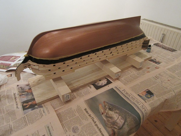

Hi everyone,
a little update:
First i gave the hull below the waterline two coats of copper-paint, so that later little gaps between the tiles would not be obvious.
The waterline was taped and the above hull painted black.
#129 Posted : 17 March 2013 19:10:46
Looks a nice neat job
J
#130 Posted : 17 March 2013 19:36:30
Great start to the tiling Walter.... think you will be seeing tiles in your sleep...LOL LOL

#131 Posted : 17 March 2013 20:34:33
Rank: Amateur Level 1
Joined: 19/03/2012
Posts: 34
Points: 95
Location: Manchester
Hi Walter great start on the coppering,just a word of warning on the last file on the how to copper tile the hull part 5,6,7 it says run a row of tiles along the water line I think this is wrong just run them naturally to the water line it will look 10 times better.I don't know why they say do that because it is a waste of time and effect especially around the stern area doing it the natural way is exactly the same but without the line off tiles. Another tip is when cutting the tiles with a craft knife do it on a hard surface not the cutting mat I found out then tend to bend on the mat and hard to cut very small pieces I went through a lot of blades too.looking Forward to your progress Ben.
#132 Posted : 18 March 2013 08:04:49
Thanks Jase and Alan!
Thanks for your warnings, Ben.
I won`t be doing the line along the water-line - i have McGowans book with the coppering-plan and will try to follow that plan as far as possible.
I think they do that water-line because maybe its easier to achieve a clear straight line that way.
The cutting of the tiles really is the hardest part of the job. A hard surface is very important.
One other piece of advice for those who didn`t start the tiling yet:
When cutting the tiles you should try and cut the whole lenght of the tile at once.
With the first few tiles i always cutted half of the lenght and then the other half. This led to a strong deformation of the tiles.
(i hope my english is understandable Bored )
#133 Posted : 18 March 2013 08:11:13
I found good sharp scissors was the most efficient way of cutting tiles, they do curl a bit but you simply flatten them out again - easy. if you want to ensure a straight line and not use the tiles to achieve it try nailing a baton across the line so you can but your tiles up to it - remove the baton when done.
#134 Posted : 18 March 2013 11:20:26
Thanks jase,
i haven`t tried scissors till now - didn`t even think of it!! Embarassing!
I will try it as soon as i get home - will make the cutting a lot easier.
Also the idea with the baton is some good advice!
I´m learning new tricks through this forum every day.
Thank you again,

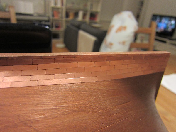

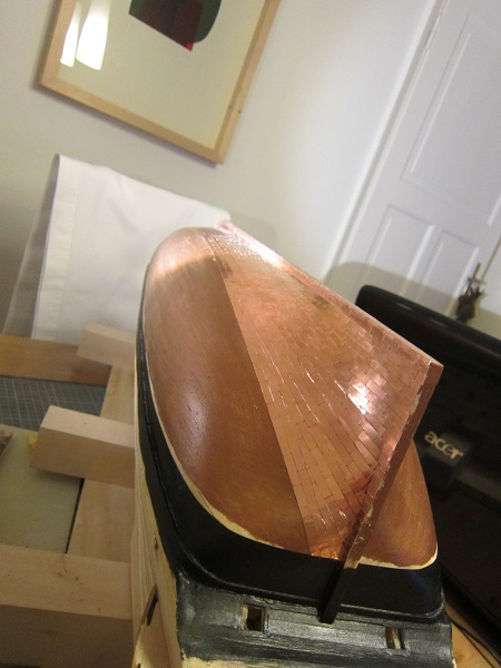

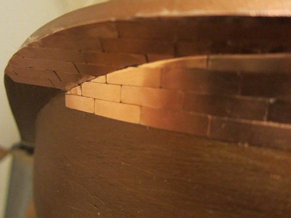

#138 Posted : 29 March 2013 10:54:20
Hi guys,
here`s a little easter update of my tiling so far.
It`s really time consuming and applying the stealers at the stern is really a pain in the ass.
But when you look at the result, it`s worth the effort.
It´s such an upgrade for the ship!
Happy Easter to all of you!
Greetings, Walter
#139 Posted : 29 March 2013 11:01:06
Doing a better job than I didBigGrin looks fantasticLove

#140 Posted : 30 March 2013 15:39:41
Joined: 04/05/2012
Posts: 362
Points: 1,089
That looks great Walter ThumpUp
And you are very fast, I needed 3 Months to get that far Blushing
Kind regards
Peter BigGrin
