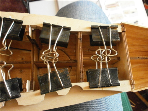

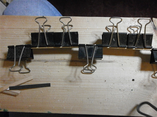

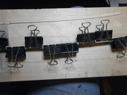

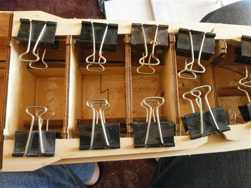

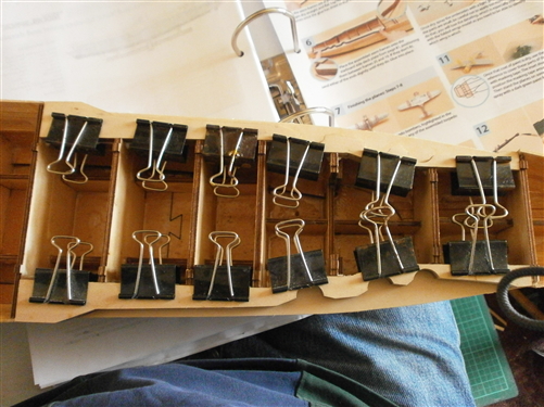

BigGrin After the glue had dried i lightly sanded the parts and glued them in placeCool

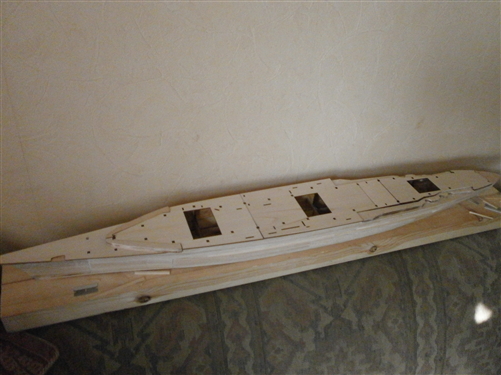

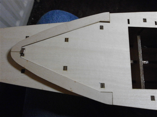

BigGrin Hi All

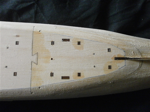

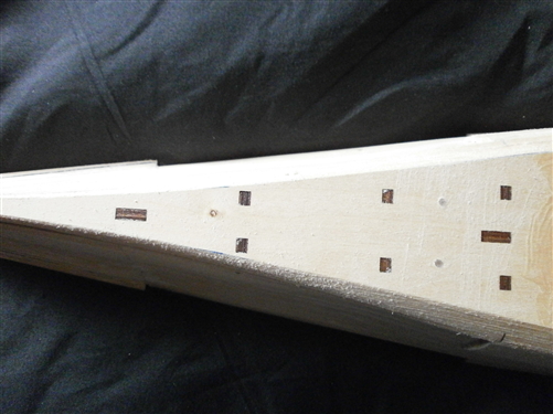

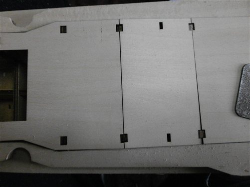

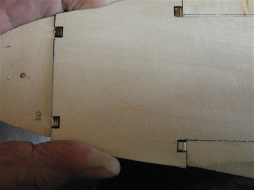

i have now compleated the dry fitting of this months deck area,s,some reshaping was needed at the bow section but after triming the tabs they both fitted quite well, just a word of warning here take it easy on the tabs as they cut off compleatly if your not carefull[ i lost 1 tabBlink ].As always all comments are welcome

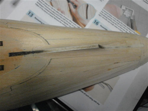

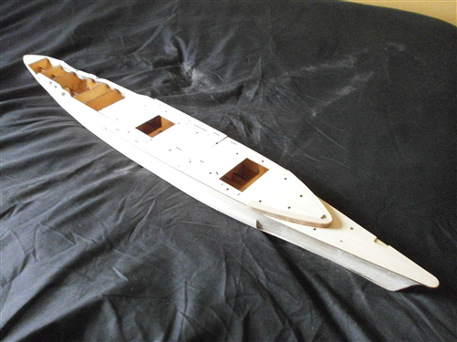

BigGrin Hi All

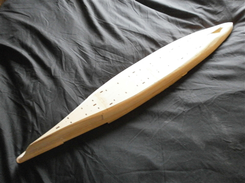

Measured and rebated the lower hull as per the instructions but only to a rough finish as per Mr T's recomendations in the official build,just the fillet to add to the stern and a launch to paint left now.As always all comments are welcome.

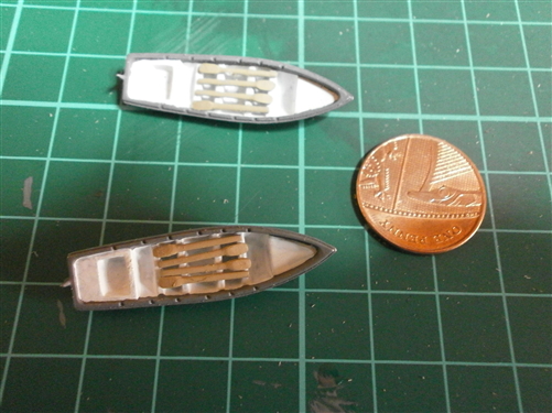

finished painting the 3rd 11 meter launch[ only 2 are shown here]just the hull fillets to add nowCool

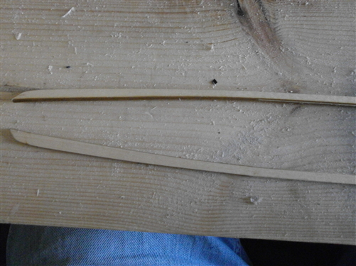

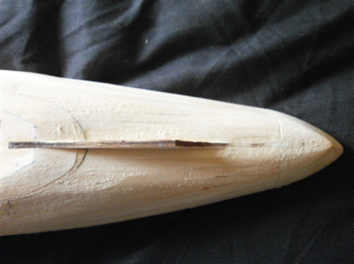

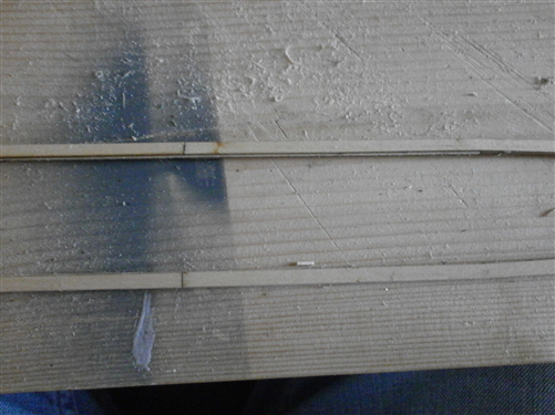

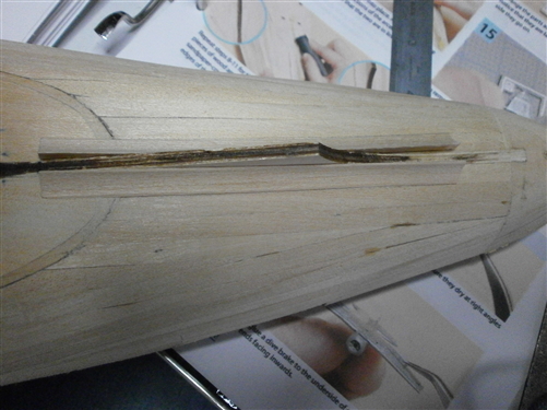

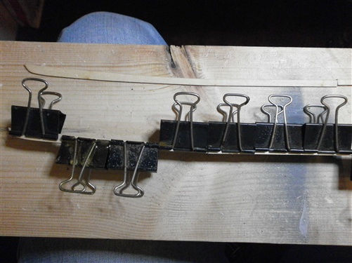

BigGrin hi all

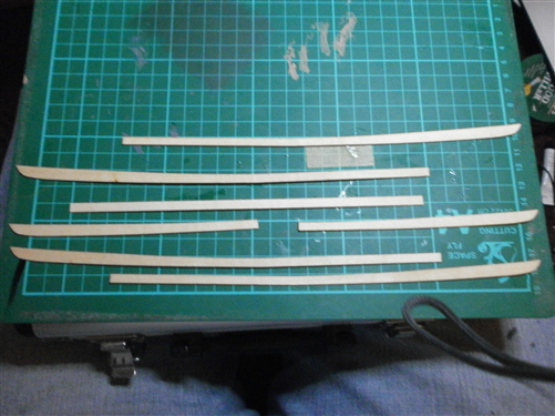

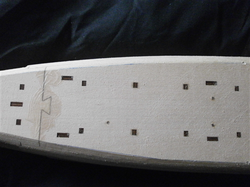

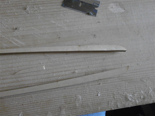

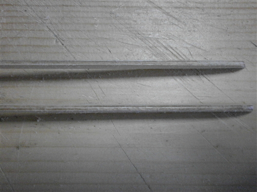

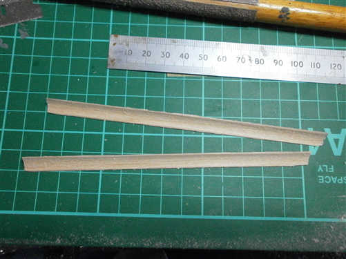

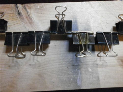

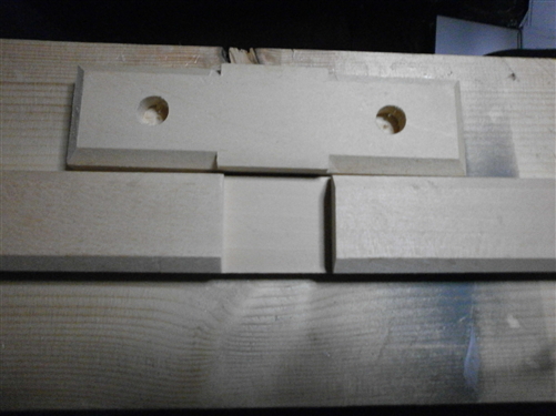

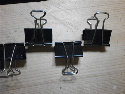

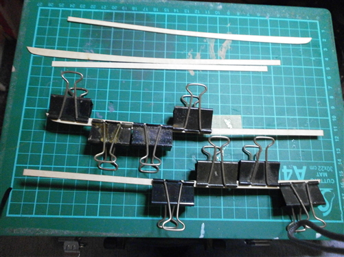

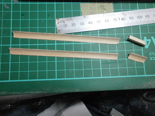

finished the stern fillets, heres how i did it.1st i cut the wood into 2 halves then marked out and cut the centre section as per the instructions,after this i sanded the bevel into the two parts and then cut them to the correct length.After glueing in place i then sanded them to profile the results are below.Just the burrs on the 2 aircraft to remove this month now.As ussual all comments are welcome

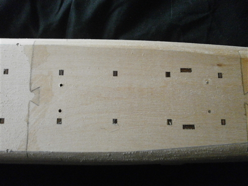

BigGrin Hi All

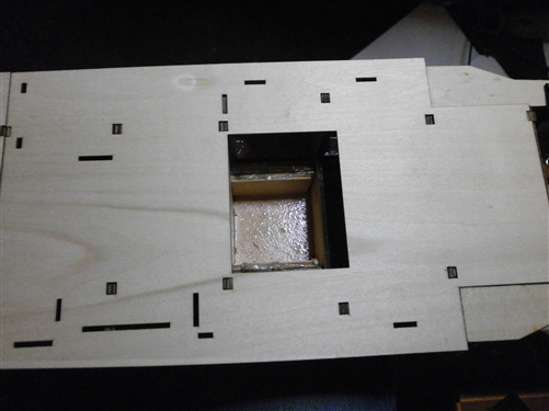

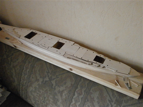

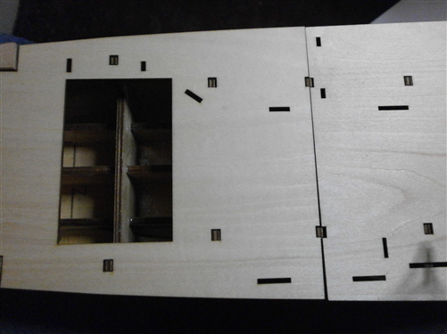

Pack 8 has arived,so i proceded to dry fit the remaining decks supplied.As ussual all comments are welcome

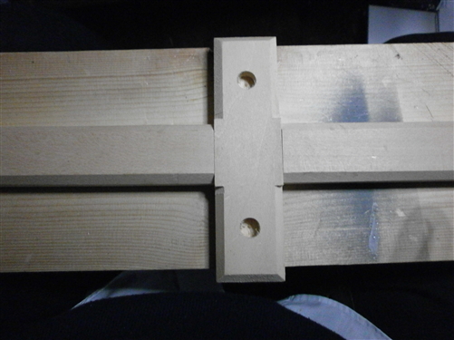

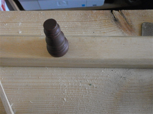

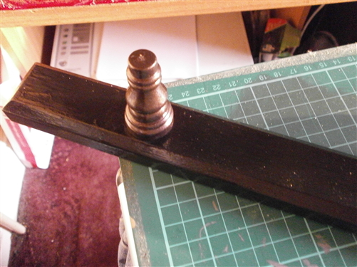

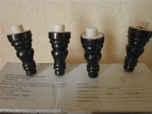

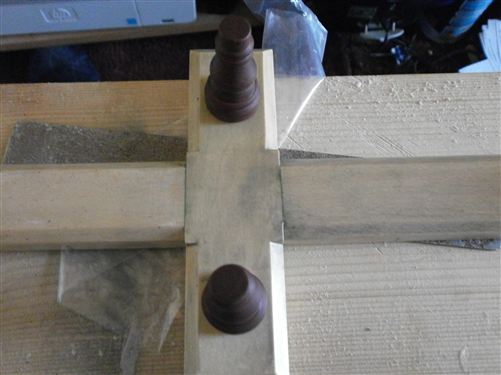

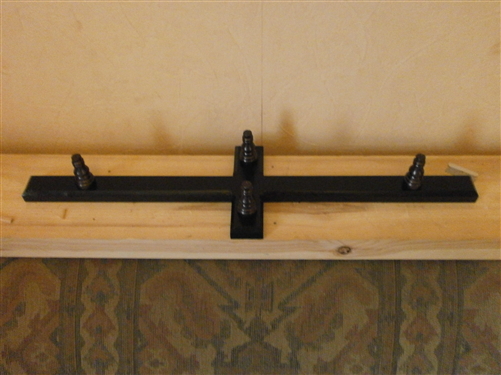

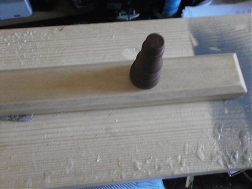

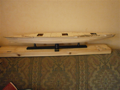

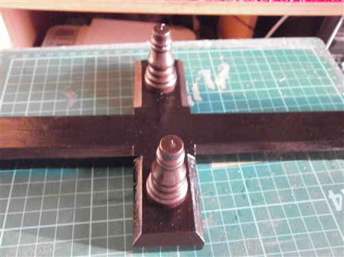

BigGrin Ok on with the build the stand is next i deviated a little on the build by not glueing the centre cross member until i had joined the longer lengths together then glued this in position after i had sanded it back,this makes it easyer to sand in my view.The next part i changed was to add some pins/wire to the pedistal tops to make the joining of the hull/stand easyer plus having somthing to fix it on to the hull.My last change was the pedistal colour it recomends gold in the build but personaly i think gold looks tacky unles done really well so i opted to use bronze ,i also panted the rest of the stand gloss black and if i say so my self im quite pleased with the resultsbut everyone to there own as they say.As ussual all comments are welcome

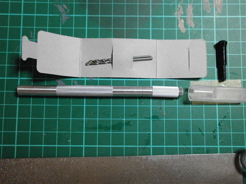

BigGrin Hi All just thought i would show a pic of the tool included with pack 8,its a nifty little hand drill with 2 drills and 2 spigots

nice one ar,do like the bronze classyLove
#138 Posted : 24 March 2012 21:38:02
Hi Andy first class job as usualBigGrin Regards Mike

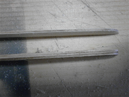

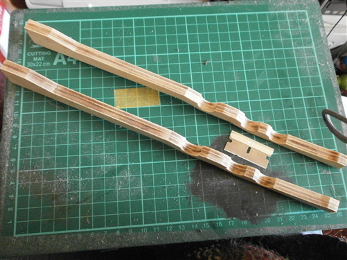

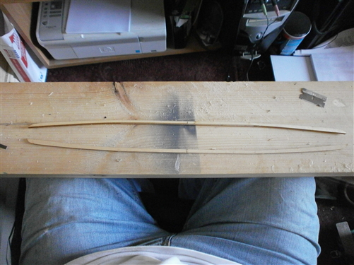

On with the build,next its the assemble of the bilge keel components and the sanding to profile as per the instructions.Just a word of warning here when i came to the sanding part i discovered that some of the ply laminations on the wood supplied wernt joined together properly so extra glueing was needed here,might just be a 1 off but keep an eye on yours.All in all a simple job to profile back just watch that you keep to the profile specified.I will only be dry fitting the bilge keels for now as im waiting till all the hull armour components are fitted before i add these.As ussual all comments are welcome
