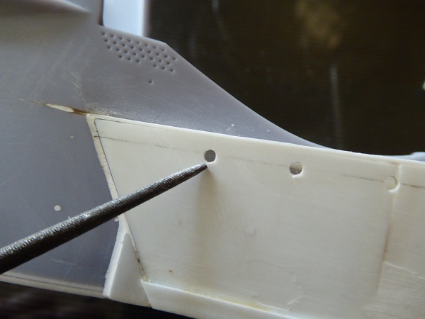

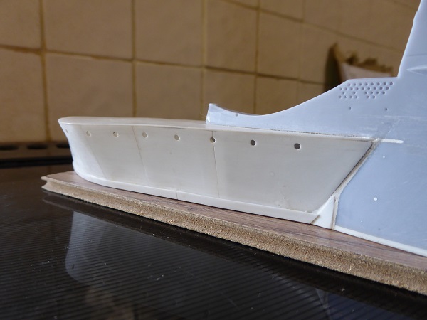

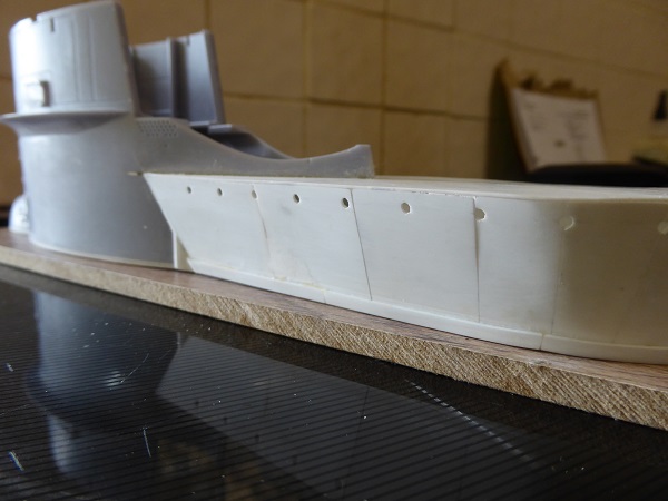

I then proceeded to 'dress' all of the holes with a needle file to give them a slight oval profile in keeping with my reference photos of U995 and U230.
#122 Posted : 13 September 2018 08:21:59
Free flood holes completed port side.
#123 Posted : 13 September 2018 08:22:40
Starboard side completed.

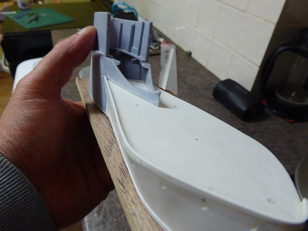

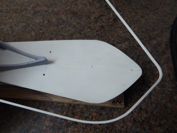

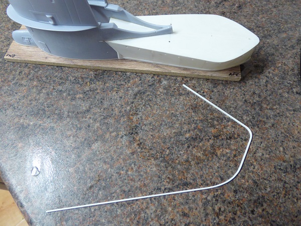

The next phase saw the addition of edging strip to the lower deck. This edging strip is where the guard rails will be fixed to at a later date. I chose 1.0mm x 1.5mm plastic strip for this job.
I couldn't make one strip to fit all the way round, so split it into two parts.
The attached photo shows the first section being bent by hand to suit the profile of the lower deck, I didn't want to just glue it without some bending as it would prove tricky to locate and have internal stresses.
#125 Posted : 13 September 2018 08:30:00
Another photo of the first section being bent to suit.

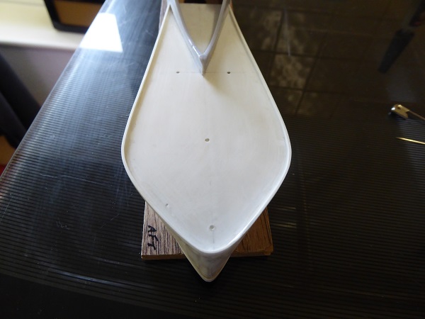

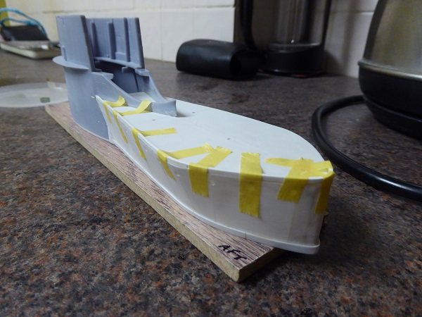

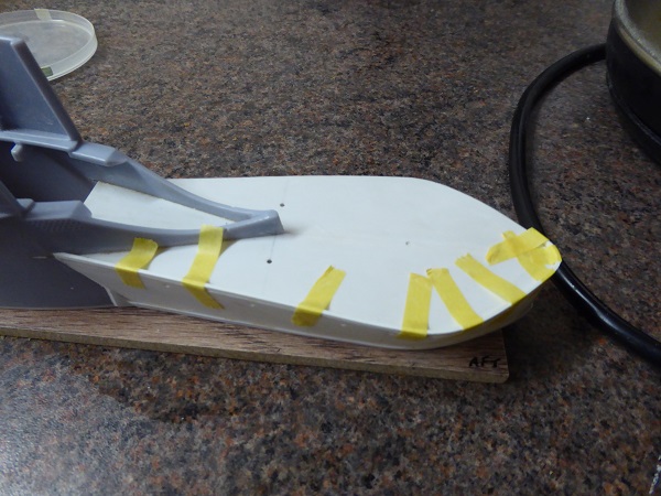

#126 Posted : 13 September 2018 08:31:05
The first section of edging strip, glued and taped in place.

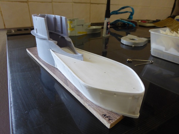

#127 Posted : 13 September 2018 08:31:38
From above.

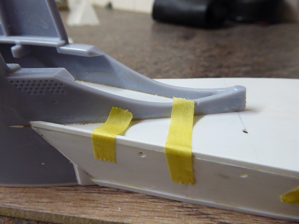

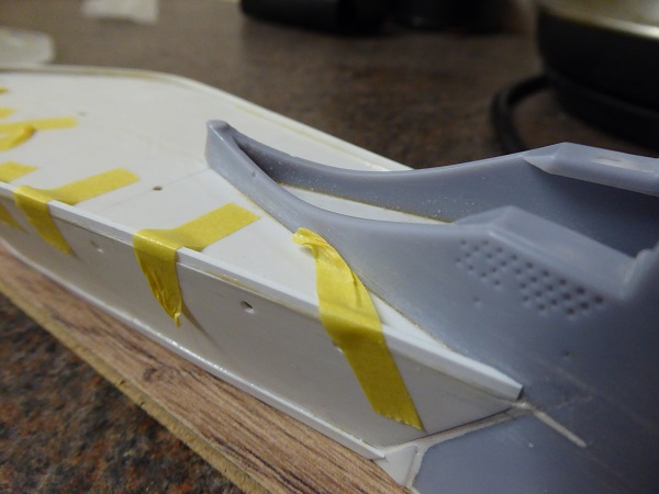

#128 Posted : 13 September 2018 08:32:34
A close up showing the edging strip taped in place while the glue sets.

#130 Posted : 13 September 2018 08:34:13
I then followed the same procedure for the starboard side. The attached photo shows the strip glued and taped in place.
#131 Posted : 13 September 2018 08:35:31
A close up photo of the starboard side.
#132 Posted : 13 September 2018 08:36:21
Edging strip complete.

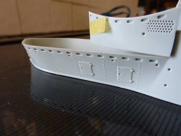

The next step in adding modifications was the inclusion of lockers, two each side, on the lower deck.
The attached photo shows a close up of the lockers on the 1/72 scale donor model which I wanted to replicate.
#135 Posted : 13 September 2018 08:41:32

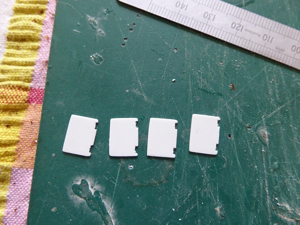

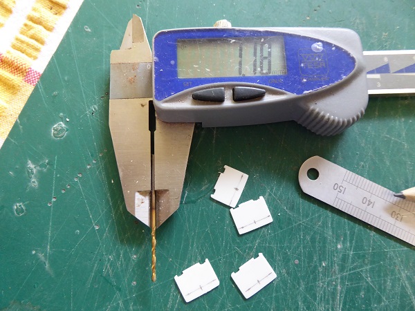

After measuring the donor models lockers, I scaled up the dimensions and cut out four pieces to simulate the lockers from 0.5mm thick plastic sheet, measuring 9mm x 12mm.
#136 Posted : 13 September 2018 08:42:43
I then carefully filed the cut outs for the hinges.

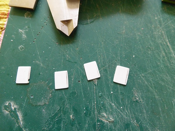

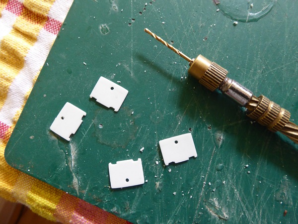

#137 Posted : 13 September 2018 08:45:15
I then marked out the location for locks.
#138 Posted : 13 September 2018 08:46:08
I drilled these out with a 1.2mm diameter drill.
#139 Posted : 13 September 2018 08:47:56

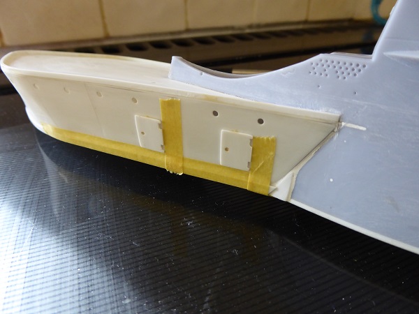

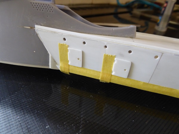

Using tape as a marker I proceeded to glue the lockers in their correct location.
#140 Posted : 13 September 2018 08:49:06
Port side showing tape in place and lockers located.
