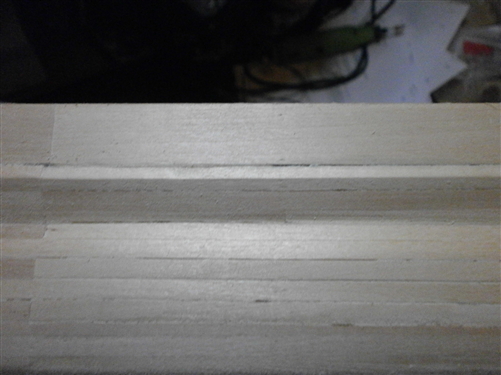

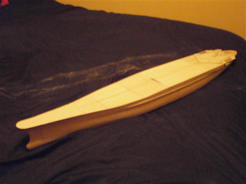

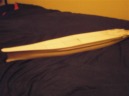

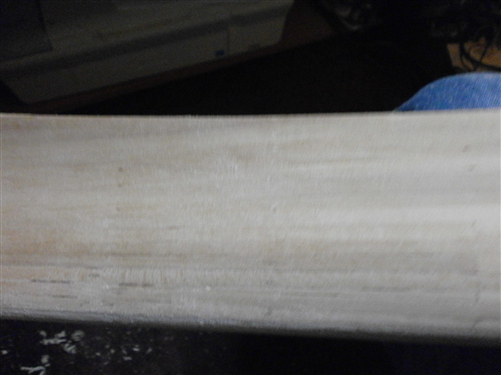

BigGrin Hi All

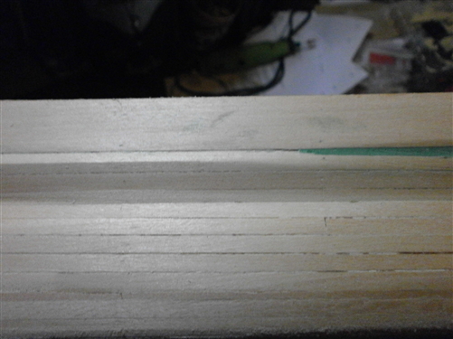

the hull is now fully profiled using the templates suplied [ even though 2 are missing from the download,luckily these are at the stern]now all that remains to be done is the final filling and sanding before i decide wether or not to epoxy the hull on the outside to get a more steel like finish.But before that happens i need to fit the stern section profiles around the rudders and add some enhancements around the propeler hull area i have in mind

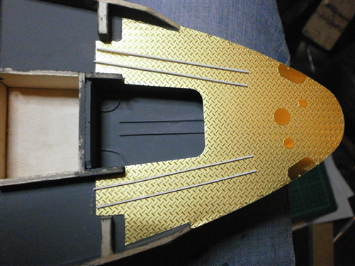

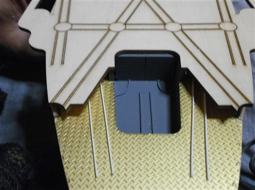

#126 Posted : 17 March 2012 23:13:54

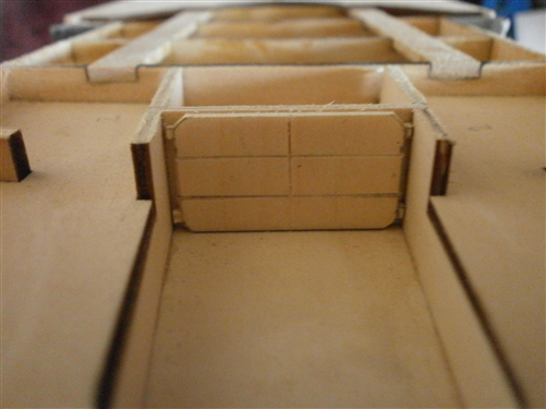

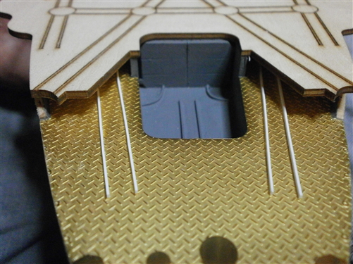

BigGrin Hi All

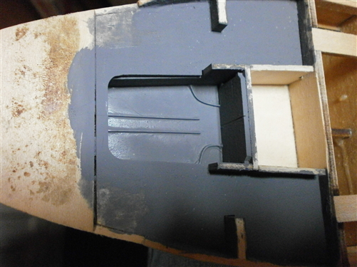

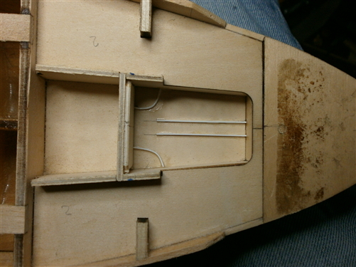

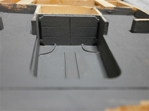

progress update iv recieved the replacment decking part now so on with the build.Added the rails in the hangar deck as Mr T has but also added the hanger doors as an addition.The wire that will be provided for the rails i will not be using as iv decided to use plastic strip to replicate this item on the build.More pics to follow shortly of this months build as usual all coments are welcome

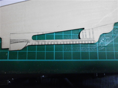

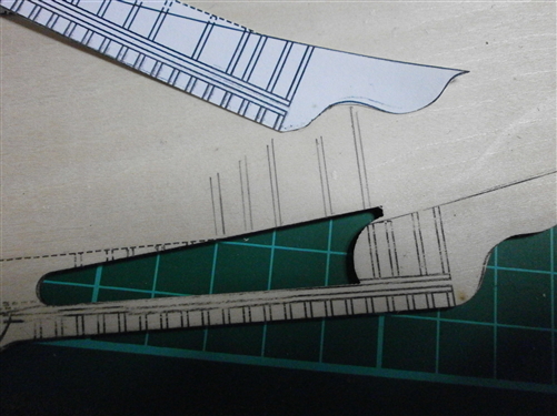

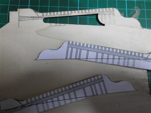

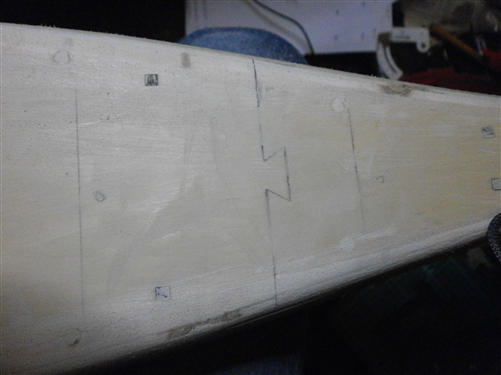

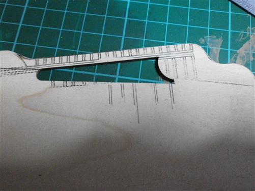

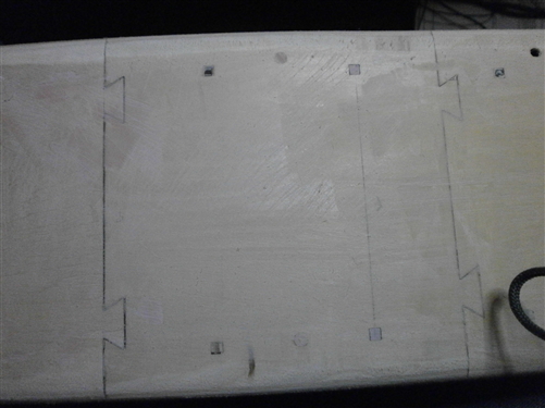

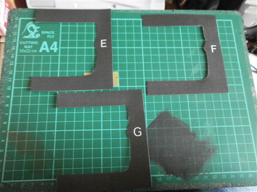

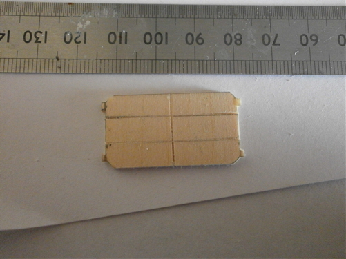

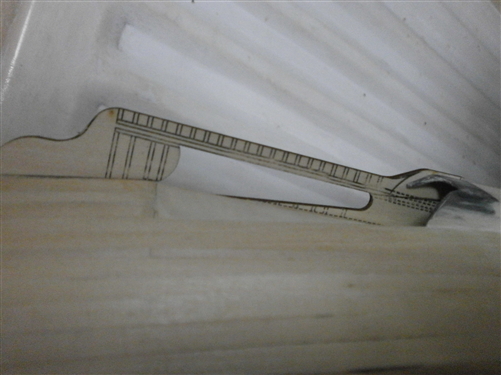

BigGrin More pics on progress, i used the old hot iron trick to transfere the stencil image onto the underside of the deck.If your not familiar with doing this its quite easy, borrow the wifes iron,set it to highest heat [ get her to go shoping 1stLaugh ] cut out the template line it up on the deck[correct side of course]then run the iron over the template the heat should then transfer the image.I had to do a little extra marking as the deck gratings cut out hinders /prevents transfer there,pics will make this apparent 'note' this method will work on 80% of plans so with the other 20% its the carbon copy paper transfer job.As usual all comments are welcome

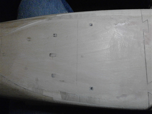

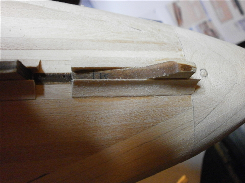

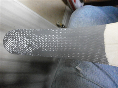

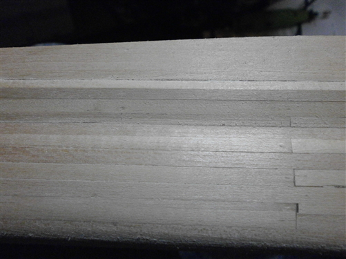

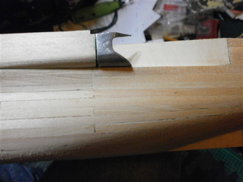

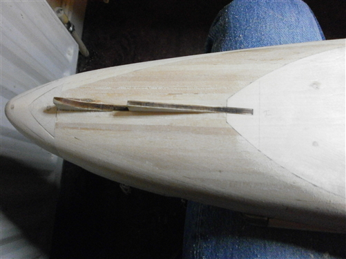

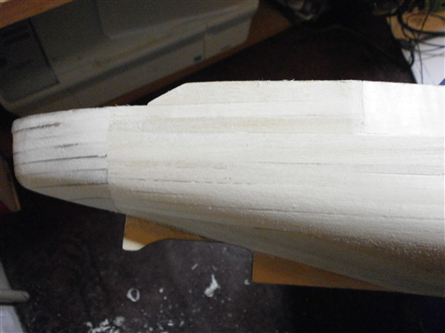

BigGrin Bow deck plate now added,small amount of sanding and filling needed on the hull but the fit was almost perfect,the paint looks shiny because it was still wet when the pic was took LOL

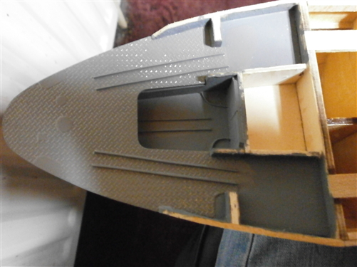

#137 Posted : 18 March 2012 14:58:09
love the silver socks Cool
#138 Posted : 18 March 2012 20:20:18
BigGrin Silver socks? Karl am i loseing the plot hereConfused
#139 Posted : 18 March 2012 20:29:44

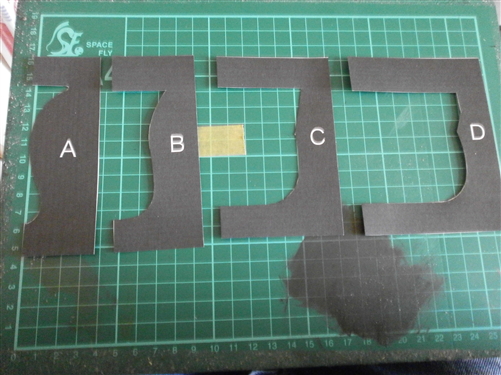

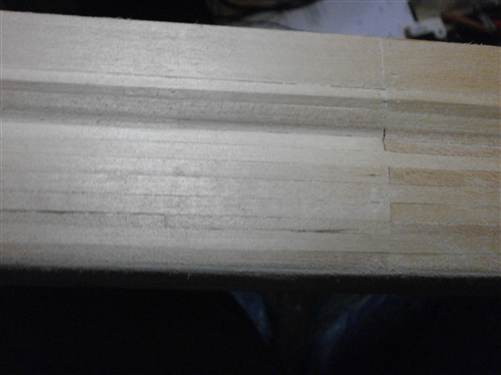

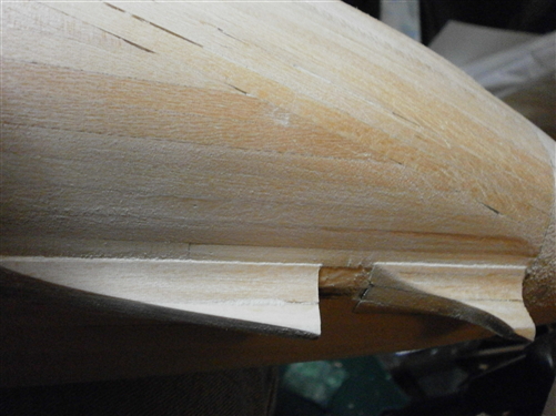

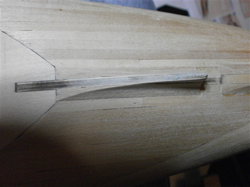

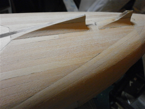

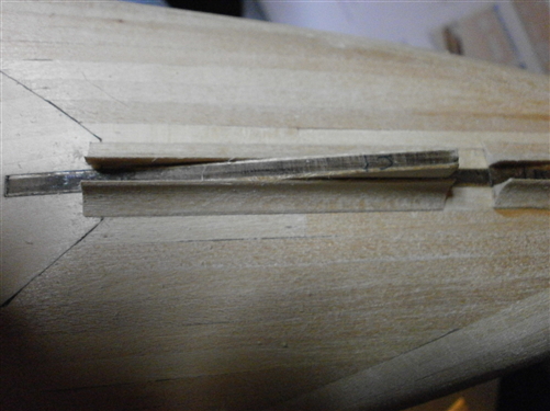

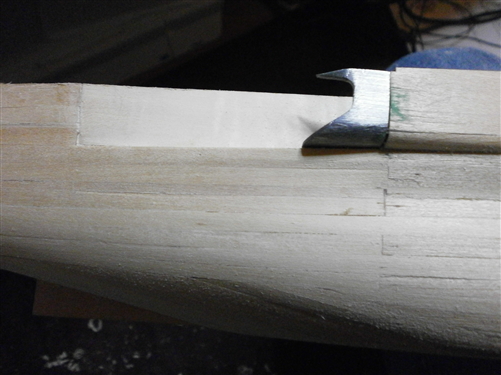

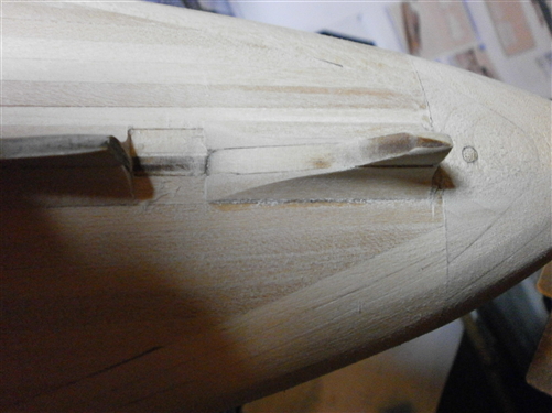

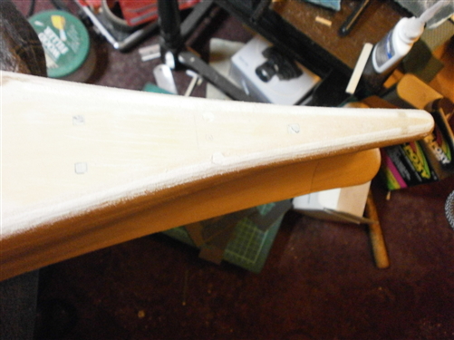

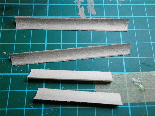

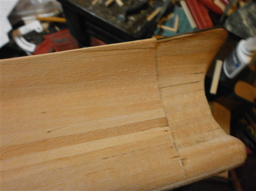

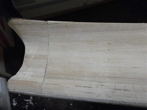

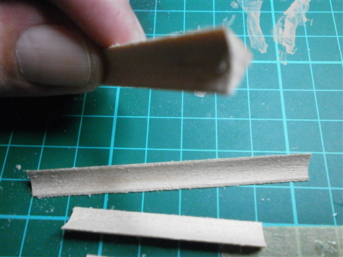

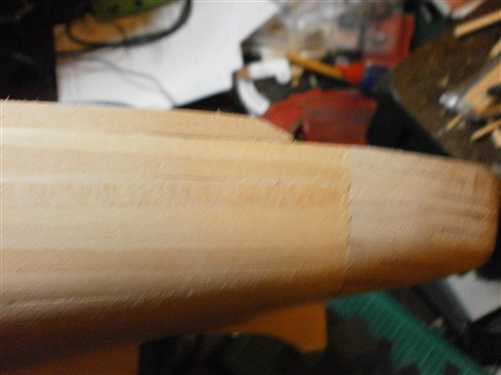

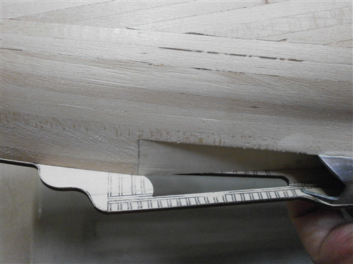

BigGrin A few more pics this time of the stern rudder fairings,i found the wood provided was of an extreamly hard grain/density but managed to compleat the rounding of the section as per instructions,Getting close to preparing the hull for painting now just need to add my deck edge enhancement to the edge of the planked area and if your wondering the decking will not be started untill all the hull is painted and assotiated bits added to the main hull.As ussual all comments are welcome
#140 Posted : 18 March 2012 23:03:43
hi ar.the last pic of that deck.looks like you have crossed your legs and are wearing silver socksFlapper
