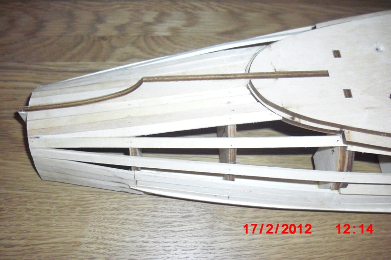

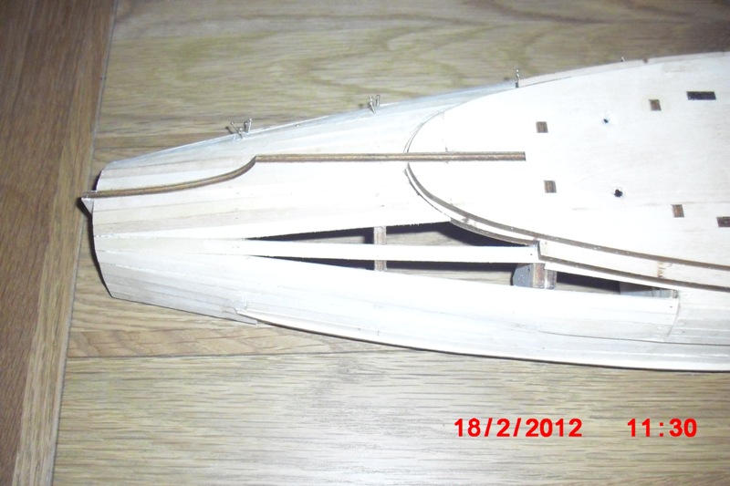

ISSUES 5 - 6 parts 24 to 28
Hi team I have now removed the Akagi from its dry dock board, she is staight with no twists or bunkeringBigGrin
I have started to plank the stern, working on the port side then the starboard side,keeping it nice and even,so that the hull will not distort, plus I have finished all the planking on the sidesBigGrin here are the photos:-BigGrin Regards Mike

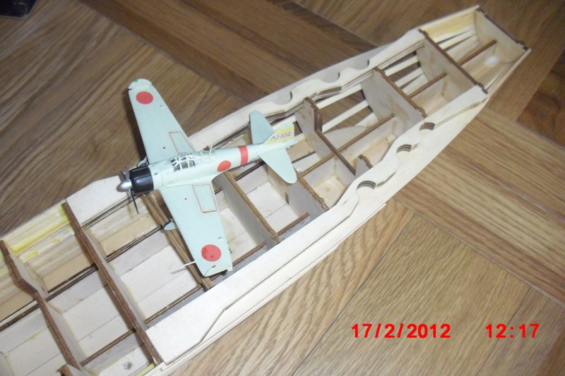

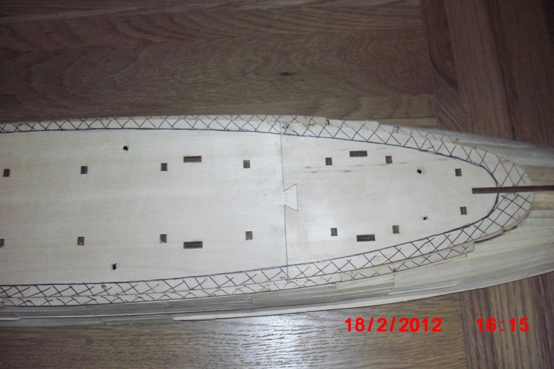

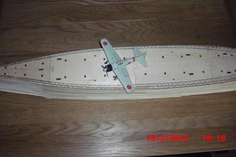

#123 Posted : 17 February 2012 14:00:10
ISSUES 5 -6 parts 24 to 28
Here is how she looks at the stern at the moment, could not resist including the Zero.BigGrin Questions and comments welcomeBigGrin Regards MikeBigGrin Cool

Looking good Mike, either the aircraft is growing or the ship is LOL

Cheers TomBigGrin You are right it is a bit off scaleBigGrin Regards MikeCool

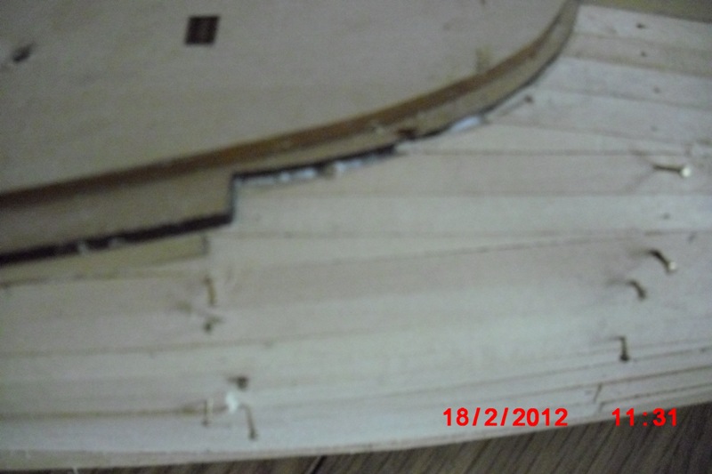

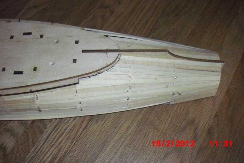

ISSUE 5 - 6 PARTS 24 to 28
Hi Team just a couple of photos of my progress planking the Hull at the stern, one side completed one to go.
The last photo shows the wedges I used, which came from trimming the planks, The angles were the same so I did not need to make new onesBigGrin

#131 Posted : 18 February 2012 13:18:28
You can actualy see the wedges clearer in the second photo,sorry the third photo is blurredBlink Mike

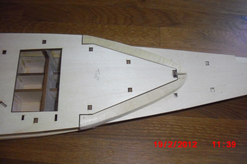

Hi Team I decided to focus my attentions on the bow decking first, I can not stress enough to pay attention to detail, do not rush the build it will pay you dividends if you do.BigGrin
After I sanded and trimmed the parts this is what they looked like:-

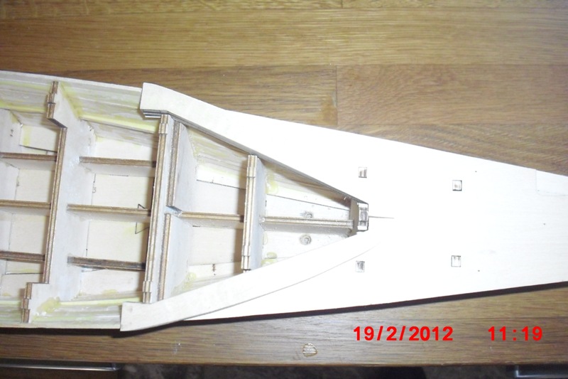

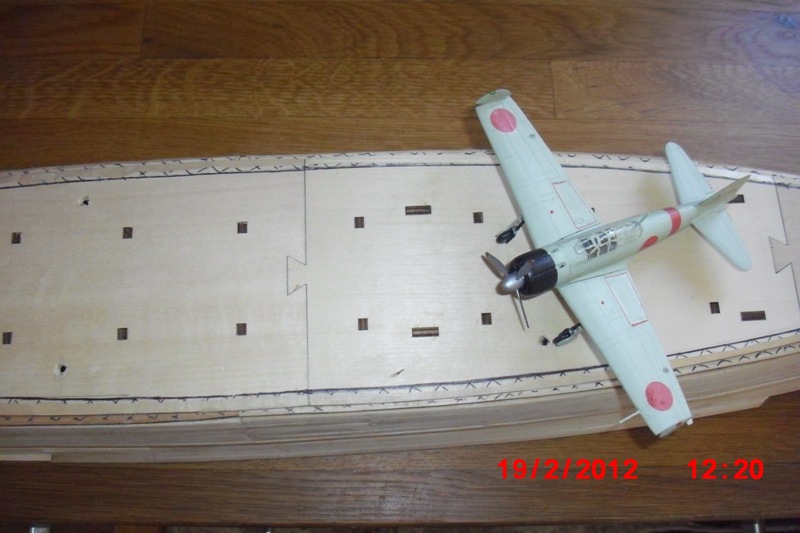

#138 Posted : 20 February 2012 18:34:33
ISSUE 5 - 6 PARTS 25 to 28
After I had finished I found the deck did not fit snuggly, it was a bit big for the two deck gunnels, I am not going to make any ajustments untill I have all the decks trimmed and fitted, you will see the gap at the front of the two deck side pieces:-
#139 Posted : 20 February 2012 18:37:46

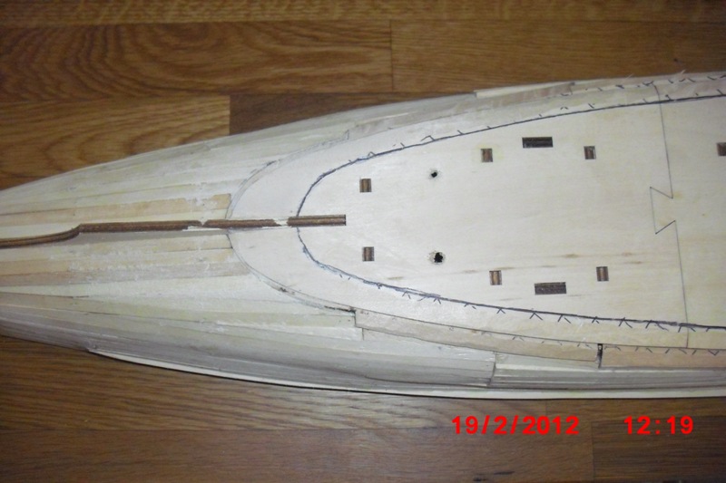

The second thing I did was to markout the area to be trimmed on the side of the Hull base:-

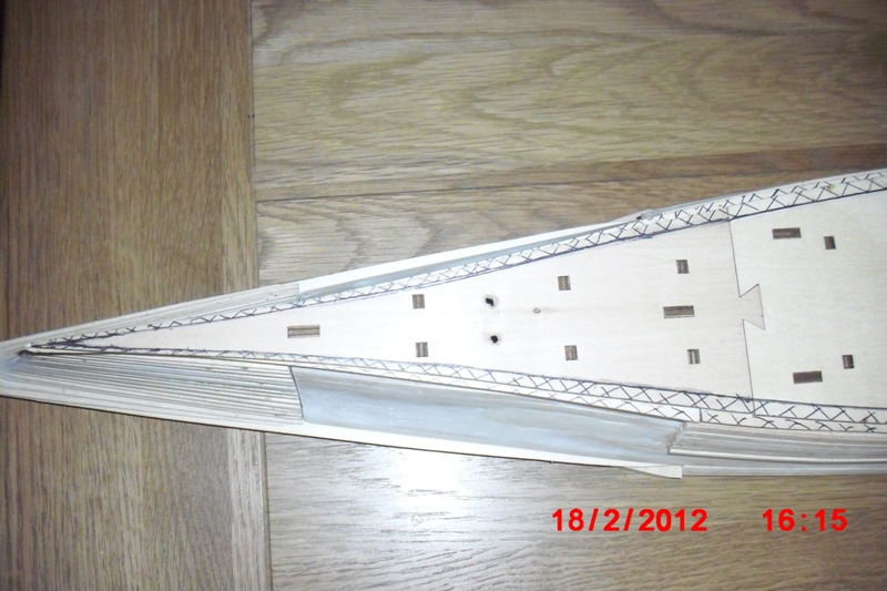

#140 Posted : 20 February 2012 18:43:51
I then used a craft knife and trimmed off all excess wood, I will only sand and shape the Hull around the stern keel leaving all the forming and shapping of the Hull later on as Mr T advises in the official build:-
