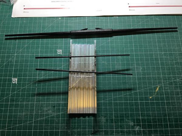

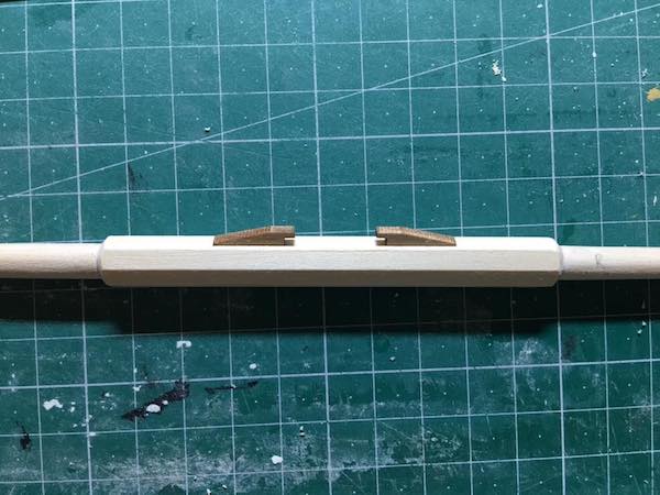

Octagonal section on main yard made and sanded smooth.
Slings fitted.

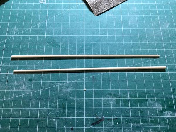

Studdingsail booms tapered.
All three parts painted black.
Hint for the booms.

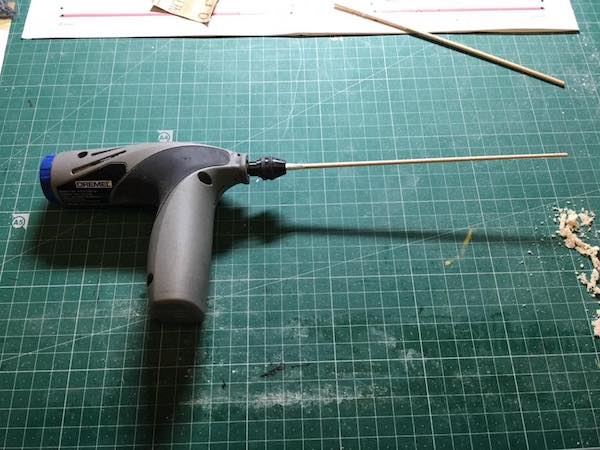

I started to taper the booms on the traditional way, spinning the dowel between my fingers while sanding the other end, but within 3 minutes my spinning fingers had cramp and I barely managed to sand any material off.... so I though let's do it on the smart way instead of the hard way... BigGrin
I wrapped the end on the dowel in a piece of paper to avoid any markings and fixed it into my Dremel. Then wrapped the sandpaper around the dowel and turned the Dremel on. IMPORTANT... ensure you wrap the sandpaper around it and hold the dowel on the far end loosely before you turn it on... otherwise the dowel will act as a whip and likely to snap.
With this method I had both booms tapered within 10 minutes with a very even and round taper.

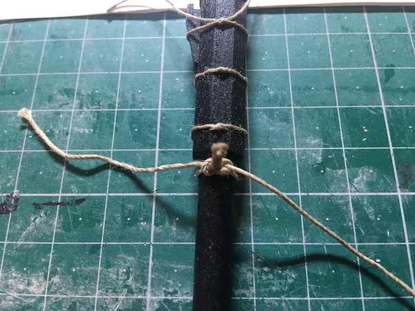

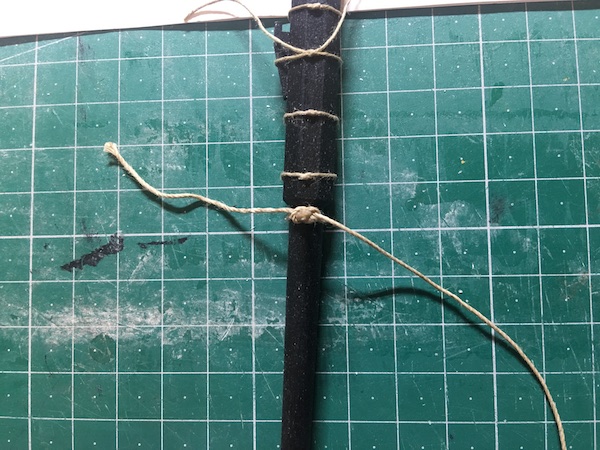

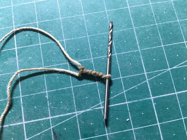

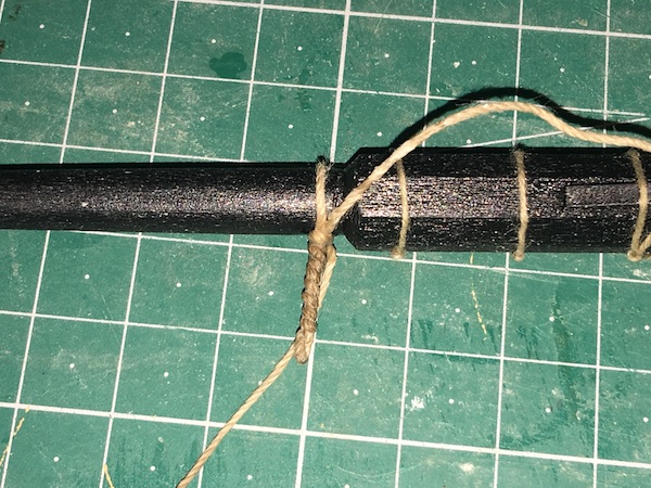

I started to dressing the main yard, and I've seen from other comments here that the footrope supports are made from rope on the real ship and not from brass/metal as it's in the kit.
Hence I decided to try something alternative.
First I took a 1mm natural thread (not included in the kit) and soaked a 8-10mm long piece with superglue to make it stiff and make the next step easier.
Then I took one end of the thread and looped around a 1.5mm drill bit and working from the loop I wrapped it around the stiff part.
After I reached the desired 10mm length I made a half-hitch and soaked the whole section (incl. the loop around the drill bit) with superglue.
Once the glue dried I placed it around the yard and fixed with a reef knot, in a way, that the stiff support is coming through the middle of the knot. This makes it standing vertical.
I think the result is pretty good and because I go for the painted option it won't be disturbing that the stiff part of the thread became a bit darker due to the superglue, compared to the other part of the support (loop around the yard). I'll paint the whole support black.
See pictures below about the process and the result, I hope you find this hint useful.

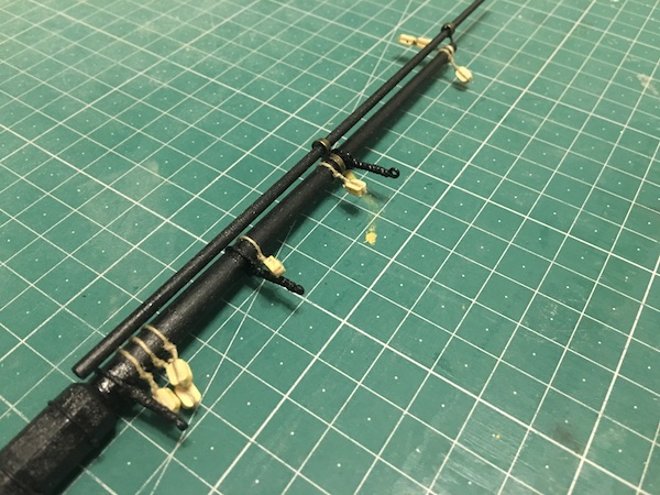

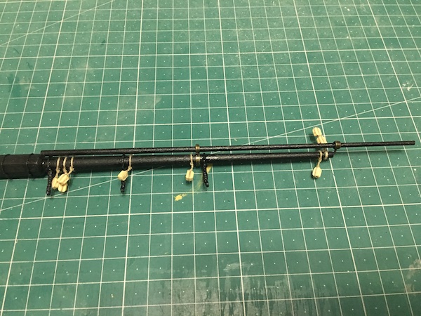

Today's work:
All six footrope supports made as I described in my previous post then painted black, together with the bindings.
Then the yard fully dressed with all the blocks required for the running rigging. Finally the booms glued in place.
At the moment I'm a little bit concerned as the magazine requested to taper the booms from 3mm to 2mm however the metal rings has a bigger diameter (approx 0.5mm bigger) which makes the booms quite loose. Anyhow, I fixed them in place with super glue as instructed, hopefully it will be strong enough to keep it in place. I hope it won't be stressed too much after all the rigging and sails fitted.

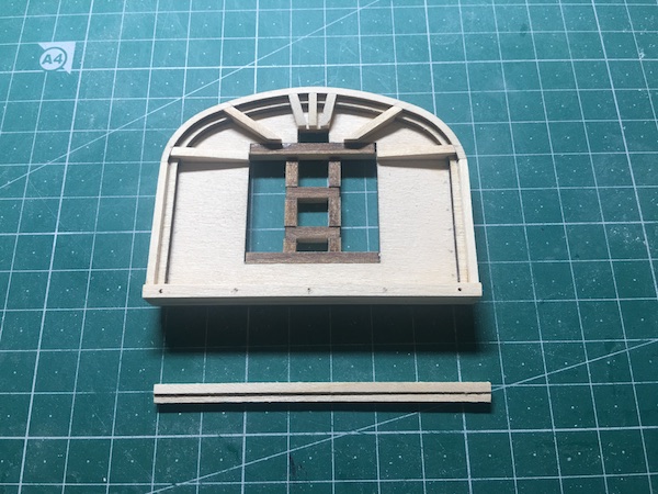

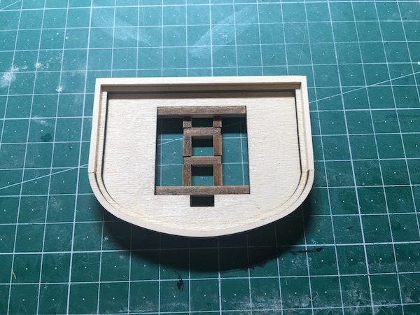

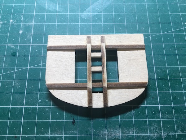

Relatively easy and quick job today, started to assemble the foremast top.
Two layers of surrounds fitted on top, cross trees, tressle trees and spacers fitted on bottom, then edges sanded smooth.
Laszlo
Happy building!

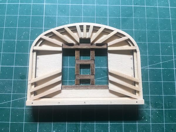

Handrail top and bottom prepared, few ribs added.
I found it easier if I add couple of key ribs (centre in the middle, two "horizontal' on the sides) first and then fill the spaces equally in between, rather than go around and fit them always next to each other. It makes me easier to make the ribs fully symmetric and better/equal spacing between the ribs.

Today I added further ribs to the fore mast top.
Laszlo

Today I finished to add all the ribs to fore mast top.
Laszlo
