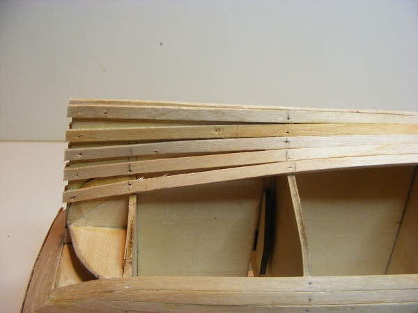

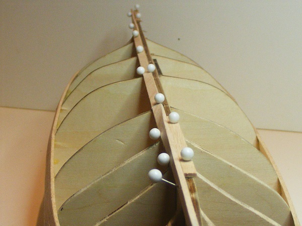

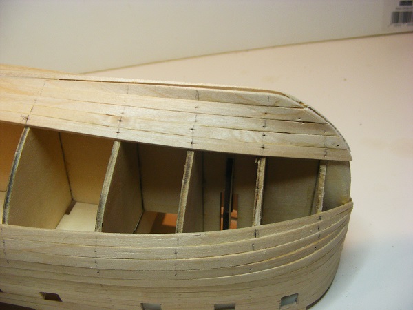

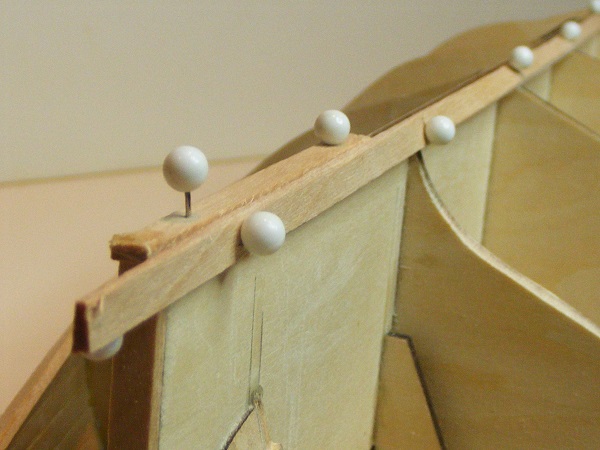

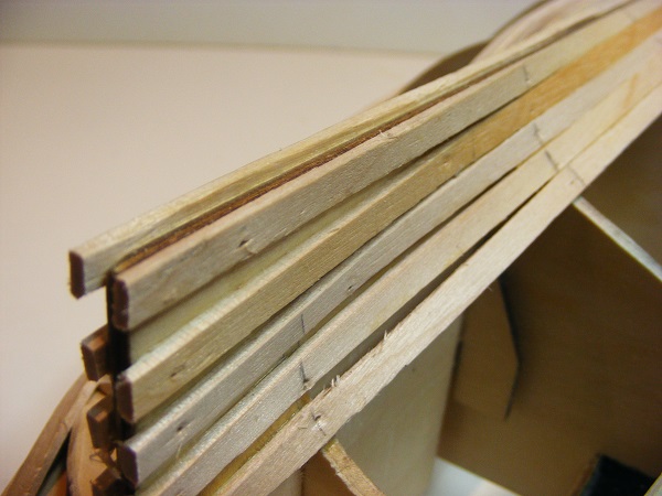

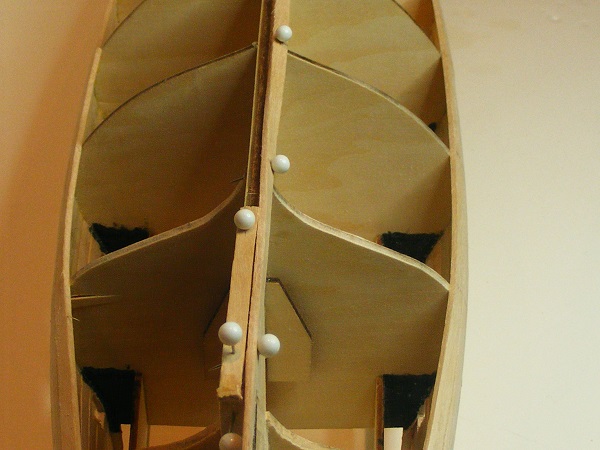

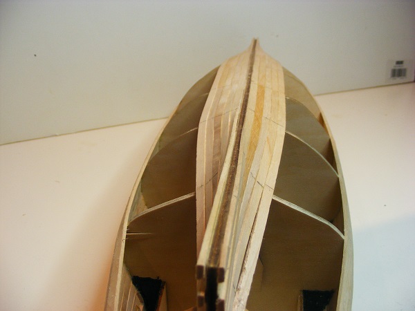

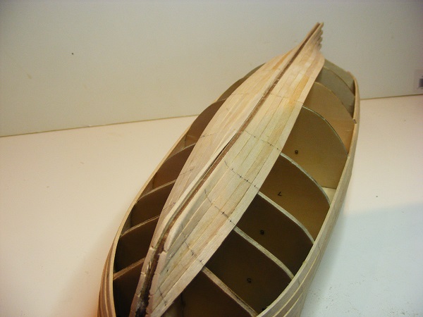

The next part of the build was to fit the garboard plank and start planking from there. The garboard plank will require a 90 degree twist to be applied both at the bow and the stern. The best way to apply the twist is to soak the plank first, fit temporarily and leave to dry in situ. Once dried then it can be glued in place leaving the planks overhanging all along the keel and at the stern and bow, I fitted a 2mm thick offcut at the stern to act as a guide.
Once the glue had dried another 4 rows of planks were added on each side. Again leaving the planks to overhang at the bow and stern and soaking the planks first to apply the necessary twists. No tapering is done on any of these rows and the stern planks need to be fanned out leaving gaps between the planks as stated within the instructions. When everything was dry the overhanging planks at the bow and stern were trimmed back, leaving an overhang of 2mm all round.
Next part soon, happy modelling...
