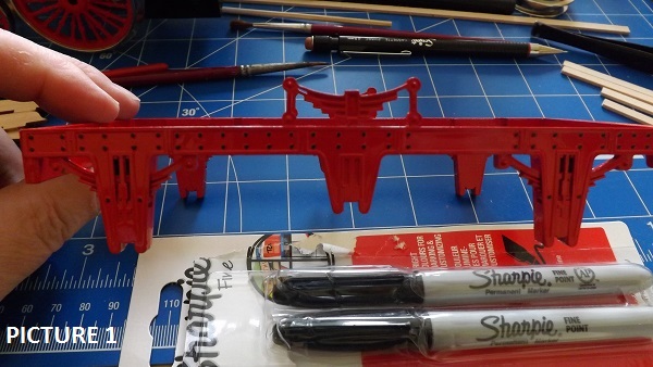

PICTURES 1 & 2

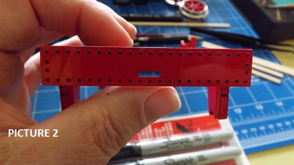

I mentioned in my last instalment that some additional colour would be appropriate on the side rails to break up the monotonous Red.
I decided the easiest option would be some colouring of the rivet heads. I did start by dry brushing but there is so little to touch that I made more of a mess of the section.
So having cleaned up the rails I opted to make life easier and used a “Sharpie” brand permanent marker which has done the job just fine.
Some additional silver paint gets added to this section as the build progresses.

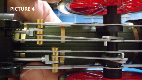

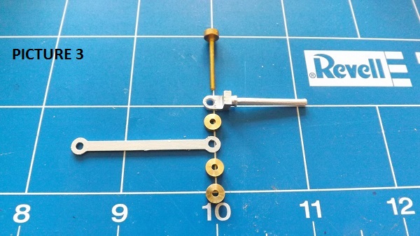

PICTURES 3 & 4
Before we can progress to finally fitting the wheels and side rails we need to add the “valve assemble” underneath the boiler.
Picture 4 shows it all in place but unglued so that Top push rod that has taken on a slight angle will be straightened out once the glue gets applied.

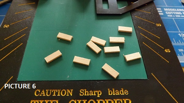

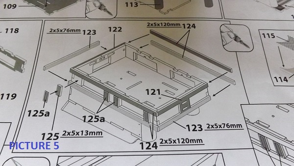

It calls for 10 pieces of 2x5x 13mm wood to be cut. I pressed on doing this and glued them into place as per the pictorial instructions.

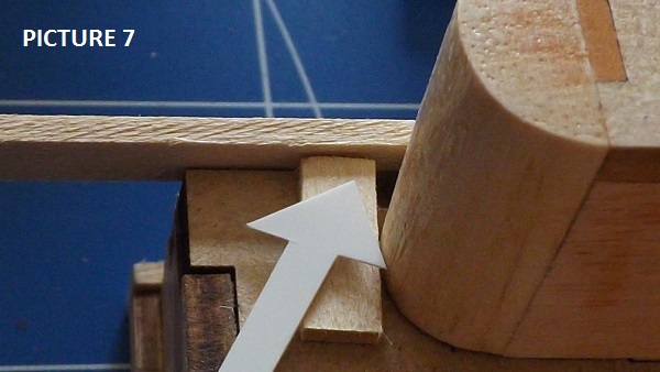

When dry fitting the Top side rail in place it was shown that this sits too high as indicated by the arrow. The deck of the tender gets planked, and these planks should finish flush with the side rail – not sit below it.
So having examined the etch overlays it showed straight away that the wood pieces should be cut to 12mm and NOT 13mm. 
The other point that came to light is that if you use the 2x5mm wood to make these 10 small parts and then glue on the etch overlays they sit to high on the sides of the tender.

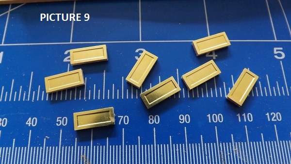

Luckily in my store I had some spare 1.5mm x 5mm strip wood. So with that in hand I glued on, using Timebond by Evostick, the etched parts.
PICTURE 9
When dry the strip was divided up into its individual number of parts.

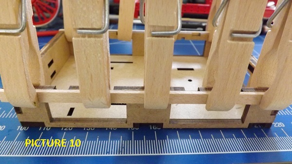

PICTURE 10
I then proceeded to finish gluing on all of these additional pieces of wood strip around the tender sides.

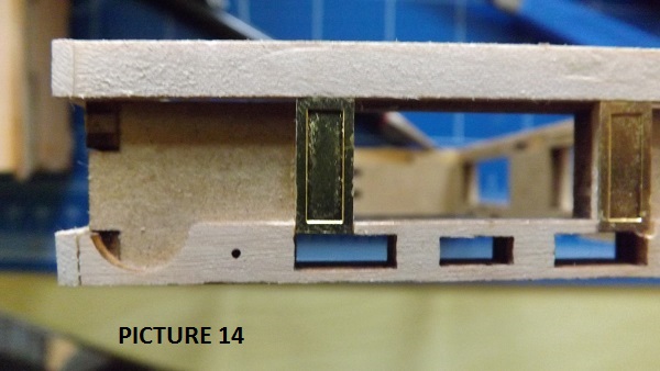

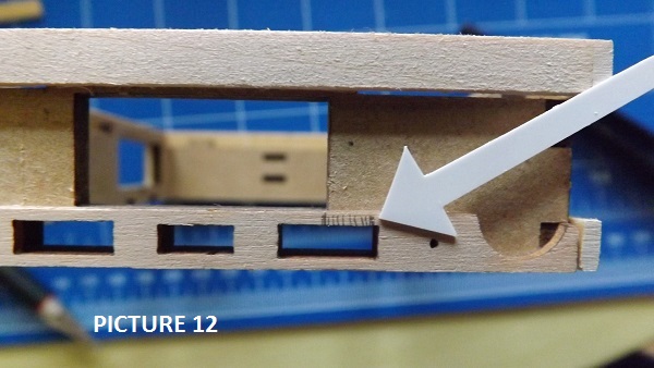

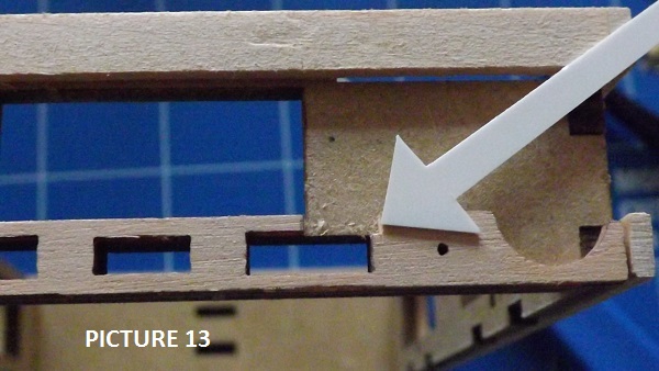

PICTURE 11, 12, 13 & 14

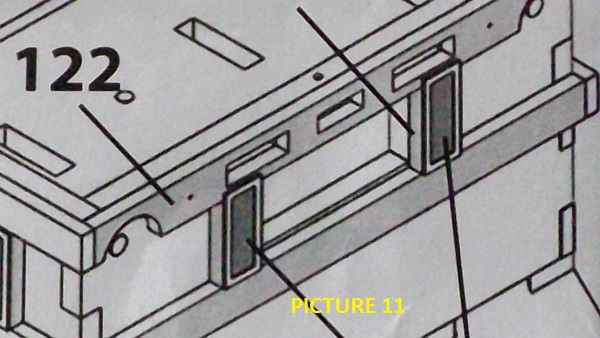

On the buffer end of the tender there appears to be insufficient space to fit the 2 etch/wood parts in place as you can see indicated in picture 11.
While it’s not at all clear (or called out in the instructions) what you need to do is trim the pre-cut part as indicated in pictures 12 and 13.
Once these 2 etch/wood parts are then glued into place all looks well.

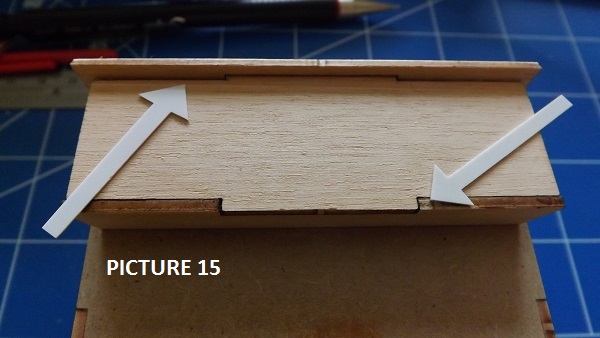

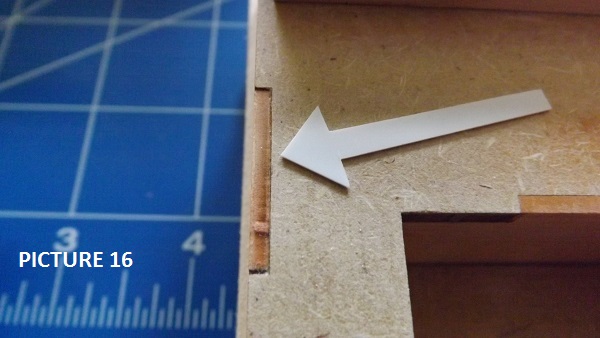

PICTURES 15 & 16
There have been some additional parts glued onto the tender this week and the fit on these pieces is not that good.
Areas highlighted by the arrows show places were some additional filler is required as these areas will be visible (although painted) once the tender section is complete.

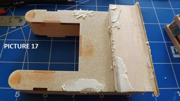

PICTURE 17
This shows what things look like once the filler is in place. Once this is dry it will be rubbed down and then a couple of side rails will be added to the top of the tender.
