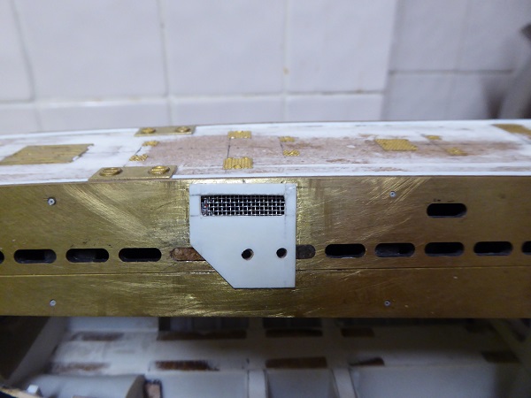

All in all the results looked very good but when compared to the original photo it just didn't look quite right.......
I noticed that my version wasn't long enough; It needed to reach further down the hull. The oblong slot also looked to low compared to the original.
This bugged me and eventually got the better of me and I decided to remove the plates, grind out a larger slot higher up, fabricate two more exhaust plates and refit the whole thing.
I'm glad I did as it looks much improved and in keeping with the original photograph. I can now look at it and feel comfortable!
The attached images show the new exhaust plates fixed in place. The first image shows the original plate held against the new version so you can see the difference.

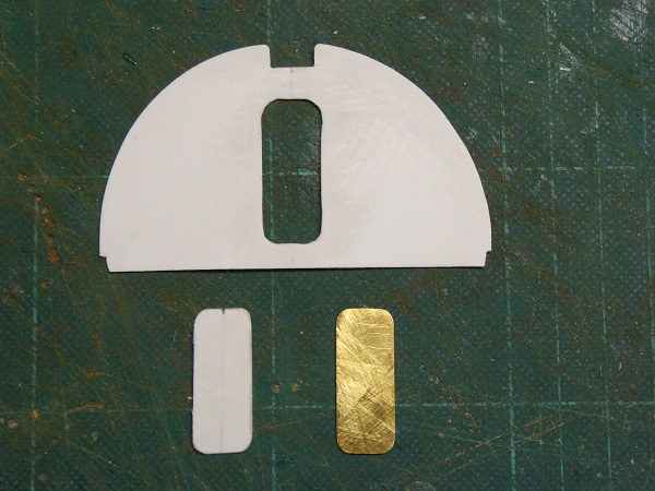

The next part of my U230 build involves making the Motor Room bulkhead with the bulkhead door opening, fixing ribs [T-Frames] to the Motor Room / Aft Torpedo Compartment and making the main motor drive shafts.
The attached photo shows the bulkhead with it's door opening cut-out alongside the plastic door cut-out and the etched brass cut-out I removed from the Engine Room to use as a template.
The bulkhead was fabricated from 0.5mm thick plastic sheet. It took awhile for me to get it to fit correctly. It was a fairly quick process to mark out and cut the semi-circular shape; the fitting on the other-hand took longer due to the various shapes and contours of the inside of the hull. Once I was happy with the dry fit I marked out the door shape using the etched brass cut-out as a template. This didn't pose too many issues and I was reasonably satisfied that all lined up correctly.
I then PVA'd the plastic bulkhead to the MDF strengthener and let it dry overnight. Once dry, I back-filled the gap between the Engine Room and Motor Room bulkhead with copious amounts of Polyfilla. Left to harden overnight I then filed and sanded the gap flush and smooth between the two bulkheads.

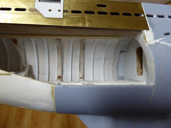

To simulate the true inside of the U-Boat [or any submarine for that matter], I decided to fit the T-Frames [ribs] inside the Motor Room / Aft Torpedo Compartment. This also carries on the look portrayed by the Engine Room plastic parts supplied with the part-works.
The attached photo shows the T-Frames in place. This was before I had backfilled the gap between the Engine Room and Motor Room bulkhead.

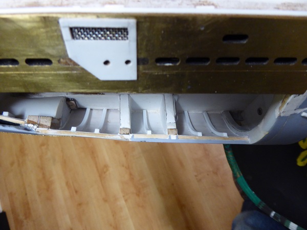

The attached photo shows the T-Frames in place. These were made using 2.5mm square plastic strip. Pretty much the same dimensions as the moulded ribs found in the Engine Room.
I had to over-bend each rib so that it sprang back to form the same curve as the hull. This was a bit of trial and error until I had a system in place; using a mustard jar as a former.LOL
#138 Posted : 09 February 2017 20:34:19
The attached photo shows the ribs fixed to the starboard inside hull looking from above. You can also see the Type 4 exhaust outlet I mentioned in a previous post.
#139 Posted : 09 February 2017 20:39:15
I made a 10mm wide spacer from 1mm plastic sheet to check the gaps between the T-Frames. Obviously the MDF supports look too big in comparison but these are providing the super-structure with strength. When I start to add detail; pumps, pipes and valves plus the tread-plate a lot of these MDF supports will be hidden.

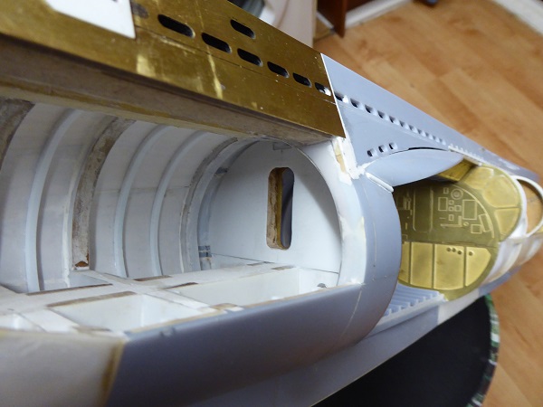

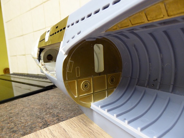

The next photo shows the bulkhead door opening filed and sanded looking towards the Engine Room.
#140 Posted : 09 February 2017 20:40:30
This photo shows the bulkhead door opening looking from The Engine Room into the Motor Room.
