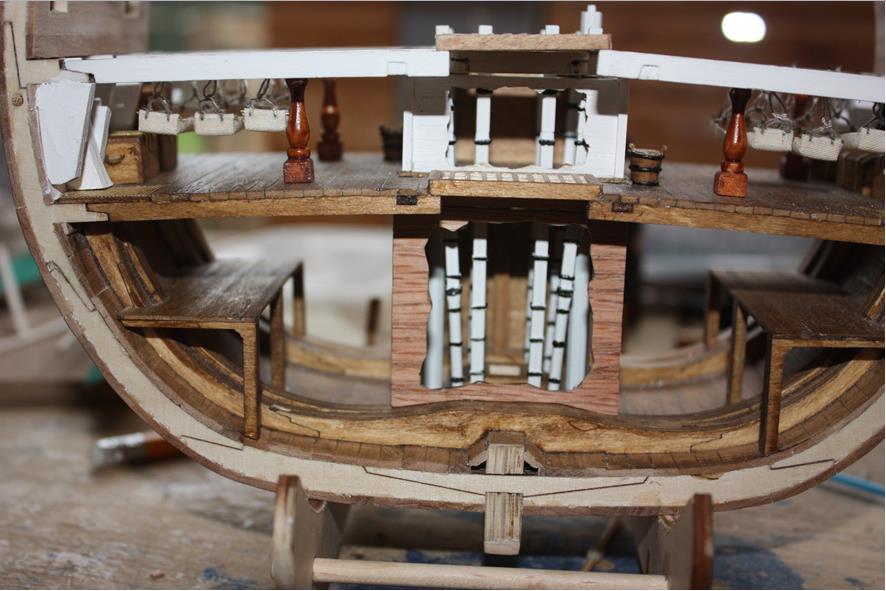

Issue 137 Cont'd
Fitting the pump columns. Some minor adjustments need as the slots into which the chain pump assembly fit where a bit tight.
Adding the beams was no problem, but gluing the chain pump assembly to these beams was a tad fiddly, there is not a lot of room.
I had a minor problem with the port side elm tree pump fitting as it would not locate in the recess in the hold below. As per the instructions I filed the beam so that the pump would stand upright and to ensure the pump would stay in position I rounded off the end of the pump so that it would fit into the recess. I think I may have been too cautious when drilling the recess and left it too shallow, but the rounding off seems to have solved the minor problem.
Added the grating and companionway frame
Now onto issue 138 planking the lower gun deck, some guns to make and the chain pump heads.

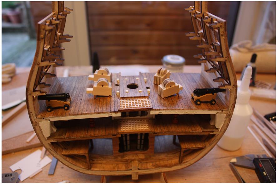

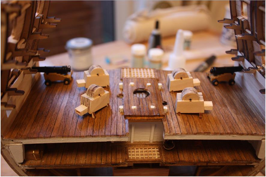

#124 Posted : 24 December 2016 18:08:31
Joined: 10/10/2010
Posts: 690
Points: 2,133
Location: Dorset

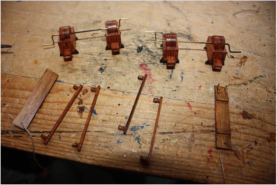

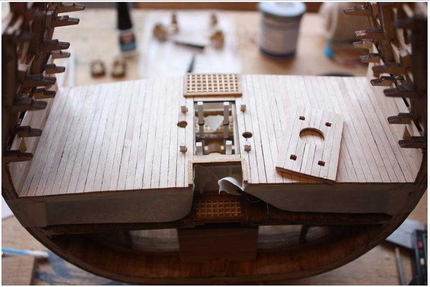

Issue 138
Planking the Lower gun deck
Making the 32 Pounders
Making the chain pump heads
Plenty of planks supplied to cover the gun deck. Straight forward until you get to the pump columns where it can get fiddly. Also be careful around the companion way and grill as these are easy to damage. The centre section of the deck forms a raised platform, I decided it would be easier to construct the whole platform as a single piece and glue in place once completed. The made it easier to trim the planks and fit the planks around the mast. I planked the whole platform and cutout the hole for the mast once the glue had dried. Test fit the platform to ensure the mast is at the required 40mm from the edge of the grating. As I could remove the platform any fine tuning was straight forward. Once the fitting was correct glued into place and the whole deck was stained.
The construction of the 32 pounders is similar to that for the Victory build, except that the barrels require painting and the addition of a thimble. The carriage has wooden axles and wheels which make these look more like the full size guns on the victory. The only addition I may make is to add Tampions the the muzzle of the guns.
The chain pump heads are straight forward the only thing to note is that the two centre parts are not symetrical so make sure you have them the right way round before you glue (Note to self read the instructions)
Pictures attached
Current Build:-

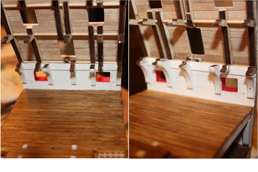

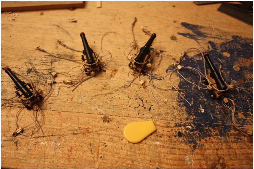

#131 Posted : 16 January 2017 10:38:44
Joined: 10/10/2010
Posts: 690
Points: 2,133
Location: Dorset

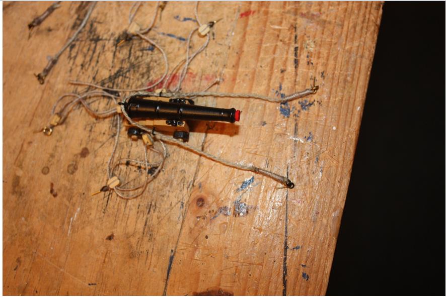

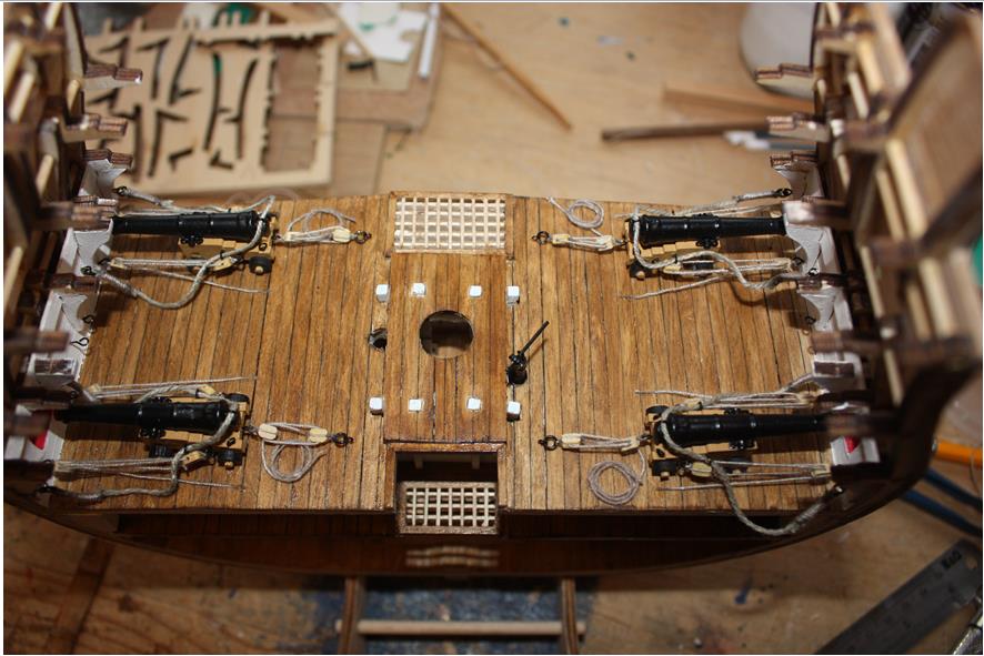

Issue 139
Finishing the lower gun deck bulwarks -
Straight forward, just ensure you mask off the deck to avoid paint on the deck. As i have mentioned before I am using some white emulsion as I find this does not bleed under the tape as I found with the Admiralty paint I first used. A Big thanks to Mr T for the heads up on the typo on the drilling plan (Official Build Diary)
Preparing the guns:
Having built the Victory this is more of the same with a few differences, Wooden Wheels and Axles and they are larger. It is a good idea to check that all the holes in the blocks are clear, in fact I made them slightly large to allow the thread to run more smoothly. One of my blocks had no holes at all !!!!!.The instruction suggest that the .75mm thread is attached to the eye bolt with two half hitches. I did not like the look so instead I used some thinner thread the bind the ends for a neater look. I also added tampions to each gun
Pictures attached
Current Build:-

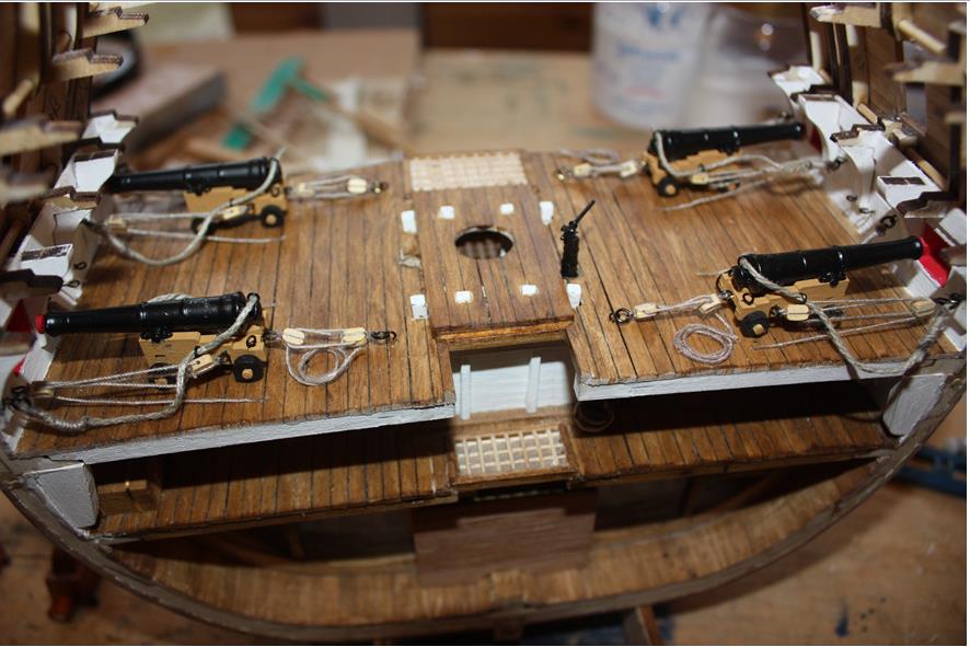

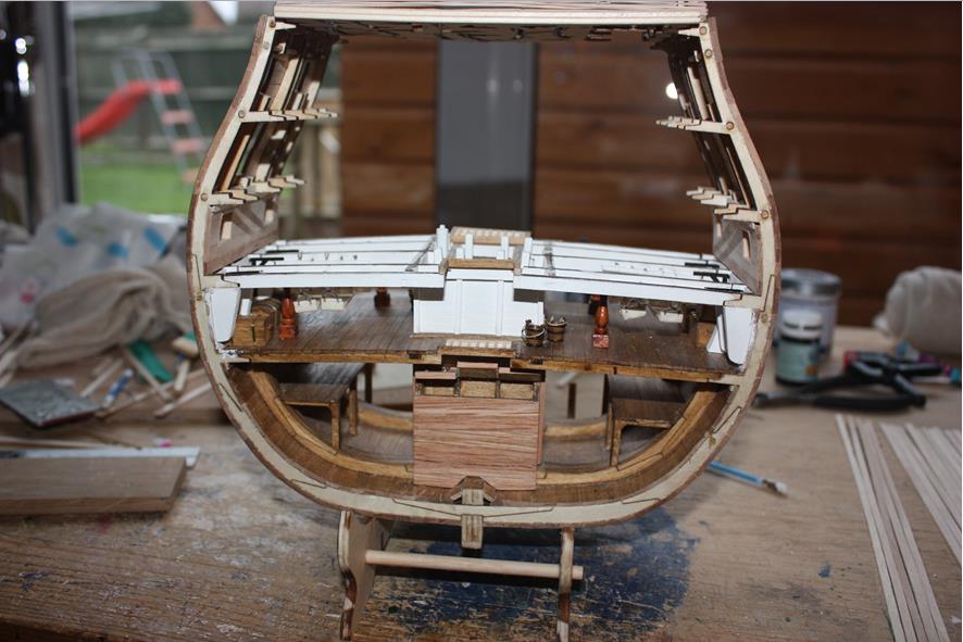

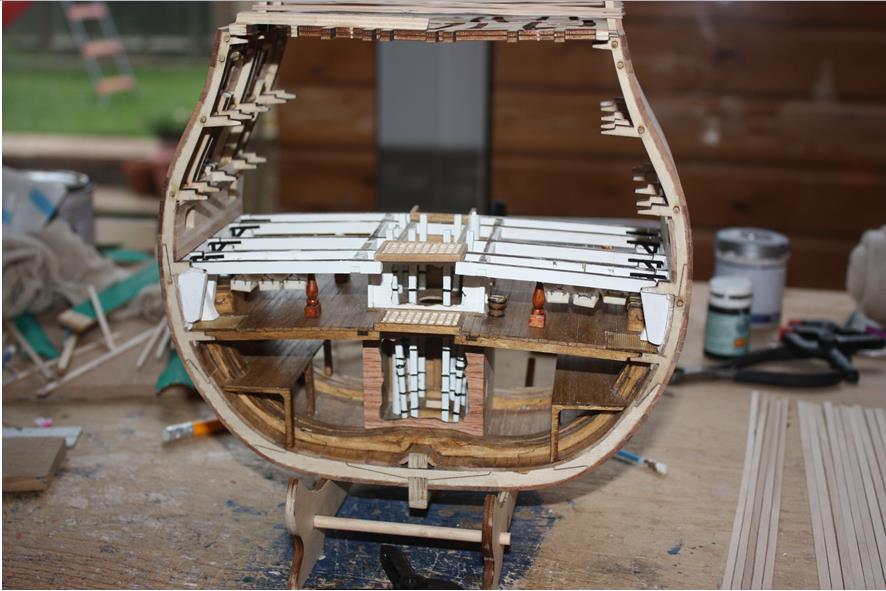

#139 Posted : 26 January 2017 11:40:08
Joined: 10/10/2010
Posts: 690
Points: 2,133
Location: Dorset
Issue 140
Rigging the Guns
Before you start to rig the guns it a good idea to ensure all the holes in the blocks are clear, one of my blocks had no holes at all !!!! I drilled out the holes slightly large which made it easier to thread the rigging. Tried painting the rings black prior to installing but a lot of the paint came off when adding the rigging so some touching up was required
Fitting the pumps
Assemble the two pumps as per the instructions - I sprayed mine black which gave them a nice even finish. The four chain pump heads need to be stained and painted. The handles I assembled in a different manner to that suggested in the build. Rather than make each handle from two pieces of brass wire I used one for each pair of pump heads. I bent one end of the wire to shape and threaded this through a pair of pump heads, then bent the second end to shape. I will then glue the heads in situ and paint the handles black. There will be no need to glue the handles so they will still be able to turn
Mess Tables and Benches
I made one small change here, I added two additional supports to the underside of the table to add a bit extra strength. I will install these as part of the next stage and have set them aside for now
Current Build:-
