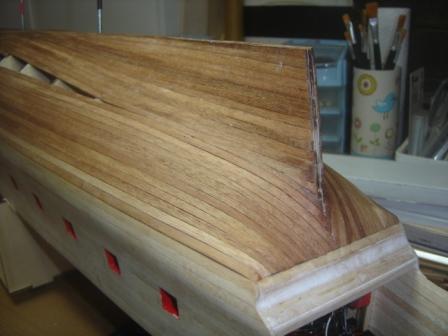

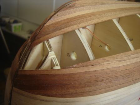

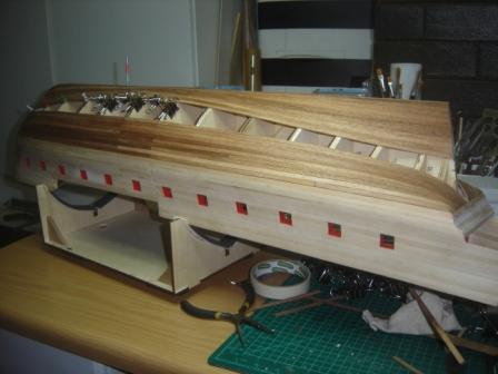

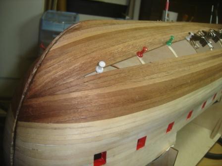

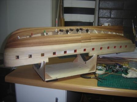

#124 Posted : 04 August 2016 10:20:37
Joined: 18/04/2016
Posts: 134
Points: 402
Been plodding along with the planking..slow process.
Chris....I tried to get my head around using stealers and ended up making long planks short, can't seem to get that right so I resorted back to plan B letting the plank take it's natural line and trimming it where it meets the adjoining plank. Hope I'm not painting myself into a corner here!!!!!
Barry

johncal
#125 Posted : 04 August 2016 11:03:21
Joined: 02/04/2013
Posts: 174
Points: 534
Location: Bethlehem PA, USA
Either way will work. It will depend on the look your going for. In my case I have copper plating so everything under the waterline is not visible and above is painted, so again not visible. In that case, you just want to do the right amount of sanding to be accurate looking. Keep in mind, on the real ships the planking is not that smooth. Look online and you'll see what I mean.
On the other hand, if you are keeping all the wood natural where the planks are very visible, in what I call a "furniture build" then the accuracy is more important as you can see the planks, as is a smoother finish which is all part of the expected look.
I thought you're coppering though, so you'd be fine.

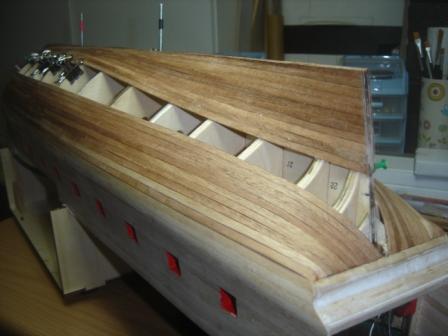

BarryM
#127 Posted : 07 August 2016 17:49:03
Joined: 18/04/2016
Posts: 134
Points: 402
Got to one of those stages where "I sits and thinks" where to lay the next plank??
The natural lay on the keel side has been steadily moving from laying easily to the previous plank to a really complex compound curve....think I might go with the natural lay and then fill in the gap with tapered pieces..yep, gonna do that.
Been resisting the temptation to start any sanding..should be able to hang on for a while longer and make one big pile of sapele dust.
Barry

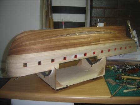

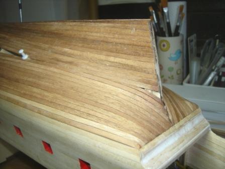

BarryM

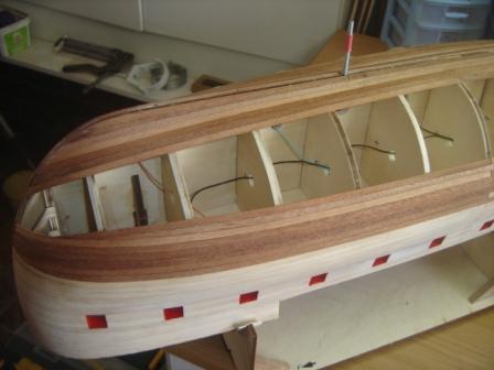

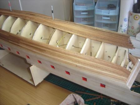

#133 Posted : 17 August 2016 11:10:30
Joined: 18/04/2016
Posts: 134
Points: 402
Thank's gentlemen...haven't had much time over the past week to spend on the Surprise but hopefully that will change, meantime here's a few pics of what I did manage...things started to get really cramped at the stern!!!!
The keel and other stuff should be arriving this week...once I finish the planking and see how the keel fits I can start some sanding, exiting times...
