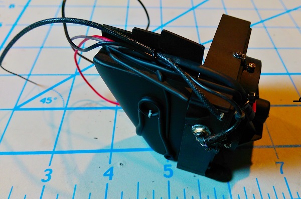

Pack 12 will be arriving soon; meantime I made a couple more improvements. I bought a bunch of hobby supplies from an excellent Japanese online marketplace Rakuten Global (http://global.rakuten.com/en/index-b.html) including braided tubes 1 mm and 2 mm diameter useful to duplicate various engine hoses & brake lines. Using a flexible bead wire dressed in 1 mm tubing, I replicated better brake lines.

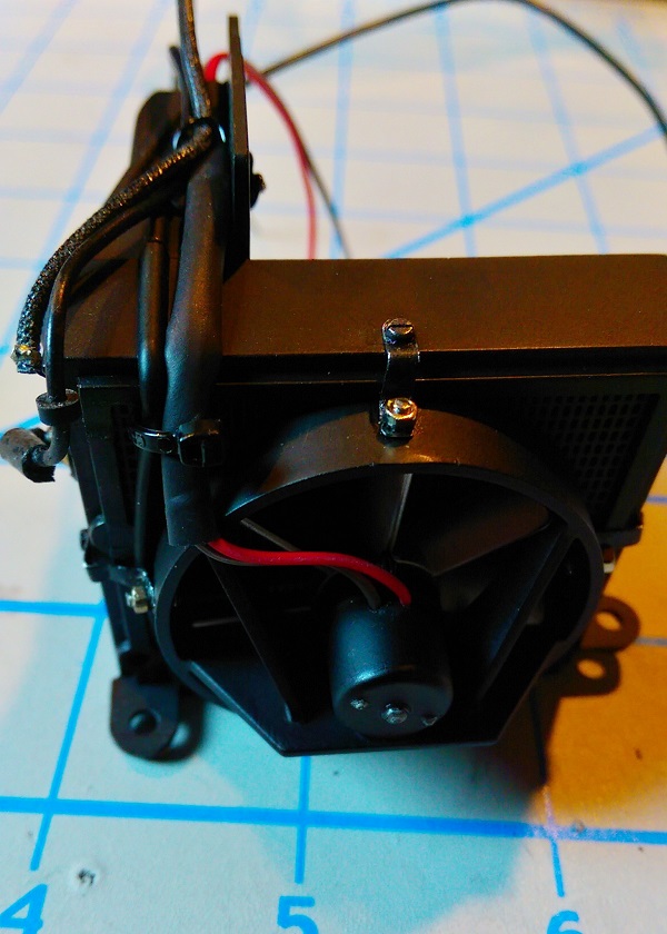

Another braided hose is clearly visible going out of the corner of the radiator (see the booklet for Pack 04), so I added one (along with a photoetch hose clamp) to my radiator.

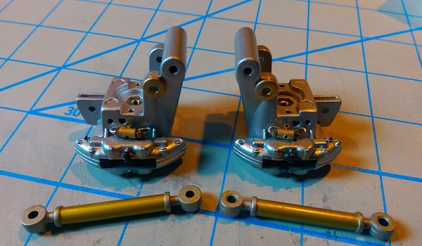

As for the front brake assemblies, brake duct cooling hoses got a wash of white paint to emphasize the grooves plus photoetched hose clamps.
Brake discs have been scraped off to remove silver paint and dry-brushed with flat gunmetal on both sides. Light circular rubbing with fine sanding pads replicate worn-out grooves.

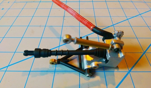

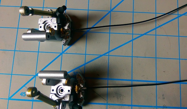

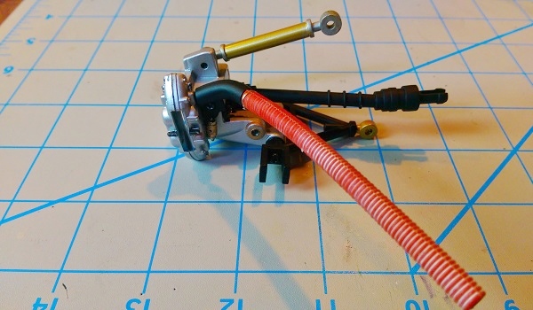

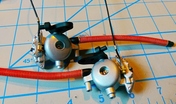

Rear upper arm sockets were painted silver to match pictures in the Pack 09 booklet. Also added brake line connectors (made of bits of a round plastic tube and bead wire) to the rear hubs. Brake lines are made of bead wire and braided tubing (purchased from Rakuten Global).

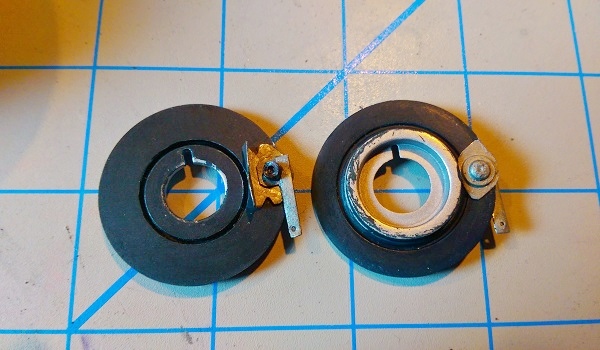

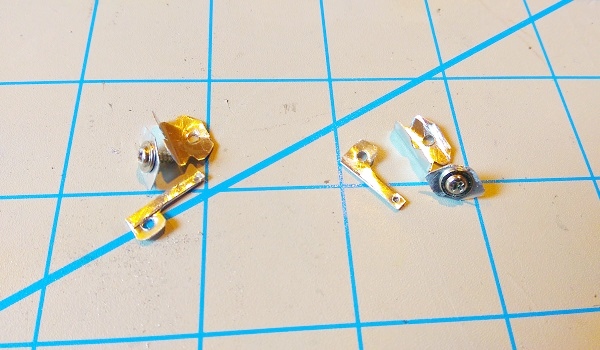

Rear wheels in the model are conspicuously missing handbrake pads so I manufactured them from bits this sheet steel, attached them to the brake discs by washer screws and painted them dark silver. Connected handbrake lines (bead wire and braided tubing) to the narrow protruding part.

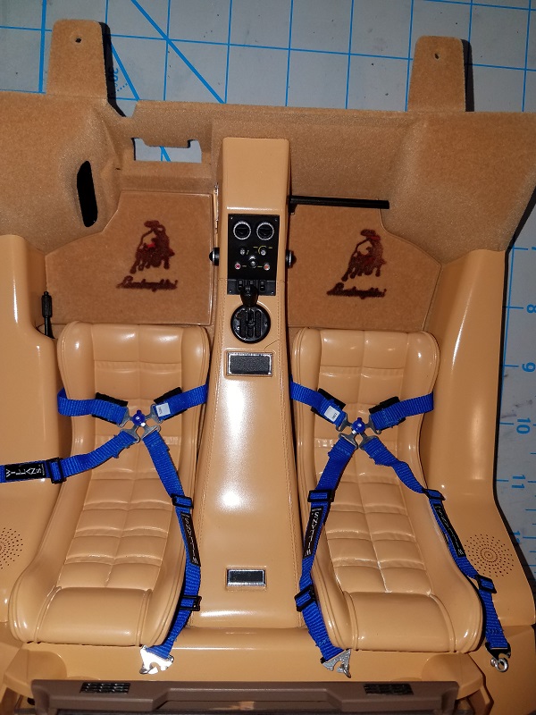

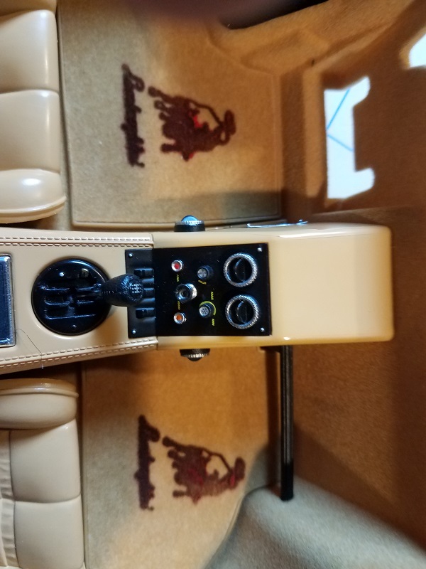

(1) A while ago I’ve decided to add Lambo logos to the floor mats (embroidered logos are present in WW Countach). The easiest way to do it was with a custom rubber stamp. O I waited while one of the big custom printing websites had a major semi-annual sale and was able to make a rubber stamp for just a few dollars.
I spread a thin layer of red enamel paint on a piece of foil, dipped the stamp and made a few tries on paper which came out pretty good. Then I attempted the same of the kit’s mats. The results were fairly good, not as crisp as on paper because the synthetic “pile” had absorbed some of the paint but still you can see the logos and the outline of the word “Lamborghini” quite well.

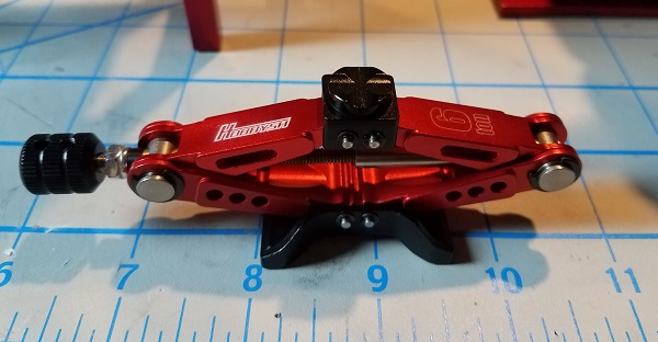

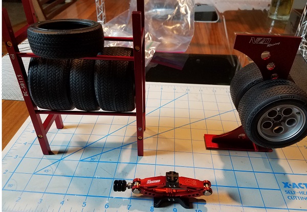

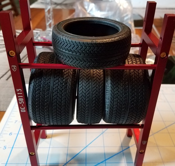

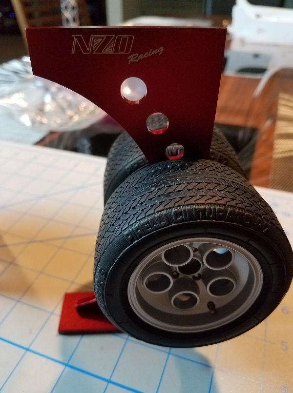

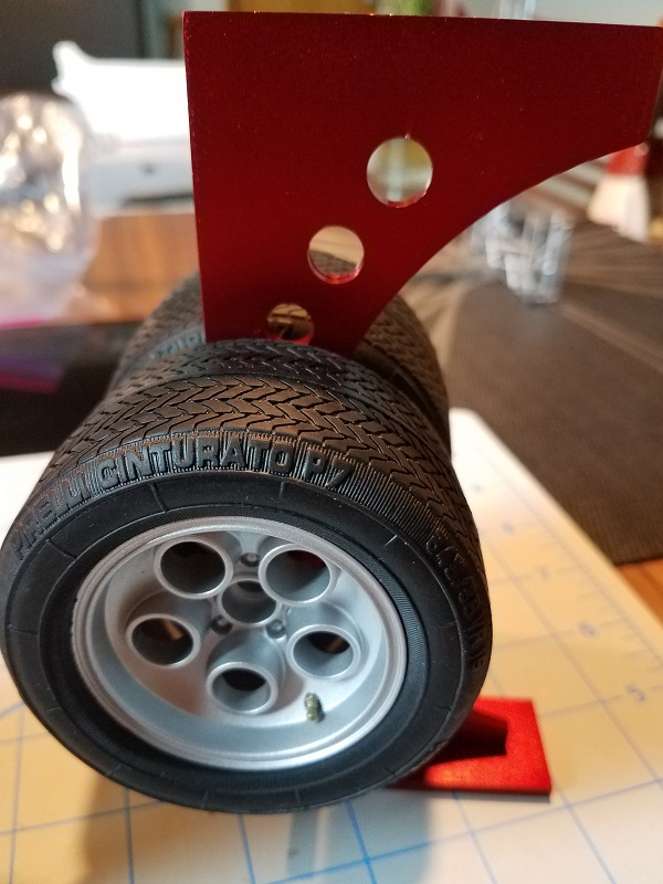

(2) Two types of red anodized aluminum scale model spare tire stands were bought on eBay along with a jack. Spare tires were ordered from DeAgostini, they were kind enough to only charge me for shipping.

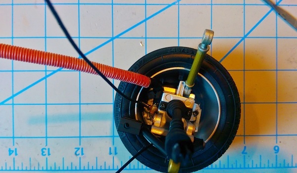

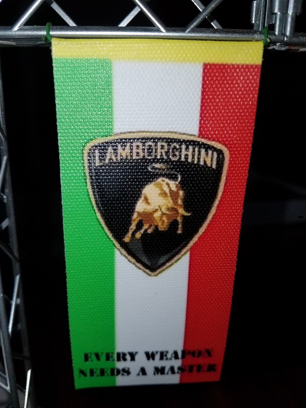

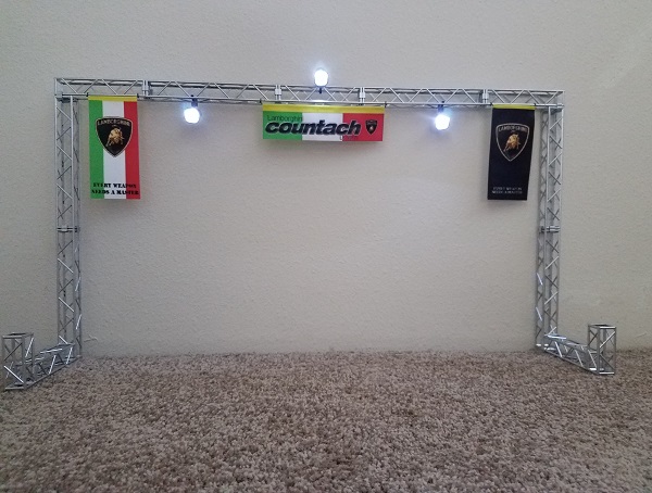

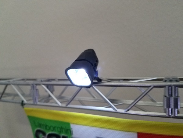

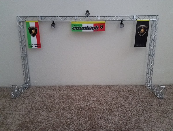

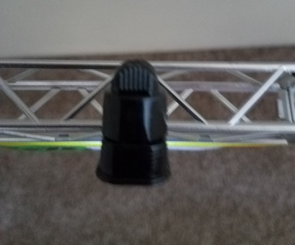

(3) The overhead truss kit is from Japan, purchased on Amazon, as well as LED spot lights. They were all in soft grey plastic. I painted the truss assembly with chrome spray paint and the spot lights with gloss metallic black.
The Lamborghini banners were custom printed on artistic canvas, cut and glued to stiff wire, and attached to the truss.

The end result will look something like the picture below (from a Japanese hobby website); this is where I got the idea but mine will be even better (I hope!)
Pack 13 should be arriving soon.
