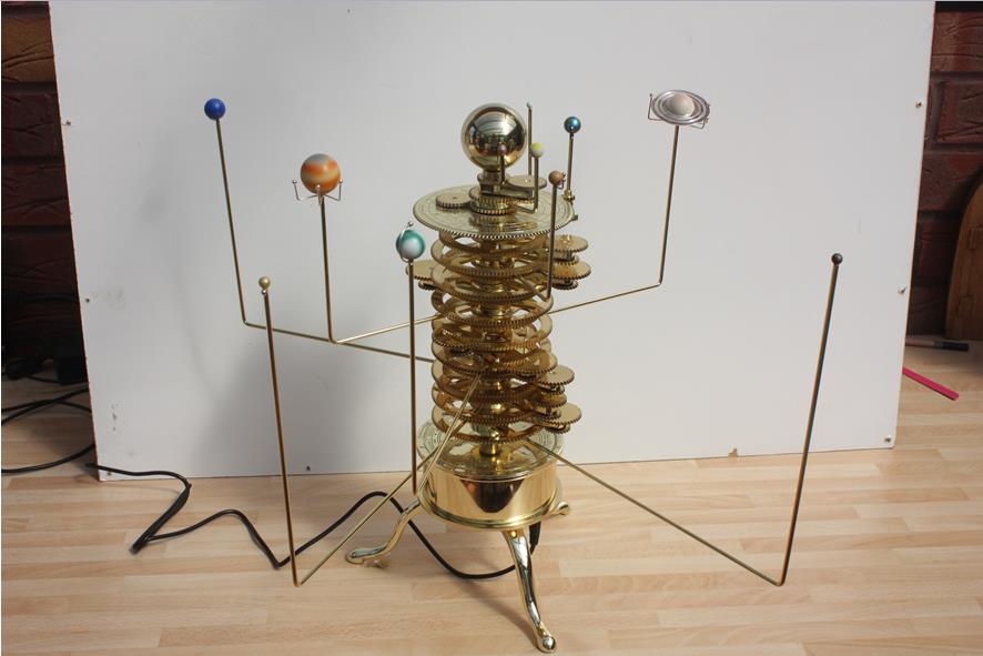

Well finally I have all the components in place. Just have some tweaking to do. Some of the planet support arms need minor adjustments/tightening up as they are not level.This does not inhibit the working but looks a bit untidy.
The planets are not in their correct orientaion re the other planets but I still have to work out how to do this ( My next job) Once plugged in the planets move as they should. The only slight mod I had to make was the slot for the on/off switch, it was a bit tight and the switch would not move freely. Easily corrected with the application of some delicate filling with my dremil. I knew that box of attachments would come in useful one day.
I was not sure that all the planets where moving when I first switched on, but you have to bear in mind that the distances involved are astronomical and the outer planets/dwarf planets have a lot further to travel.
Mercury takes 88 days to orbit the sun
Venus takes 224.7
Earth takes 365.2
Mars takes 687
Jupiter takes 4332
Saturn takes 10760
Uranus takes 30700
Neptune takes 60200
Pluto takes 90600
Not all the planets are in this list as it does not include the Dwarf Planets apart from Pluto which has only recently been downgraded to a Dwarf Planet.
There is a follow on build the Orrery, a Tellurion which is a model on the earth moon and sun only. This would involve another 52 issues 53-104. Not for me at this time
I will attempt a video but am not sure if I will be able to upload it to this site. What are the file size limitations?
Meanwhile picture attached.
The build has been interesting, I am more than happy with the quality of the parts, but the customer service and delivery issues towards the end where disappointing.
I am amazed at the number of views this build has attracted and as always appreciate the support and positive feedback from the forum members.

#123 Posted : 22 August 2016 16:48:27
Nice work Gil, looks good.
#124 Posted : 22 August 2016 17:08:47
Gil
Looks a brilliant build so a very well done for sticking with it and getting it completed.
Not seen the follow on they are doing but sounds interesting although that number of additional issues does sound a lot.
Hope your Lancaster build goes well. It will keep you busy as its such a complex set of parts. Looking forward to seeing your start on that one.
#125 Posted : 22 August 2016 17:45:39
Well done.
A very nice end result considering some of the hassle you had with parts.
#126 Posted : 22 August 2016 18:40:14
looks great Gil.Looking forward to your next build
#127 Posted : 22 August 2016 22:54:06
Great to see this finally finished. It looks stunning!
With regards to video you might be better off uploading the video to YouTube and posting a link
#128 Posted : 23 August 2016 07:22:27
Looks fantastic, glad to see you finished the build. We have all our parts now, just started getting the bonus parts for the sun, earth and moon.
