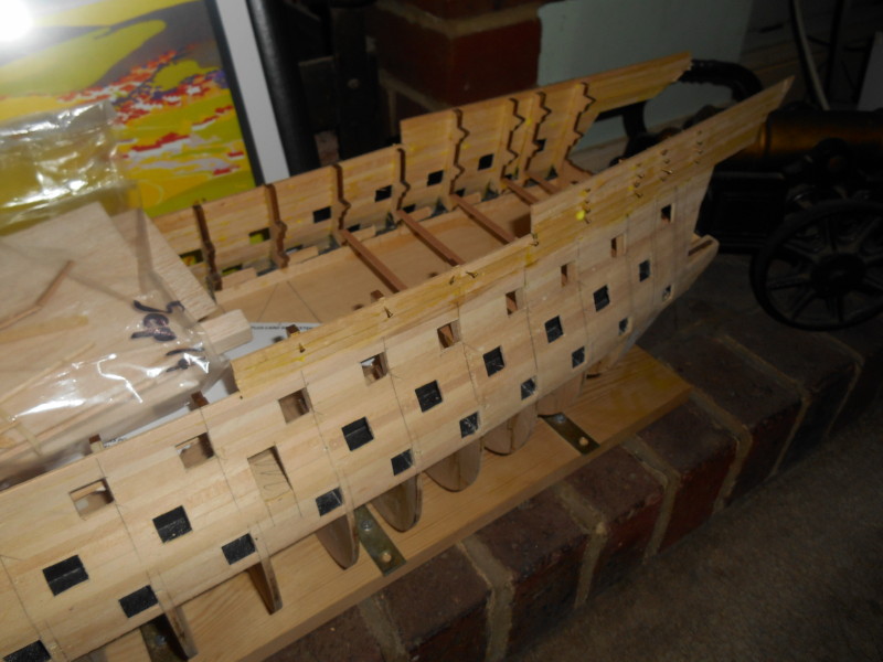

Thanks guys for all of your kind wordsThumpUp a little more of the planking done this evening up to the forcastle, i do wonder why they didn't make frames 15 & 16 a little higher to take the planking ?Confused
Gibbo attached the following image(s):
#124 Posted : 05 August 2015 23:52:19
Nice work GibboBigGrin Frame 15&16 are left short as that top plank will be sanded at an angle getting lower from bow to stern, the frames would interfere with this process if they were higher.
Ah...now i see, thanks for that steveThumpUp

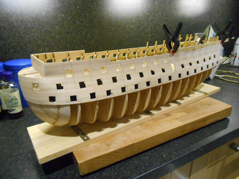

Upper deck gun-ports cut bar eight of them, and starting to build up the stern planking.

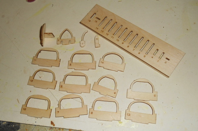

#132 Posted : 08 August 2015 01:18:19
Joined: 26/05/2014
Posts: 912
Points: 2,773
Location: East Sussex UK

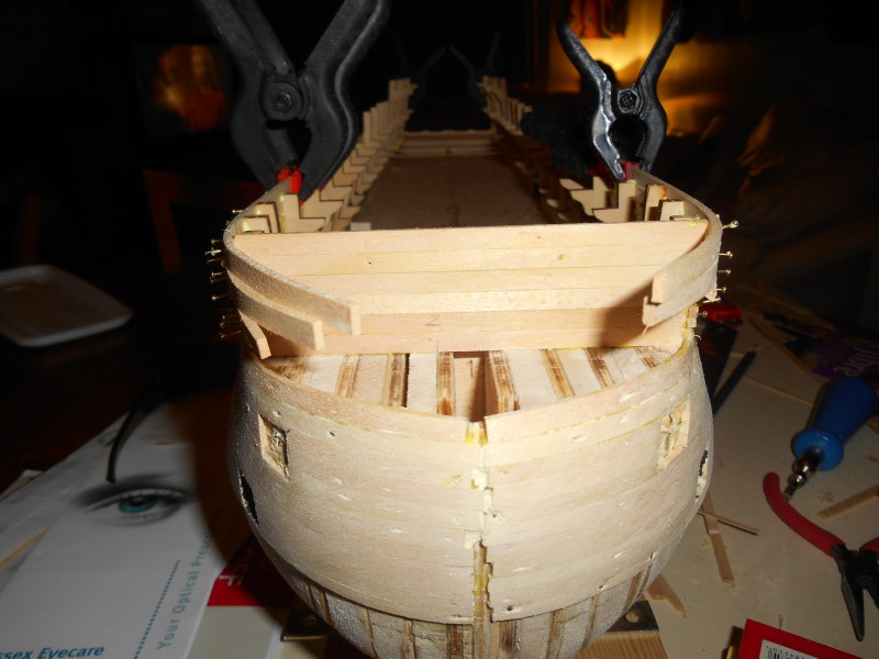

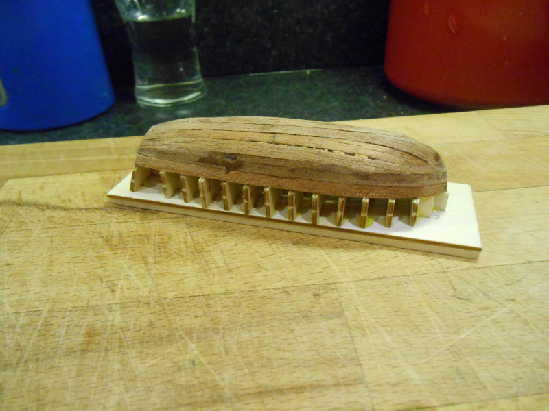

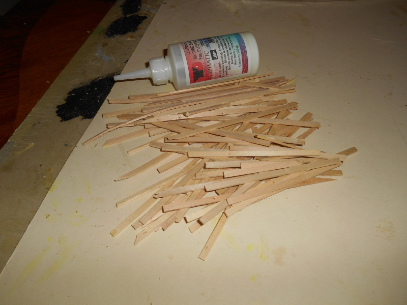

Pic no.1: Unused planking has been used for the bow and upper stern sections and the planking that was used before has been used for everything else and this little pile of wood is what's left, so there has not been a lot of wastage so far, Pic no 2: The upper planking is now complete. Pic no. 3: The Launch has been dismantled and cleaned up ready for re-assembly, with a bit of jiggling back and forth it came apart pretty easily, had to make a missing bow former no.3 and i dont seem to have any planking material for the Launch, i might try sanding down some 1mm Tanganyka and see how that goes.

Thank you for looking in and all of the positive feedback guys, it's very much appreciated, the launch frames are now all back together on their jig and with this thing being knocked around a bit and coming half way round the country there are a couple of fragile frames as you can probably see in the picture, these i will have to straighten out as we do the planking, i tried to sand some 1mm Tanganyka down to about a half mill because i don't have the supplied strips but really couldn't get the consistency right the way through, i thought this might be just too much trouble in the final sanding and finish so i have decided to use the 0.4mm sapele strips left over from my DelPrado build and double plank the launch, this will give me some extra rigidity by being able to glue the second layer completely over the first and not just on the frames, and give me some extra play for sanding, and of course save me seven and a half quid on a back order.

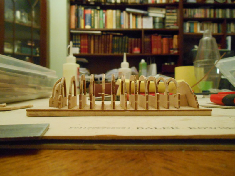

#139 Posted : 13 August 2015 23:38:07
Joined: 26/05/2014
Posts: 912
Points: 2,773

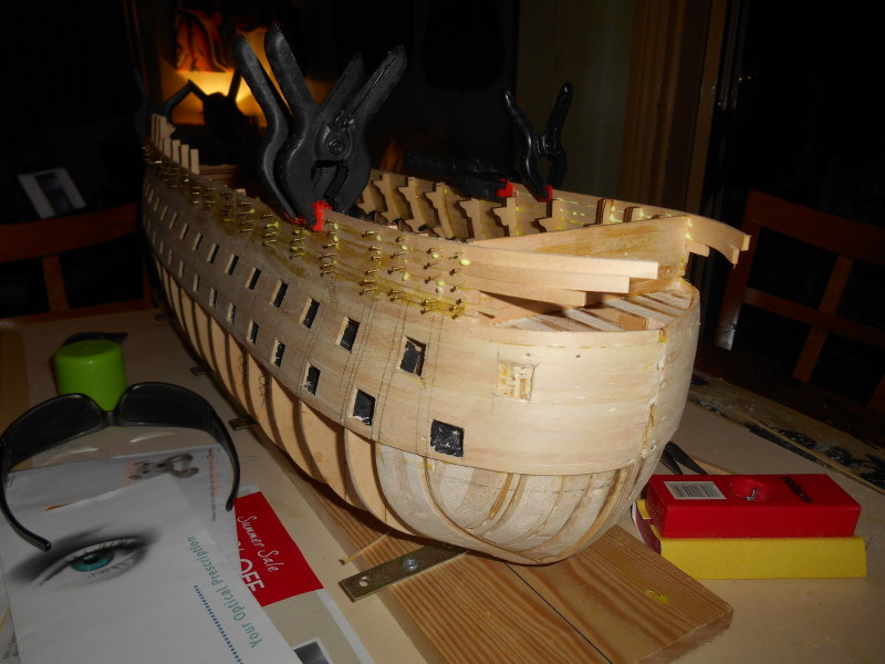

Well after planking one and a half big ships with thick planks and not having too many problems with them i found this little beastie a right pain in the backside, I've grown to really hate this little thing, i dont know why i found it so difficult, i just cant work it out, now it's a question of "do i give it a second layer" Aaaarrrgghh, or "fill sand, fill sand, fill sand" and see what happens, thats an answer for another day, i'm off on my holidays for a couple of weeks and i'll be glad to get away from "The Beastie".
Happy modelling all.
