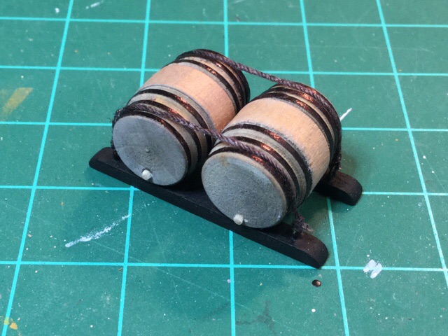

Barrel Stack complete. I added some bungs to the barrels using bits of toothpick (cocktail sticks in the UK) as suggested by John - great idea. It's not perfect but I like it.

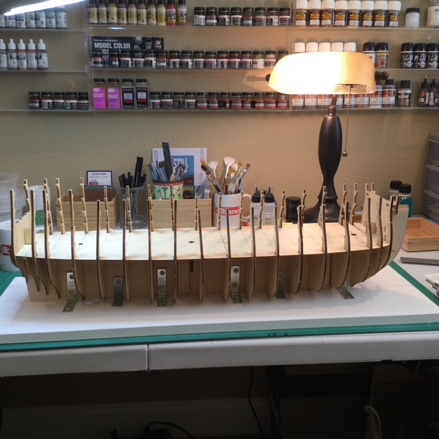

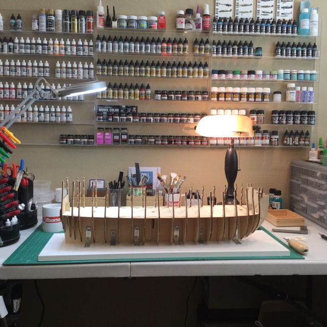

Today I assembled the frames to the keel and fit the main gun deck to the rest of the framework.
I had to take a good bit of warp out of the stern deck halves but a light soak and a day or two under some heavy books and most of it was gone. The center of the two deck halves goes exactly down the center of the keel and I centered all of the frames to my lines.
I thought I would post the pictures before I glue it up.

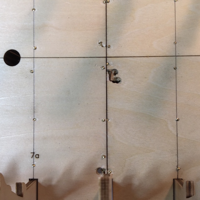

I'm a little embarrassed Blushing that I actually drove the nailer through the deck in a few places (see picture 3). My assumption is that this deck is completely hidden and that I don't need to patch and fill the holes or worry about any of the nail heads Confused. Someone please correct me if I'm wrong.

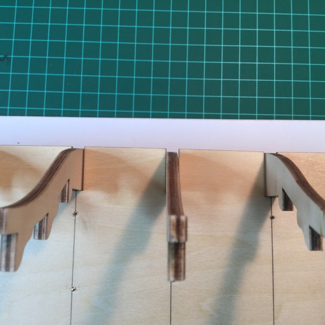

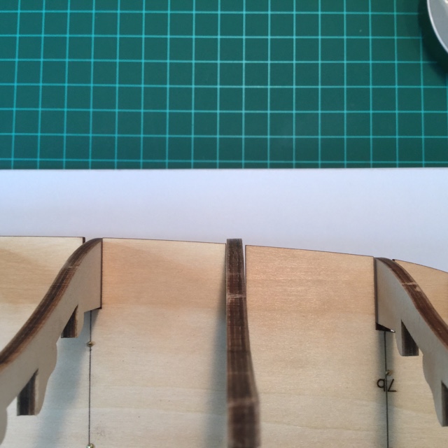

There are also a few spots where the deck sits out slightly from the frames and where the frames sit out slightly from the deck Confused (see pictures 4 and 5). My assumption is that all of this will get corrected during the fairing process. Again, someone please correct me if I'm wrong.
DSoldano attached the following image(s):
Dominick
On the Bench: DeAgostini HMS Victory, Moebius Creature From The Black Lagoon
Up Next: We'll See
#139 Posted : 06 June 2015 23:40:44
Looking good Dominick and you are correct on both counts, you will not see any of the deck you've just laid so appearances here don't matter, what matters is that the deck is correctly fitted and all lined up... Cool Cool .. The fairing process will take care of any deck overhang from the ribs so again no need for concern here.... Cool Cool
#140 Posted : 07 June 2015 00:13:24
BigGrin Now that looks like a hull ready for planking and as Alan says any overhangs will be removed with the fairing process. Are you going to put infills at the bow and stern to aid in the laying of the planks, as for the cut out have you seen how Bernd did his cut away section if you do take the cutaway route then some planing at this stage of the build will pay dividends if you choose to do something along those lines.Look at pages 12/13 of the build link below.
