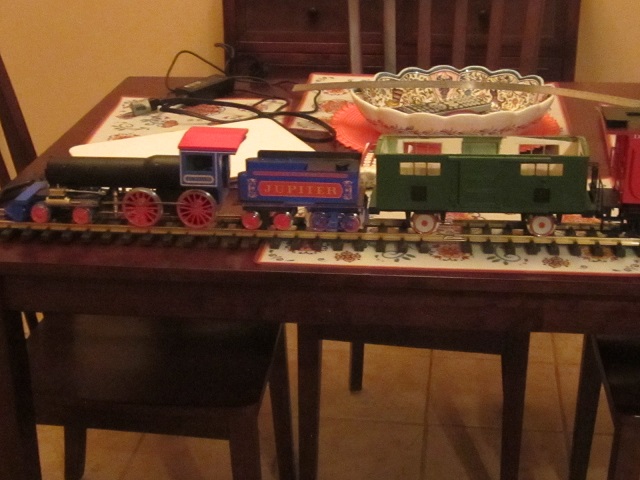

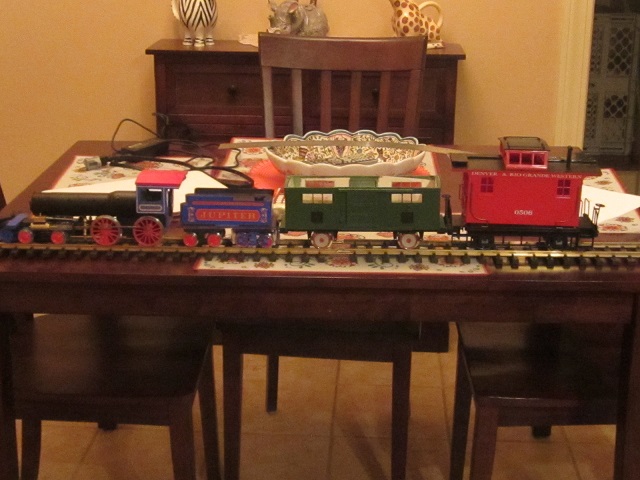

More mock ups.I placed the boxcar behind the train and put the caboose behind that.It measure about 40 inches total length.I have to resize the caboose from 1/24 to 1/32 as it is obviously too big.
I think the boxcar looks OK .I decided on a green color to tone down the diorama a bit.

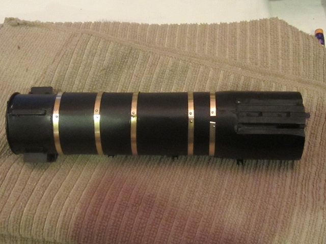

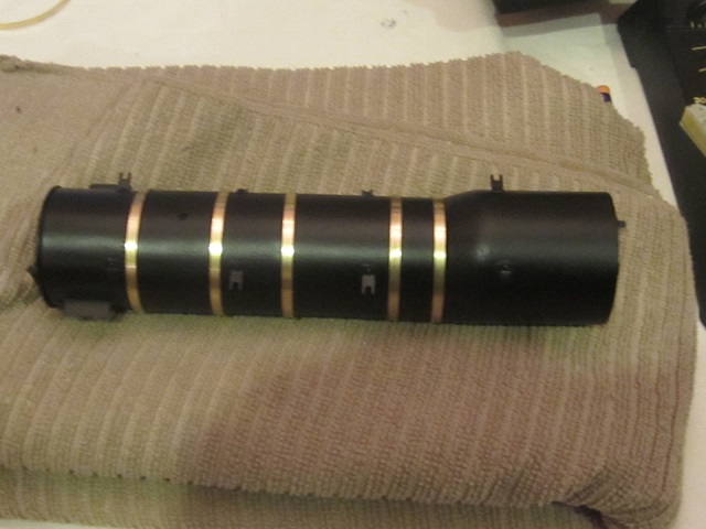

I see from your picture you still have to attach the copper bands to the tank. I did think of gluing them on but was concerned about surplus glue spoiling my paint job so in the end I cut to length, bent to shape ( making them a little tight) then drilled the ends and pinned in place. The pins will not be seen once the tank is attached to the chassis.The two short lengths at the cab end I glued in place

Thanks for the tip about the bands.I think that is what I will do too.
#124 Posted : 28 July 2015 05:11:36
More work on the boiler.my fellow Jupiter builder Gil recommended using pins to attach the boiler bands so I decided to listen to his sage advice and here are the boiler bands.

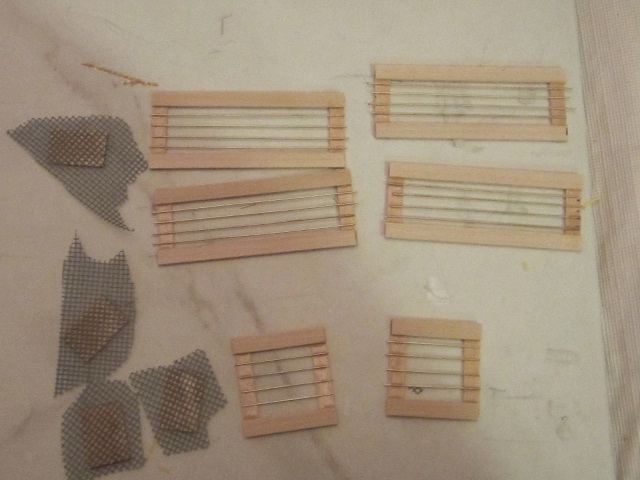

More details on the boxcar as I wait for my spraybooth to become accessible again.The boxcar has bars across the windows so I tried to mimic those with 1/32 brass rod.I also made some grills using the netting for the chimney.

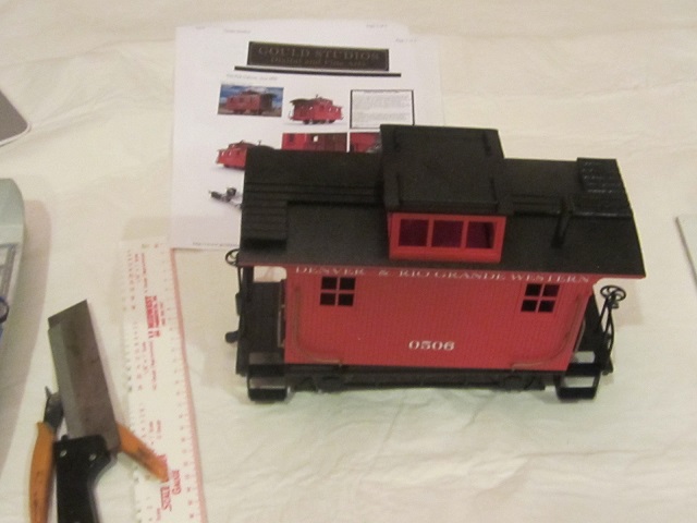

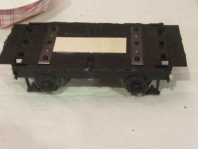

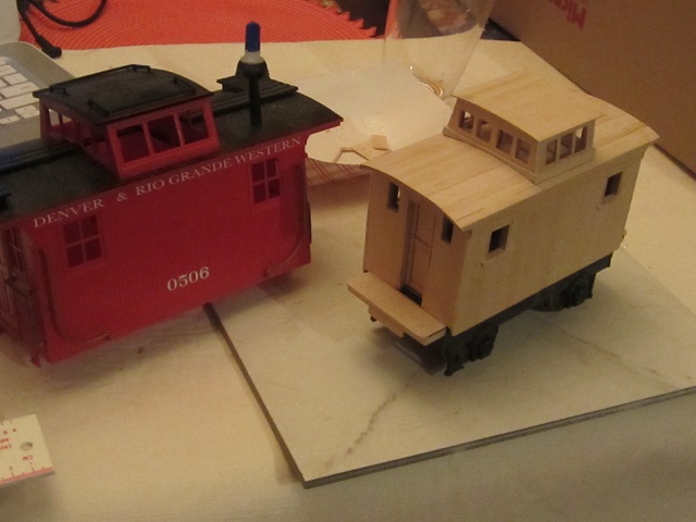

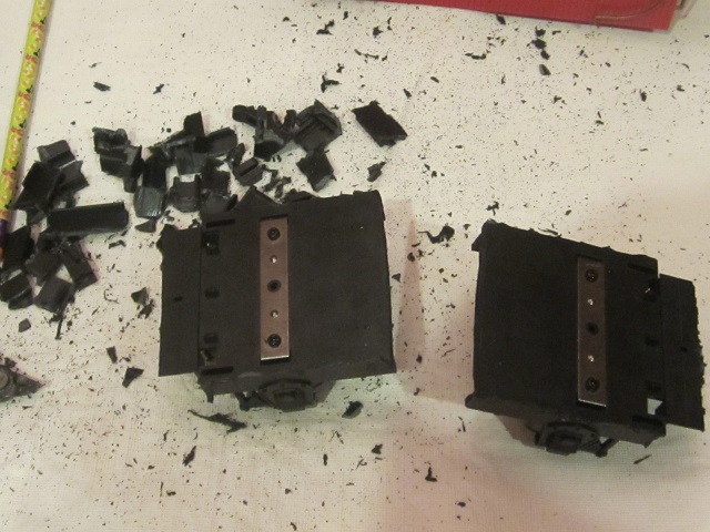

Still waiting on the spraybooth so I started wok on the caboose.This is a cheap Bachmann caboose that is 1/24 scale.It has 45mm wheel spacing so I decided to use the base of the caboose and scratchbuild the body.I need to shorten the wheel base so I cut the base and took 3cm off the length and reattached the 2 ends.I also made the caboose narrower so it matches the width of the boxcar and tender.Once the base has dried I will start construction of the body of the caboose based on the Bachmann caboose and some photos of a caboose found on the internet.
Despite hours of scouring the internet, talking to a few train stores it seems like no-one makes a 1/32 caboose so the only option was to build my own.
Cabooses were just starting to be used in the 1860s.They were generally quite small with a 4 wheel configuration.I couldn't find a specific Central pacific car, but there is no reason to think they would be Different from the Sante Fe caboose that Bachmann made.

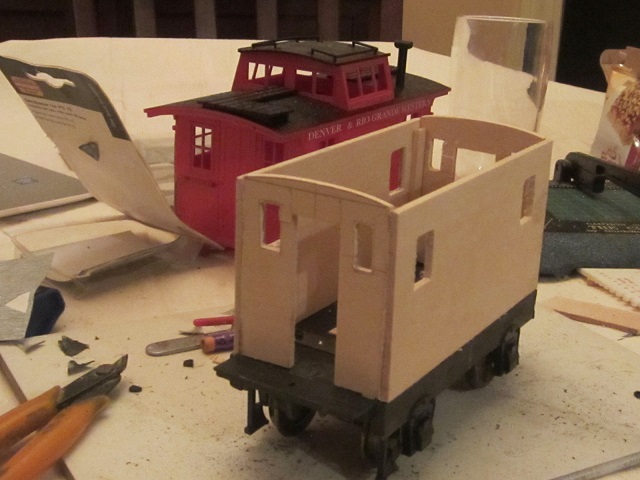

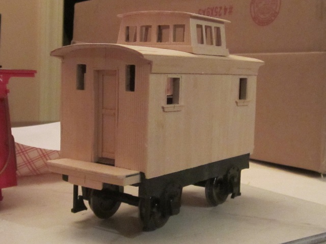

More progress on the caboose.The asbestos removal is taking forever so I still cant get to my spraybooth.

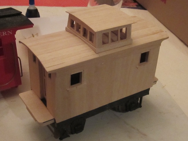

I used basswood sheets to build the body of the caboose.I will cover these with the siding to simulate planking.I am not sure if I will leave the roof with planks or fill it and make it smooth.

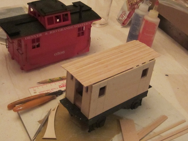

More detail work on the caboose.I put the thin planking siding on the sides and framed the windows and doors. Almost ready to start painting it.I just need to do some filling and sanding.I am going to use filler on the roof to make it smooth and then attach the cupola.
The basement asbestos removal is done , but now I have mold down there so I have to treat that before I can use the spraybooth.
