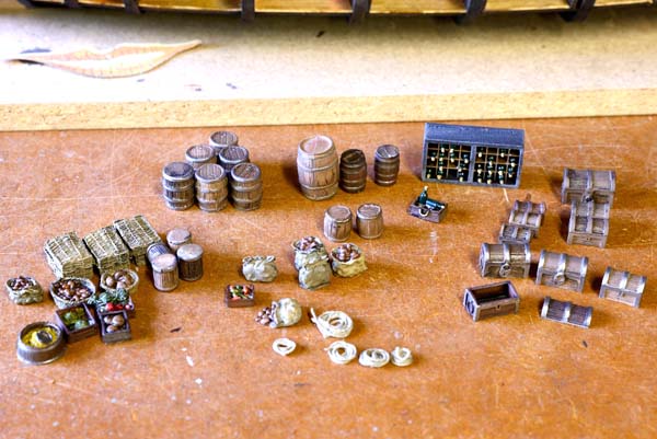

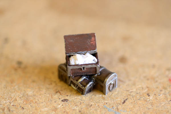

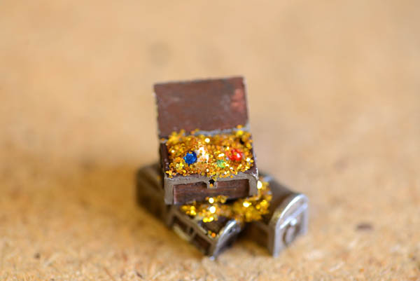

Hi All,
I finished painting barrels & chests. In hindsight, I should have painted steel before I applied the wash.
All the timber basecoat is a mixture of Tamiya XF10 Flat Brown and XF 64 Red Brown. In some instances I mixed in some XF60 Dark Yellow to lighten the Flat Brown a little. The steel on the barrels and chests is GW Boltgun Metal.
The baskets and sacks are a base-coat of Tamiya XF59 Desert Yellow and XF60 Dark Yellow.
My basic method was:
1. Prime using the appropriate aerosol primer, metal primer for the cast bits and plastic primer for the resin parts.
2. Airbrushed with the above colours.
3. Applied black ink wash.
4. Once dry I dry-brushed starting with the original base colour and progressively lighter colours.

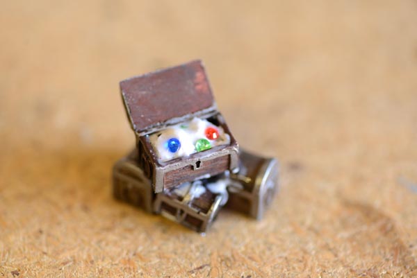

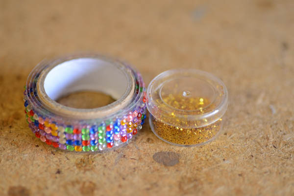

To make the treasure, I filled the open chest with some tissue paper soaked in white glue to form the bulk. The jewels are “Jewel Tape” from a stationary outlet and the gold coins are gold glitter. Try to get the larger diameter glitter as it looks more like gold coins.
I found this idea on Youtube (Keyword ‘D&D treasure pile’)
I must have made almost double the barrels etc, but once installed, the deck still looks a little bare.

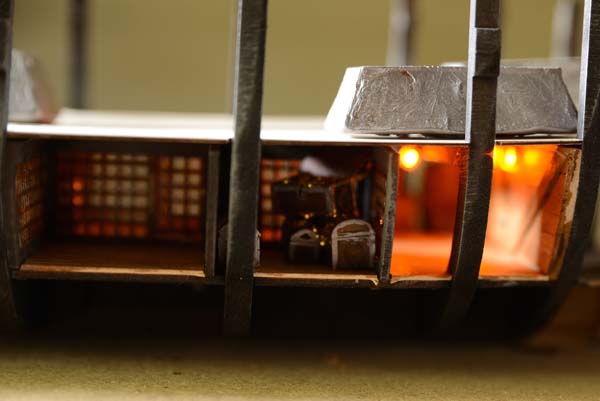

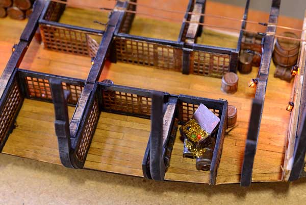

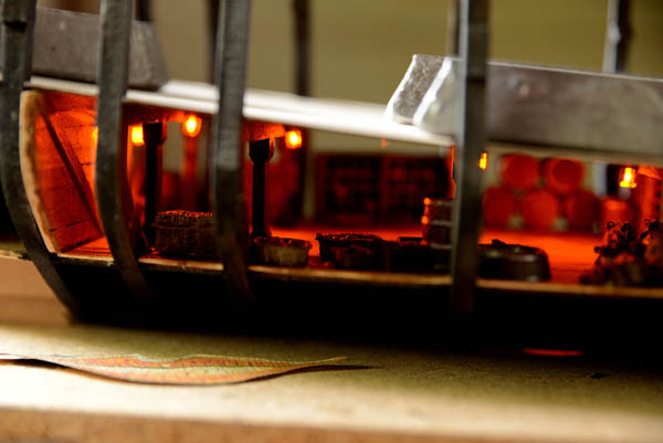

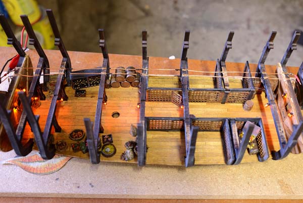

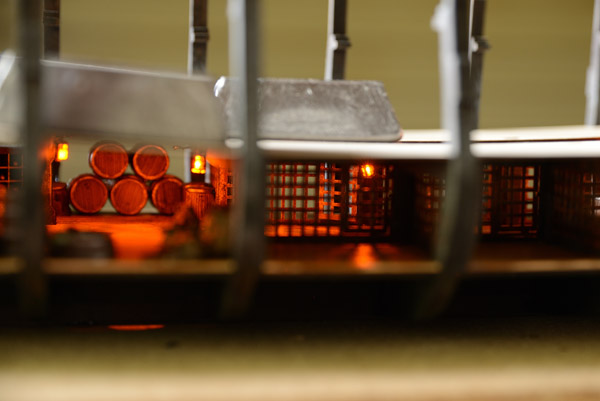

Hi All,
I fitted the upper deck to test lights. It looks like there is sufficient light in the open areas, but the front 3 cells could do with some more light.
Back to the drawing boardCursing
#133 Posted : 20 November 2017 18:00:24
That does look really nice all lighted.
You have made a wonderful job and as to that extra bit of lighting - i am sure you will crack that one.
#134 Posted : 20 November 2017 21:54:16
You're doing a fantastic job with this build, loving the detail.
#135 Posted : 20 November 2017 21:57:27
Looks fantastic Garth. love the lighting effect.
Ian Cool BigGrin Drool
daffy09
#136 Posted : 21 November 2017 02:06:24
Joined: 08/07/2010
Posts: 1,036
Points: 3,086
Love the lighting Garth, cracking job
Happy building
David
#137 Posted : 21 November 2017 07:46:06
Top job with the lighting!
#138 Posted : 21 November 2017 10:13:14
Hi Garth, the lighting is brilliant! Also love the treasure chests full of gold. Great work!Cool
#139 Posted : 21 November 2017 11:22:23
Looking good Garth, excellent detail.....Drool Drool
#140 Posted : 21 November 2017 14:41:33
Really top work Garth BigGrin love the lights and the treasureDrool Drool regards PhilCool
