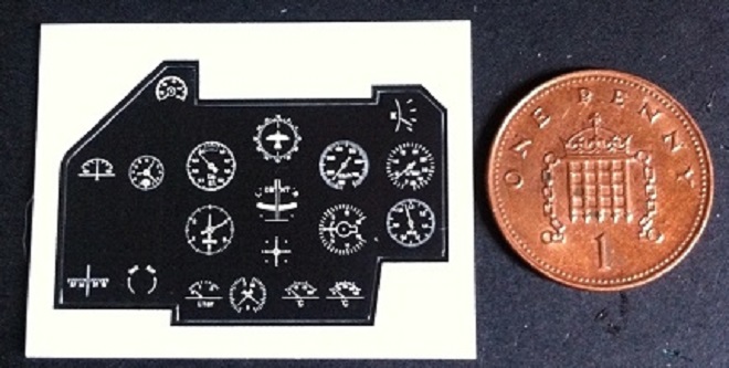

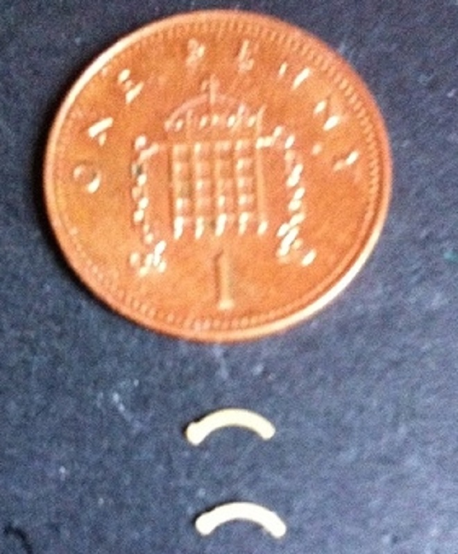

The processes at the moment include making, buttons, switches and control levers for the pilots instrument panel.

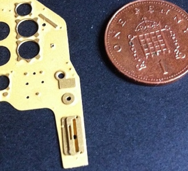

One of the control levers consists of three parts and would fit on a 1p piece approx 20 times, so small in fact that my Iphone is struggling to focus (along with my ageing eyes).
Gonna have a well deserved beer now, then download the latest pics and give you an update later.

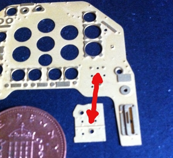

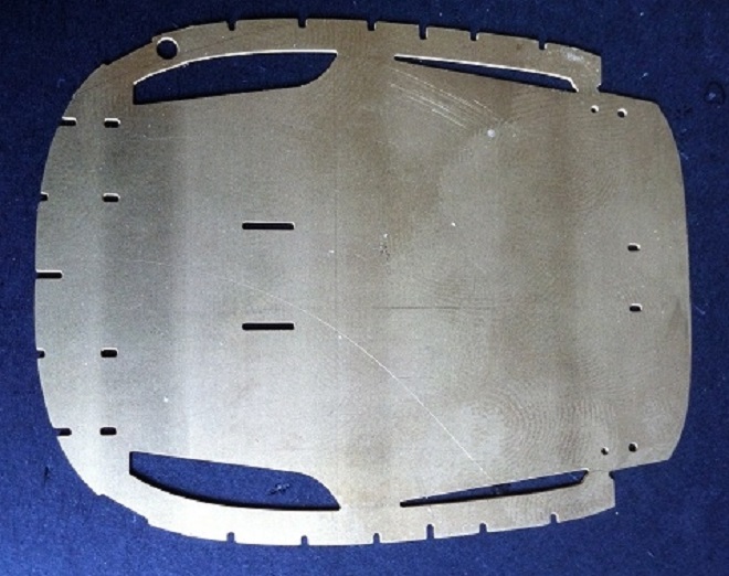

Back tracking to issue 1, you have these parts.Pic 1
As you will have read early on in this build, I kept these parts back as I wanted to make this as complete a build session as I could, for this section of the build.
(An advantage of buying a complete kit as a one off)
So here we go, BigGrin

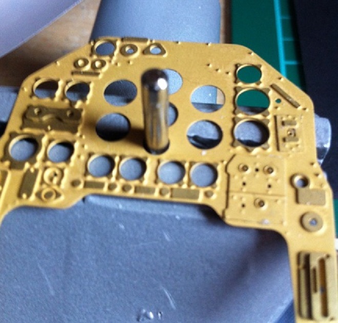

The Pilots Instruments and Fascia Controls:
The biggest part is the base for the top layer of the Fascia.
The smaller parts, build up on the 3D enhancement of the panel.Pic 2
One thing to bear in mind with a lot of these parts, is their orientation.
They have thin/thick, sides/ends so test fit every part before they get anywhere near adhesive. Part in place in Pic 3
With the above part, you will notice that orientation is imperative.
The main slot cut in the part is central, but the smaller slot is higher than the centre line of the part.

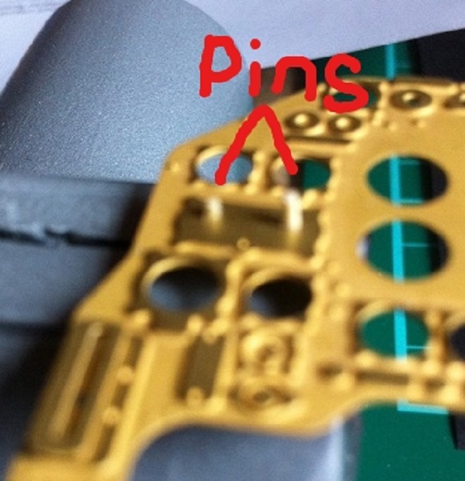

Part fitted. Pic 4

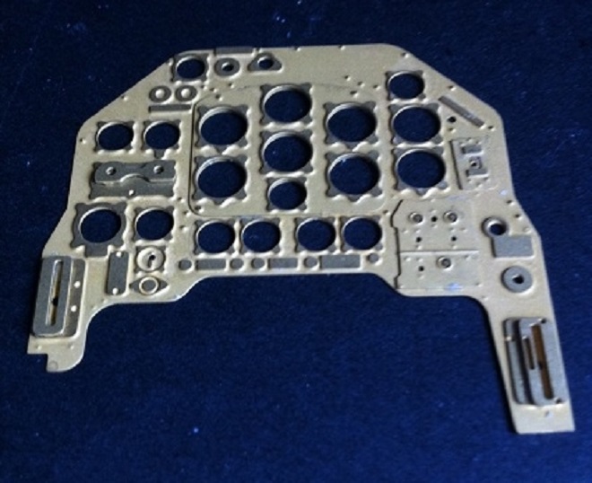

The next part. Pic 5
The lining up of the holes in this part of the base plate needed some thought. Small parts, even smaller holes and super glue.
Answer:
Cocktail sticks. (If Gandale`s left any on the market) Flapper
Put a stick in each hole from underneath and clamp them in a small vice.
Then remove the base plate, you end up with a jig for fitting the next part. CoolPic 6
Made a couple of dry runs to make sure this would work, then placed base plate on jig, applied adhesive to part to be fixed, fitted part and then immediately removed base plate with added part in exact location.
Base plate on jig. Pic 7
So, as said applied glue to next part, put in place then removed base plate immediately from jig.
The result. Pic 8

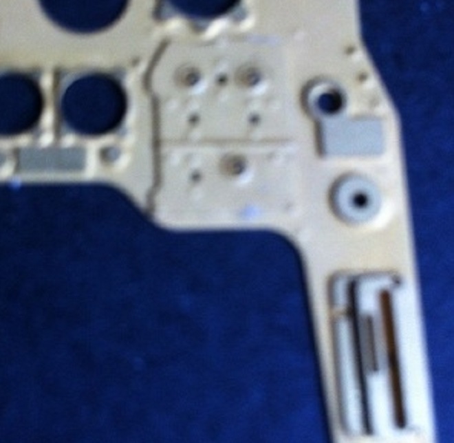

The next part to be added has three locating points, so easiest bit so far. Pic 9
Fitted. Pic 10
The next part to be fitted has seven holes to be lined up with the base plate, Crying another jig required, because these holes are for the clocks/dials so need to be accurate.
The answer was to find a drill bit of the size of the smallest hole and work the jig the same way as before.
The parts. Pic 11
The jig: as before - different size LaughPic 12
The base plate in place. Pic13
The next part was then put in place and the base plate removed from the jig to give this result. Pic 14
OK, so that completes the 3D enhancements for the upper plate of the pilot`s control fascia.

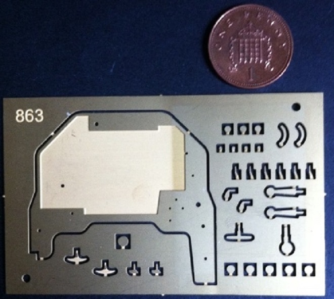

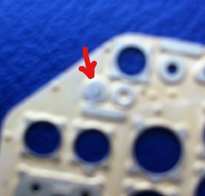

Here`s the parts supplied with this issue.Pic 1-2

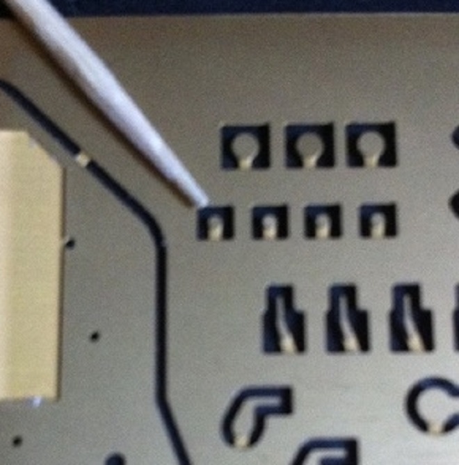

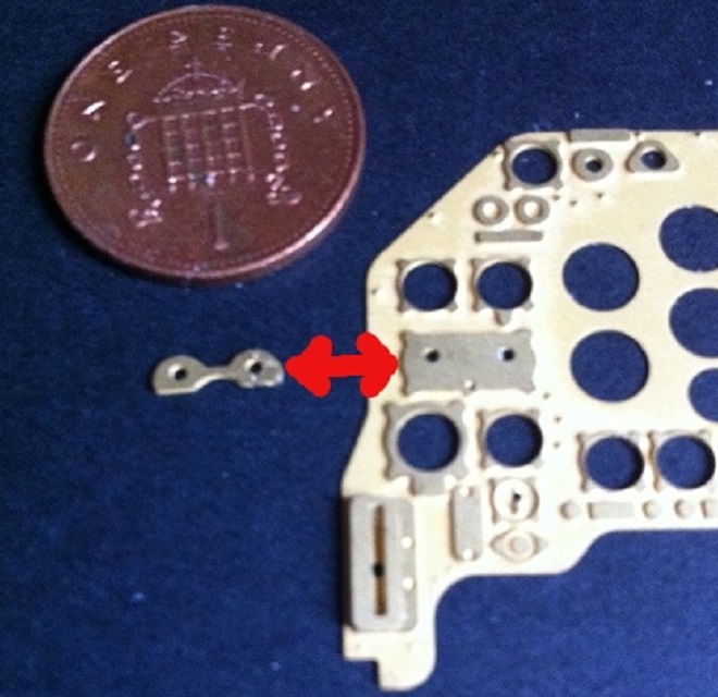

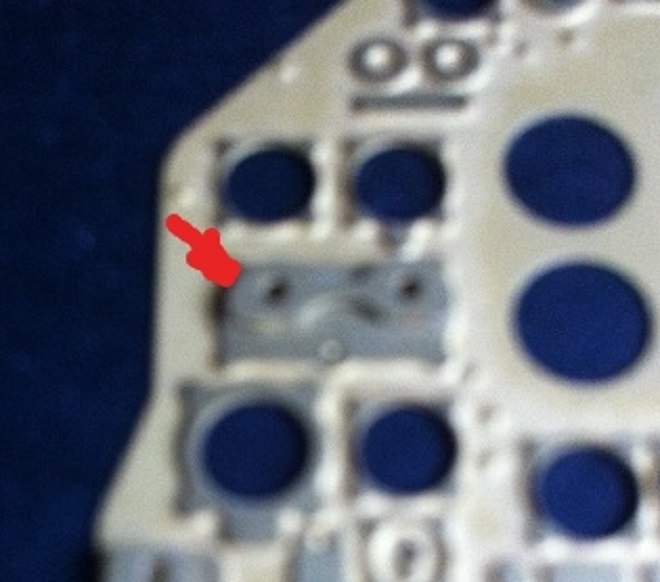

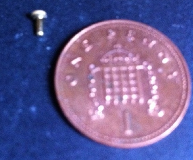

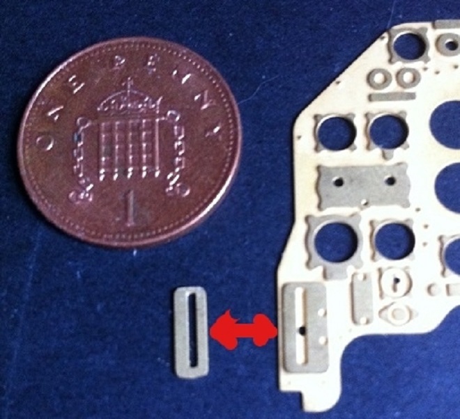

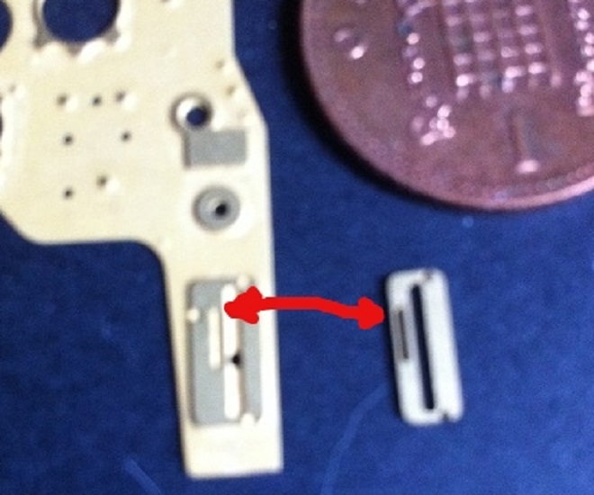

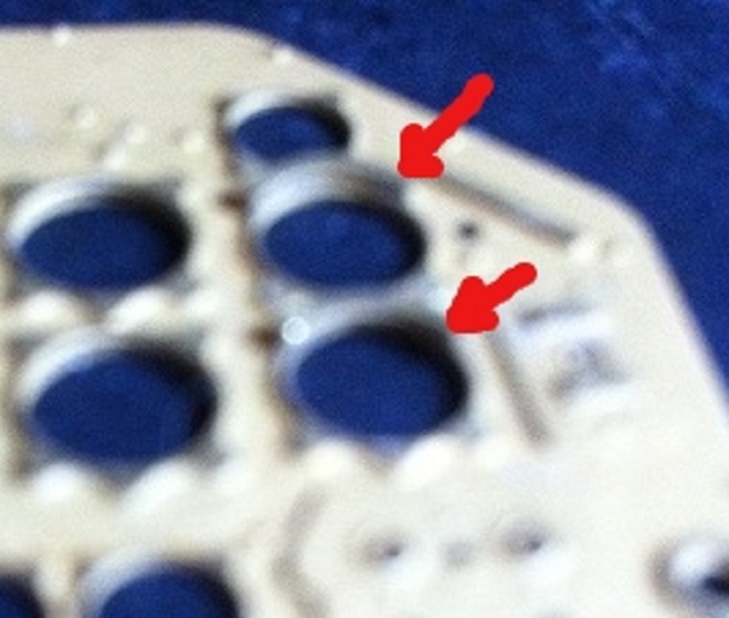

Now having shown these parts, I want to give a close-up of the smallest of parts. There are two of these parts to make push buttons.Pic 3
This is the first kit I have dealt with, where they give you some spare parts, just in case the carpet gremlins get you. LOL LOL.
Ok, now for some serious detail.

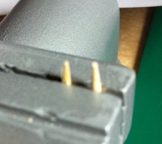

This is one of the buttons in place.(Arrowed cos the pics NAFF)Pic 4

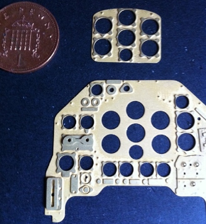

Two of the clock faces now have cowlings fitted above them.
The parts. Pic 5
and fitted. Pic 6

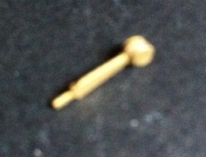

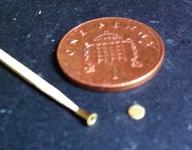

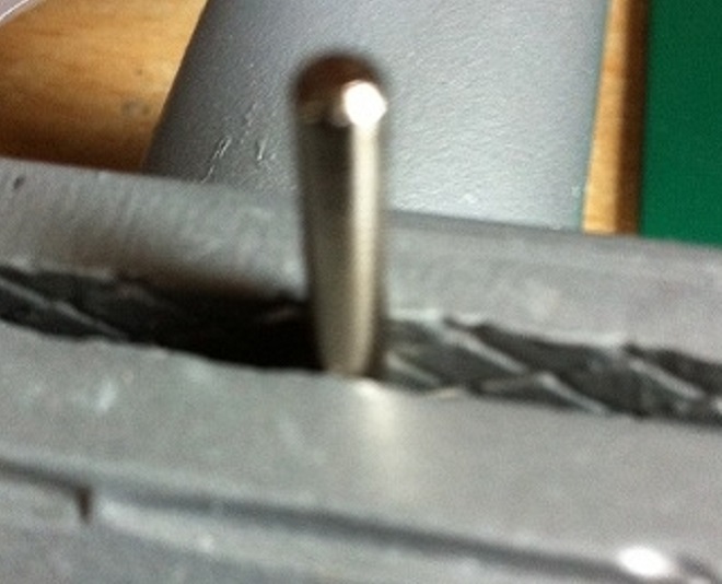

The first is a push button.
The stem of this button is a piece of flared tube, to which a disc is fitted on the end.
To aid the fitting of the disc to the stem, I put the stem on the end of a cocktail stick. Pic 7
Parts together. Pic 8

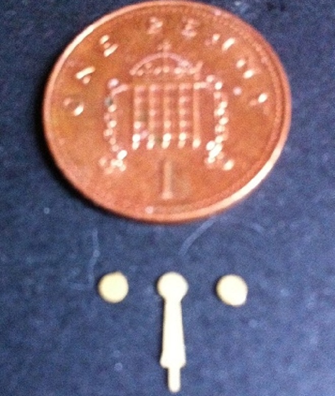

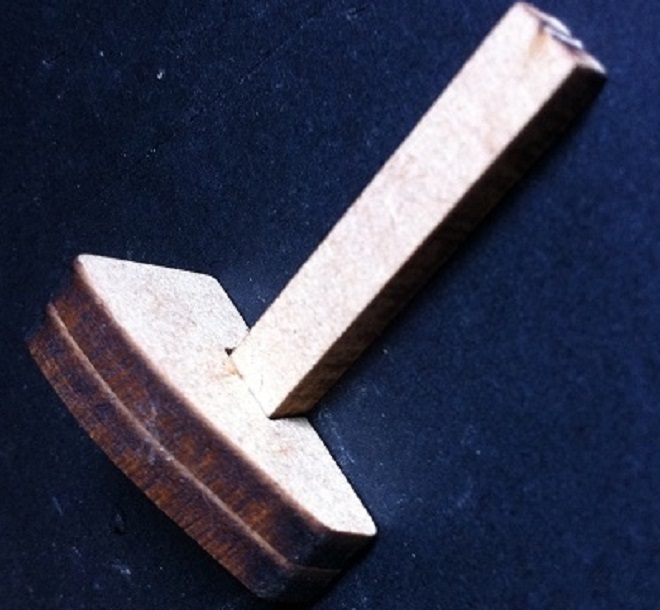

Two control levers are now made from three parts each, (identical so will only show one).
One disc to be added to each side of the lever to enhance the control handle. Pic 9
The finished item. Pic 10

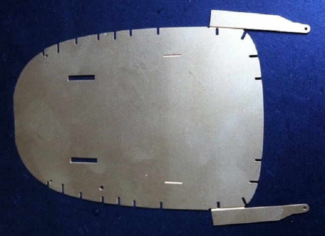

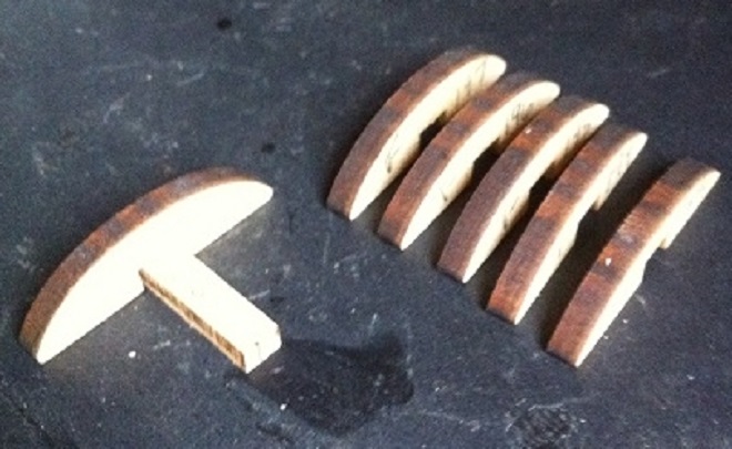

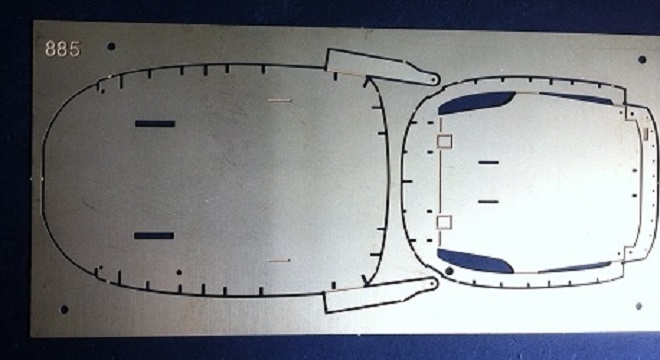

Issue 19, provides two section bulk heads for the ends of the cockpit area. Pic 1
Here`s two pics of the parts out of the fret.Pics 2-3
Now these two parts, according to the instructions, are attached to the air frame and then painted .
"Don`t Think this will be easy".
So, "suggestion" is to paint the inside face of these parts and then, fit them in place and paint the outside afterwards.
Results to show later, but I think worthwhile.

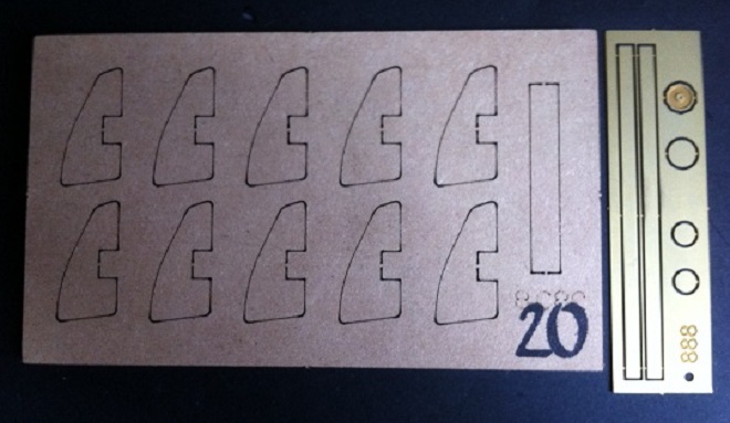

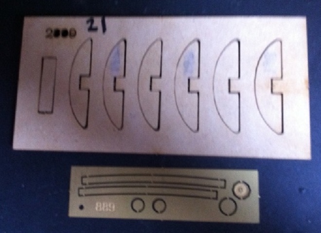

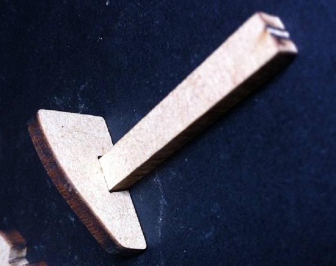

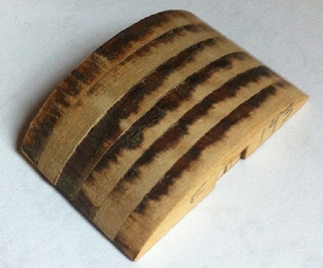

Issue 20 starts the construction of one of the two oil tanks.
Parts: Pic 4

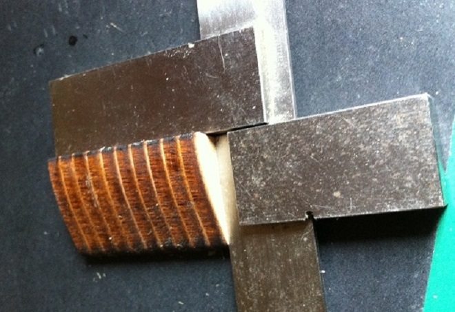

The MDF sections, form up against the straight former.
Stage pics as shown. Pics 5-6
The end shape comes out like this, when framed up between two mini set squares.Pic 7
The second oil tank (issue 21) is made up under the same circumstances.
The parts. Pic 8
These are made up the same as parts in issue 20. Pic 9
Take care to use these parts as they come out of the fret. The edges are tapered, and the tank shape is tapered from one end to the other.Pic 10
