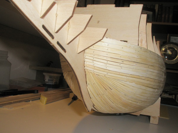

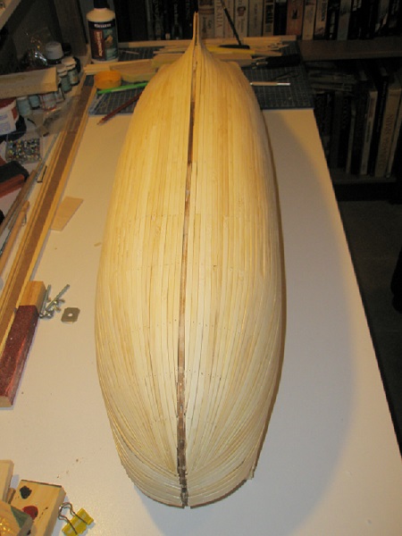

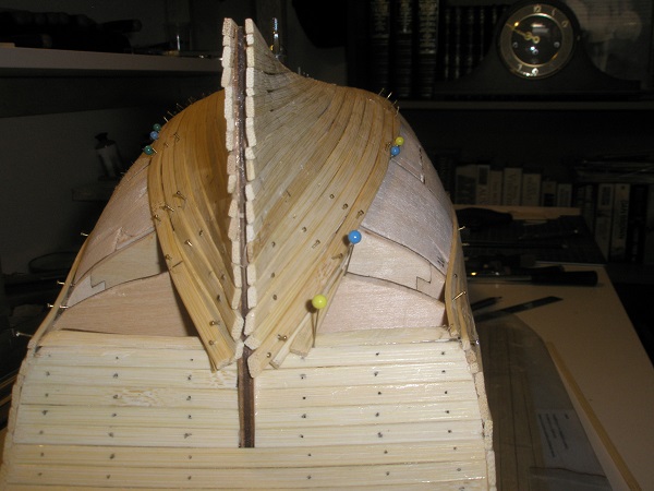

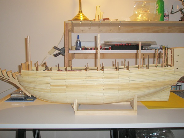

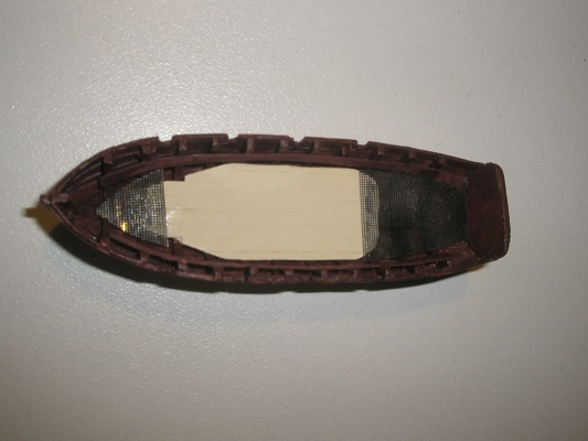

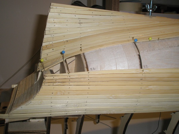

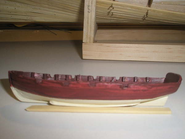

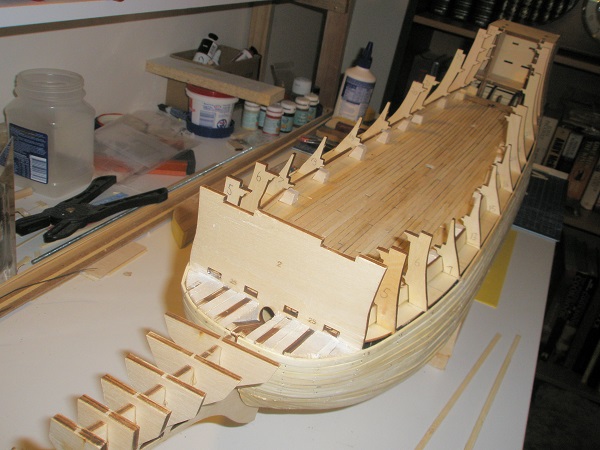

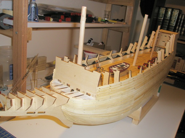

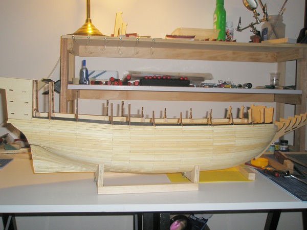

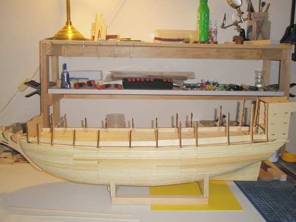

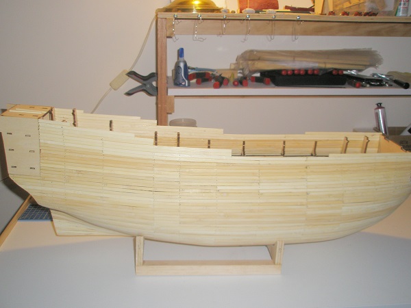

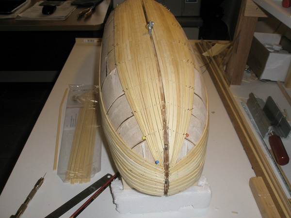

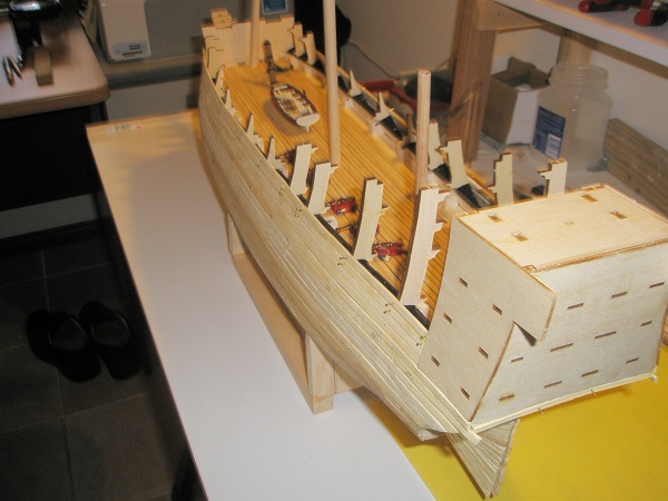

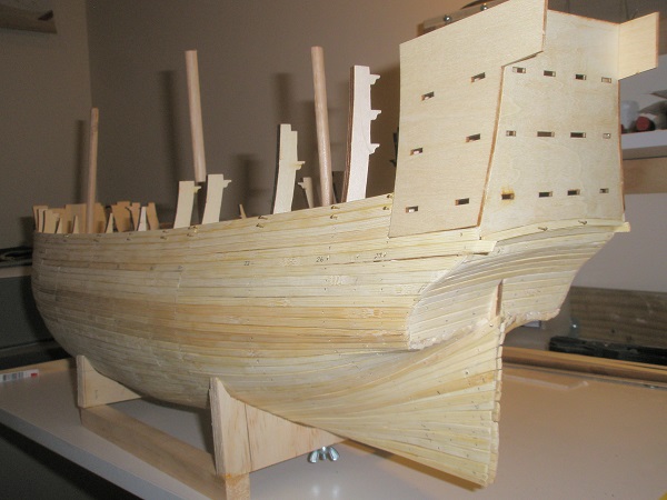

Hi All
Progress for August 2014 - with some pictures;
* Repainted the ships boat, blackened mesh and fitted, assembled duck boards outside the boat, painted, then installed;
* Finished laying trial deck planking to middle deck, leaving plenty of space for dummy cannon supports. Will clear lacquer prior to fitting third deck;
* Continued hull planking up to issue 25. Got the plank ends up the stern post in a fairly straight line. Made a bit of a blue with the bow planking - the first 4 planks from the false keel are finished too long, taking up too much space towards the bows - consequently I ran out of room at the first bow former. I've compromised by ending bottom planks along the last upper hull plank...Cool Cool
Overall I'm happy with my planking, but any comments or advice will be appreciated...BigGrin BigGrin
JohnP

#127 Posted : 01 September 2014 22:28:40
Hi John, coming along very nicely and don't worry too much about running out of room at the bow for the planks, you're doing just fine.... remember, this layer is about getting a nice smooth shape to the hull, clean lines all ready for the final layer of planks which of course is the most important..... Cool Cool .. Deck planking looking great, very nice work there... Keep posting those pics.... Cool Cool
George1
#128 Posted : 02 September 2014 02:01:22
Joined: 16/03/2014
Posts: 516
Points: 1,563
Hi John. BigGrin
Everything looking good mate. Cool Cool
Looks like you've got deck planking under control too. Cool Cool
Like Alan said you'll see where you need to put in pointed strakes to alleviate the curvature from bow to stern as that gap closes. BigGrin
The only assistance I can offer is watch when the gap closes at rib 26 or thereabouts to the stern to ensure planks close off that gap. I nearly made a mistake when following the narrowing of three planks at the stern as shown in Official Build as I had the start of the taper bow side of rib 26 and would have left a skinny gap at that point where I should have started the taper stern side of rib 26 and the three planks of full width would have closed it off perfectly. Better that you might have to narrow a plank there to fit than the planks not filling or you'll be having to have pointed strakes opposite one another. BigGrin
Of course as Alan says the most important thing is filling in with this first layer of planks.
George

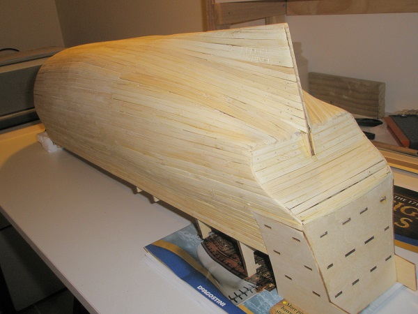

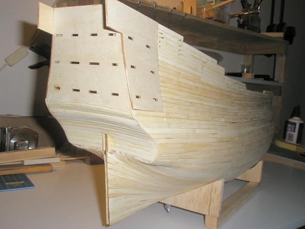

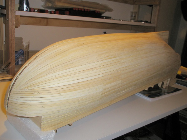

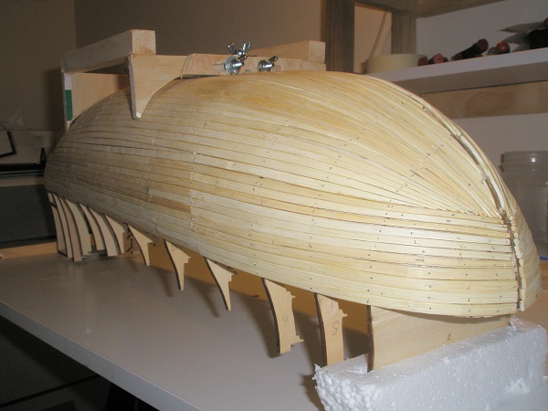

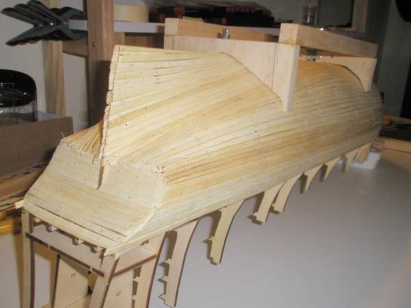

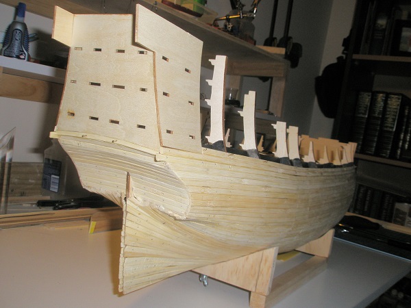

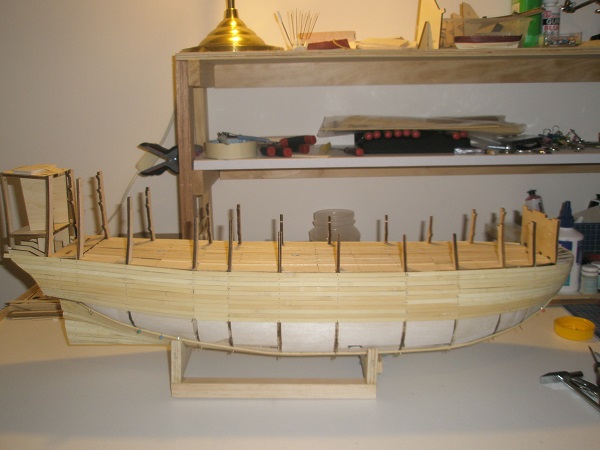

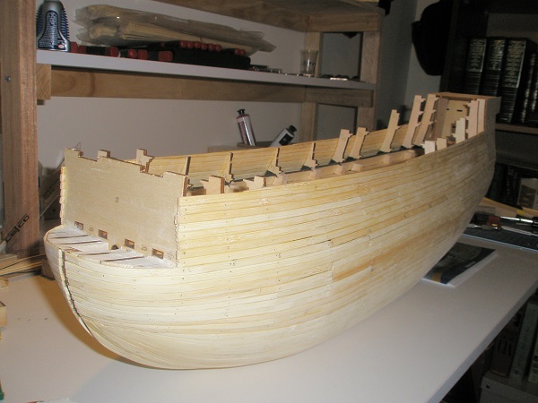

Hi Everyone - I'm baaa-aaack!
Sorry I've been AWOL for a while but my 14 year old wind-up lap top gave up the ghost a couple of months ago and I was loathe to go out and buy one of these new- fangled things with different op systems...Crying
Something about teaching old dogs new tricks...not possible in my case either...BigGrin BigGrin. Anyhow, the wife eventually went out and bought me a new one, so then I was FORCED to bite the bullet and learn my way around this new device. This has taken a bit more time, and then I had trouble with passwords in logging on to this forum...Mad Mad
Notwithstanding the foregoing trials and tribulations, I have been pottering along with my SotS build and have attached some pics of my progress to date.
BTW, issue 21 never showed up but I managed quite well without it materially speaking, and still have 3 unopened packs of bamboo on completion of hull plankingCool Cool
Kind regards to all
JohnP

BigGrin Welcome back to the forum John . Lovely work on the planking m8 ThumpUp Rgd Martyn

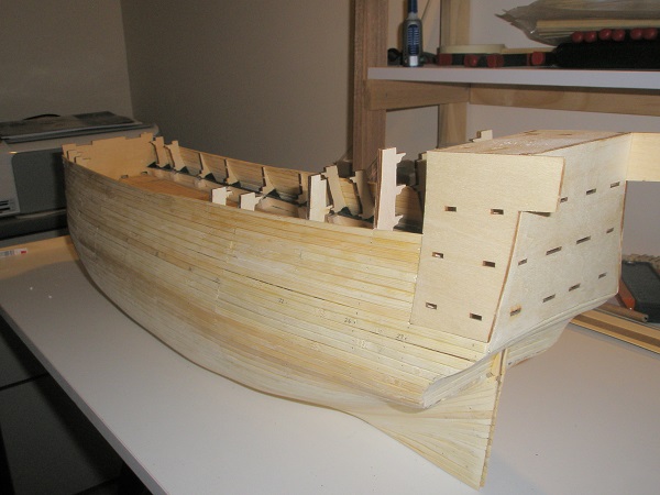

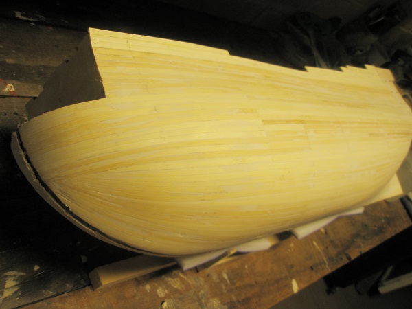

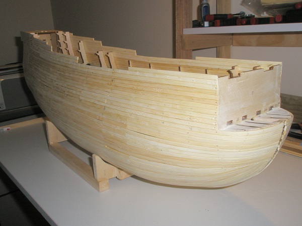

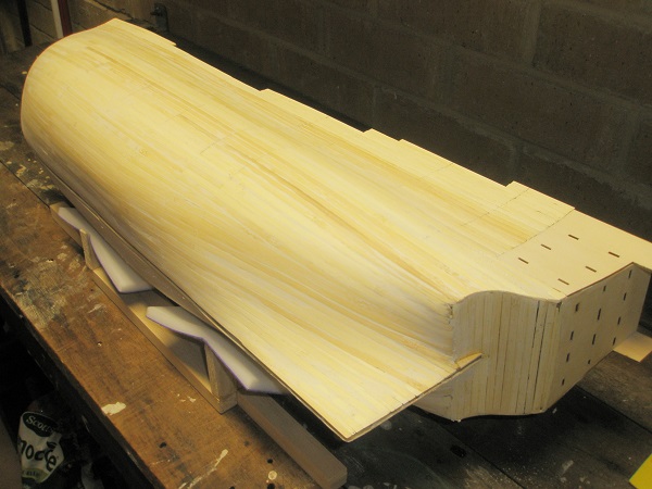

Hi All

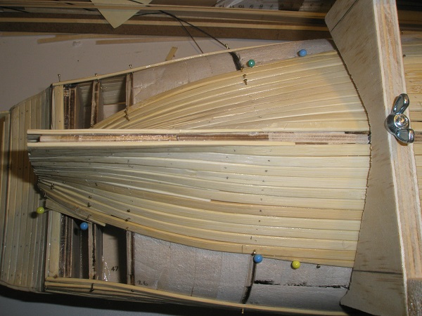

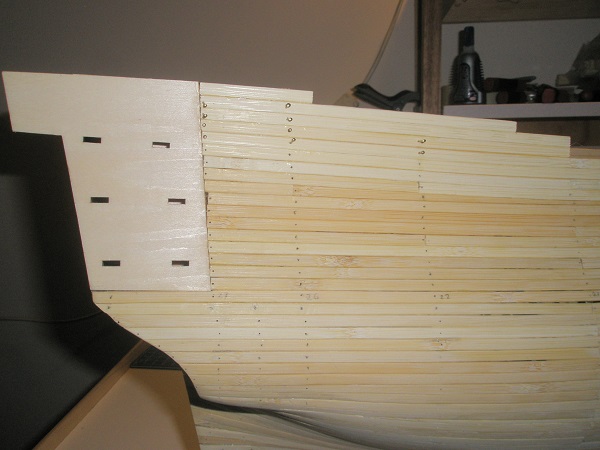

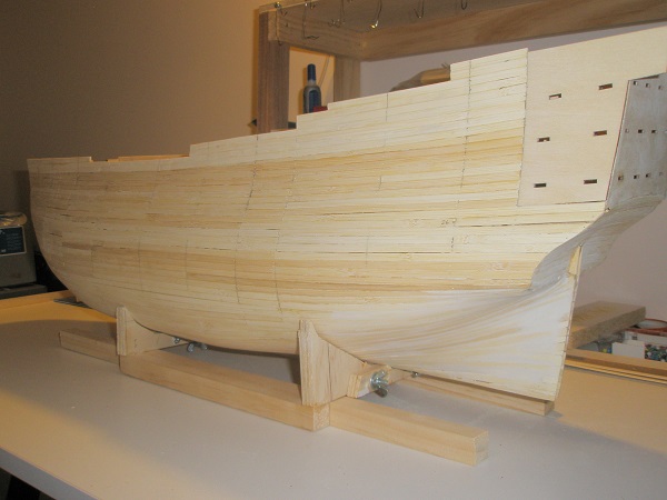

Below are some pics showing November Progress with completion of hull planking...Cool
The last picture shows detail of planks ending at the Starboard side gallery foundation plate. When I reached the top there was room only for one short 50mm piece whereas instruction says there should be two pieces. But if I put the second piece in, it would extend well beyond the top of the stern gallery...
There are 16 layers of planks from the bottom corner of the gallery to the top - the same as in the magazine and Mr T's official build diary, so I'm not sure how this situation occurred...Blushing
So can anyone advise if there would be a detrimental effect to the future build by omitting the second short piece - bearing in mind there would be only half the perpendicular elevation at the forward end of the short piece...Confused Confused
Rgds to All
JohnP

#134 Posted : 14 November 2014 14:58:38
hi john, very nice job there, keep up the good work.Cool BigGrin
#135 Posted : 14 November 2014 19:48:39
Hi John, lovely work and its great to see you back publishing your progress...Cool Cool .. Regarding your question, it really does not matter if the planks go above the stern gallery section as later in the build you will do some marking and some trimming back of the planks to give you the overall height... Variations in this part of the build is very common so just carry on as you are doing and add the extra plank....Cool Cool
Hope this helps however, any queries then let me know.

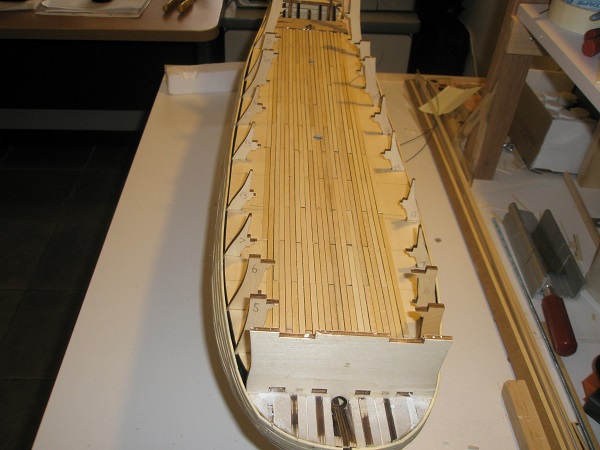

Hi Alan
Yes it's good to be back on board and thanks for the compliment.BigGrin
Thanks also for the - as always - sound advice re the second short plank and which has been followed today...It doesn't look too bad...Cool
You will note I have clear lacquered the middle deck planking in accordance with your earlier advice and it looks really good. A bit orangey in the photo but that is just the artificial light I have in here. The colour is actually very similar to the hull planking - which is how I wanted it...BigGrin Cool
Kind regards

#139 Posted : 15 November 2014 23:23:50
Hi John, pleased the advice worked out for you.... Decking looks great, a job well done..... Cool Cool

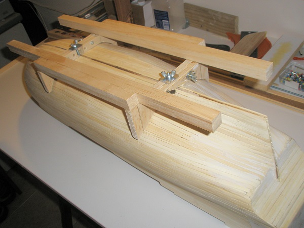

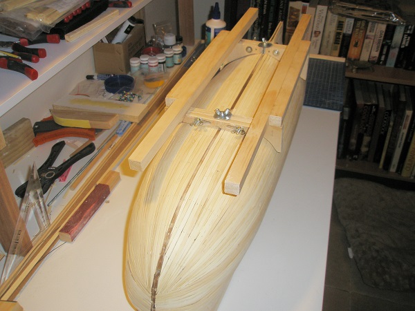

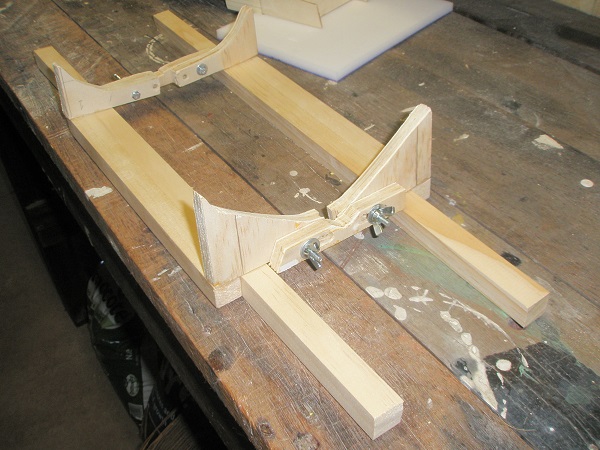

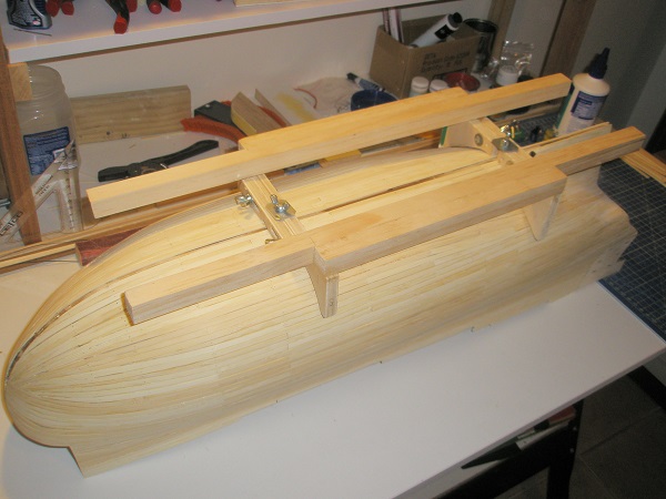

Hi Everyone
Collected issue 38 from the newsagent today - at last - a change of scenery!!!Laugh Laugh - but alas - I can't get to it yet as I still have the procedures of issues 35 and 36 to carry out...Blink
So not a lot of further progress for November, I was obliged to modify my build cradle as it was unstable whenever weight/pressure was applied to the bows or stern and tended to tip downwards...Crying Fixed that with two extension bars added...BigGrin
At the same time installed additional screws to allow for height leveling adjustment on all quarters, and extend width of cradle to accommodate thickness of second layer of planking and protective cushioning...Cool
I've sanded and filled one side of the hull and quite happy with the result - smooth as a baby's bum now...Laugh
Kind regards to All
JohnP
