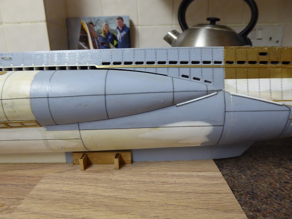

Working forward, I continued adding weld lines, horizontal and vertical to the starboard side.
#1362 Posted : 19 October 2017 20:22:44
Continuing working forward on the starboard side.
#1363 Posted : 19 October 2017 20:24:33
I then applied vertical and horizontal rivets to the starboard, amidships free flood holes.
#1364 Posted : 19 October 2017 20:25:27
Followed by the same section on the port side.

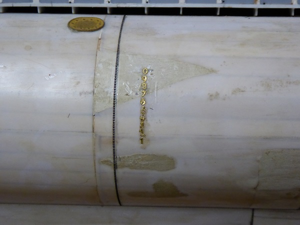

#1366 Posted : 19 October 2017 20:33:22
At this point, before I continued with the weld lines on the port saddle tank, i marked out the divisions for the amidships draught marks. The measurements were the same for the other draught marks; 104mm from the bottom of the keel which equates to 50 decimetres [5 meters] on the actual U-boat.
The attached photo shows some electrical tape I used as a marker with 2mm divisions, stuck to the hull with the top division aligned with a mark on the hull at 104mm. The 2mm divisions equate to the correct 10cm division between numbers on the actual boats. This top mark will be numbered as 'zero' representing 50 decimetres, with the number nine underneath which represents 49 decimetres and so down to 'one'.

At this point my camera returned from being serviced, so no more rubbish photos from my phone.Cool
This photo shows the completed, brass, photo-etched numbers.

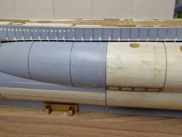

Adding the vertical weld lines to the port, saddle tank.
#1370 Posted : 19 October 2017 20:38:05
Continuing with the vertical weld lines.
#1371 Posted : 19 October 2017 20:39:07
Horizontal weld lines being added to the port, saddle tank.
#1372 Posted : 19 October 2017 20:39:28
Looks brilliant Phil, even before adding paint! Now go to the fridge and grab a beer to celebrate the end of this riveting marathon, you deserve it and then grab another tomorrow to celebrate your ModelSpace 1st Birthday!! Cool ThumpUp
Can't wait to see the next stages unfold - very well done. Drool Drool
#1373 Posted : 19 October 2017 20:40:31
Continuing aft with the horizontal weld lines.

The last of the horizontal weld lines added to the rear of the port, saddle tank.
#1376 Posted : 19 October 2017 20:44:44
A view of the port saddle tank.

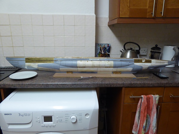

#1377 Posted : 19 October 2017 20:45:54
Port side view of U230! Make the most of this photo as it's the last time you will see it like this!!Cool

Well everyone, that concludes this weeks update of my U230 U-boat build. A major milestone has been achieved and in anticipation I have booked Monday and Tuesday off next week to apply the paint!BigGrin
No weathering at this stage, just undercoating, top coat in three shades of grey and matt varnish as a clear coat. More details on paint in my next update.
So, a few stats:
It's taken over three years to get to this point where the boat is ready for paint.Blink
It's taken over 10 weeks to complete the rivets and weld lines.Blink Blink
I used, <drum roll please> 6290 rivets!!!!!!!!!!!Blink Blink
....and 7.4 metres [24 feet] of weld lines!!!!!!!!!Blink Blink
Phew!!!LOL
Thank you all for your comments throughout, have a great weekend and happy modelling; with less rivets!LOL
Phil W.BigGrin
