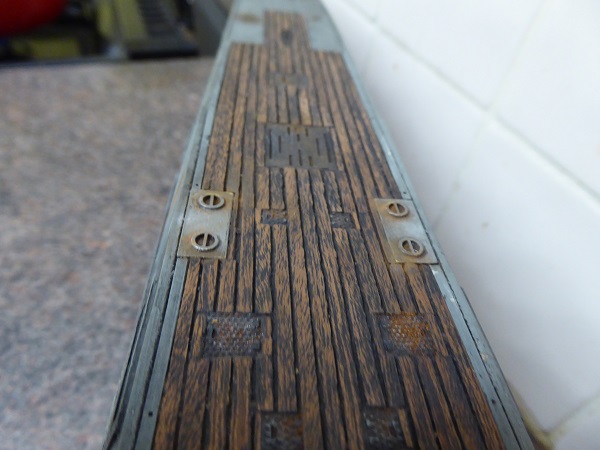

This photo shows the end of the decking.

I'm pretty happy with the way the decking has turned, It's blended nicely and has a 'worn' look without being over the top.
Thanks for looking in, have a great weekend, weather permitting and happy modelling!BigGrin

Decking looks amazing Phil, so very authentic.... Superb work....Love Love Love

That decking looks amazing Phil. The weathering is spot on.Love Love Drool Drool

BigGrin Deck looks good to me and nice work as always Phil

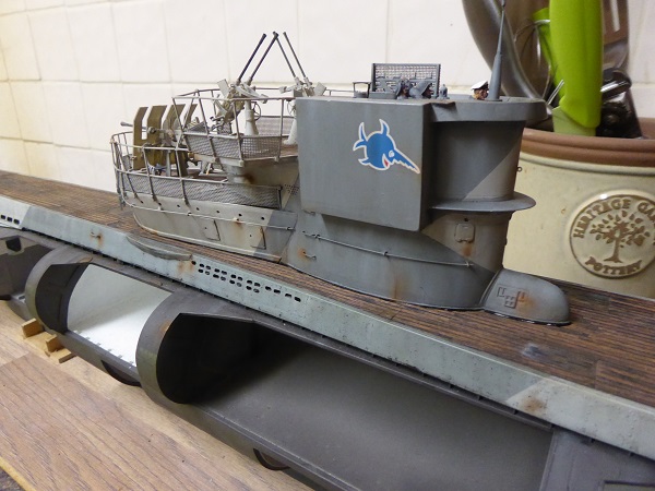

To start this post i've included some photos showing the conning tower in situ.
#1270 Posted : 22 November 2019 08:41:06

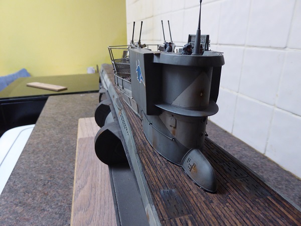

Front view.
#1271 Posted : 22 November 2019 08:42:09

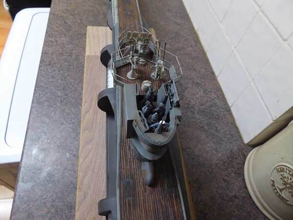

From above.
#1272 Posted : 22 November 2019 08:42:41

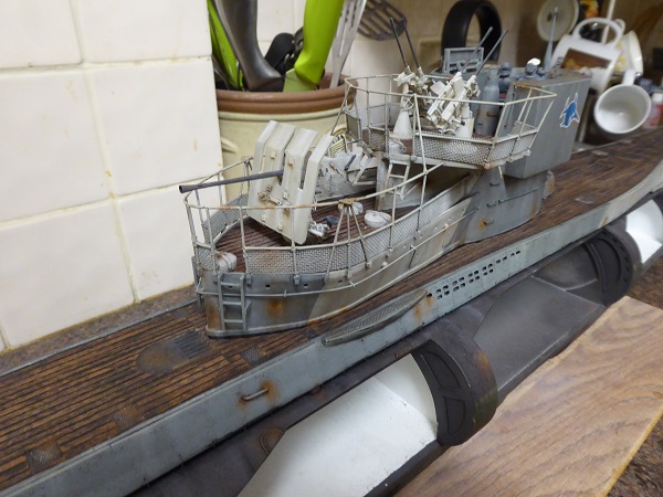

Looking forward.

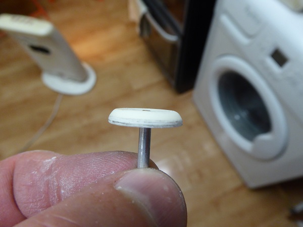

Now it's time to start working on the internal details. I'm starting with the aft torpedo compartment which requires lots of scratch building and will take several weeks.
The first job was to study photos of the real compartment on U995. This took a whole evening as I familiarised myself with all the equipment.
I started with making the rear torpedo tube and door. The aluminium tube was a left over piece after i finished installing the torpedo tubes in the bow back in 2016.

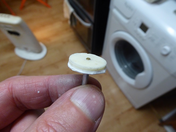

The door was made up of several layers of plastic sheet, glued together and a whole drilled through so I could fit a shaft. See attached photo.

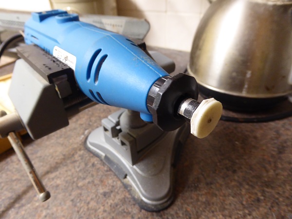

#1274 Posted : 22 November 2019 08:52:35
The shaft allowed me to fit it to the chuck on the Dremel, itself being mounted in a mini vice, so I could use it like a lathe.
#1275 Posted : 22 November 2019 08:54:04
I could then shape the torpedo tube rear door to a profile using files and sand paper while it span around in the chuck.
#1276 Posted : 22 November 2019 08:55:11

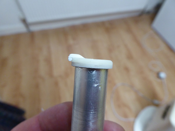

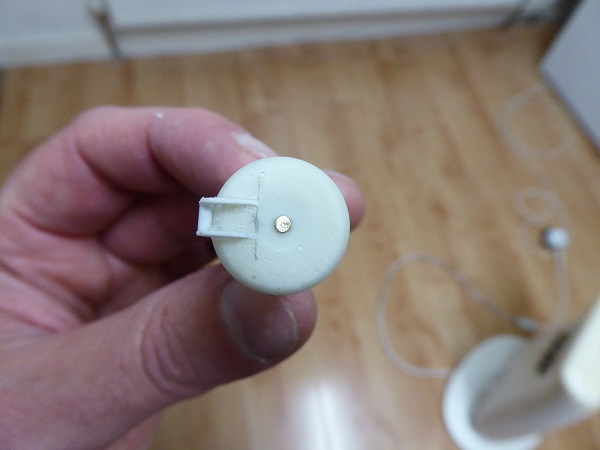

The next job was to make the hinges. I used plastic rod and sheet off cuts to fashion the shapes.
#1277 Posted : 22 November 2019 08:56:13
A different view.
#1278 Posted : 22 November 2019 08:56:53
From another angle.

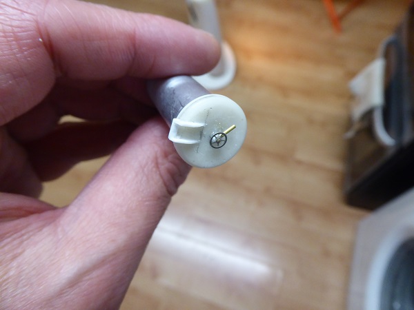

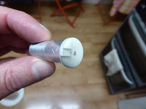

#1279 Posted : 22 November 2019 08:59:00

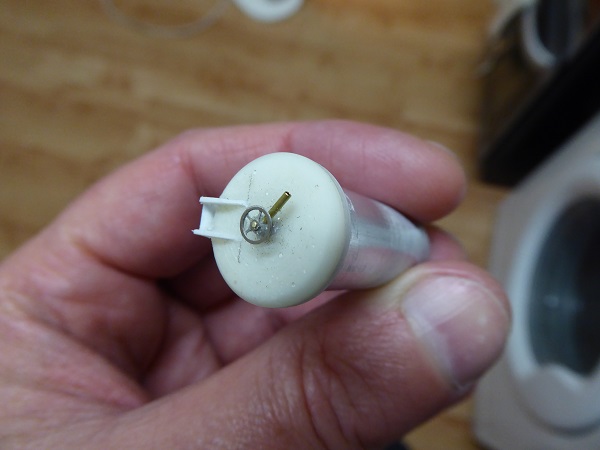

I then made the locking lever and fitted an after-market, etched brass valve hand wheel to represent the drain valve.
#1280 Posted : 22 November 2019 09:00:03
A different view.
