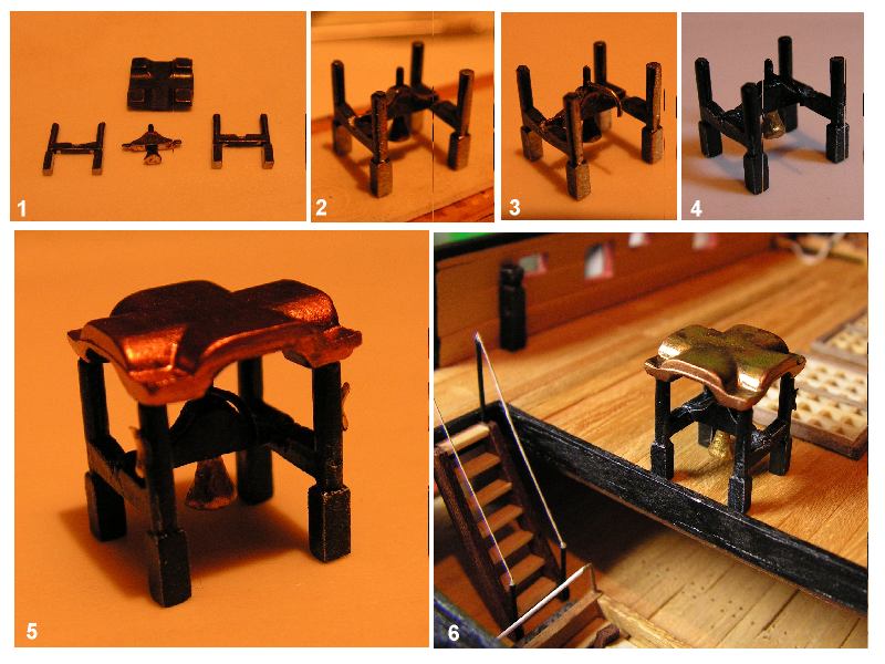

OK, here's another little sub-assembly I got on with over the weekend - the Belfrey.
Below the photos show the construction of this little project. Pic 1 is the four components as supplied straight from the kit, at the top is the roof section (upside down) with the two side frames and the combined roll bar and bell in the centre. All the pieces are made from the same bronze like metal castings as the cannons etc and have just been filed down a little to remove the mould lines.
Pic 2 shows the frame assembly superglued together and Pic 3 is the same shot after the bell pull rod has been added from thin brass wire.
Pic 4 is the assembly after a painting with Admiralty Dull Black, dry brushing with white and the bell painted with Humbrol Acryllic Brass.
The large Pic 5 is the completed Belfry with the roof glued on and two tiny little cleats again made from very thin brass wire. Although both the DeAg and the Jotika kits have a black roof to this structure, one of the many photos of the Vic that I've downloaded over the years shows the Belfrey roof in a weathered verdigris green implying that the roof may be copper plated. I like the idea of that bit of colour on the foc'sl so I've gone for painting the roof with Admiralty Copper. After I had let the copper dry (so I thought!) I then mixed up a wash of Citidel Billious Green (Yeah, I know!BigGrin ) and a touch of Regal Blue and tried to give it a little weathering effect to dull the shiny copper down a little. Unfortunately the copper immediately dissolved but it was dulled down a bit so I added a very light touch of black in the corners of the roof and it doesn't look too bad at all.
The final pic shows the completed Belfrey just standing in place, for the final placement I'll need to cut a pair of slots into the black surround to sit the legs of the Belfrey in as they come right up to the edge of the waist. One thing I did notice with this piece of the Vic is that in both my reference books the drawings show the crank arm to ring the bell pointing towards the stern but the photo of the real thing shows the arm pointing towards the bow I can see no logical reason for putting the bell pull in the one area of the deck that is positively dangerous to get at so I've gone with the arm pointing forward. (Mind you, if the Belfrey was anything like the one on the Surprise in the movie, it probably wasn't there that long into the battle!!)Blink

Robin

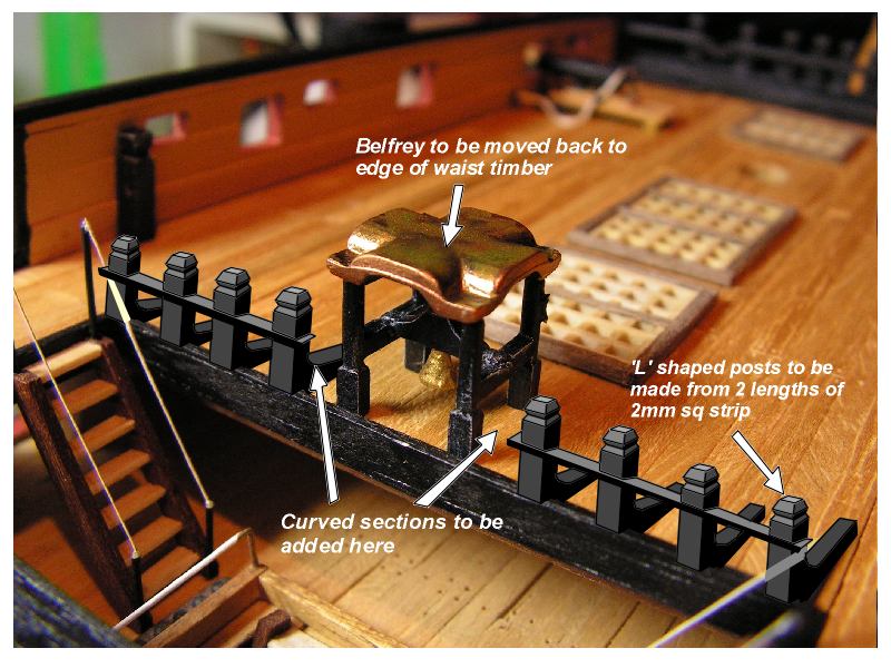

The next thing to complete will be the barricade which runs each side of the Belfrey. It should hopefully look something like this (God those pieces are proving difficult to carve and the other barricade is even worse!!) BigGrin
Robin

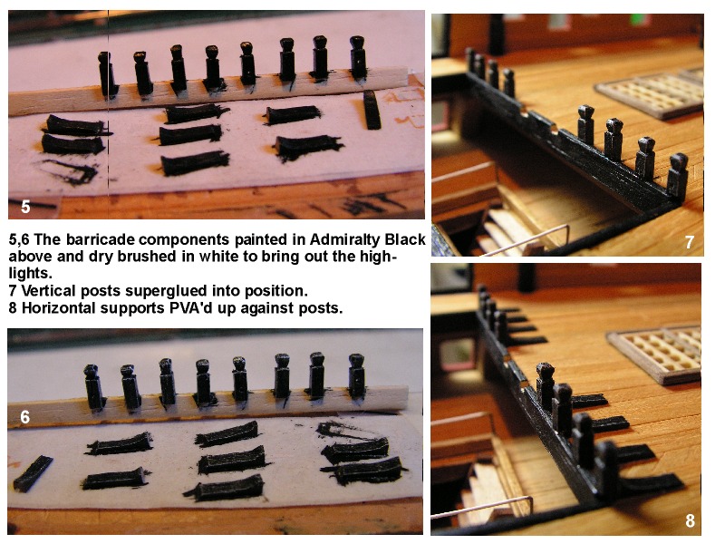

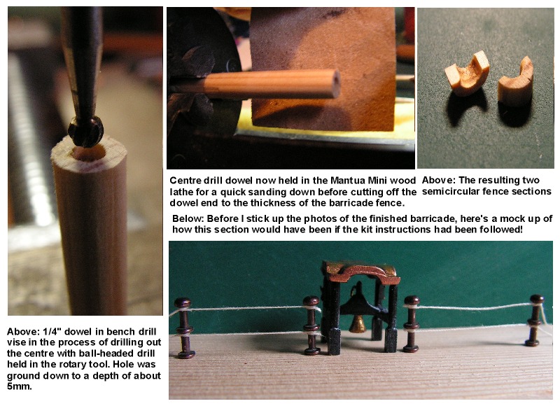

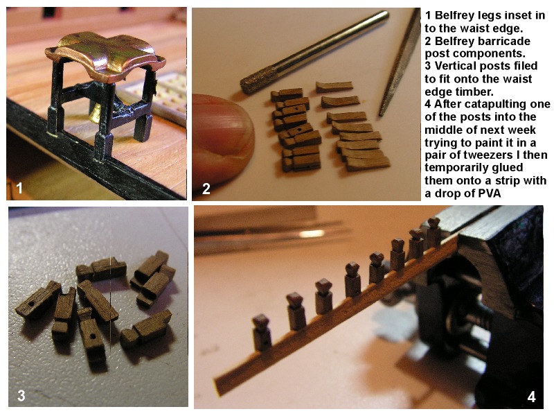

OK, here's the second part of the great (but frustratingly fiddly) Belfrey and it's Barricade. It's looking pretty good at the moment and part three will finish off this section shortly with the final addition of the 'shelf' (I've had three goes at it so far but I WILL get the cut outs right eventually!)Blushing
Incidentally, I did manage to find the tiny little post which sprung out of the tweezers after a very detailed search of the work top, it didn't vanish down the waist steps as I first thought!
Hopefully back soon.
Robin

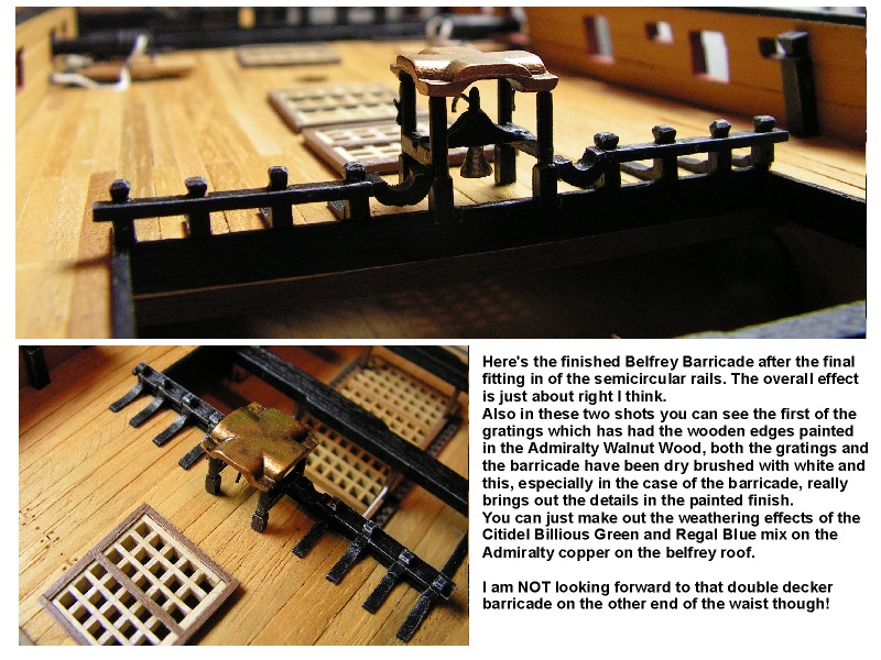

Here then is the final segment of the Belfrey Barricade! Now this section is complete I think I'll work alongside the last two cannon and make up the belaying racks and stove chimney together with making up the tackle for the two carronades and then, I can begin working back (that means the aft barricade!) Crying
It's all good fun though and is (still) very enjoyable! Blink

Robin
