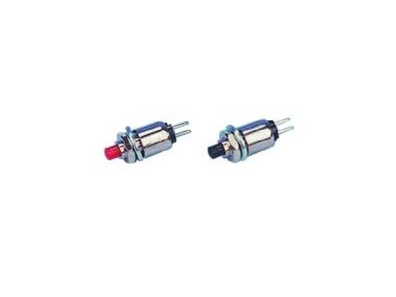

Does the Sovereign have a row or two of dummy barrel cannons glued into a black painted false 'wall' behind the gun port like the Victory? If so you could try this approach with the small push switches below. You would just need to drill out the false wall big enough to take the shaft of the switch which would then be secured in place by its own little nuts (then painted matt black) and then, (the sneaky bit) drill a hole into the actual push button (probably better before fixing the switch in! Blushing ) just big enough to take the pin on the back of the cannon barrel, then epoxy the barrel into that hole. All you need to do to switch the lighting on and off is to push that particular cannon in. (If you do use a push switch make sure you get a 'locking' one.ie, stays off or on after pushing it, 'momentary' switches only stay on as long as the switch is kept pushed in!)
Probably more silly ideas to follow!BigGrin
Robin
PS these switches were about £1.80 in Maplins

Thanks robin, infact i have one of those very switches. I think that idea was brought up in another post or something, great idea too would be perfect! though by the time we get the cannons most of the ship would already be covered up, i think im looking for a solution i can get covered before we finish the hull :) because by then theres no going back on other solutions seeing as thats where all the wires are Blink my most possible solution would to simply paint the switch white and hope its camouflaged with the hull, and seeing as there will be a second layer to the lower hull it may not stick out as far. BigGrin

That switch should be fine Admiral, by the sound of it your push button switch is a 'momentary push to make' type so it wouldn't have been suitable for an on/off.
