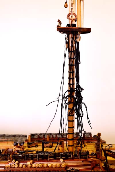

Finally started the rigging this weekend. Fitted the fore mast shrouds. Thanks must go to Stevie for his method of fitting the Deadeyes.
I tied a slip not on each pair of shrouds, I'll label them once the Deadeyes are fitted.

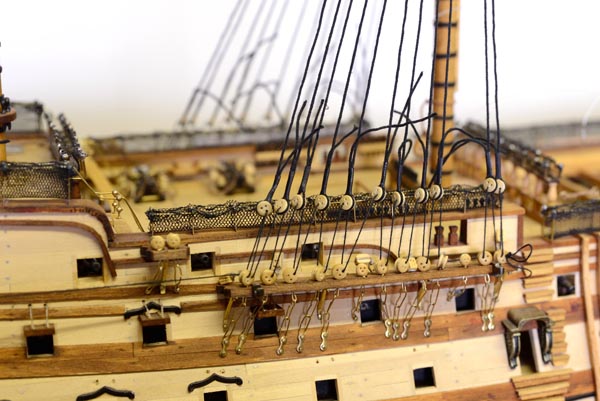

Hi All,

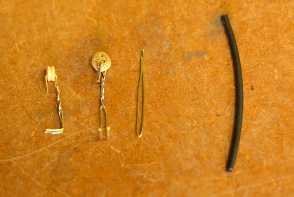

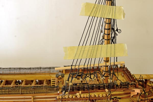

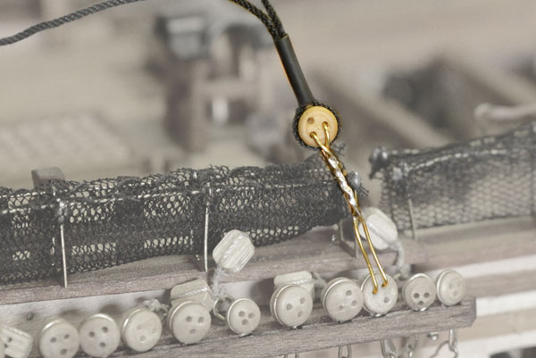

Completed fitting the Deadeyes to the lower shrouds this weekend. MAN, did I battle aligning the Deadeyes. I tried all sorts of things. Firstly I followed the books instructions, secondly I made a jig to hold all shrouds in place, then finally, I decided to bind each Deadeye temporarily in place after fitting the heat shrink. This seemed to do the trick. Other than that, I have basically followed Steve’s tutorial.
In hind sight, perhaps it was more so that I was able to string a couple of hours together to finish the task. Rather than as with the Foremast, fit three or four Dead eyes, pack the model away for a few weeks, then hall it out again to fit five or six more, and so on…
#108 Posted : 23 March 2015 11:52:06
Looking good GarthBigGrin That's basically what I did with the deadeyes except instead of the temporary bindings I just numbered them with some tape to avoid getting them mixed up. Look forward to more.

Hi Steve,
Thanks for looking in. I have removed the Foremast and bound the shrouds on the bench rather than on the model - as you suggested. It is much easier. I'll add some pix as I get there.

Hi All,
Completed fitting and binding the lower shrouds.

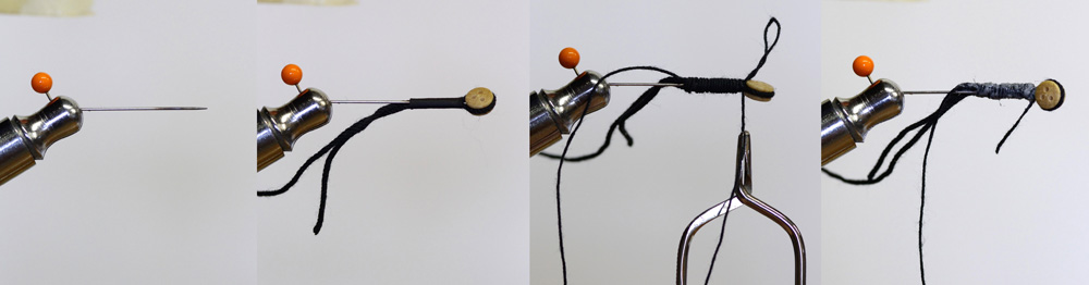

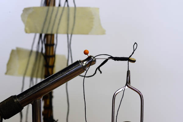

I found my fly tying kit to be a great help securing the parts to be bound.
1.Clamp a bent dress makers pin into the jaws of the vice.
2.Slip the heat shrink over the pin.
3.Bind as per instructions. (The Hackle Pliers are a great help keeping tension on the thread)
4.White glue applied.
My thoughts on repetitive jobs like this: Doing a bit here and there can be so counterproductive. Where possible, try to complete the job in one sitting. I find that with every one that I completed, I was fine tuning my methods and eventually I was getting quite good at it.

Hi All,
Started on the Futtock Shrouds this weekend. Basically following Steve's heat shrink method, except this time I used my Whip Finnisher (From my Fly tying gear) to do the binding. I know this is'nt true to the original, but most of the binding is hidden anyway - and it's a lot faster.
