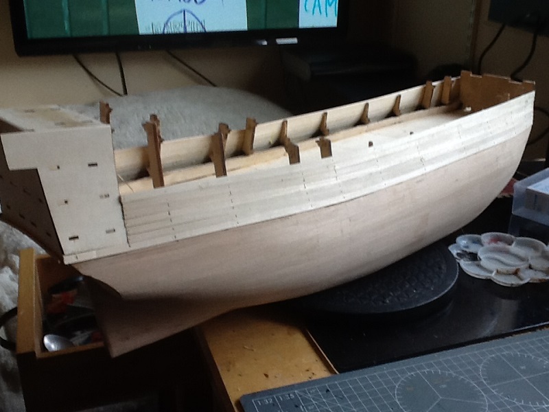

thank you gents for the kind comments,and a little explaining is needed I think,first of all,apologies for the bad pics,I've drop my camera and is broke,so the I-pad had to step in.
the pencil lines you can see are where I have tapered and beveled the planks,not sure yet where to terminate the ll.e.ds.but hope to have contacts on the keel which will work from the stand.

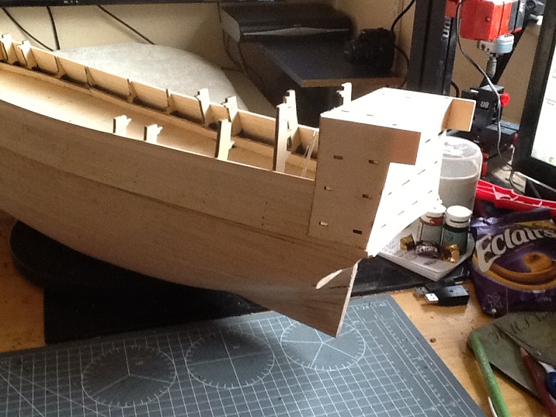

#102 Posted : 26 January 2013 10:48:35
that's the lower hull planked,and now for the big sand off,of all the jobs in building a ship,this has got to be the messiest,s.w.m.b.o. ALWAYS moans about the saw dust gets everywhere.Huh

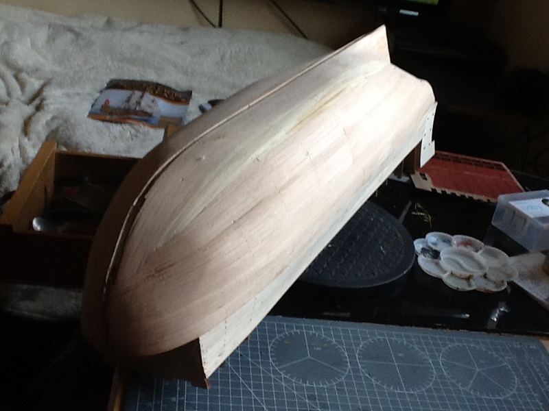

#104 Posted : 26 January 2013 16:28:28
thanks trev,heres some more after sanding.
#105 Posted : 26 January 2013 16:30:19
sorry the pics are upside down,I'm no photographer.

hi karl nice and smooth now did you use a machanical sander ?
#111 Posted : 10 March 2013 19:48:15
Hi Karl,
The hull is looking good, I`m only a little way into planking and have found the full balsa infill very helpful as a newbie, but I don`t know how difficult it would be without it, so maybe a bit biased BigGrin .
When you sand the hull, which method do you use, I am looking to get some ideas before I get to that point and would be grateful for your input.
#112 Posted : 10 March 2013 20:39:50
hi benny and del,my method of sanding is in the prep work,I dont like using filler,so I fill any gaps with slivers of wood,then I use a permagrit sanding block,rough one side and fine 'tother,they are expensive but lasts and lasts.I start with rough and remove excess bits of wood filla,then I use the other side of the block which is supposed to be medium but is a little worn now,so it gives a fine sand,any tiny gaps(shrinkage)I use aliphatic glue sanded over,which the sawdust created mixes with the glue to do an invisible join. when the planking is completed I will use shellac sanding sealer,as many coats as it needs with wet and dry carborundum 1200 in between before paint/varnish.
