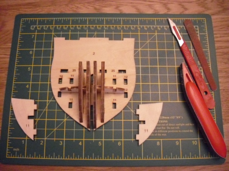

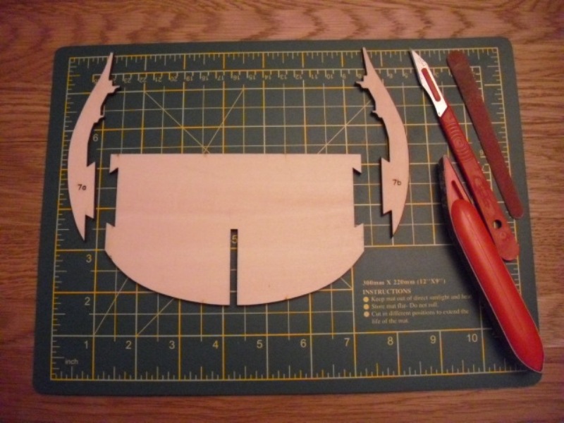

I am only going to use parts 7, 7a, 7b and 11 x 2.
Lets deal with 7, 7a and 7b first, so remove all the loose ash using the tools as before again this is not so critical on the outer edges because later on in the build we will be fairing these parts. :-

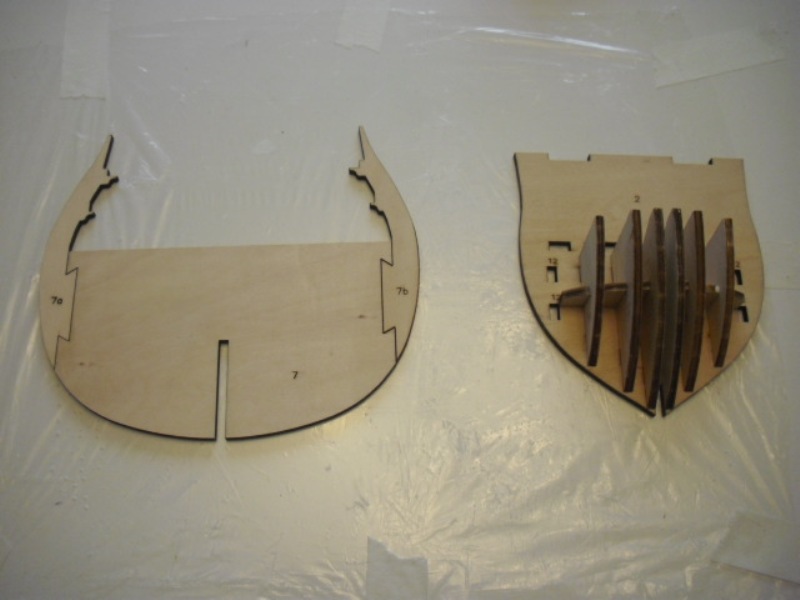

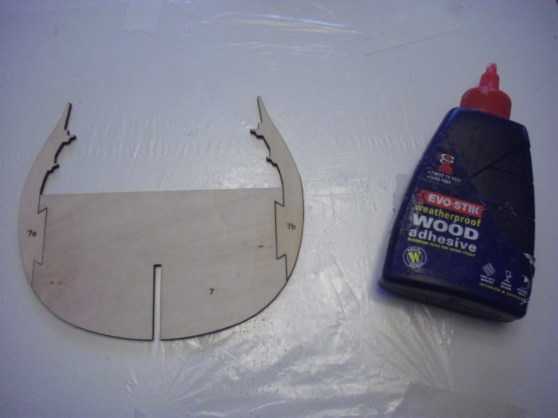

Now using our white conti board with the plastic coating ( so the glue does not stick to the board) fix the parts together with adhesive making sure the parts are flat:-

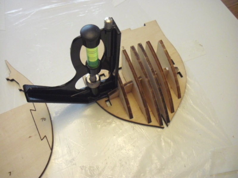

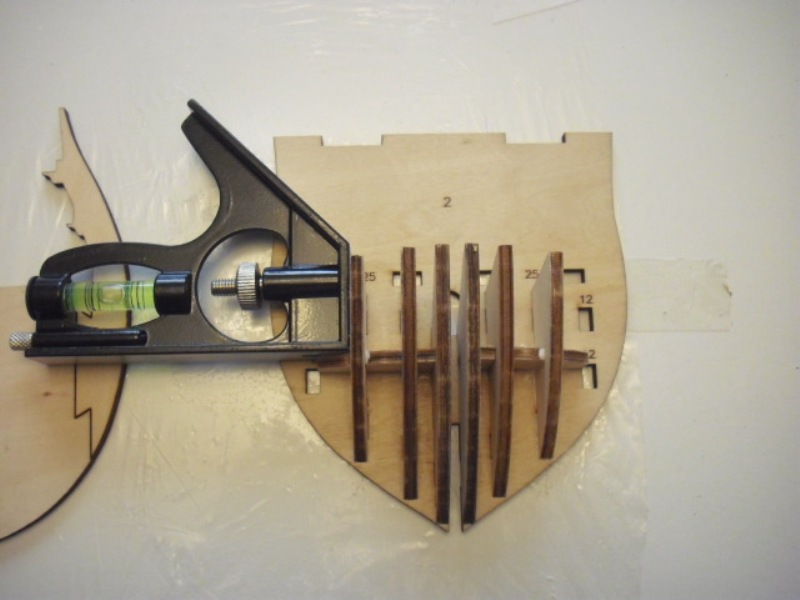

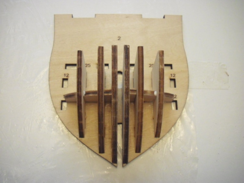

Next up is fitting parts 11 to bulkhead part 2, again trim off all loose ash and using adhesive fix the parts useing a square to test for a true fit on our white board:-

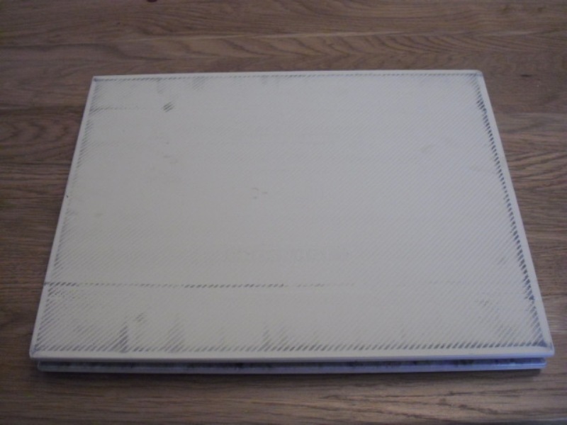

A good idea to keep your parts flat untill you start building the keel, beg steal or borrow a couple of large tiles (the edges are rounded so will not cut your hands) place the parts on the decorative side of the tile, then place the other tile decorative side down and store under the bed or similar.
I buy my tiles from B&Q, please have a look:-

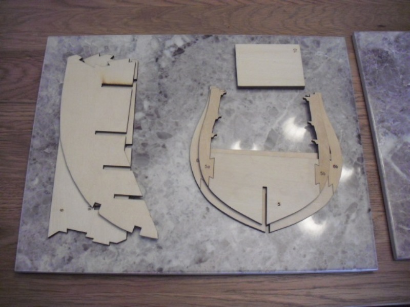

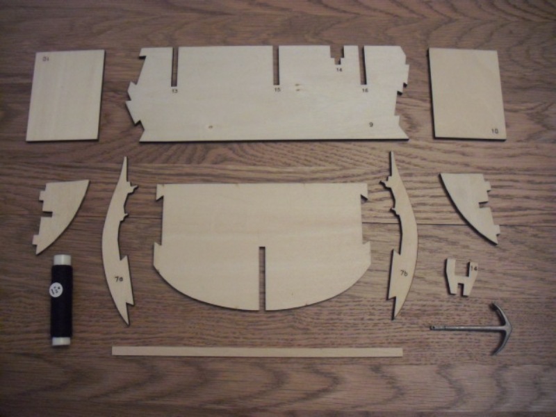

Well Team thats all for this week, thanks for watchingBigGrin Questions and comments are welcome, I will leave you with the parts we have built this week:-
Regards MIke
