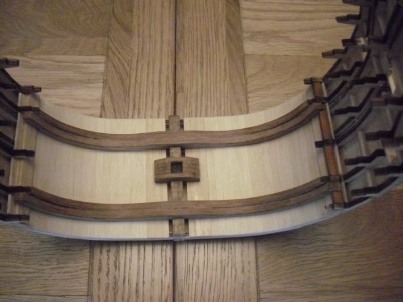

#107 Posted : 09 October 2012 12:58:08
ISSUES 129 AND 130 BUILDS

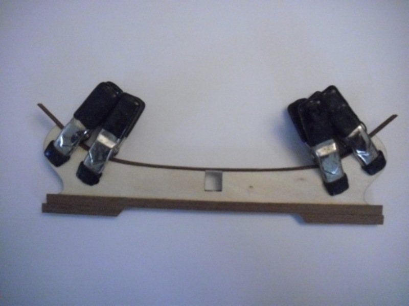

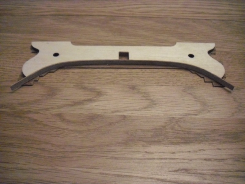

Hi Team, well here we are again as you know I am planking the main beams, the pump well and the mast base to cover the ends of the ply wood.
I have also modified the deck limbers, I am using the Anatomy of the ship for my information.
All the build in the photos is dry fitted, I do not intend to use adhesive untill I am satisfied that all is well.The insructions in Issue 130 tell you to stick the pump well in place, this to me is a no no because it is difficult to plank the pump well when it is fixed in the confined space, better to plank it outside the hull.
Here are photos of the beam being planked:-
#108 Posted : 09 October 2012 13:06:27

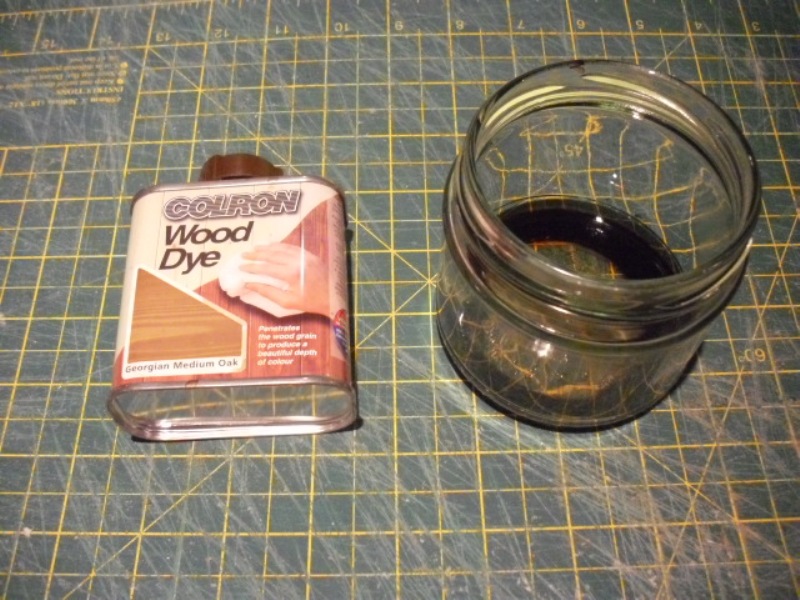

At this point I stained the sides of the beams with Georgian Medium Oak (Coloron Wood Dye) and thinned it with white spirit to obtain the same colour as the walnut planking I am applying. -- PLEASE NOTE I applied the dye before I planked the beams so that it would not "bleed" onto the planking:-

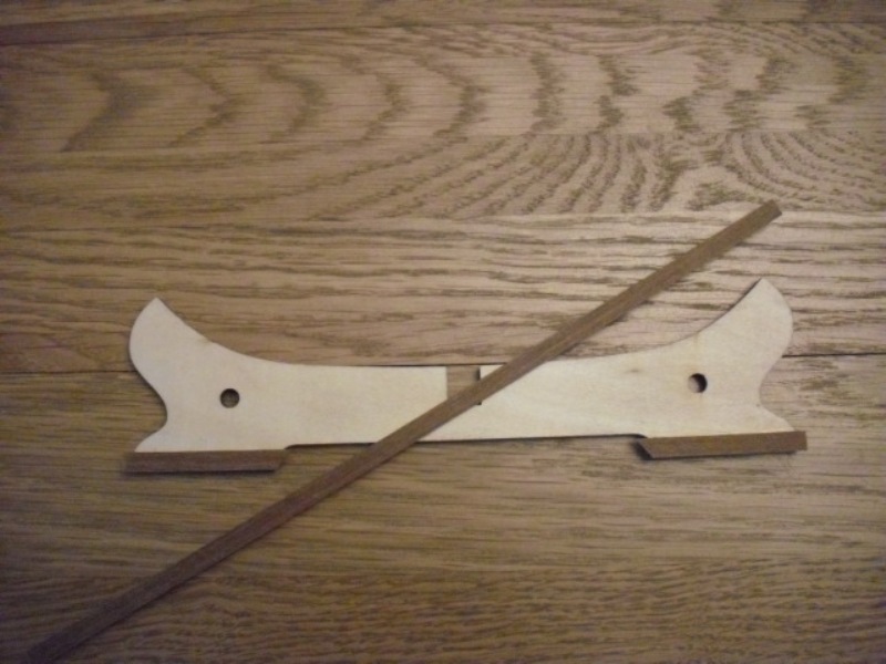

Then I planked the ends of the beams:-

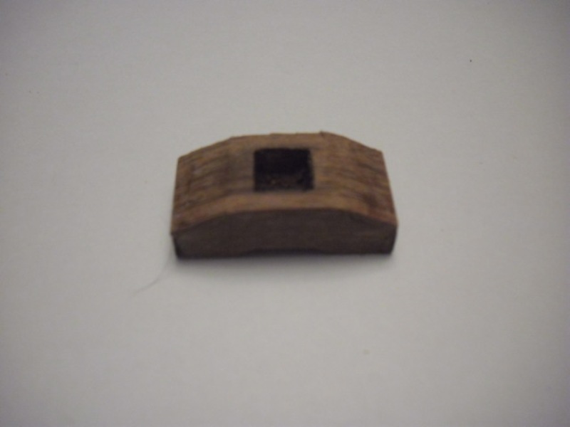

#110 Posted : 09 October 2012 13:11:05
ISSUES 129 AND 128 BUILDS

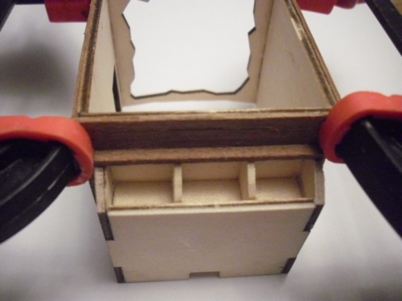

I gave the mast base the same treatment, applying the dye to the sides before planking:-

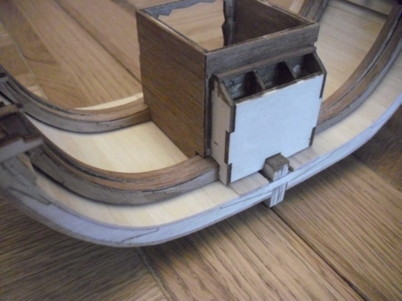

#111 Posted : 09 October 2012 13:15:33

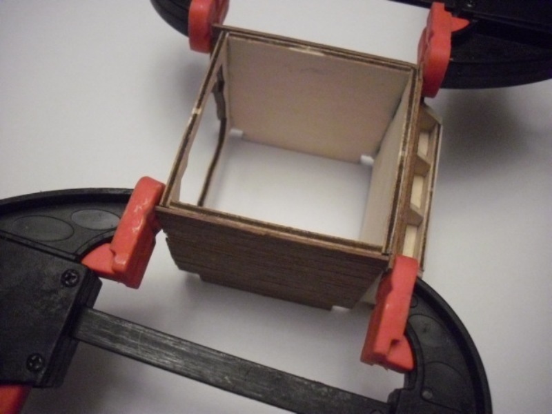

Now it is the turn of the pump well to be planked again I am using my 5mm x 1mm walnut planking:-

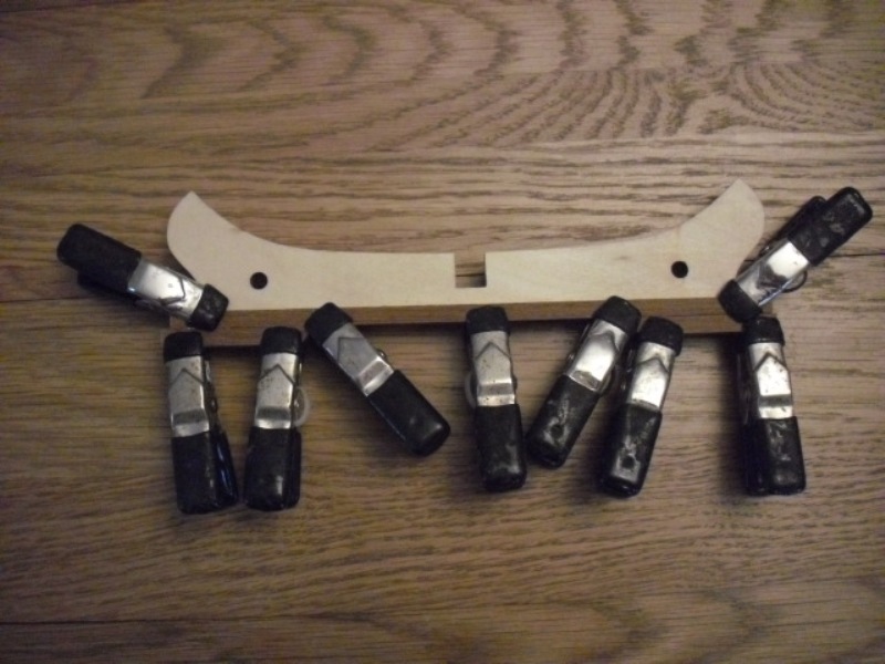

#112 Posted : 09 October 2012 13:18:44

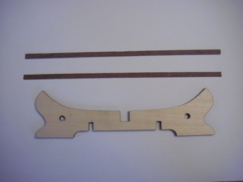

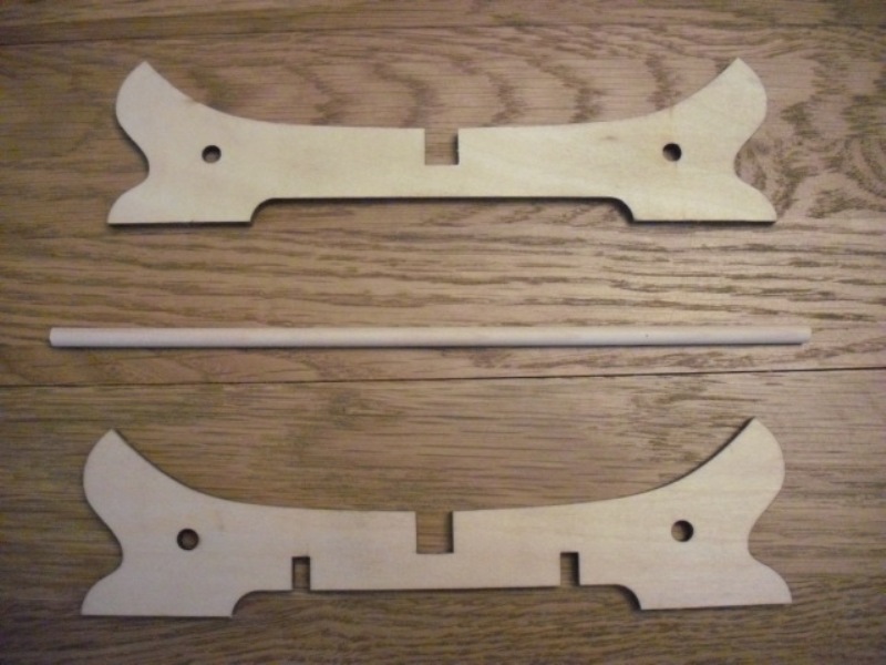

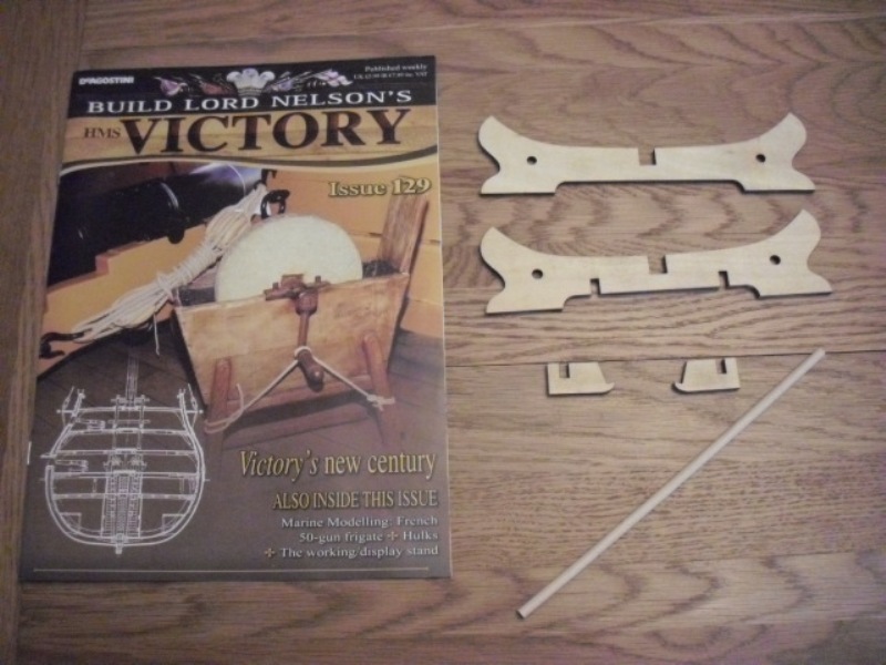

This is what we received in issue 129:-

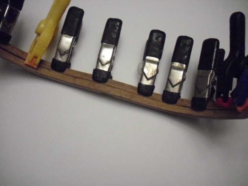

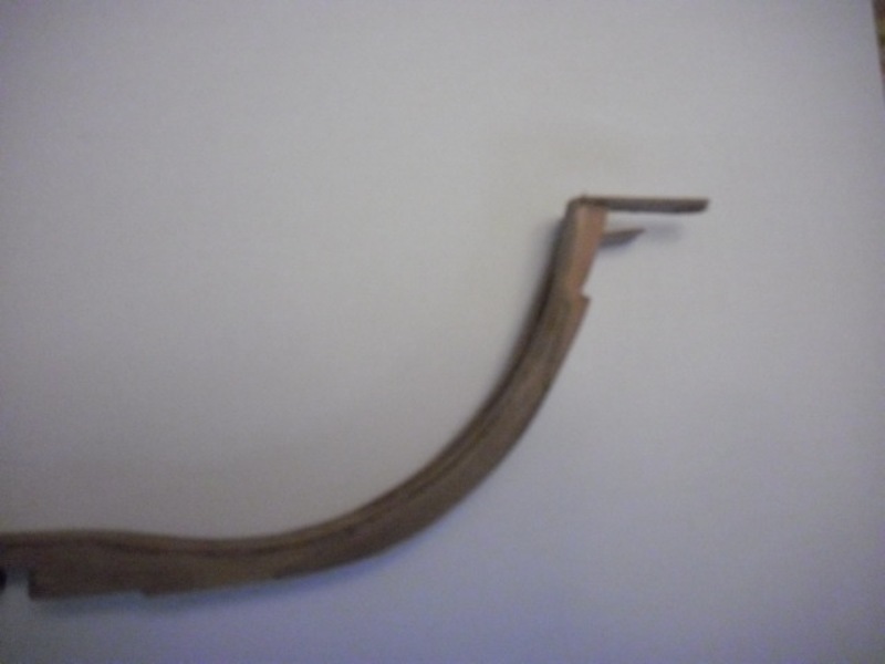

#113 Posted : 09 October 2012 13:22:33
ISSUES 129 AND 130

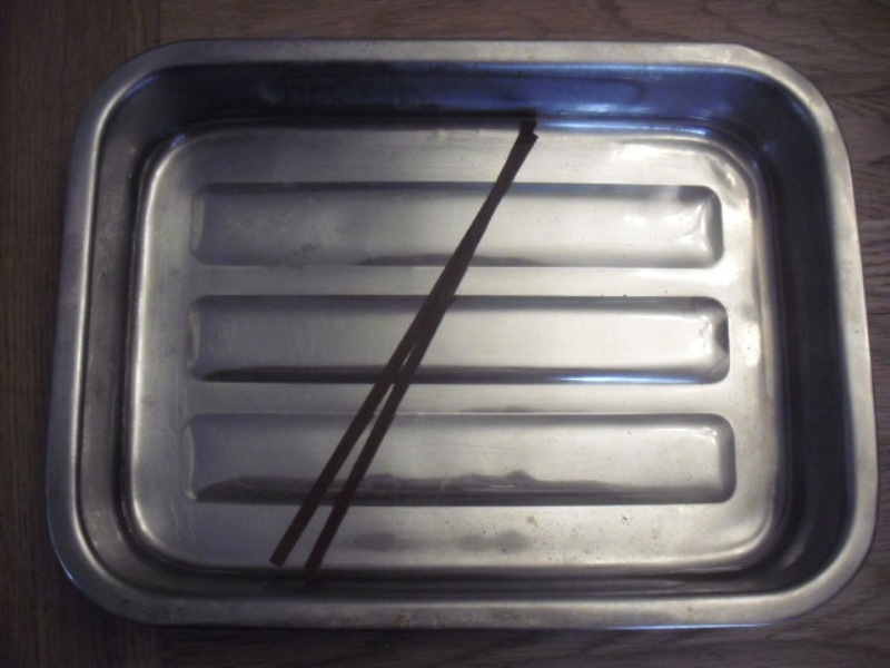

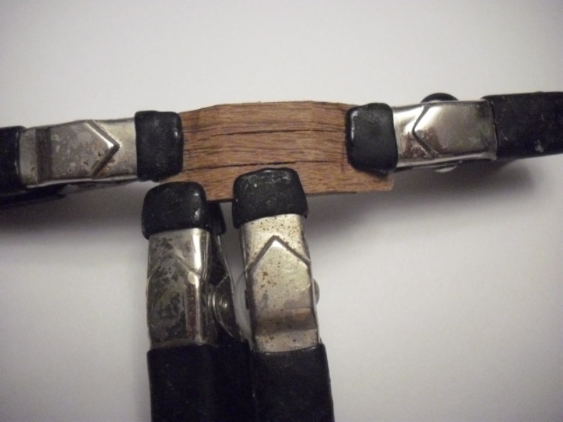

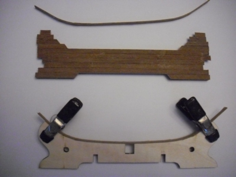

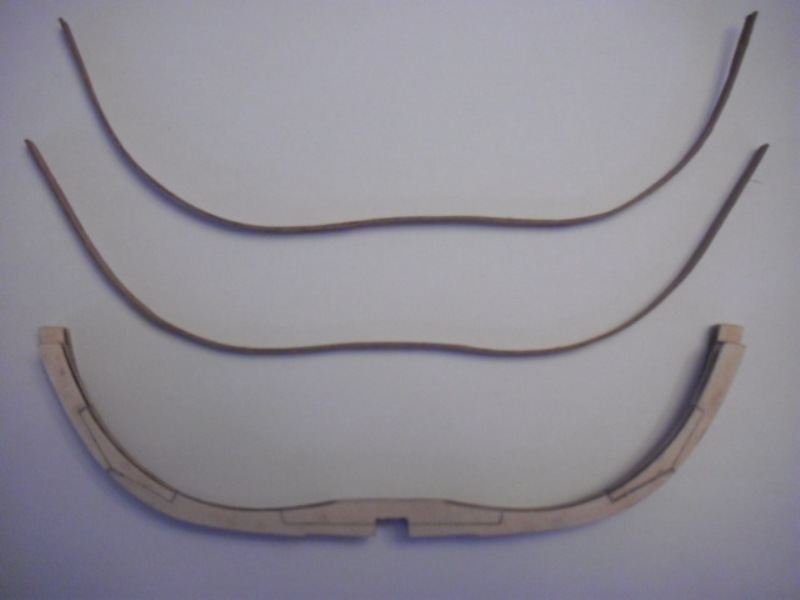

I decided to plank the stand with my walnut planking, during this process I soaked the planks to form them around the curves, clamping them while wet untill dry but not using adhesive:-

#114 Posted : 09 October 2012 13:30:48
ISSUES 129 And 130 BUILDS

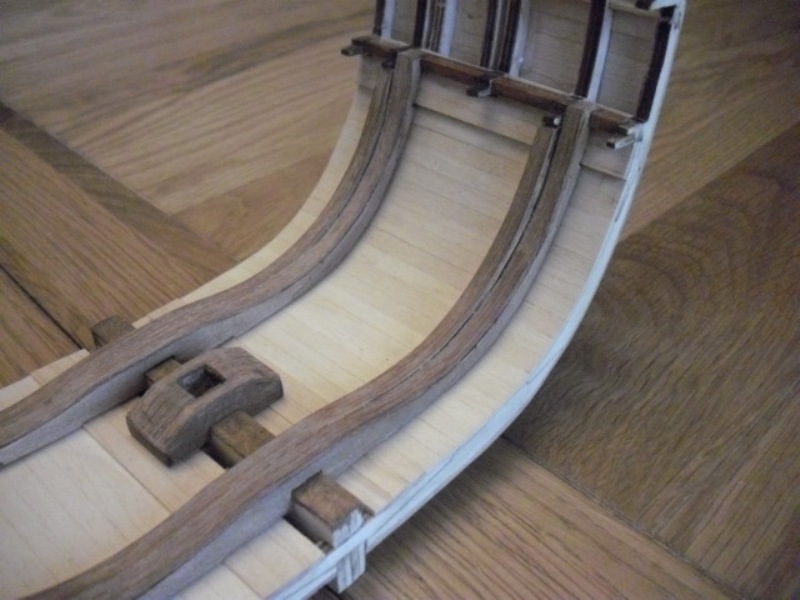

Well Team thats the end of this session, the modifications I am doing are my preffered build, you do not have to follow me.The pump well has been dyed with the mix I prepared earlier.
Questions and comments are welcomeBigGrin
I will leave you with photos of where I am upto at the moment.
No part has been fixed with adhesive yet.
Kind regards
Mike
