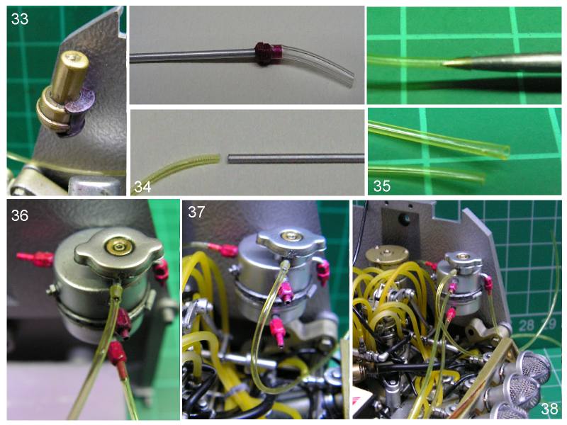

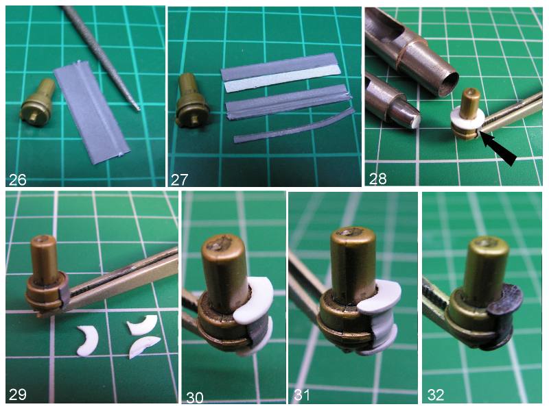

So, now for the fuel valve support bracket. It’s a strange looking thing, it only encompasses half of the valve body with no visible means of holding the valve in place. Although, having said that, there is a shot of the valve in one of my reference pics that does appear to (possibly) be a large black cable tie (zip cable?) going around both the circumference of the valve and also around the bracket – I might have to look at that a little closer! Photo 26 shows the start of the bracket with the kit valve together with a short piece of the semi-self-adhesive DecraLed. The round diamond dust rat tail file shown alongside was used to finish off the raised channel seen running along the lead which was started off with a large darning needle. This was impressed into the back face of the strip and is necessary to allow the strip to encompass the valve over its raised rim seen towards the bottom (I’m wondering if this is supposed to represent that cable tie!) The next step was to trim the width of the strip down so it was the same size as the larger cylinder on the valve as shown in Photo 27. Then, using the razor blade cutter the rimmed strip was cut to length starting at the rear locating peg, and coming about one third of the way towards the front of the valve. Once it was cut to size and ‘tacked’ down in place a drop of thin superglue was applied to seal it down. To make the two flanges on the top and bottom of the bracket I went back to the set of leather hole punches I built up making my paper model Sopwith Pups (I used them for cutting out the rotary engine cylinders amongst other larger round parts). Two of these are seen in Photo 28 and were used to cut out a plasticard disk and then punch out the centre of that to fit the valve (that bit is still in the front of the smaller punch). The black arrow points to the DecraLed strip in place around the valve body as mentioned above.
I then had to slice off the part of the disk beyond the rear locating peg, pencil mark the curved end of the disk just beyond the lead strip and cut that back, sanding it down into the curved end shown in Photo 29. I had hoped to be able to make both flanges from the one disk but after rounding off the end of the top right piece of plasticard it was about half a mm too short! A couple of hammer taps later I had made up the second disk and that made up the second flange, both of which are seen superglued in position in Photo 30. Photos 31 and 32 show the painting of the bracket, first a couple of coats of Vallejo Grey Primer followed by a single coat of The Army Painter Warpaints: Rough Iron. Once all was dry I then dry-brushed it with a drop of the grey primer to simulate the wear and tear seen in the reference photo. The final effect, minus its electrical wires, is shown in Photo 33 with the valve firmly pushed into its locating hole in the firewall. The wires will be added in after the engine section has been fixed onto the body of the car, that cut out visible at top right is for one of the two big support struts that join the firewall to the engine block – I’ve already been bitten once with the oil expansion tank’s outlets – I’ll wait and make sure the wires don’t foul the struts (or anything else) first!BigGrin
Now its back to Kev’s Veniard yellow tubing! As I mentioned earlier, I bought a pack of the larger 1mm tubing to try out and as I said then, it turned out to be too small for the fuel lines in this scale. However, with a little help its just right for the expansion tank. Photo 34 shows my first trial outlet made up on the end of a length of the 1mm aluminium tubing. The clear tubing on the end is from another modelling supplier on ebay and is 1.2mm in diameter. This fits extremely well but is too thick and too stiff to form the oil lines. The bottom half of the photo shows the Veniard yellow tubing which is just the right size for the lines and beautifully flexible too. Unfortunately at 1mm diameter it’s also too small to fit the 1mm aluminium!Blink The solution is shown in Photo 35 – gently push the tube end over a suitable needle tip, this one is an old brass ended tool from a dissection kit (no, I can’t remember how on earth I ended up with a dissection kit!) The problem then becomes as soon as the tubing is removed from the needle it immediately returns to its original size. The second solution I discovered is to pour hot water over the tubing whilst it is on the needle and let it cool down again. We have a nifty little water boiler which we use now instead of a kettle, this keeps the water at 85 degrees all day (using a measly 2W of power to do it) and that temperature seems to be ideal for this procedure. As you can see in the lower half of the photo, once cooled down the tube end retains its stretched opening compared to the original end shown below (and this is how it would also look after stretching over the needle and removing without the hot water).
This then allows the tubing to fit over the connectors as shown in Photo 36 (the tube on the bottom is just a short piece used to test the fit). The second tube that I knew where to position is shown in Photo 37, this one passes behind the alternator and drops into a conduit down the left hand side, and finally, Photo 38 shows all the oil lines in position, even though I have no idea where the heck the others go to! (Almost every reference photo shows them going somewhere different, that’s the problem when your references are not only contemporary ‘vintage shots), but also modern photos of ‘re-conditioned’ classic cars. Oh well, there’s bound to be some dark recesses where things go in but never come out!BigGrin

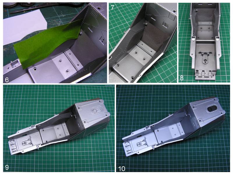

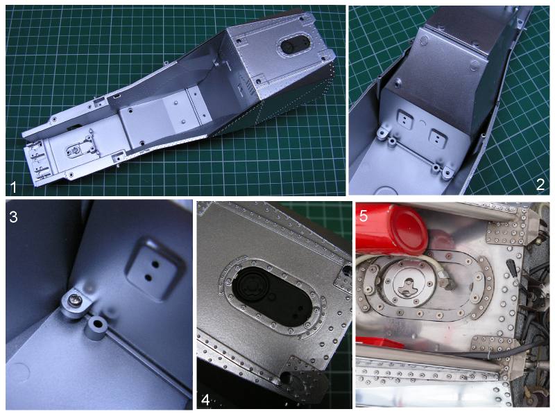

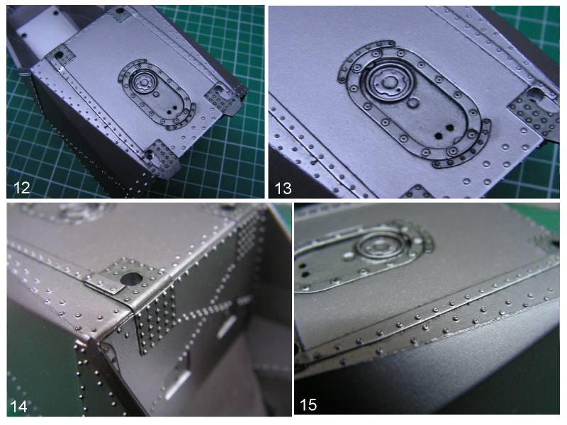

Photo 1 shows the BIG part I’m working on now, this is the main aluminium body section called the ‘Cockpit Cradle’ in the instructions. After the oil expansion tank and the fuel valve this thing is enormous – ten inches long, three inches high and three inches wide (25x7.5x7.5cm (ish)). This shot also includes a part from a couple of phases further down the schedule, namely the rear of the driver’s section. The rear of this part is seen in Photo 2 and I decided to put it in early as I’m going to be airbrushing the entire cradle with Vallejo Metal Colour so it will be far easier and more economical to do it all in one go. This piece, the ‘Driver’s Backplate’ comes in Phase 25 along with the seat belts.
Put together both of these components by fitting the openings on the plate on to the columns on the cradle (circled in the photograph) and inserting the end of the plate into the cradle (arrowed in the photograph).
That’s what the instructions say about fitting the backplate into the cradle. Sounds easy but not quite so easy in practice! I struggled for quite some time trying to get the thing to slide in. It went in eventually but with the help of considerable force and once in, it wasn’t going anywhere, especially back out again!BigGrin To be honest it didn’t really need any screws to keep it in but I put in the pair of Type J screws anyway, one of which is shown in Photo 3. One of the changes I’ll be making is to alter the appearance of the fuel tank filler cap. As shown in Photo 4, this is supplied as a black ‘infill’ on the kit part whereas on the actual vehicle it appears as shown in Photo 5 – a natural metal finish in slightly different shades (steel?). I’ll be airbrushing the entire body or cradle in Vallejo Duraluminium with a darker mix of that colour with some Vallejo Jet Exhaust added to try and accentuate the shadows in the floor and sides of the driver’s section. The fuel tank filler will be washed with various strengths of the Humbrol Blue Grey enamel wash (new bottle has arrived) with the strut brackets given the same treatment.
Well, that’s the plan anyway! In the next installment we’ll find out how the ‘shadowing’ has gone and start on that fuel tank filler.

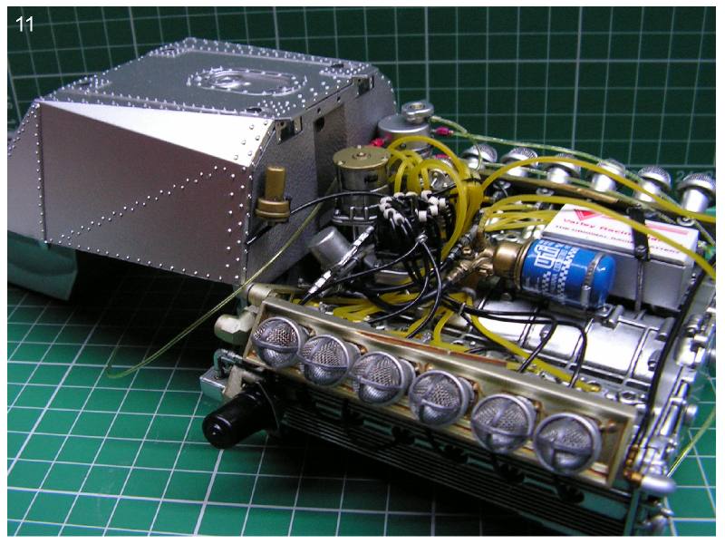

Well, I’m glad to say the airbrushing went really well. The first job after airbrushing the whole piece in Vallejo Duraluminium was to mask off the upper panels on each side of the cockpit to keep the shadowing to the lower panels. The masking is shown in Photo 6, using Frog Tape which was cut out following a pattern I first made up in thin card. I first stuck the tape down on the worktop cutting boards a few times to reduce the tackiness of the tape so it didn’t pull off any of the previously dried Duraluminium. I then airbrushed a mixture of Duraluminium and Vallejo Jet Exhaust Metal Colour at 3:1 to give a subtle shading effect. It was definitely subtle, so subtle in fact I could hardly see any difference! I then tried a mix of 1:1 which still wasn’t dark enough and ended up airbrushing light coats of Jet Exhaust on its own which gave a nice shadowing effect as seen in Photos 7 to 9 which can be compared to the original kit finish, repeated in Photo 10. The real pity is that just like the lovely pipe-work on the engine, most of the shadowing is completely hidden by the driver’s seat panel a little way down the line!Crying
Just for those who can’t resist sneak previews, Photo 11 shows how the engine and its firewall fits into the rear of the cockpit cradle!
With the overall colour on, I then had to re-detail the fuel tank filler, which was previously an overall matt black. This was achieved with Humbrol Blue Grey Enamel Wash, applied thinned down to fill in the flat bottom section and the surrounding riveted ring, and with a darker solution of the wash applied to the two crescent plates front and back, shown in Photo 12 and enlarged in Photo 13. The same darker wash was also applied to the riveted brackets, which carry the roll bar later on and also, the two struts which help to secure the engine to the chassis. The grooves around the filler and the rivets were then accentuated with Humbrol Black Enamel Wash. The brackets which form the top of the driver’s position are shown in Photo 14 after the blue grey and black treatment. I also tried to pick out the edges of the thin brackets which are found on either side of the top of the cradle in the black wash but it was so thin it took multiple applications to get any noticeable effect! It was much easier picking out the panel lines on my Spitfires with this wash in the ‘Scramble!’ diorama but I suddenly remembered afterwards that I airbrushed the Spitfires with that Johnson’s Klear before applying the wash, maybe I should have done that here too! (I’d forgotten all about it, plus I’d already airbrushed the Vallejo Metal Colour clear varnish over the whole thing).
Anyway, I’m quite pleased with the overall effect and with the cockpit cradle, that brings us to the end of Pack 3. The next step is to begin the seat belt construction, which should have gone on to the rear of the driver’s compartment before it was added on to the cradle (but couldn’t because of the re-painting). After that, Pack 4 is devoted entirely to the construction of the cockpit.

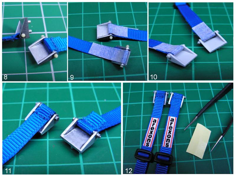

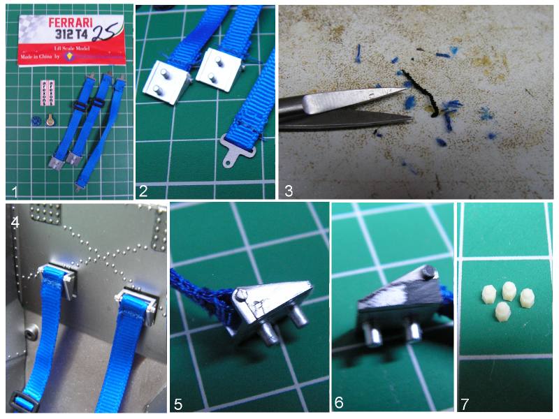

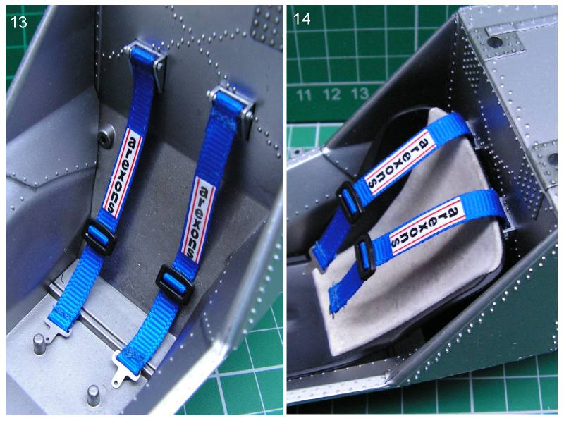

Pack 25 contains the parts for the driver’s seat belt. There are three parts of actual ‘belt’ although the longest piece comes up through two slots in the driver’s chair section later on, effectively making two belts out of one. The remaining bits are a couple of self-adhesive sponsor decals and a two part connector similar to what the fighter pilots had on their seat harness straps during WW2. The belts themselves are made of a blue fabric, stitched on to a plastic bracket at the top, a plastic buckle in the middle and a metal clip at the bottom (Photo 1).
Photo 2 shows those brackets and clip and also some ‘excess’ stitching thread, which needs to be carefully trimmed back before proceeding on. I used my micro scissors to do the trimming, the blades shown in Photo 3 are about 15mm long with the snipped off threads and ‘fuzz’ shown alongside. The two brackets are push fitted into a pair of recessed rectangles with two locating holes each on the rear bulkhead of the cockpit. In Photo 4 the brackets are shown lightly pressed in (very lightly, the thing you learn on this kit is the hardest part is actually getting the bits apart again after ‘test fitting’!)BigGrin
One thing I did notice early on was that both the brackets have some nasty looking mould and injection marks on the sides. A bit too noticeable as you can see in Photo 5. At first I decided to file and sand the marks down as shown in Photo 6, but after trying to work around the moulded on bolts I suddenly thought why bother? I’d already cast a variety of resin nuts and bolts for the battery clamps so I filed the kit ones off completely and replaced them with my smallest castings seen in Photo 7 (that’s a 1cm square they’re sat in). Once they were super glued on as in Photo 8, I carefully sanded off the thread on the inner side of each bracket, leaving just the nut. On the real item there is obviously a nut and bolt, with a fixed head on one end and the nut on the other, I thought it would be logical for their maintenance to have the moving nut on the ‘outboard’ side where it would be easier to get at! (And that’s the full extent of my Formula 1 mechanics course!)Blushing The next task was to mask over the fabric belt so that I could re-paint the brackets, this was easier than I’d expected, the strip of masking tape just slid under the bracket and belt and then wrapped around and stuck to the belt as seen in Photo 9. I first gave the brackets a couple coats of Vallejo Grey Primer, shown in Photo 10, followed by a couple of coats of Vallejo Model Air Chrome, applied by brush with some Humbrol Black Enamel Wash after the acrylic was dry as seen in Photo 11. Next came the sponsor’s decals, these were carefully removed with fine tweezers from the backing sheet and positioned on the belts before pressing down firmly. They stuck really well as shown in Photo 12 but I’m not too sure about the high gloss finish. If I can find some photos of the belts in use I might try some semi or dead matt varnish later on. I did consider painting the buckles in chrome as well as they have appeared this way on other scale models of the 312, but the one photo I found of old Giles in his seat did seem to show them as very dark, probably even black!
Photo 13 shows the two belts with their brackets pushed firmly into the rear bulkhead. Eventually, most of the details will be (again) unfortunately hidden as the driver’s seat is placed into the cockpit. The final Photo 14 illustrates this with the seat just resting on its locator pegs, there is enough of the brackets showing to make the extra work worth while though!Cool
The next step is the anti-roll bar frame with the two side panels. As this will require more airbrushing, that’s a job for after the Christmas rush!Blink
