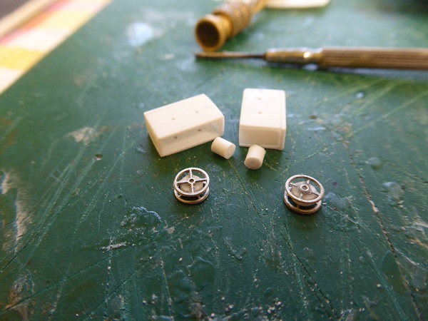

The next 'mini-project' was to fabricate the two block and tackle assemblies. These were used to lower the torpedo into the compartment, once it had been manouvered through the loading hatch.
The fist step was to make two wheels that keep the chain located correctly within each block and tackle assembly.

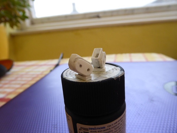

#102 Posted : 21 August 2020 16:24:33
The attached photo shows both block and tackle assemblies near completion along with the aforementioned guide wheels and also two rollers.

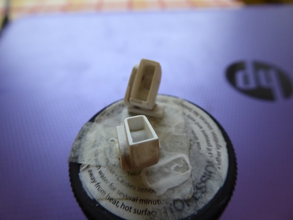

#103 Posted : 21 August 2020 16:25:51
Block and tackle assemblies filed to shape, painted, pin washed, rollers fitted and ready for the guide wheels and chain.

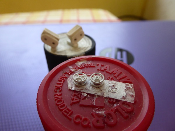

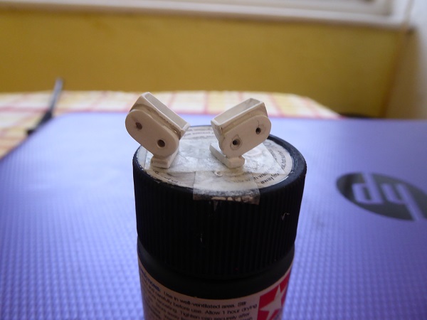

#104 Posted : 21 August 2020 16:28:04
This photo shows the rollers fitted. Rollers and guide wheels had 0.6mm diameter hole through the centre of each and corresponding holes in the block and tackle assemblies to align a brass shaft.
#105 Posted : 21 August 2020 16:29:16
Another angle showing the block and tackle assemblies.

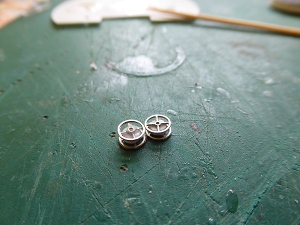

#106 Posted : 21 August 2020 16:29:55
Guide wheels painted.
#107 Posted : 21 August 2020 16:30:56
Guide wheels and chain fitted.

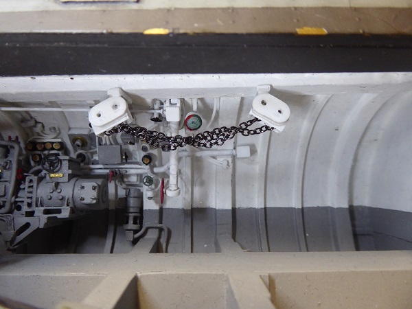

#109 Posted : 21 August 2020 16:34:35
Block and tackle assemblies fitted. The two loose ends of chain were tied to the main chain via fine wire.
#110 Posted : 21 August 2020 16:36:53

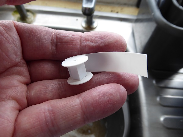

I've now turned my attention to building the two main motors. These would take their power from the batteries to turn the prop shafts and propellers.

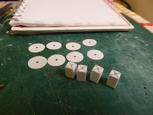

The first part was to spend a bit of time just looking at photos and mentally breaking down these motors into basic shapes to form the body.

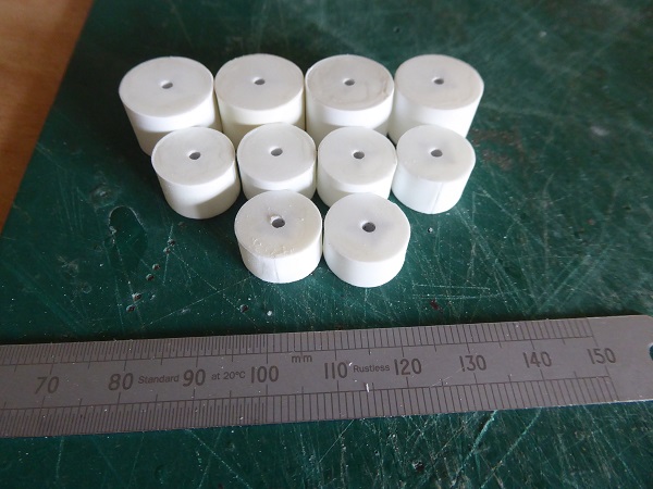

Essentially they are cylindrical, consisting of various diameters and widths, so this is what i started to make.
I used 6.5mm square acetal strip, cut to lengths that match the different widths of the individual cylinder sections. Drilling a 2.0mm diameter through the centre of each gave me a datum.
I then used a compass cutter to form various diameters from 0.5mm thick acetal sheet and finished off by opening out the centre hole to 2.0mm.

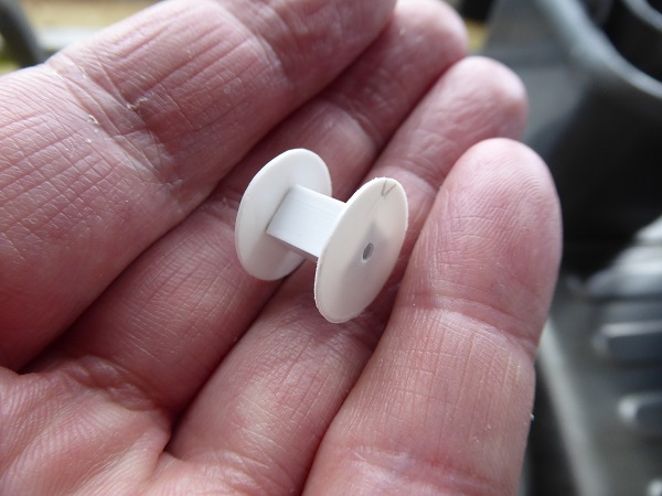

#116 Posted : 04 September 2020 09:36:22
Using a 2.0mm diameter brass rod i could slide two circular sections over the brass rod with the square section sandwiched in the middle, all glued together.
#117 Posted : 04 September 2020 09:38:18
The next step to complete one of these cylinders was to fix a strip of 0.25mm thick acetal sheet, cut to length and width and glued to the outside edge.
#118 Posted : 04 September 2020 09:39:55
I had several of these cylinders to make in the same fashion as described before.Blink

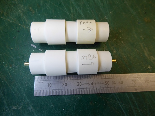

#119 Posted : 04 September 2020 09:43:11
These individual cylindrical sections were then fixed together using the brass rod as a locator so that i ended up with the basic shape of the two main motors.

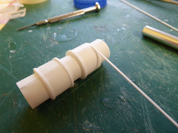

#120 Posted : 04 September 2020 09:45:24
Now i can start to add detail beginning with edging using 1.0mm x 0.5mm acetal strip.
