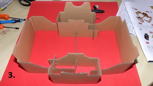

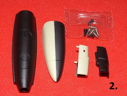

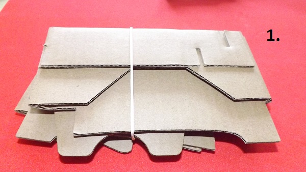

PICTURE 3
We start this section by putting together the 4 cardboard sections that make up the temporary stand for the aircraft.

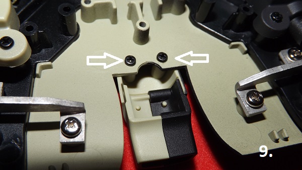

PICTURES 8 & 9

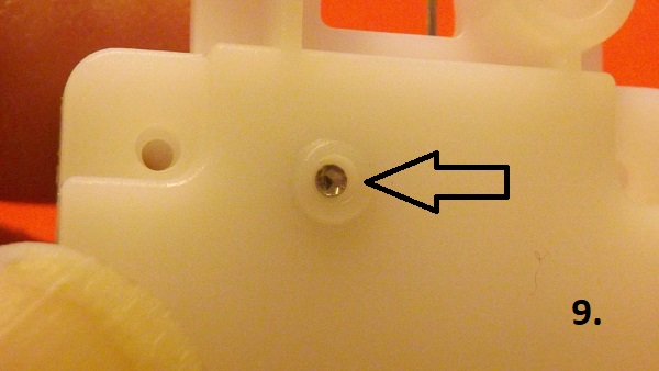

The Carburettor air intake is secured to the lower wing with 2 screws as shown in these 2 pictures.

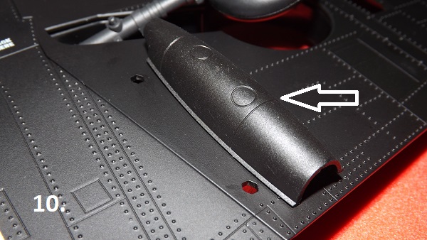

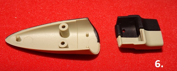

PICTURE 10

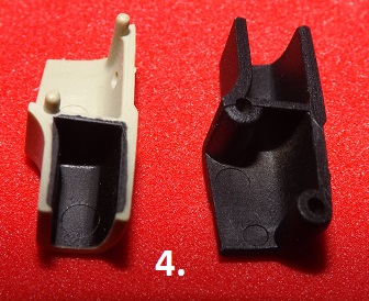

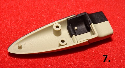

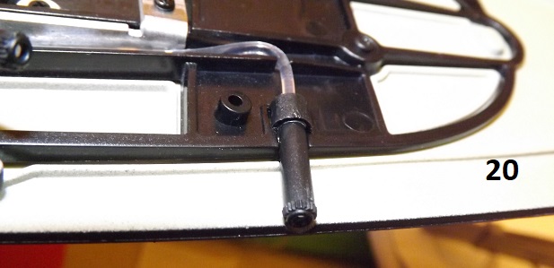

The air cooler intake is next up. This is just spot glued and pressed into place.
This part does not have the same sort of fit issues that we saw with the radiator housing.

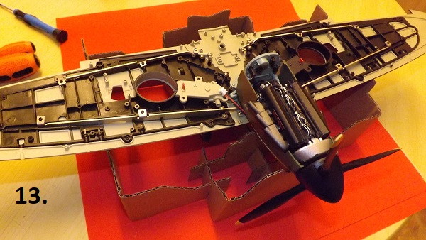

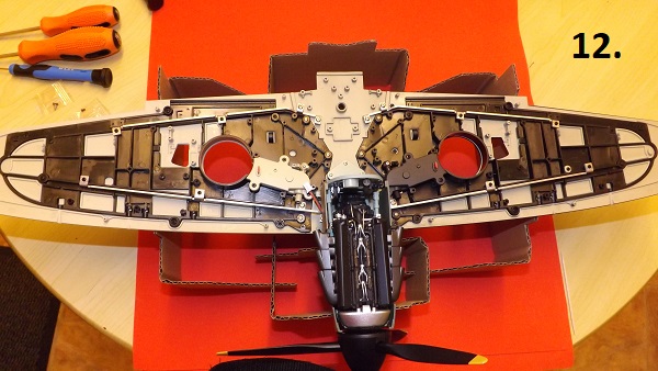

PICTURES 11, 12, 13 & 14

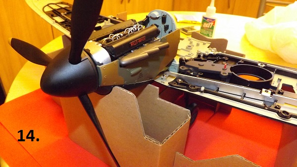

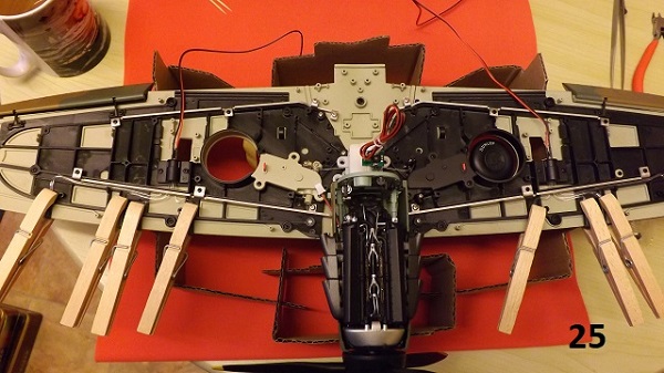

And the last part of the assemble required in this section is to fit the engine onto the lower wing using 4 of the supplied screws.
These pictures show how all of this looks.

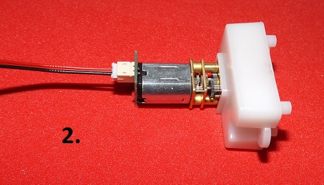

ISSUE 35 – THE MOTOR FOR THE LANDING GEAR

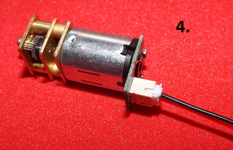

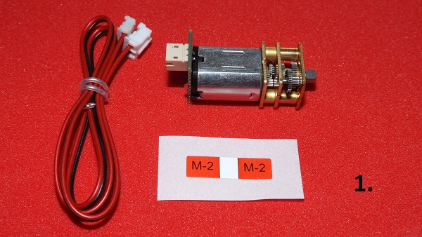

PARTS CHECKLIST – PICTURE 1
35-01 Motor for the Landing Gear
35-02 Cable
35-03 Cable Label
PICTURE 2

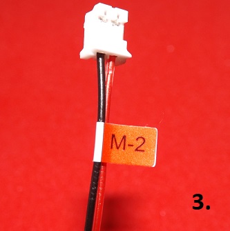

We are told to be aware that the 2 plugs on the supplied cable are different sizes.
PICTURE 3
The label is affixed around the cable leading to the larger plug.

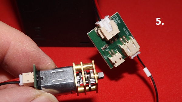

PICTURES 4 & 5
We then connect the motor to the lead, and the lead to the test board and battery box to ensure it all works.
Of interest here (Picture 5) is the gearbox attached to the end of the motor.

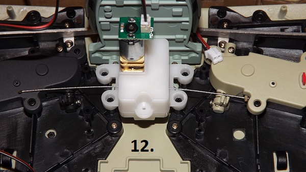

ISSUE 36 – CONNECTING THE LANDING GEAR

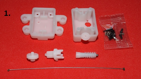

36-01 Gear Casing
36-02 Gear Casing
36-03 Cog Assembly Cap
36-04 Cog
36-05 Shaft and Cog
36-06 Landing Gear Connecting Cable
36-07 Three 1.6 x 4mm KM screws (1 spare)
36-08 Nine 2 x 4mm PB screws (1 spare)
36-09 Three 1.6 x 3mm PM screws (1 spare)
PICTURES 2 & 3

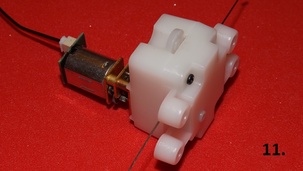

We start off by fixing the motor previous supplied to one half of the gear casing.
The motor is secured from inside the case half using 2 of the KM screws.
PICTURES 4 & 5

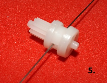

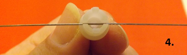

It appears that the gear retraction will be operated by a steel wire.
This wire is trapped between the two halves of the Cog
PICTURE 6

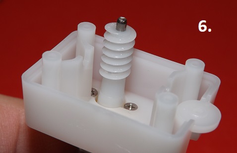

We then fix the worm gear over the motor spindle.
PICTURE 7
As this assembly is going to be extremely difficult to get too as the build progresses and we are told NOT to power up the motor again at this stage, I am not sure how noisy this might be.
Therefore, I have decided to grease the parts using a plastic safe grease that you can see in this picture.

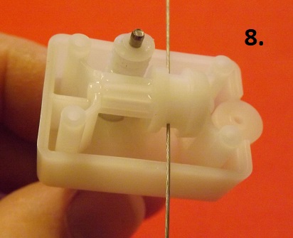

PICTURE 8
We then slot the cog assembly and wheel retraction cable into the housing. This again is lightly greased.
PICTURE 9 & 10
We then place the top of the gear casing in place ensuring that the pin on the worm gear fits into the hole you can see arrowed in picture 9.
PICTURE 11
The 2 halves of the gear casing are then secured together using 4 of the PB screws.
As tempting as it is to power this up the instructions tell you not to do this.

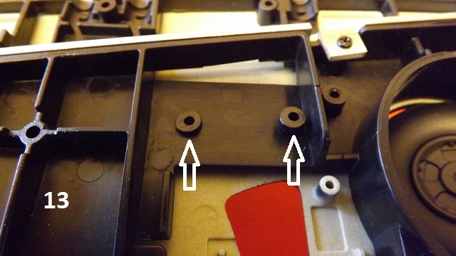

PICTURE 12
The gear box assembly is then secured to the lower wing using 4 x PB screws.

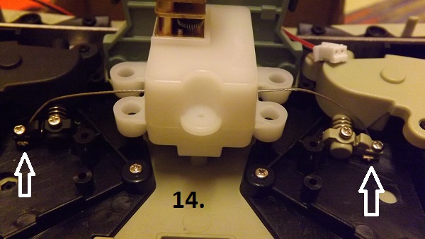

PICTURES 13 & 14

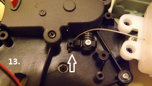

The last part is slightly fiddly in that we have to insert the end parts of the retraction cable into the slots on each of the undercarriage legs.
This cable has a crimped brass end and we need to ensure that is fitted correctly into the undercarriage leg slot.
Its then secured in place using 2 x PM screws.

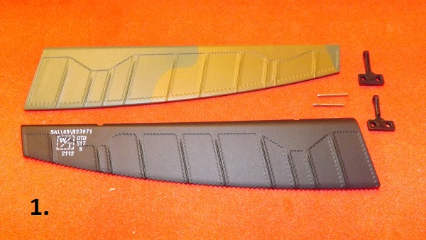

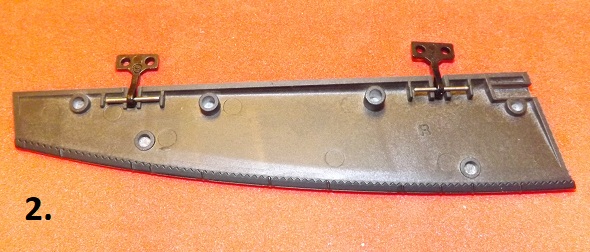

ISSUE 37 – ASSEMBLING AND FITTING THE LEFT AILERON
37-01 Left Aileron Upper Panel
37-02 Left Aileron Lower Panel
37-03 Left Aileron Hinge (marked 1)
37-04 Left Aileron Hinge (marked 2)

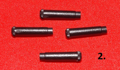

37-05 Two Hinge Pins
37-06 Five PB 1.7 x 3mm Screws (1 spare)
PICTURE 2
As we can see in this picture the pre-printed markings are very clear and well done.

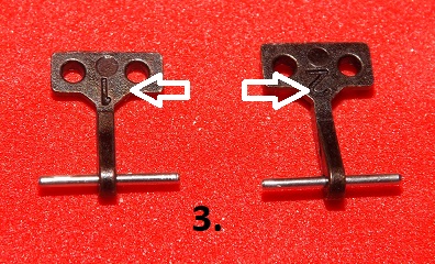

PICTURE 3

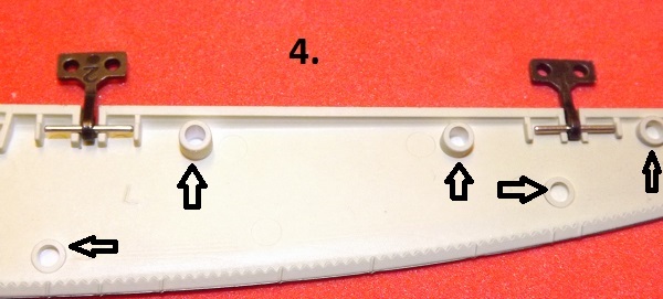

Making sure that we identify the hinges correctly (look for the stamped “1” and “2” on the parts, the hinge pins are put in place.
PICTURE 4
We lay these hinge parts into the slots in the upper aileron half.
Superglue is then applied to the indicated areas.
PICTURE 5

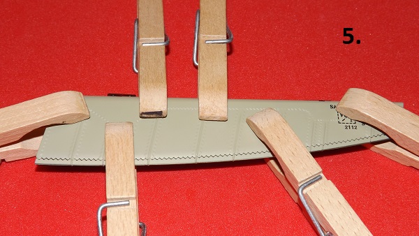

We then trap the lower aileron part in place and hold the assembly together with pegs until the glue has dried.

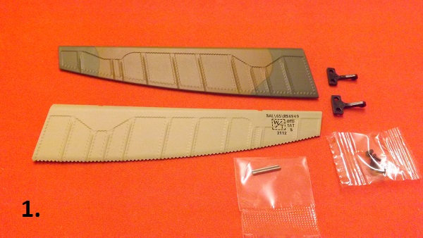

ISSUE 38 – ASSEMBLING AND FITTING THE RIGHT AILERON
38-01 Right Aileron Upper Panel
38-02 Right Aileron Lower Panel
38-03 Right Aileron Hinge (marked 1)
38-04 Right Aileron Hinge (marked 2)
38-05 Two Hinge Pins
38-06 Five PB 1.7 x 3mm Screws (1 spare)
PICTURE 2
Construction of this part follows exactly the same directions as with the left aileron assembled in the previous issue.

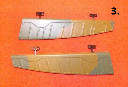

PICTURE 3

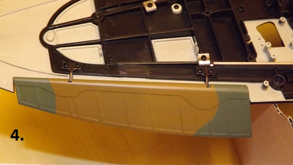

When complete we are left with the left and right aileron ready to be installed onto the wing assembly.
PICTURE 4
The ailerons are screwed to the lower wing assembly using 4 PB screws.

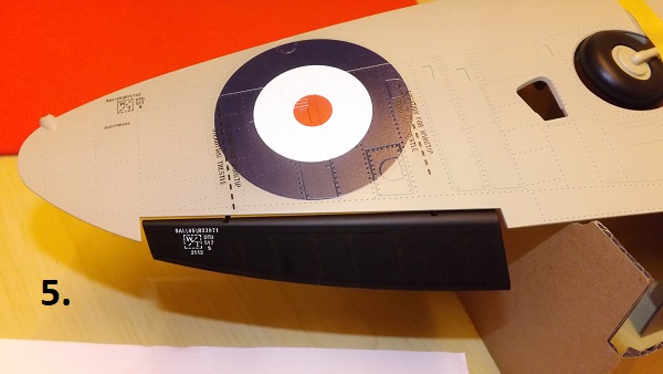

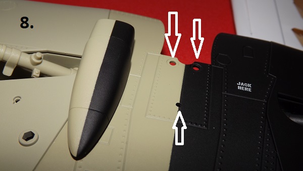

PICTURES 5 & 6

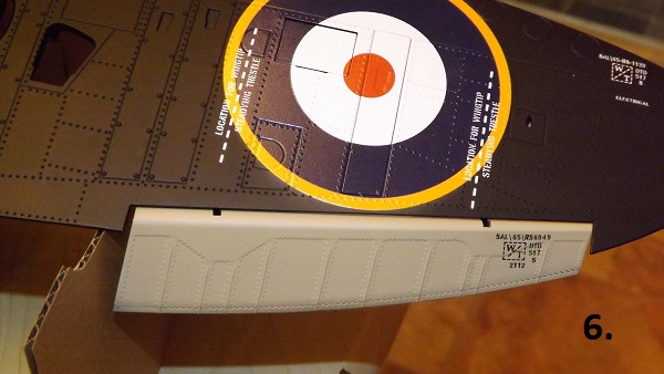

And its at this point, turning the lower wing over, I thought “Oh no what have I done wrong?” as we end up with the sky coloured aileron on the black wing and the black aileron on the sky coloured wing.
To me this looks so wrong. However, having looked at some of the build sites while uncommon its not unheard of for the ailerons to be fitted in this way (just me wishing they had kept the aileron and wing halves the same colour).
So, there we have it – 8 stages finished and finally updated. Again, my apologies for the lack of contribution of late but life has been turned on its head for me and going from steady no major issues life only a few weeks ago the loss of my mother is something I am going to struggle with for a very long time, I think.
Until the next time Stay Safe and happy modelling.

The mismatched undersides of the ailerons were quite common on the real aircraft and I think was intended to help break up the aircrafts' silhouette when viewed by the enemy from beneath?

Hi all, Reading up on the Spitfire History a probable explanation to the mismatch of ailerons might have been caused by the wrong kit of parts being sent with the aircraft for assembly at airfields. The parts were prepainted and somebody somewhere was careless and didn't notice they were painting the wrong colour, rather than return parts for repainting and waste time they used them as they were. Overpainting was ruled out as it was afraid it would upset the balance of the flying controls.Not sure this would have been the case but that was the reason given by top brass.

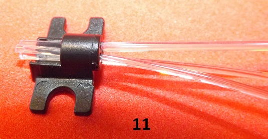

ISSUE 39 – HOLDERS FOR THE OPTICAL FIBRES (Same build parts and sequence is used in ISSUE 41)

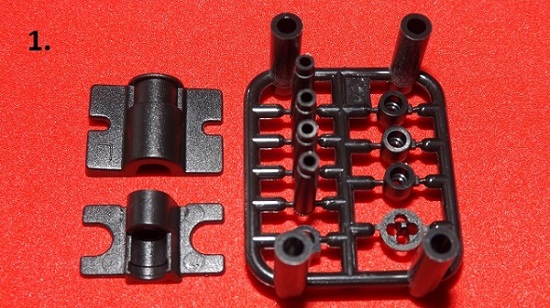

PARTS CHECKLIST - PICTURE 1
39-01 Frame with parts for the optical fibre holders (A to D)
39-02 Optical fibre grip
39-03 Optical fibre grip

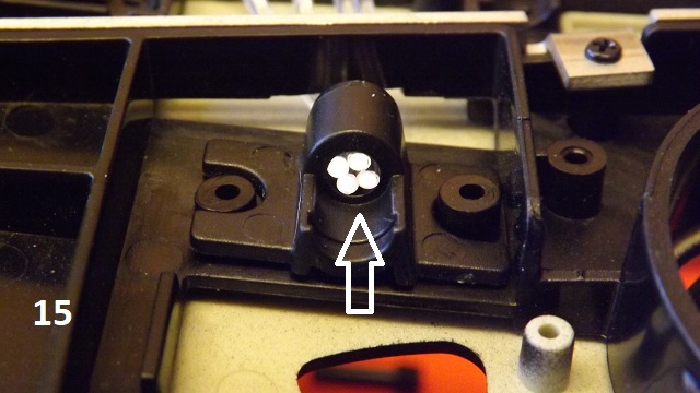

PICTURE 2

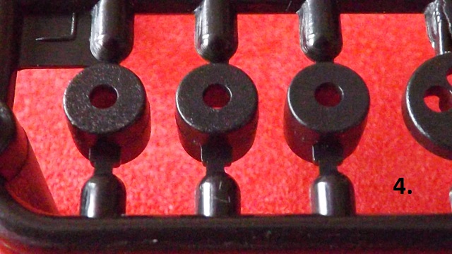

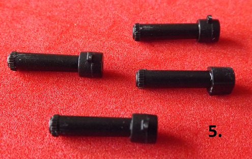

We start by snipping off the 4-machine gun barrel ends from the fret.

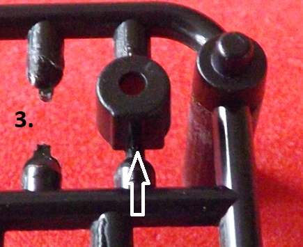

PICTURES 3 & 4
We then need to cut out the 4 barrel supports from the Fret.
Its worth noting that the mount on the holder that holds the longest of the fibre optics has a square base (pic 3) where as the other 3 have a “peg” base.
PICTURE 5
We then glue each of the barrel supports onto one of the barrels.
For this I opted to use Tamiya extra thin so as to avoid having to use superglue which is not a favourite product of mine at all.
And that, believe it or not, is all we do in issue 39 and the same again in issue 41.

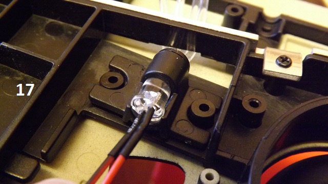

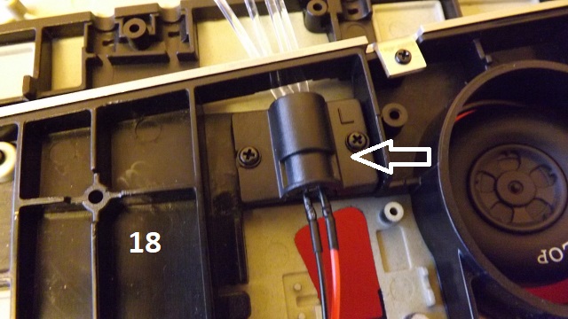

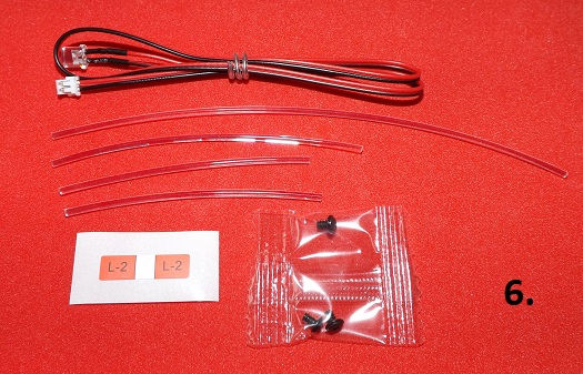

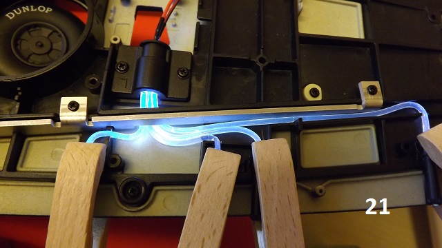

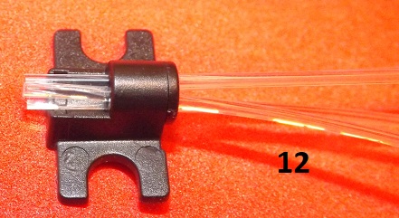

ISSUE 40 – FITTING OPTICAL FIBRES TO THE LEFT-WING (Same build parts and sequence is used in ISSUE 42)
PARTS CHECKLIST - PICTURE 6
40-01 Optical Fibres x 2 short
40-02 Optical Fibre Medium
40-03 Optical Fibre Long

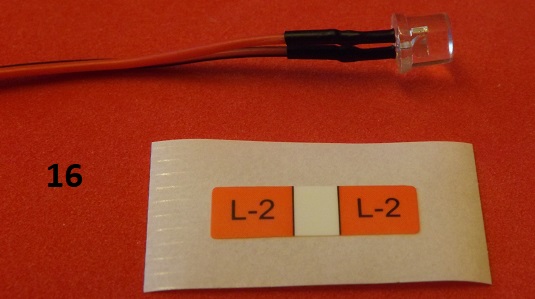

40-04 LED and Cable
40-05 Three PWB 2 x 3mm screws (1 spare)
40-06 Cable Label

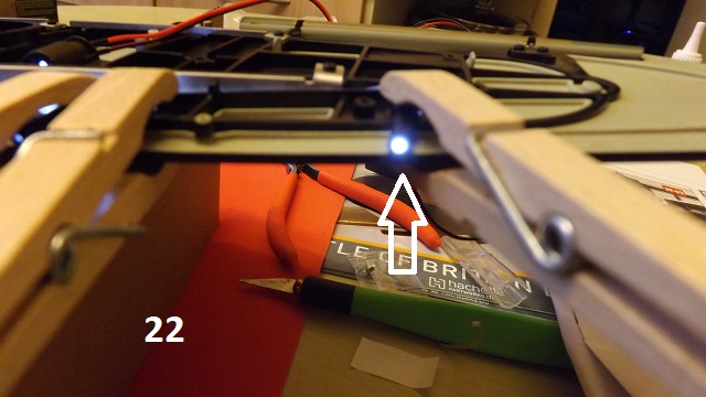

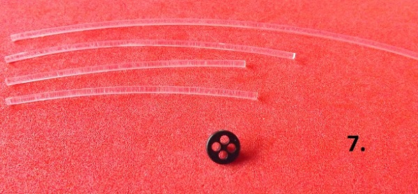

PICTURE 7

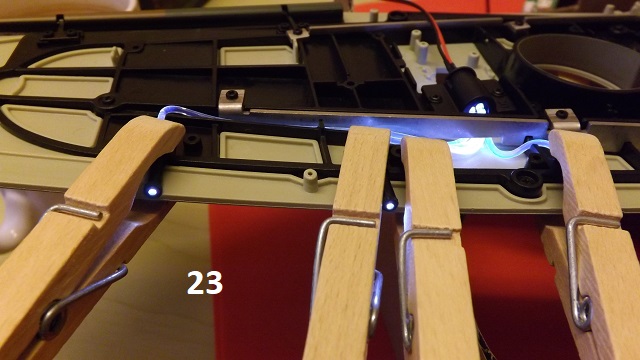

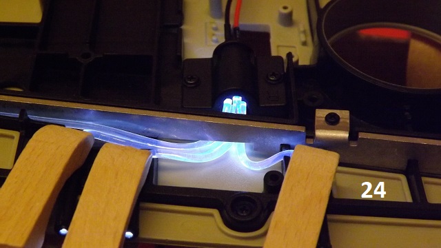

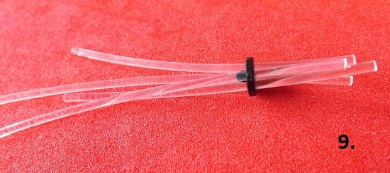

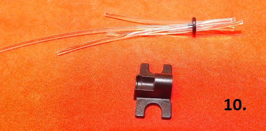

We start by taking the 4 optical fibres plus the optical fibre guide from the previous issue.

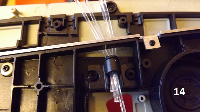

PICTURE 8
The 4 holes in the fibre guide form a “square” of 2 holes up and 2 down. As you can see in this picture the sequence in which the fibres need to be inserted is not very easy to see, so it takes a bit of thinking about to get this correct.
PICTURE 9
And here is the guide with the 4 fibres in place. They are not glued in as they need to be adjusted later, plus various brackets will hold them secure later.
You are told NOT to get glue on the fibres as it will affect the light path through the fibre.
PICTURE 10
Next up is the Fibre Optic Grip.
PICTURES 11 & 12
Into this grip we fit the fibre optic guide. This is just a press fit into place.
PICTURES 13 & 14
Here we can see the location in the wing that the Optical Fibre Grip will be fitted.
As we fit this into position, we need to pass each of the fibres under the metal strength beam.
PICTURE 15
Once in place we push each of the fibres forward so that they are all level with the face of the fibre guide.
Even with no additional light (just daylight here) we can see that the ends of the fibres do transmit a good amount of light.

Next up we take the cable label and this is wrapped around the supplied LED.
PICTURE 17
We then fit the LED in position behind the fibre guide in the wing.
PICTURE 18
Holding the LED in place (it has a tendency to move) we fit the optical fibre grip top cover and secure this in place with 2 of the supplied screws.

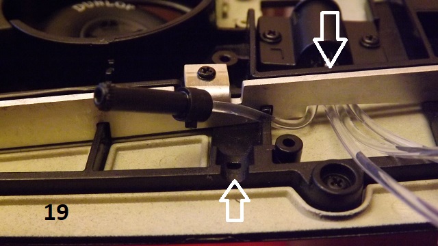

PICTURES 19 & 20
Its then time to “thread” the fibres along the wing and to then secure the barrels in position.
Little bit fiddly this part and needs a little care and patience to get right.

And here we can see the LED illuminated using the test board and battery pack supplied much earlier in the built.
Interesting points people have raised on other build sites have seen some builds either covering the exposed fibre with black tape, or in one example I have seen, using heat shrink along the whole length of each fibre.
I think the concern is “light bleed” and that the path of the fibres may shine through the surface of the top wing.
I am not sure that will be an issue but if it is there is still time to correct this at a later stage.
The other issue people have reported is the fact the barrel ends illuminate white. Some builders have suggested a gun flash would be more yellow and in one instance I have seen a builder post details of using micro crystal clear and Tamiya clear yellow to colour the end of the fibre.
Again, personal choice and at this point I have not decided if I want to modify mine or not.
PICTURES 23 & 24
Here we can see the barrels glued in place and being held firm with planking pegs while the glue sets.
Again, I have opted to use Tamiya extra thin and the final joint is very strong.
PICTURE 25
And this is a final overhead shot of the lower wing with both port and starboard fibres and gun barrels in place.
To be honest the complete build of those 4 issues took a fraction of the time to assemble compared to actually writing up the process.
