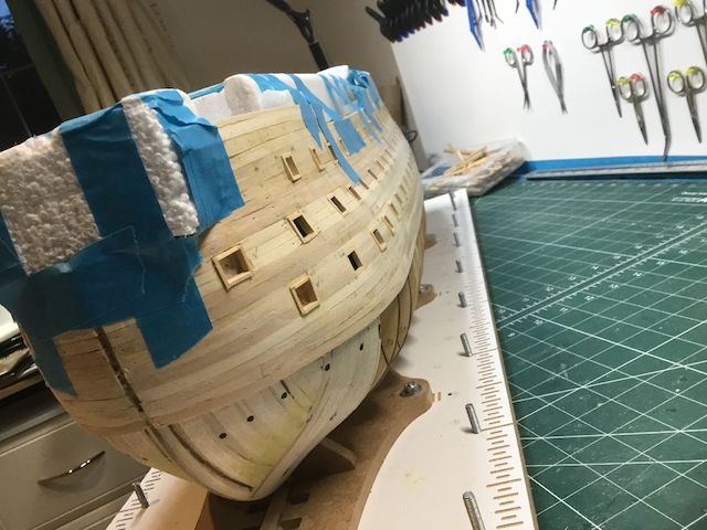

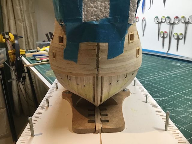

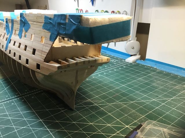

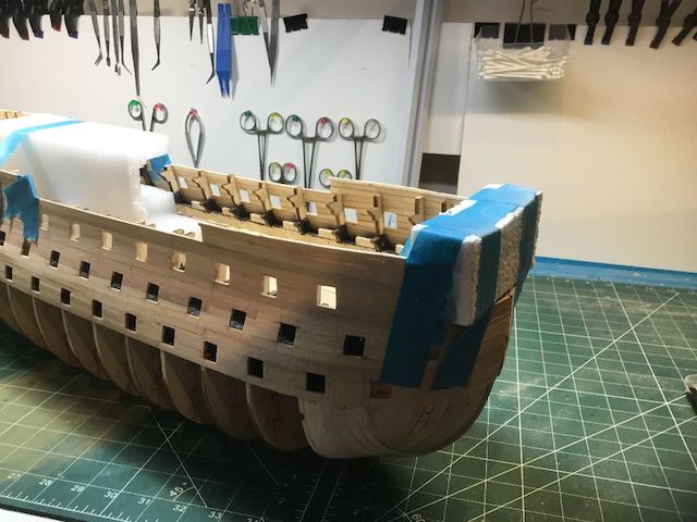

I finally completed the upper planking and as the bow planks were quite close to 14mm above the deck supports, I added an extra narrow strip. Closed off the gallery support brackets and taped in some polystyrene packing so that the lower hull can be planked.
Any comments, good or bad please, would be appreciated.

No comments at all. It looks great, Chris.
#103 Posted : 24 October 2019 22:49:11
Coming along nicely Goddo, nicely done....Cool Cool
#104 Posted : 25 October 2019 07:23:41
Hi Chris,
Looking good!!! It's a good idea using all that polystyrene reinforcing.
#105 Posted : 25 October 2019 09:14:53
Posts: 6,968
Points: 21,211
Looking excellent.Love

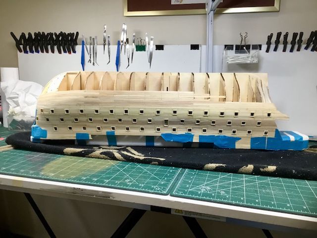

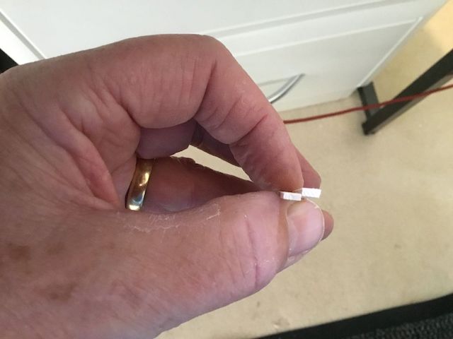

I have been lining the gun ports using 1.5 x 4mm as supplied. All was fine on the port side.
Then I made a mistake. I lined a complete row of starboard gun ports without looking at the planks too closely
until I tried my little home made 9mm x 9mm guage in the finished openings. I couldn't understand why it just wasn't passing through until I looked again at the planks. They were 2mm thick so now I have the job of sanding back the openings to get them to 9mm square. At least it was only one row.
Lesson learnt: Even though the package says they were 1.5mm, always check them first.

All looks great to me, nice build.
Dont worry, we all made mistakes. Until you can corrct it without too much damage, it’s OK. Cool
Happy building!

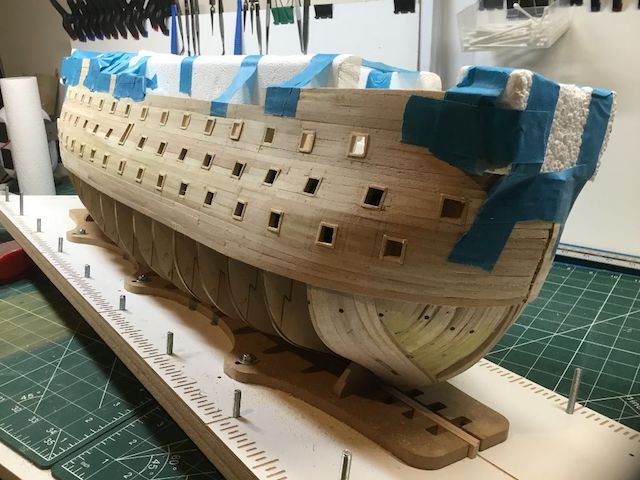

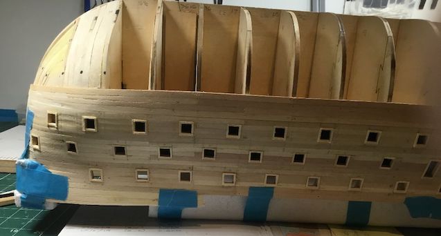

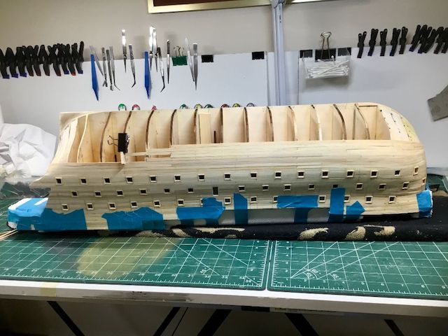

Update photos now that first four rows of lower planking are complete.
Gun ports all lined, including the two beneath the gallery.
goddo attached the following image(s):
#109 Posted : 10 November 2019 21:28:48
Well done on getting all your port openings lined.
That is a massive load of work and one of the areas that does get tedious.
Your getting on really well with your build.
Hope it continues well.

A couple more progress photos here.
hull 1.jpeg (33kb) downloaded 40 time(s).
hul 2.jpeg (52kb) downloaded 37 time(s).

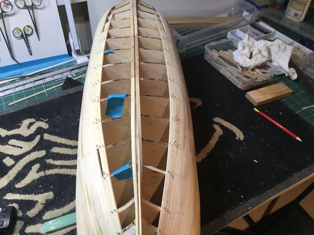

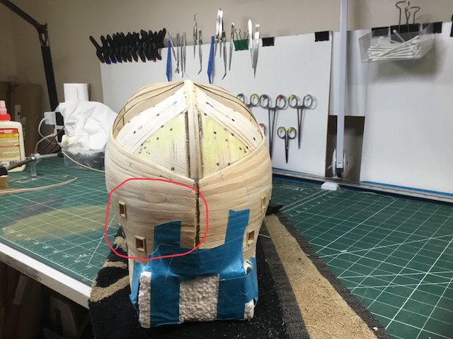

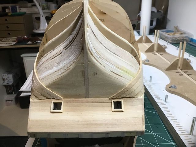

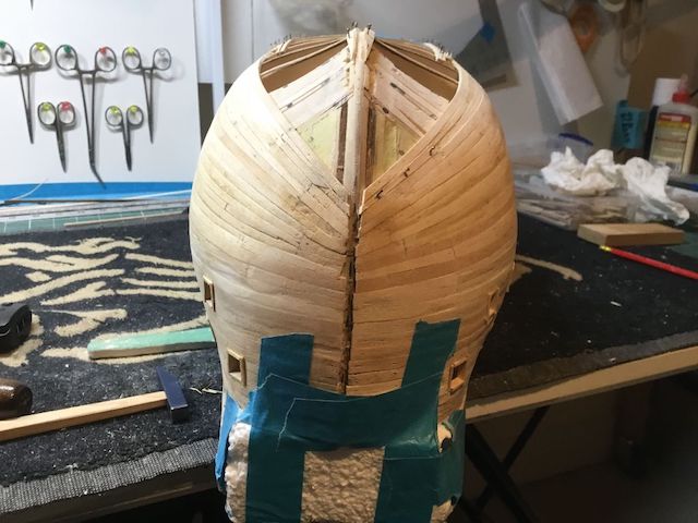

More planking progress but I have developed a few "dipped" areas along the way.
Hopefully, once the hull is sanded, the dips will be reduced and the rest can be taken care of with filler.

Thanks for the advice Alan. I must admit that you had already informed me of this so my fault entirely.

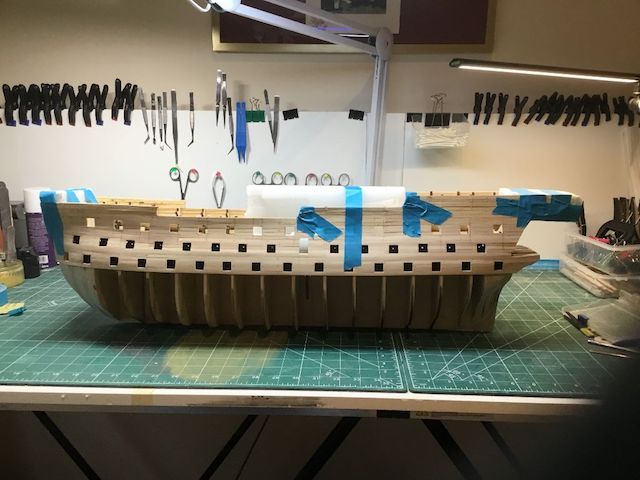

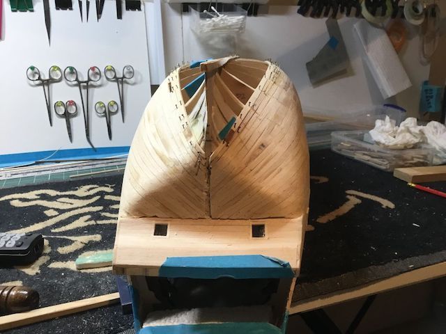

A little bit of progress on the hull planking.
I'm hoping to get the final planks on over the holiday and then sanding down will begin.
The "dips" I'm experiencing haven't been too onerous and I have had a go at filling a couple with 0.5mm thick strips and sanding back. It seems to be working at the moment.
