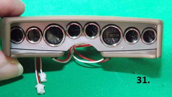

STAGE 53 – ATTACHING THE INSTRUMENT PANEL
PICTURE 31
The parts included this time are
Instrument Panel x 1
We Also Need from Earlier Stages:
Underbody (Stage 51)
Dashboard (Stage 52)
M2.6 x 6mm self tapping screws x 2 (Stage 50)
LED Tester (Stage 28)

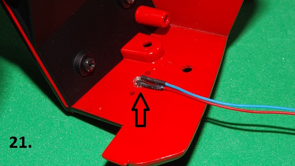

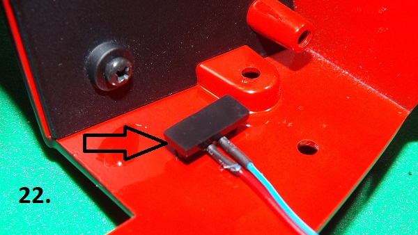

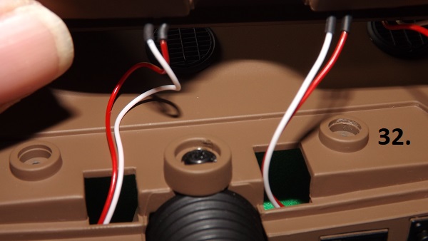

There are 2 wires coming from the Instrument Panel and these are tested using the LED socket n the test board and all works just fine.
PICTURE 32
We then pass these 2 wires down through the holes in the dashboard.
PICTURES 33 & 34

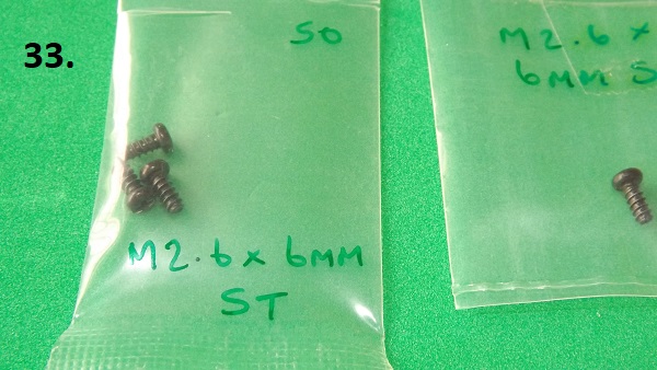

Really important to label the screws as they arrive or trying to work out which ones are needed becomes very difficult as many of them look so alike.
Here we use 2 x M2.6 x 6mm Self Tapping to secure the Instrument Panel to the Dashboard.

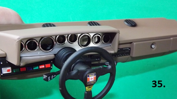

PICTURE 35
And this is what the final assembly looks like.

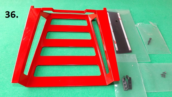

STAGE 54 –THE BONNET 1
PICTURE 36
Bonnet
Rain Guard Plate
Left Bonnet Hinge
Right Bonnet Hinge
M1.7 x 4mm countersunk screws x 3
M2.3 x 6mm self Tapping screws x 2
PICTURE 37
We first off identify the left and right hinges.
PICTURE 38
These are installed on the bonnet using M1.7 x 4mm countersunk screws.
PICTURE 39
We then take the rain guard and remove the tape covering the self-adhesive strips already fitted to this part.
PICTURES 40 & 41
The rain guard is then press fitted into place and that completes this section of the build.

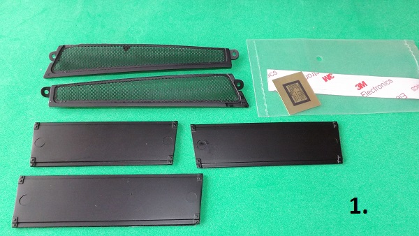

STAGE 55 – THE BONNET 2
PICTURE 1
Bonnet Strut
Bonnet Mesh L
Bonnet Mesh R
Guard Plate A
Guard Plate B
Guard Plate C
Double Sided Tape
Agip Logo Sticker
2 x 5mm countersunk Screws x 2
2 x 4mm countersunk Screws x 5

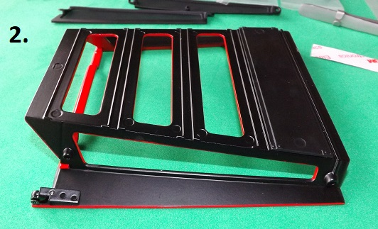

We also need to collect some previous parts – namely

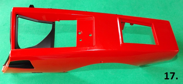

PICTURE 2
Bonnet (Stage 54)

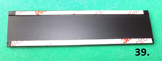

PICTURE 3

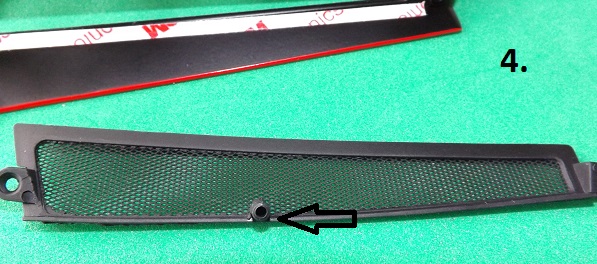

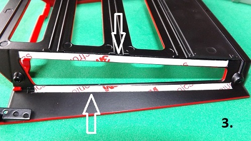

We start off by fixing 2 lengths of the double-sided tap to the sides of the Bonnet.
The lower tape you can see in this picture needs to be fixed so it matches the angle of the bonnet side.

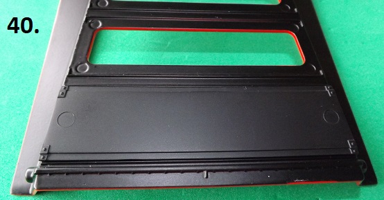

PICTURES 4 & 5
Making sure we have the correct grill (for this side the one with the mounting post for the bonnet stay (, and press fit onto the tape we have just put in place.
We then screw this grill panel in place using 2 of the 2 x 4mm countersunk screws.
We then do exactly the same on the right side of the bonnet.

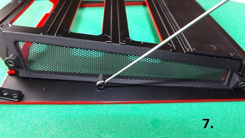

PICTURES 6 & 7

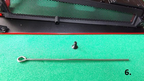

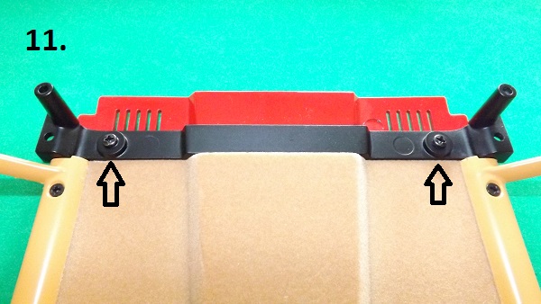

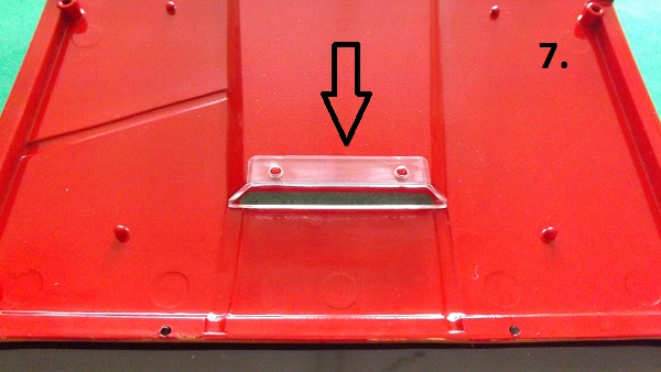

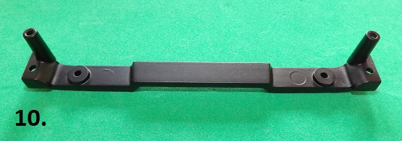

We then take the Bonnet Stay and 1 x 2 x 5mm countersunk screws. This part needs to be screwed into place allowing the stay rod to still have some movement.

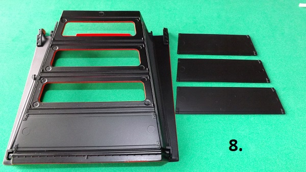

PICTURES 8 & 9

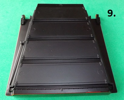

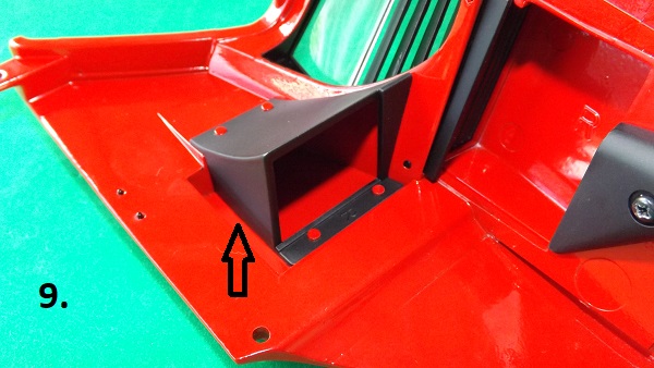

Next, we take the 3 guard plates, and ensuring we have them in size order, we remove the already installed tape cover and press fit these into place on the bonnet.

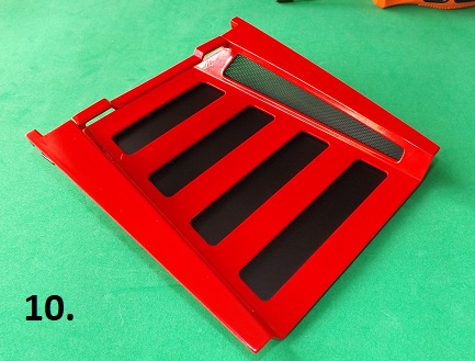

PICTURE 10
And when in place this is what the bonnet looks like.

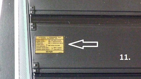

PICTURE 11
Last part to do on the bonnet is to fix the Agip label into place and that is all that is needed in this build stage.

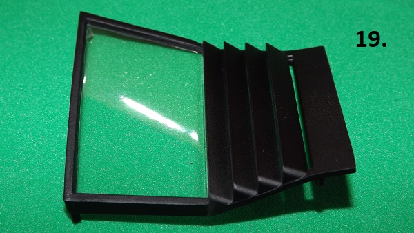

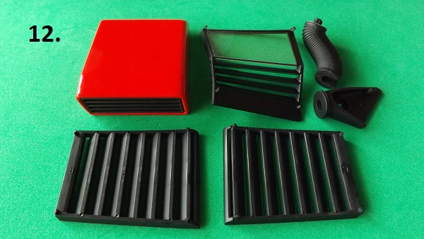

STAGE 56 – THE LEFT AIR DUCT HOSE
PICTURE 12
The Parts Included This Time Are
Left Rear Quarter Window
Left Air Intake
Left Air Duct Hose
Left Outlet Louvre
Right Outlet Louvre
Left Air Duct

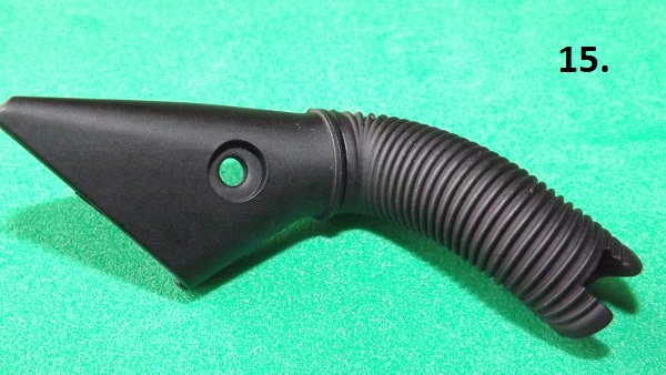

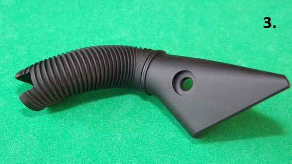

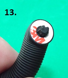

PICTURES 13 & 14
We first off remove the “3m” paper from the already installed double sided tape.
The connection between the hose and the hose inlet are keyed so very little chance of putting these together incorrectly.
PICTURE 15
Once joined this is what the assembly looks like.

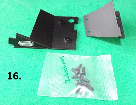

PICTURES 16, 17 & 18

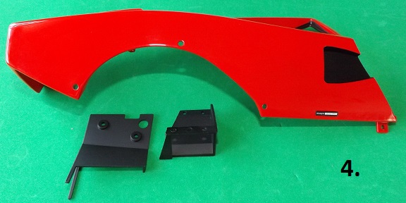

Left Rear Wheel Box
Left Hot Air Deflector
Left Intake Housing
2.6mm x 6mm screws x 9

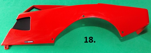

First disappointment with the kit so far in that the rear panel has some “bubbles” in the paint finish.
I just cannot be bothered to raise it as an issue and hopefully it will polish out with a touch of Novus polish.

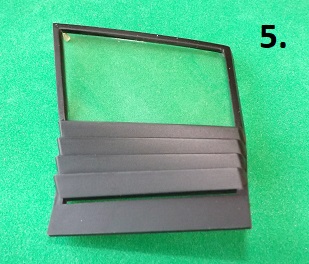

PICTURES 19 & 20
We start with the left rear quarter window which has 4 tabs that are press fitted into the matching holes in the wheel box panel.
PICTURES 21, 22 & 23

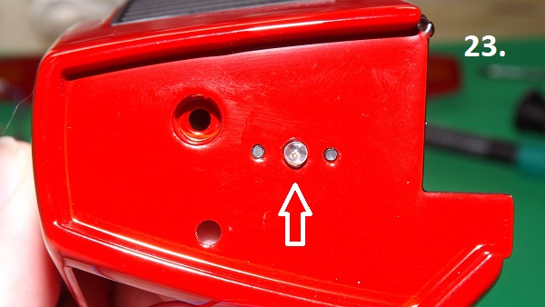

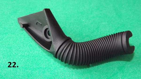

We then take the Hose assembly, left air intake and left intake housing and fix all 3 component parts to the Wheel Box
PICTURES 25 & 26
We then take the left hot air deflector and screw this into position on the Wheel Box.
PICTURE 27

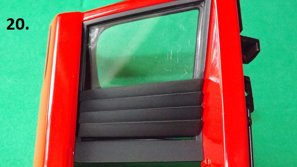

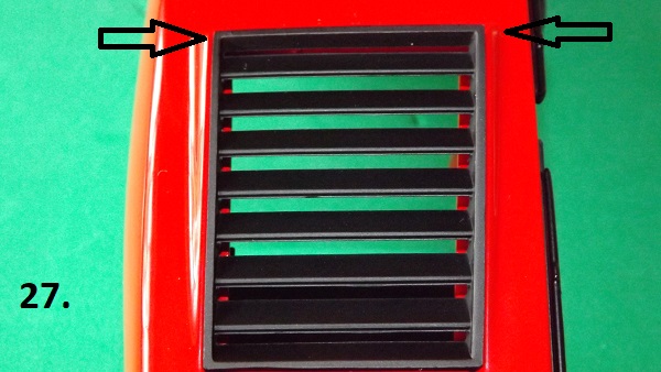

Sadly, another disappointment with this part.
It’s the Left Outlet Louvres and you are told to press fit the 4 pegs on this part into the 4 holes in the Wheel Box.
Unfortunately, on the part I have the part will not fully clip into place at its from end and sits proud of the surrounding bodywork.
May have to resort to gluing this part in place but very, very reluctant to use any of the superglue I presently have as it’s the sort that leaves a white fog on everything.
So, there we have it for this month with a fairly quick and easy assembly of this pack.
Bit disappointed with the paint on the wheel box as so far all of the parts supplied have been of the highest quality
Until the next time Stay Safe and Happy Modelling.

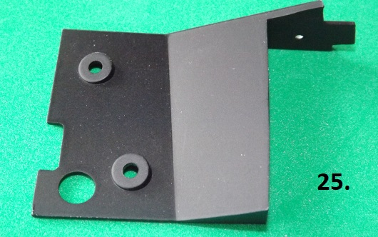

STAGE 58 – THE RIGHT AIR DUCT HOSE

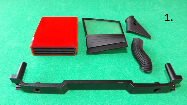

PICTURE 1
Right Rear Quarter Window
Right Air Intake
Right Air Duct
Right Air Duct Hose
Rear Body Support
PICTURE 2

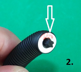

We start off by removing the backing paper disc from the double-sided tape already in place at the end of the Right Air Duct Hose.
PICTURE 3
We then join the Right Air Duct Hose to the Right Air Duct.
These parts are “Keyed” so there is little chance of getting the assembly wrong.
And that has to be one of the easiest and quickest stages so far in the build.

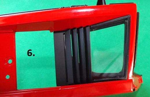

PICTURES 5 & 6
We start by taking the Right Rear Quarter Window and press fitting this into place in the Rear Wheel Box.

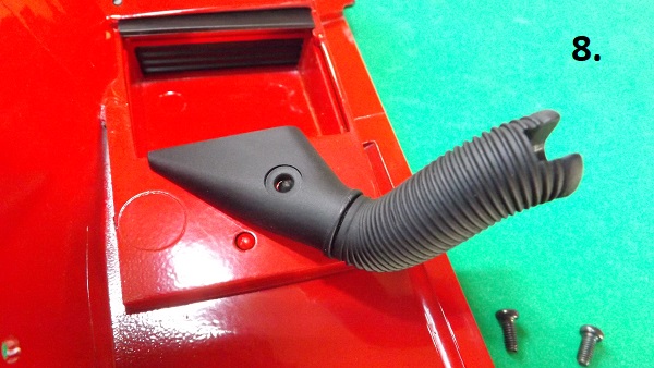

PICTURE 8
Next up is the Right Air Duct Hose we assembled in the previous stage.
This is fitted in place and again secured with 1 x 2.6 x 6mm screws.

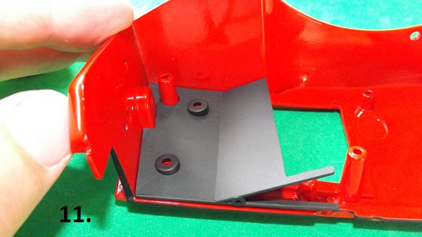

PICTURES 10 & 11
The Right Hot Air Deflector is next up and this sits down very neatly over the position its designed for.
Its held in place with 2 x 2.6 x 6mm screws.

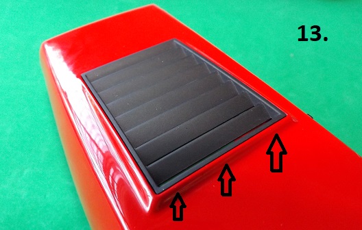

Last part of this stage is to press fit the Right Outlet Louvres into position on the Rear Wheel Box.
This went into place just perfectly and the fit (arrows in pic 13) is spot on.
Sadly, the left Rear Wheel Box I had issues with and this part does not fit flush so on that a dab of superglue will have to be employed.

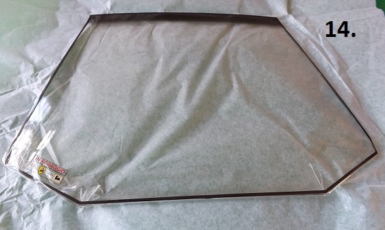

PICTURES 14 & 15

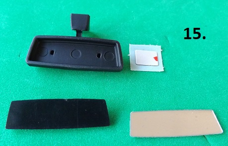

Windscreen
Strong Double-Sided Tape
Mirror Housing
Mirror Base
Mirror

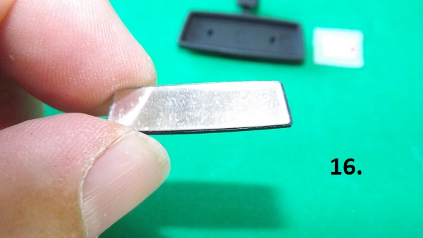

PICTURE 16
We start by removing the backing paper from the rear of the mirror and carefully aligning the mirror with the mirror base before pressing the 2 parts together.
The mirror is fractionally smaller than the backing so we want to align these 2 parts so we get a neat, symmetrical edge all the way around.
PICTURE 17
All that we then need to do in order to complete this stage is to press the mirror/backing into the mirror housing.
And that is it for this pack. All very quick and simple on this occasion.

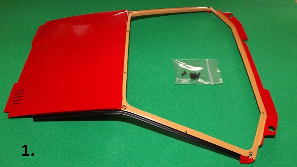

STAGE 61 – THE WINDSCREEN
PICTURE 1
Roof and Windscreen Frame
2 x 5mm countersunk screws x 5

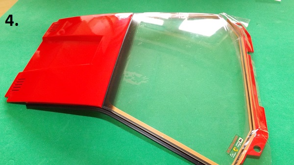

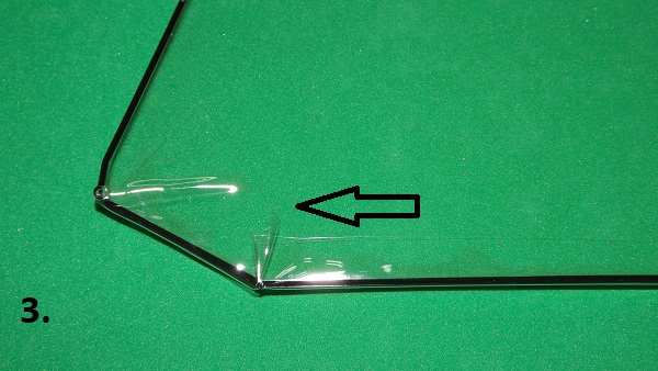

PICTURES 2 & 3
We start off by recovering the windscreen supplied in stage 60.

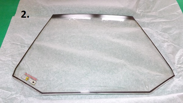

It’s going to be fitted into the windscreen frame but before we can do that, we need to peel back some of the protective film that wraps around the windscreen.
PICTURE 4
The windscreen is fixed in place using 4 of the 2 x 5mm countersunk screws.

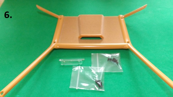

STAGE 62 – THE ROOF LINING
PICTURE 6
Roof Lining
Periscope Window
2.6 x 6mm screws x 3
2 x 4mm countersunk screws x 7
From Previous Issues we also need the following:
Rear Body Support (Stage 58)
Roof and windscreen (Stage 61)
PICTURE 7
We start by press fitting the periscope window over the 2 pegs on the roof section.

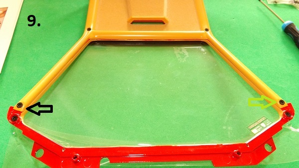

PICTURES 8 & 9

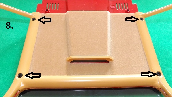

We then fit the roof lining into place and this is secured (holding the periscope window secure) with 6 x 2 x 4mm screws.
The arrows in these 2 pictures show were the screws are fitted.

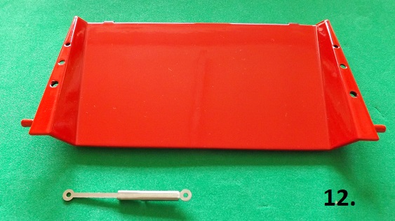

STAGE 63 – THE BOOT COVER LINING
PICTURE 12
Boot Cover Lining
Boot Cover Lining Stay
2 x 4mm screws x 3
1.7 x 4mm screws x 2

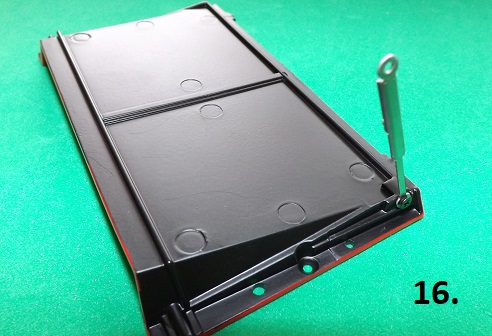

PICTURE 16
Very simple assembly stage here.
All we need to do is secure the Stay to the Boot Cover Lining using 1 x 1.7 x 4mm screws.
We need to tighten that screw just enough to leave some movement on the Stay Arm.

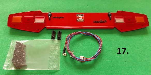

STAGE 6 – THE TAIL PANEL
PICTURE 17
Tail Panel
Tail Lamp LEDs x 2
LED Stoppers
2.6 x 6mm screws x 19
Main Assembly (Stage 54)
Left Rear Wheel Box (Stage 57)
Right Rear Wheel Box (Stage 59)
Boot Cover Lining (Stage 63)
AAA Alkaline Batteries x 3

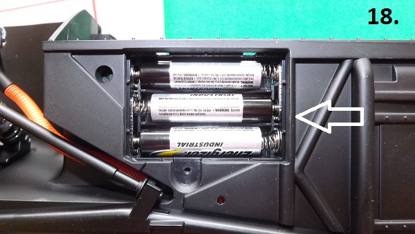

PICTURE 18
We start by removing the battery cover from the main assembly.
I will be leaving this off for now and its been on and off a number of times in order to test various stages of the electrics.
We insert the 3 AAA batteries.
The lead from the battery box is plugged into the test board.
PICTURES 19 & 20
In turn we then plug in each of the Tail Lamp LED’s to make sure they work.
In this case both LED’s light so no problems with that.
PICTURE 21
We then press the LED into the hole in the rear wheel box.
Its actually quite a loose fit.
PICTURE 22
The LED is then secured by press fitting one of the LED Stoppers in place.

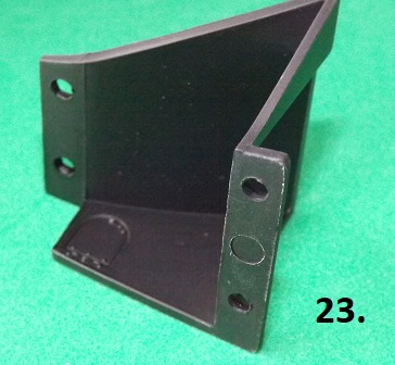

PICTURE 23
And here we can see the installed LED in place.
The same operation is carried out with the other Rear Wheel Box.

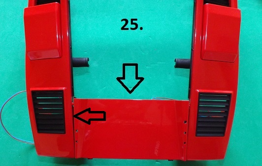

PICTURE 24

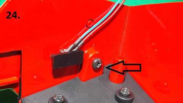

Taking the Tail Panel, we locate each Rear Wheel Box in place and using 1 2.6 x 6mm screws we fix the parts together.
PICTURE 25

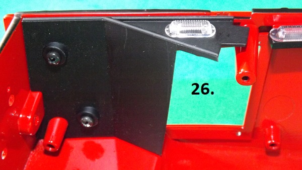

Before installing the second Rear Wheel Box we need to sandwich the Boot Cover Lining between the 2 parts.
When complete I did notice there is a slight splaying of the parts (left facing arrow) as there is nothing to hold the front section of this assembly together at this stage.
PICTURE 26
Beginning to look very sleek now.
PICTURE 27
Just to ease that slight splaying of the parts I decided to put an elastic band around the front section just to keep everything inline.
While an elastic band should cause no issues, I did still add a couple of pieces of paper between band and paintwork.
