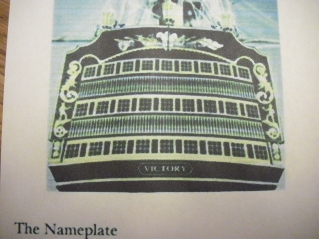

#104 Posted : 19 February 2013 23:35:09

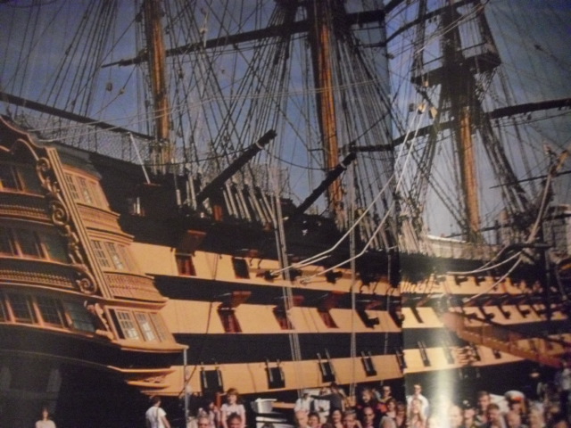

Hi Walter, firstly congratulations on the birth of your son, BigGrin I hope mother and baby are doing well.
I am pleased you have finished your Gallery to your liking, at the end of the day you pay your money and you make your choice that is what makes our models unique, but it is a fact that the side panels supplied in my Gallery enhancement are too scale and they are the correct size, infact they are oversize from top to bottem I will quote you from the instructions you have received:- THE ONLY DIFFERENCE IN FITTING RELATES TO THE HEIGHT OF THE QUARTER GALLERY SKINS. IN ORDER TO ENSURE THAT THE SKINS CAN BE FITTED TO ALL CUSTOMER MODELS, THE QUARTER GALLERY SKINS ARE TOO TALL - THAT IS TO SAY THEY ARE OVERSIZE FROM TOP TO BOTTEM. WHEN FITTING THE QUARTER GALLERY SKINS, IT WILL BE NECESSARY TO REMOVE SOME MATERIAL FROM THE TOP EDGE IN ORDER TO PRECISELY FIT YOUR MODEL.
NOTE; MATERIAL SHOULD ONLY BE REMOVED FROM THE TOP EDGE - DO NOT REMOVE MATERIAL FROM THE LOWER EDGE OR THE WINDOWS AND WINDOW FRAMES WILL BE MOVED OUT OF CORRECT ALIGNMENT.
This Gallery Enhancement was manufactured by the Company who produce the Rolls Royce of Victory models.
Maybe you did not do this?
You seem to be preoccupied with the windows being level with the gun ports, when they are not on the real VICTORY and should not be.
You were critical of other members builds, saying the side panels were too low and did not have the windows level with the gun ports.
Although you say you are happy with your hybrid, it is not accurate, the rear gallery skin should be curved (as shown in my tutorial)yours does not have this curve.
Your quarter gallery skins windows are much to large and you will not be able to fit the Brass etch ballustrades correctly as they should be.

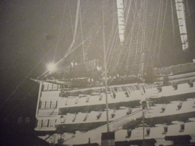

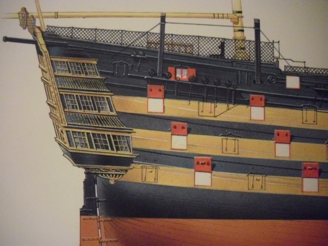

I have included some photos to show you that the windows on the quarter gallery on the Victory are not in line with the gunports you will see that they sit a little lower.
These are actual photos I have permission to use as they are not for gain

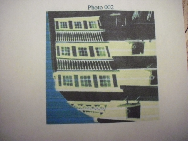

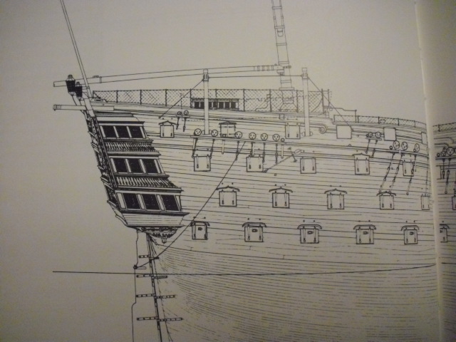

And finaly Walter these are the photos of the rear and side Gallery from the instructions you received, and your ship should have looked the same, only you know why it did notBlink;-
You purchased a kit from me that was correct and fit for purpose, but you chose to do somthing else with it and at the end of the day that is your choice
Kind Regards Mike

Maybe the windows are in scale, but as i said, they sit too low on the panel. Too low - so how could removing material from the top make them sit higher???
Also, the roof of the side gallery should begin just atop the upper row of windows. If you remove that much material from your parts, the roof starts way too low.
My modelling skills may by far not be on the level of most of the people here in the forum, but i`m no idiot! I do some research myself and also have some books with drawings of the victory.
You state something and your own photos show that you are wrong.
On the pictures you can clearely see that, whereas the first row of windows sits a little bit lower than the middle gun ports, the second and third row are almost level with the respective gun ports.
Now have a look at the build diary of Bernd, who, as one can see, is much more skilled than me. The upper edge of his third row of windows sits completely below the lower edge of the gunports.
He himself states, that the windows are too low and it has a somewhat awkward look.
No I don`t know, why it did not. My guess is, that this picture of the side gallery shows a different model than the DeAgostini one. Because if you fit the panels to the DeA-hull the upper row of windows in no way lines up with the respective gun ports, as it almost does in this picture. That fact again can be seen in Bernds build.
Why did your tutorial stop at exactly the point of fitting the parts to the hull? It`s been two months now since your last update. Maybe you`ve encountered the same problems???
You could proof me completely wrong by showing us, how you manage this.

I also have the book of McGowan and i don`t know which drawings you are referring to, cause in my book the upper egdes of the second and third row of windows are quite level with the upper edges of the respective gunports. (I´m not allowed to post a drawing for proof here).
On your model, the second row already sits a little too low - and when you will have cut the upper gun ports, you will see, that the upper row of windows will sit way too low.
Also by having removed material from the upper edge of the panel - as said in the tutorial - your roof also sits about 1 to 1 1/2cm too low in relation to the rear panel. (compare to the original picture of the victory in my last to previous post).
Don`t get me wrong, the way i biuld the side gallery, it also isn`t alike the original at all - i know that. Especially the windows itself of course look way better with the enhancement, but they are in the wrong place.

hi dadokta,I think you are being a bit unfair to mike,for a start you didn't follow his instructions on fitting the windows enhancement,the stern windows has a bend,yours has not,and I think the enhancement needs to be lifted slightly to get the correct alignment,a gifted builder like yourself would have done that automatically,so lets put this argument to bed and move on. good luck.
#114 Posted : 20 February 2013 16:11:19
Hi Karl,
believe me i`m not unfair. I won`t comment the enhamcement anymore as stated above.
But - what`s that thing about the stern windows? They have exactly the right bend - maybe the angle on the picture doesn`t show that.

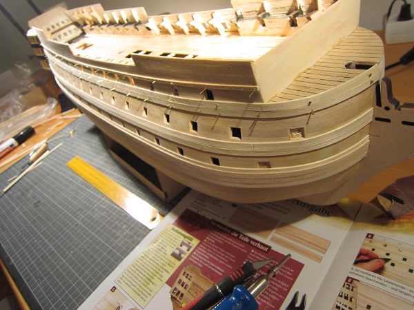

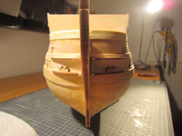

#117 Posted : 25 February 2013 14:23:30

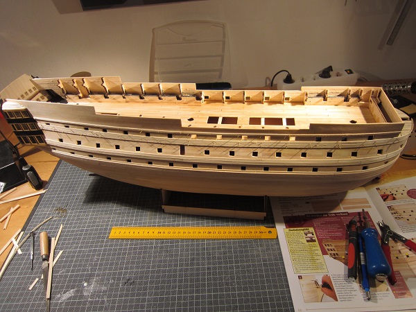

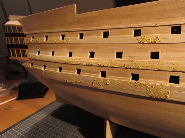

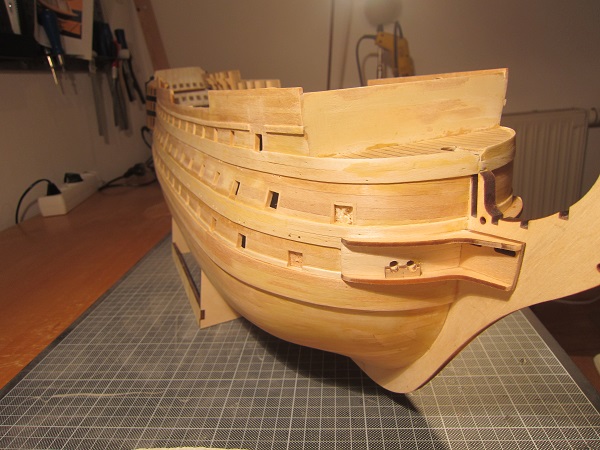

Hi guys,
i`ve been working on the wales lately.
All comments welcome!
#118 Posted : 25 February 2013 15:47:21
Coming along nicely Walter Cool
#119 Posted : 25 February 2013 21:28:26
Very nice looking build Walter, credit to you....
#120 Posted : 25 February 2013 23:33:14
Thanks Mr.T, Alan :)
