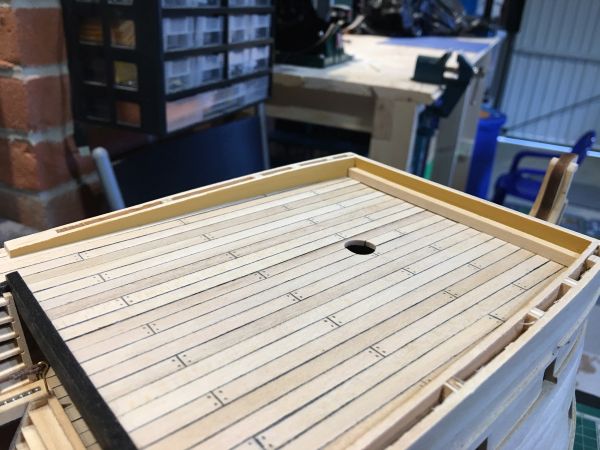

Bulwark insides at bow/poop painted yellow ochre... bow front inside wall partially painted black... cannon ball racks painted black and fitted... cover frame at middle of quarterdeck cut, painted and fitted.
Further bulwark covers added, small piece to middle of quarterdeck, one across the front at bow.

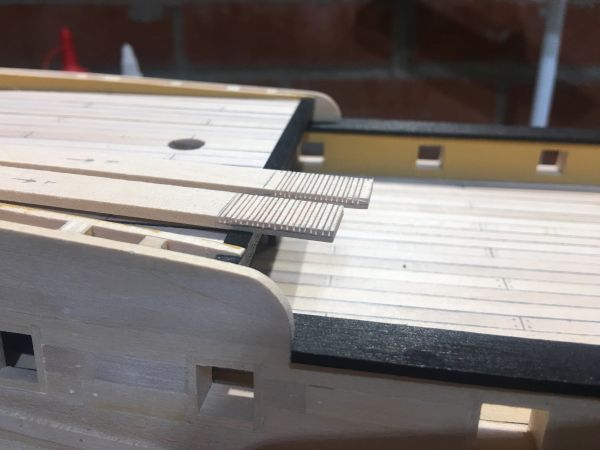

08/11/2017
Protruding ends of front wall bulwark cover cut to flush with side covers... made lots of shallow cuts for poop deck bulwark cover to able to bend it around its tight radius... now need to soak in water to make it more pliable...

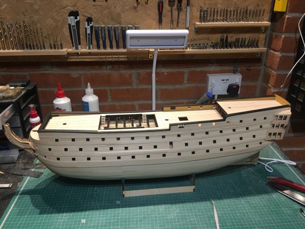

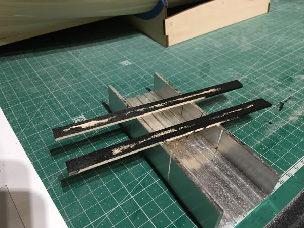

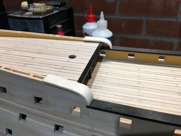

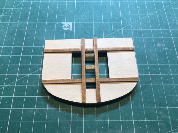

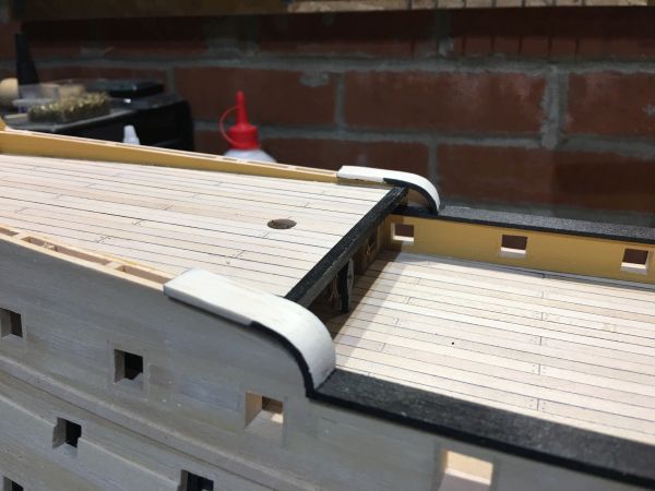

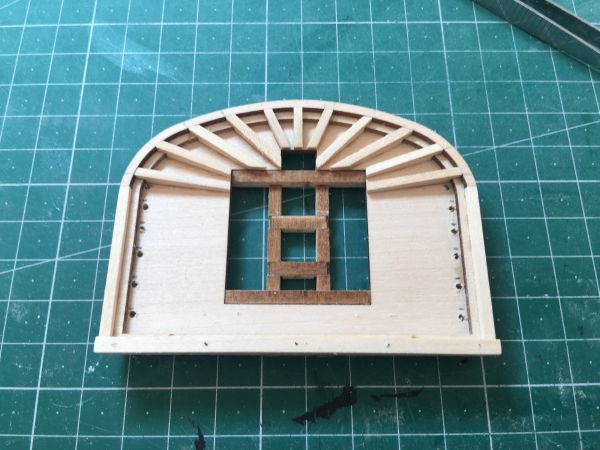

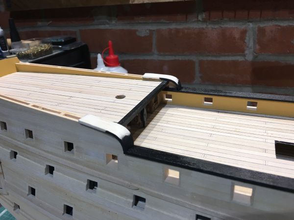

11/11/2017

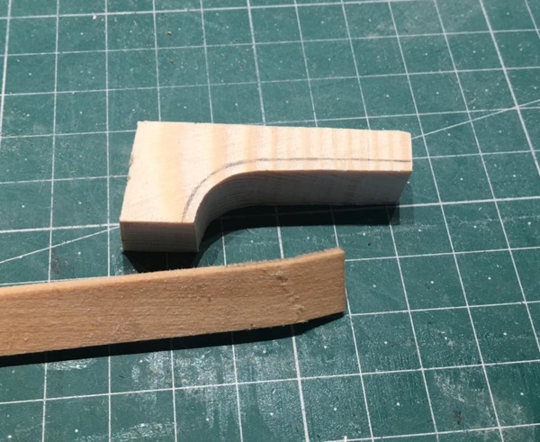

Plan A failed, the strip with shallow cuts, despite of soaking in water, snapped when tried to bend. As I have got limited number of strips in the kit I can’t afford to keep trying and maybe got succes for the 10th attempt 😳... here comes Plan B... I’ll form the curves from a block of hard wood by keep sanding them to shape...
GRRRR 😡🤬🤯 Plan B also didn’t work... the benefit of the hard wood (that it’s actually hard) becomes disadvantage during the final shaping when it’s only 2mm thick/thin and need sanded. It requires quite a force with the needle file while supported on the other side... now second piece snapped...
Plan C... try to make it from extreme soft wood (balsa).
Happy building!
Laszlo

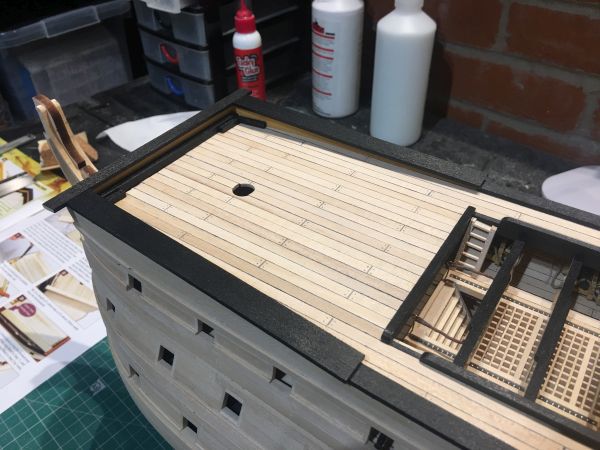

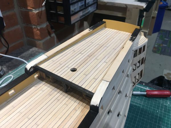

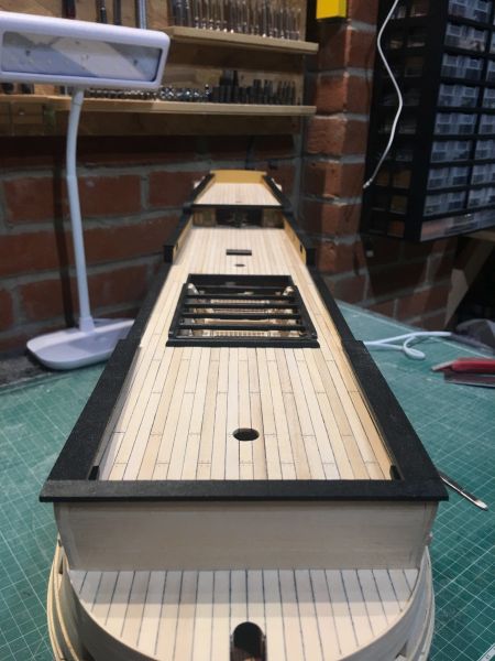

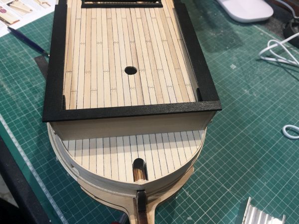

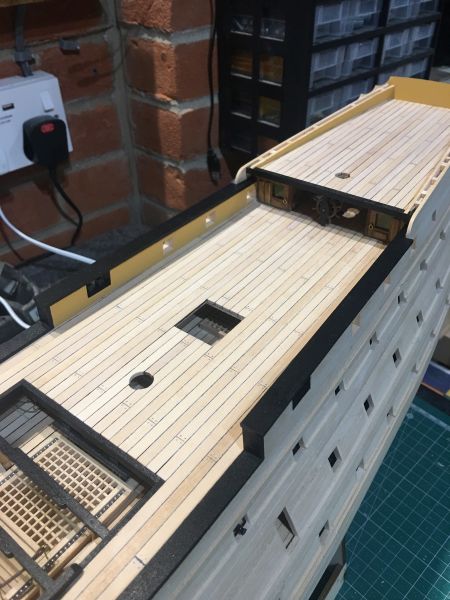

12/11/2017

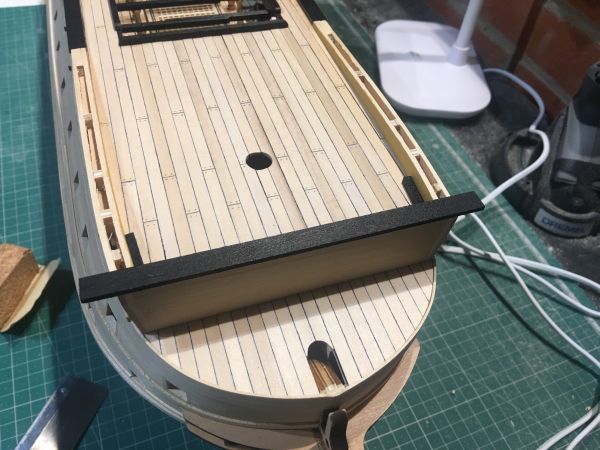

Plan C from balsa wood seems worked OK... well, still snapped twice but it wasn’t problem, I have lots of balsa blocks, also much quicker to shape it... two bulwark curved covers sanded... hopefully won’t cause problems later on that they’re very soft. Instructions checked in advance, they won’t be stressed.
Curved bulwark covers glued in place, partially painted. Will be fully painted after rear section of covers fitted and sanded flush. They cut to size already, partially painted, now waiting to get it dry. Will be glued in place just before I go to sleep to allow sanding and final painting tomorrow.
Rear section of poop deck bulwark covers glued in place. Will be sanded and painted tomorrow.
Happy building!

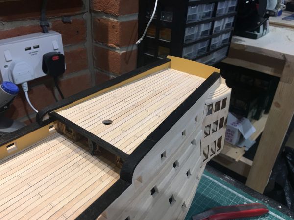

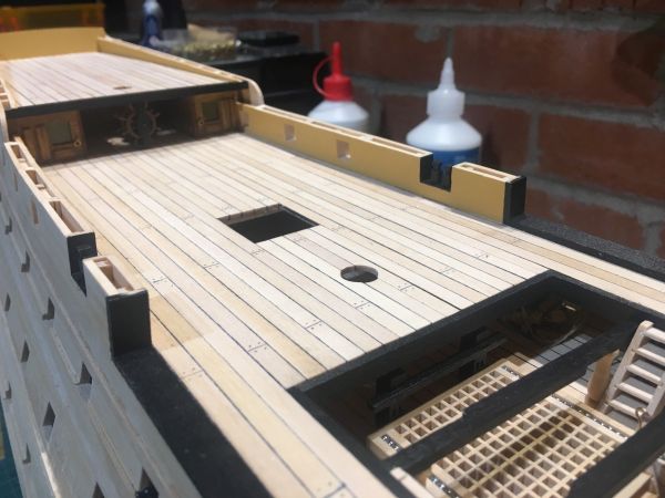

13/11/2017

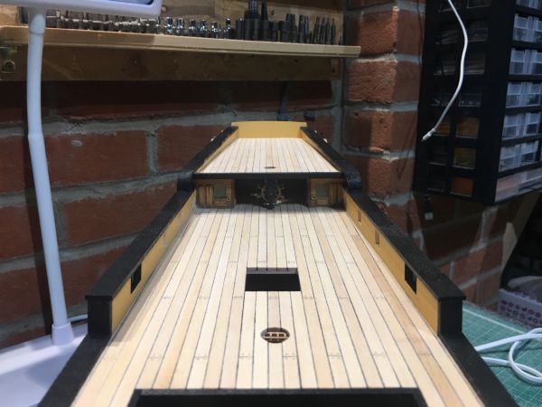

Poop deck bulwark covers sanded and painted.
Half way down to complete the ship. 😁😊 60 of the 120 magazine issues completed. The hull main structure now completed, will be put aside for a while. It looks quite good already. 😊Next time when it will be touched will start to paint the lower hull, but now let’s start working on the masts.
Happy building!
Laszlo

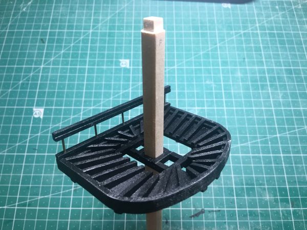

14/11/2017

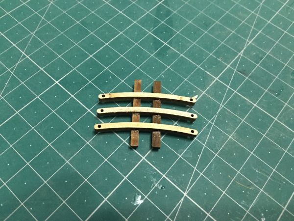

started to assemble the main mast fighting top, baseplate, surrounding frames and cross trees fitted together.

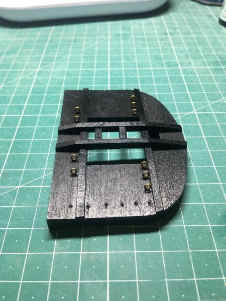

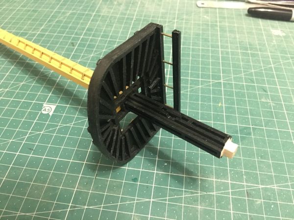

15/11/2017

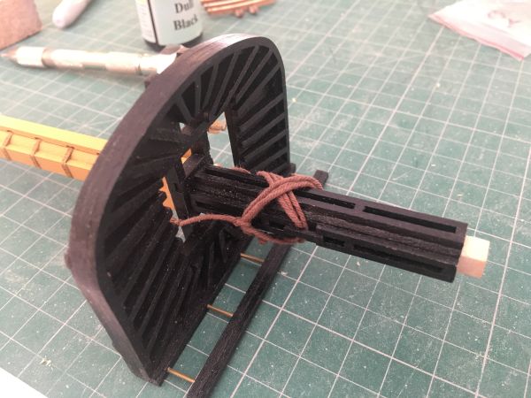

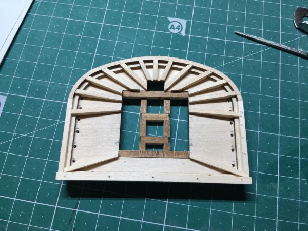

main mast fighting top... handrail top and bottom assembled, holes drilled for rigging blocks, started to fit the fighting top base strips. They are all different size and there are 27 of them, must be shaped individually. First three done and fitted.
Happy building!

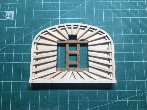

Further ribs fitted to main mast fighting top.
Four more ribs shaped and fitted to main mast fighting top

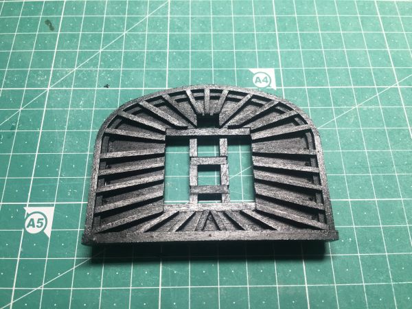

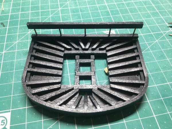

19/11/2017
remaining ribs fitted to main mast fighting top and the whole assembly painted black

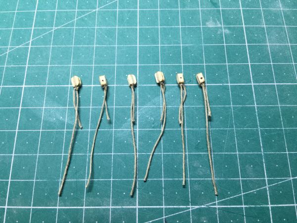

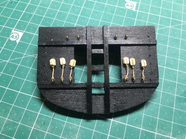

eyelets added to the bottom of fighting top... 6 blocks preapered for rigging then rigged to the eyelets... handrail painted and fitted

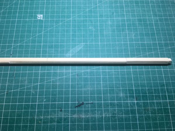

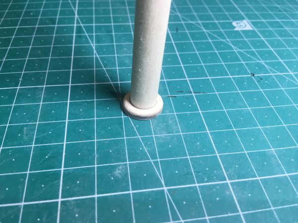

21/11/2017

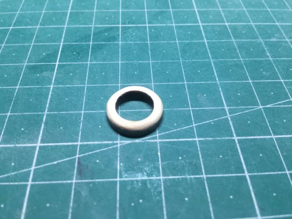

started to carve the main lower mast... main mast bottom trim ring also shaped.
Happy building!

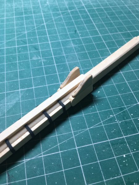

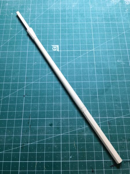

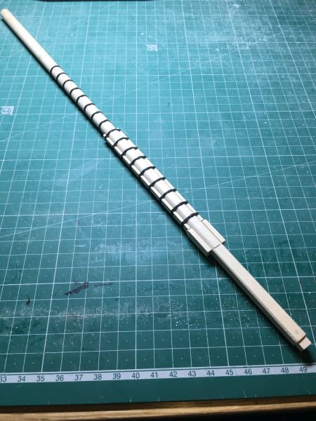

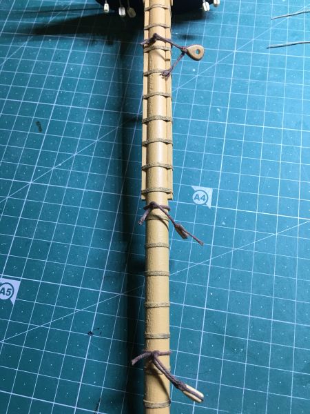

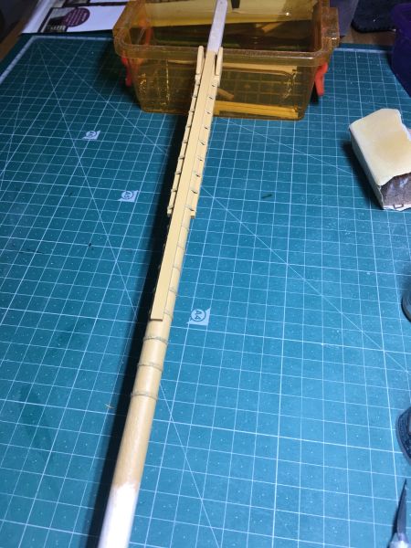

22/11/2017

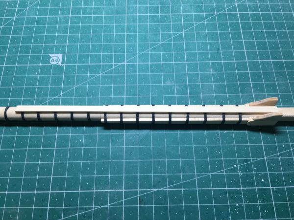

main lower mast carved further... top support strips shaped and fitted... 17 bindings made around the mast to support the support strips 😆... the knots hidden in a tricky way underneath the bindings
Happy building!

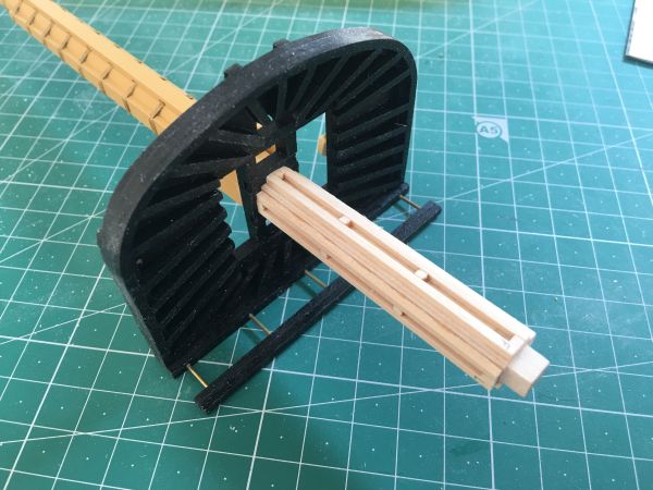

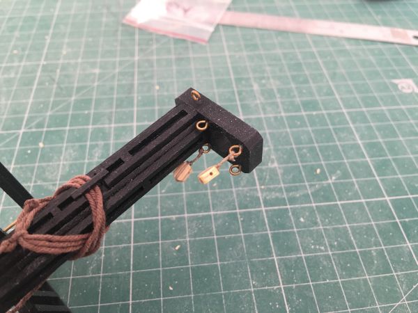

25/11/2017
Fighting top glued to main lower mast... battens fitted onto four sides of the mast top section.
Upper section of main lower mast painted black... main mast cross trees assembled... mast cap painted, prepared for rigging with eyelets and rigged blocks... main topmast shaped/carved

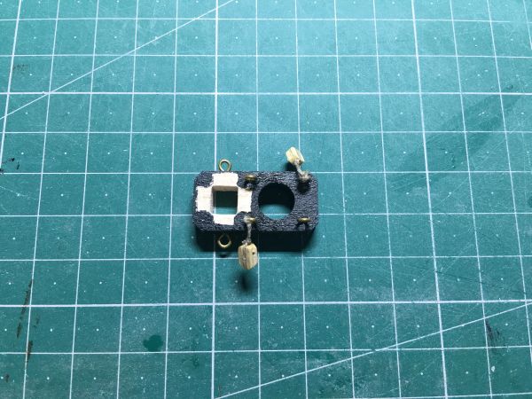

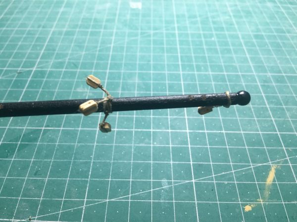

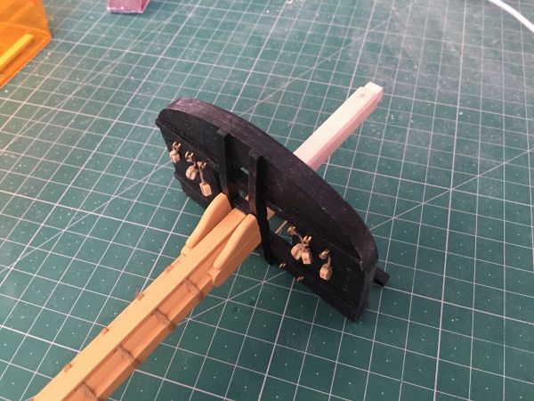

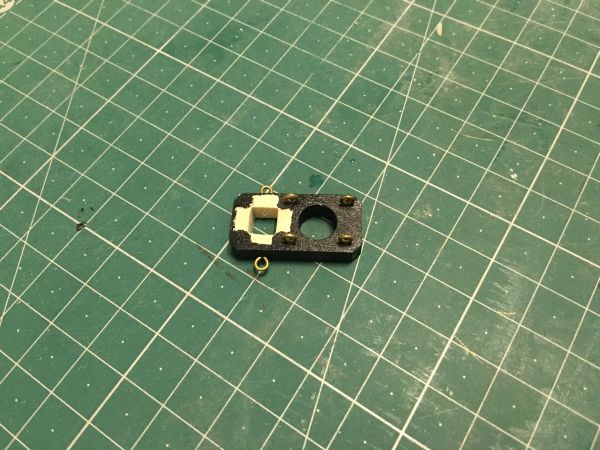

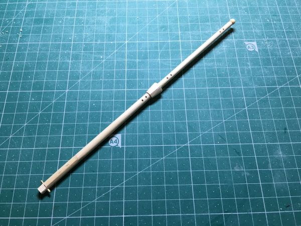

26/11/2017

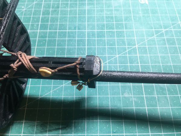

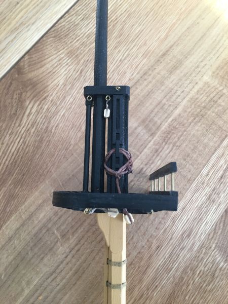

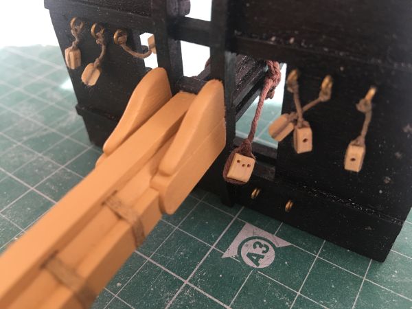

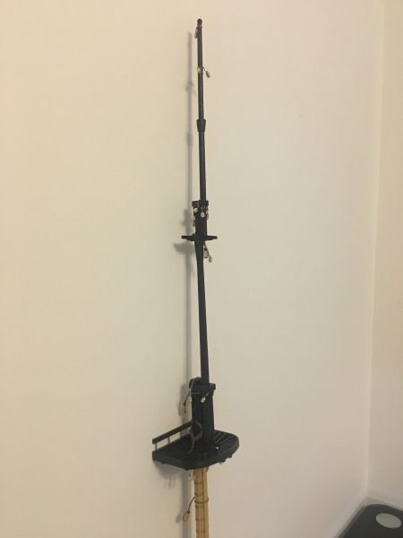

Rigging added around main lower mast top, triple blocks rigged to the rigging 😄... mast cap glued in place... main topmast painted black and fitted in place... hand mast (short pole front of the top mast) formed, painted and glued in place... mast looks good already, next part is the topgallant mast which is the top section of the mast.
Main topgallant mast carved/shaped, then octagonal area added and shaped at the middle, bead added to the top... topgallant mast and cross trees test fitted to main mast... complete height is 80 cm (!!!)
Happy building!

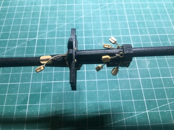

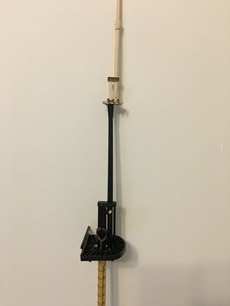

27/11/2017

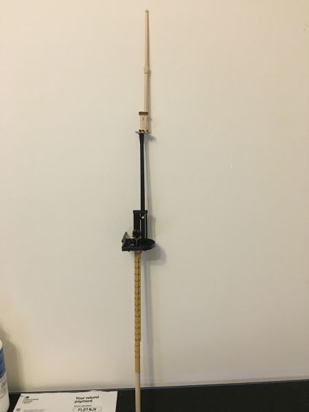

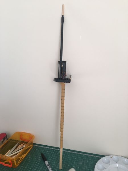

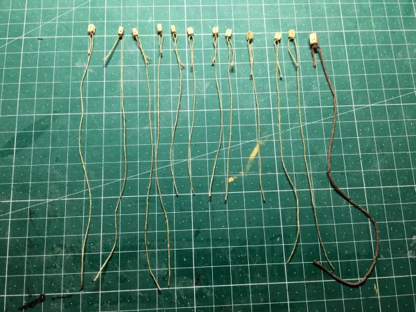

Main topgallant mast, mast cap and cross trees painted black... main mast fully assembled... it’s huge... hardly fit in a picture.
As now the main mast is completed, further blocks added to prepare it for the full rigging later on... various blocks prepared with threads to add to the mast tomorrow.

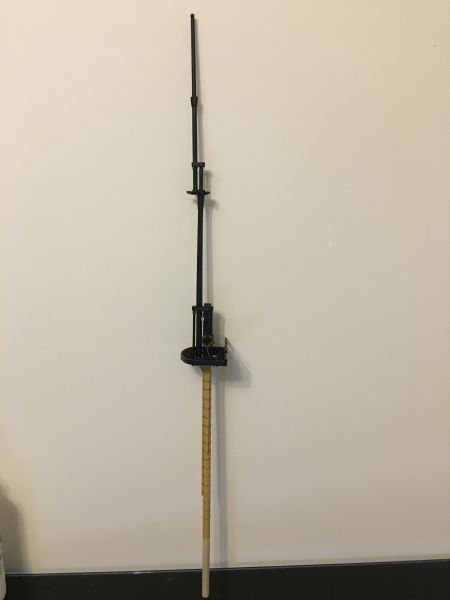

28/11/2017

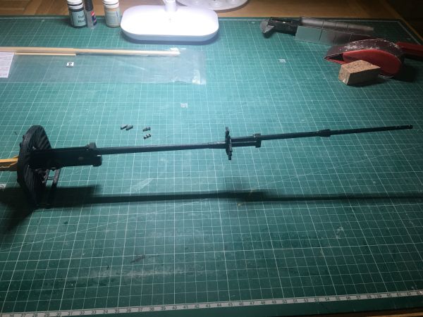

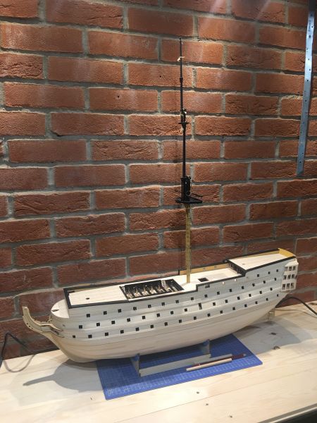

Rigging blocks added to the main mast which is with this now fully completed... will be put aside for a while and start working on the yards (spars) for the main mast.
While putting the main mast aside next to the hull I just test fitted it... wow... looks good and huge...

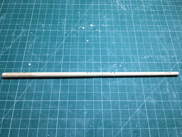

29/11/2017

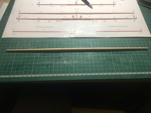

started to carve/shape the main yard.
