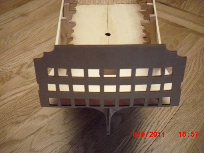

Hi everyone, step by step we are coming to the end of ISSUE 40.
Here I have fitted the gallery rear panel no 60 trimming carefully the two gallery supports:-

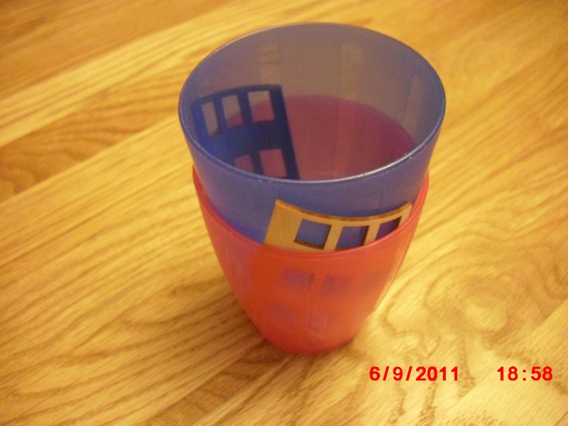

I then soaked the gallery side panels in hot water for 20 mins, and used this tried and tested method of putting a bend in them where they will wait for 48 hours:-
#106 Posted : 06 September 2011 20:25:48

#107 Posted : 06 September 2011 21:25:46

realy impressed with your build, like your idea with the cups to bend side panels BigGrin Keep up the good work. Ian

wish i had thought of that about bending the side panelsHuh , they were a pain to hold while the glue setBored even using clamps they still look a bit out but hey its my ship and im happyLOL LOL

Thats a great tip mike, I am coming up on that stage so I am definately going to try the "MWG cup bending trick" on my side panels....thank you.

Your welcome it works a treat,had to put some other use to my grandchildrens beakersBigGrin Cool

ROFL....can just see the grand kids all standing round the Victory and the cups ....pouting!

Awesome tip on the cups - thanks!
How did you bend the big rear panel?
