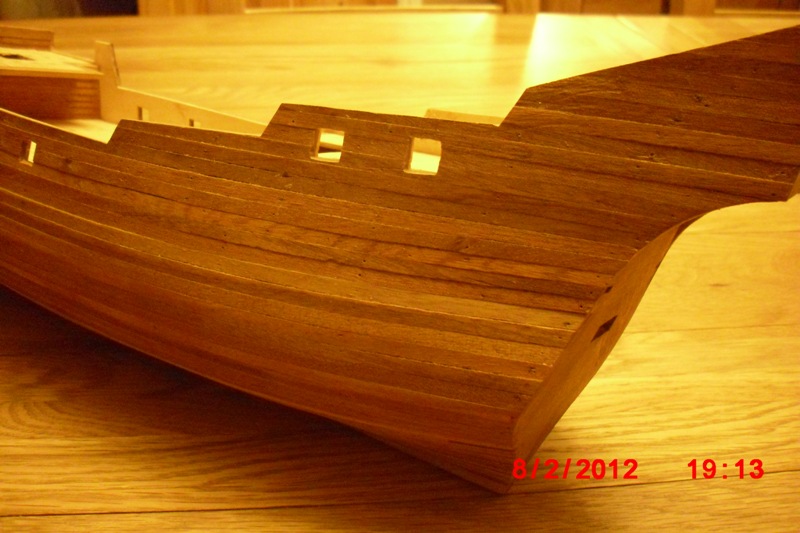

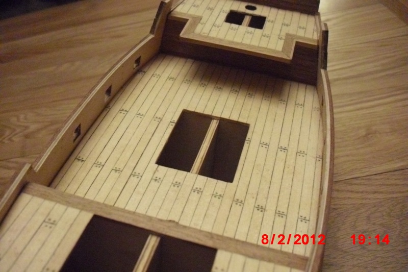

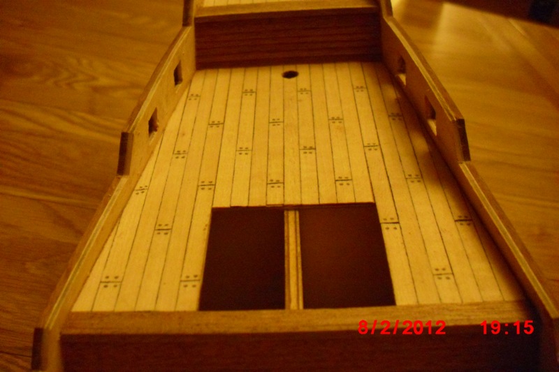

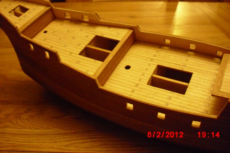

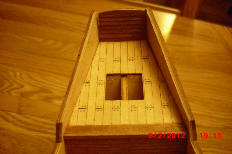

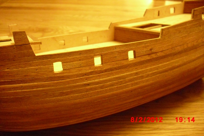

CUTTING THE CANNON PORTS
Hi Team now she is trimmed, I have been cutting the gun ports, she is really taking shape nowBigGrin comments welcomeBigGrin Regards MikeCool

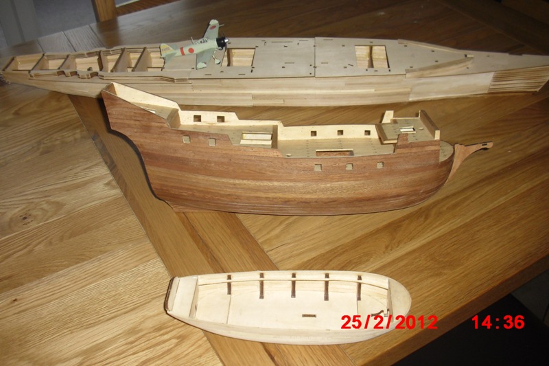

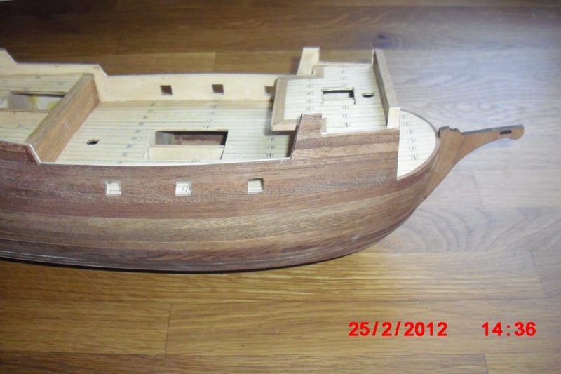

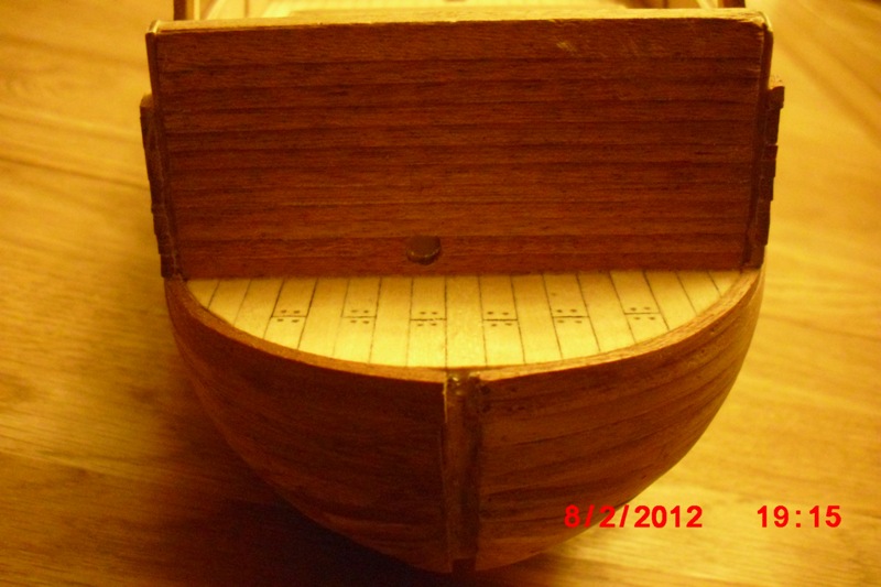

THE STEM
I have now dry fitted the stemBigGrin and so you can see the scale and size of her, I have enclosed a photo of her with the endeavour long boat and the AkagiBigGrin Regards MikeBigGrin
Questions and comments welcomeBigGrin

Just a quick question.
Did you enlarge both the inner and outer planking to 10mm for the gun ports, or only the outer?
My friend is building this and enlarged both to 10mm now it looks like the inner should be 8mm and the outer 10mm so the guns have something to locate in.
At the moment the guns just fall through the ports.

I hope you don't mind me butting in here to help answer Steves question.
The gun ports are pre cut on the bulwark lining so you only have to cut out the planking to that size, there are then metal inserts which make up the gun port linings, these are 10mm square on the outside, but have a recess and lip on the inner surface which is 8mm square which fits perfectly into the precut size.
Do you agree Mike?
Come on you Jimmies
#109 Posted : 25 February 2012 19:25:11
Hi Bob all my gunport lids will only fit a 10mm opening (that is the recess size) so I have cut the deck gun ports to that measurementBigGrin however I must say the instructions are not over clearBlink Huh Regards MikeBigGrin
