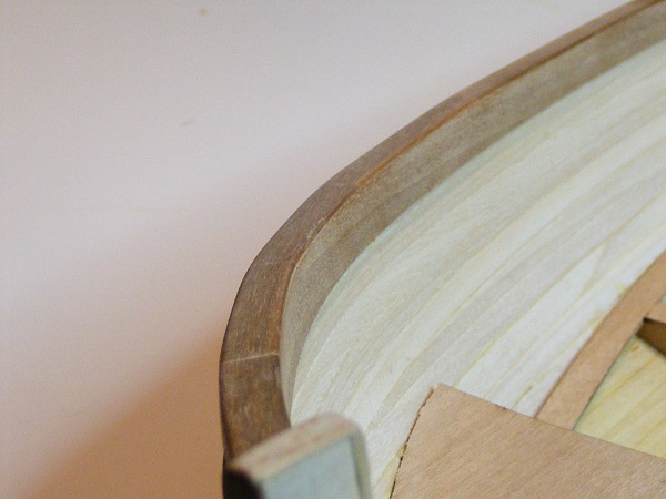

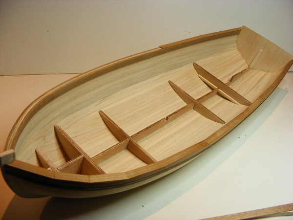

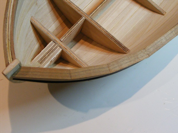

Moved the build forward a little more by capping the handrail. This is capped with a walnut strip and that means having to cut the strip into trapezoid shapes in order to follow the profile of the handrail. Once fitted it was then a case of sanding everything smooth on the inside and outside of the rail.Cool Cool .. Then moved to fitting the rubbing strake to the stern and finishing that area off....

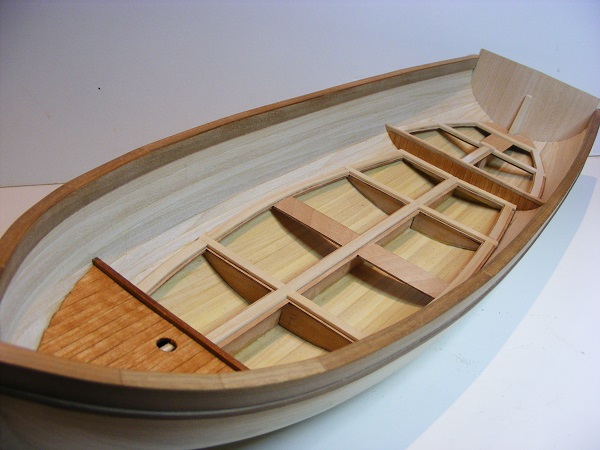

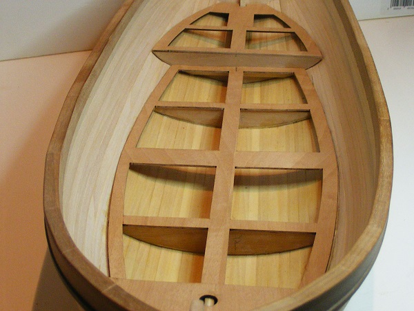

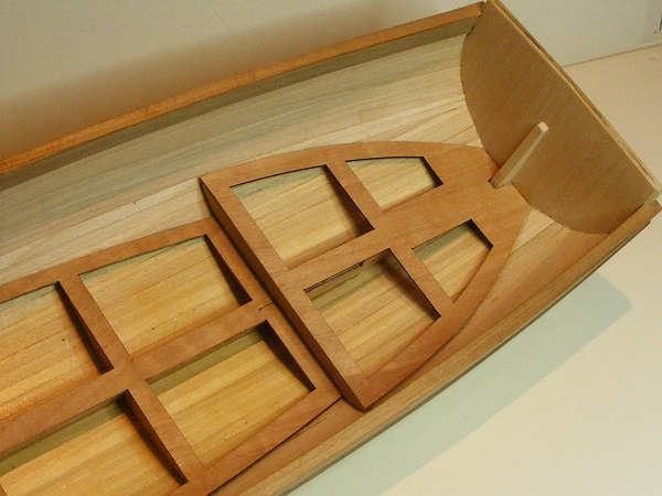

Now moved onto to shaping and test fitting the framing for the flooring. Everything under this framing will not be seen so to add additional strength to the hull I painted that area over with diluted PVA and left to dry, hull certainly feeling a lot more secure now... Last thing I did for this session was to glue the framing in place. Next we start to add some of the detail so until then, happy modelling all....Cool Cool

Thanks Walter, the handrail wasn't too bad but being walnut then trying to bend laterally is a no-no. The strip s wider than the rail so by cutting into trapezoid sections and taking a little care means it will cover the rail with little problems....Cool Cool

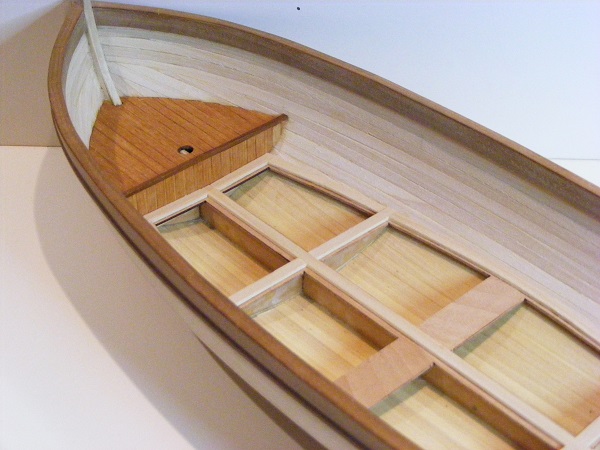

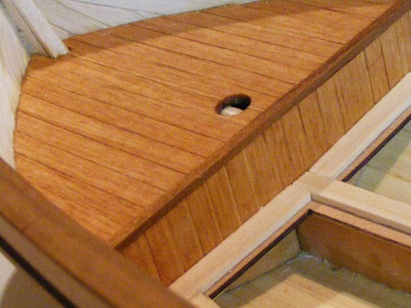

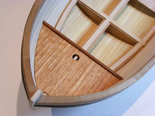

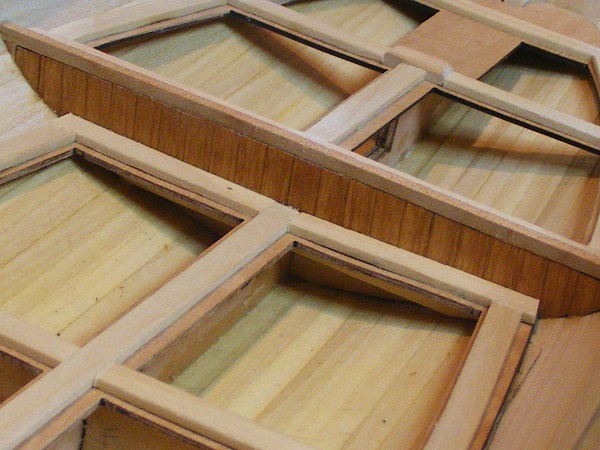

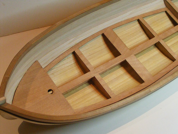

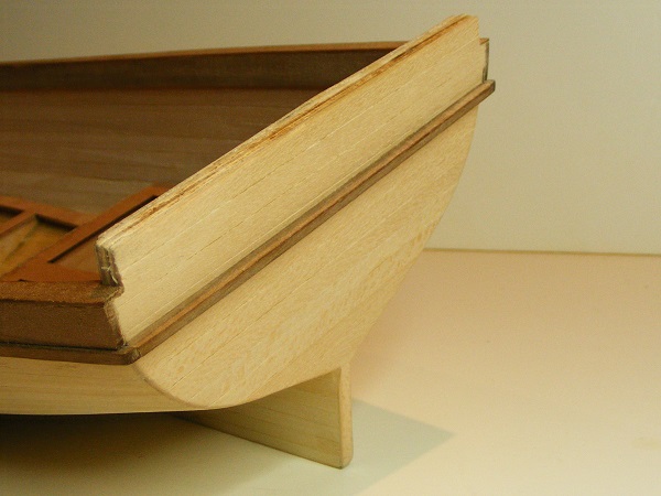

A little more done to this one. Planked the forward and stern bulkheads as well as the bow deck with walnut strips, gave it all a fine sanding followed by 2 coats of Danish Oil, think it really brought the grain out to good effect. Cool Cool. Next was to carry on building up the flooring, adding the framework to take the gratings and various other fittings, these will be shown later in the build. Cool Cool
