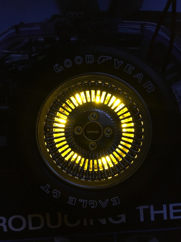

Great idea to add lightening to the wheels; how does it look with the wheel on, is the lighting uniform through the wheel?
A circular light 'tube' like a fluorescent lamp bulb would be ideal for this, i don't think there are any that small though Bored
Hi Eagle thanks for looking, I will put a pic on of the wheel in the dark and the front and back of the wheel. I have also found some small rope lights that may look better then the LED strip i will do an update on that soon as i get them.

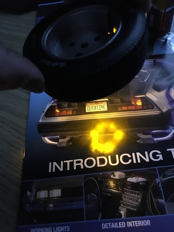

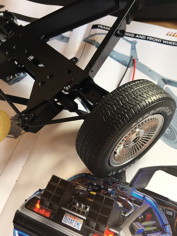

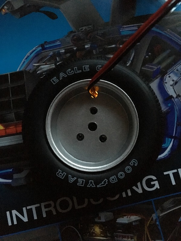

Update on the wheel in the dark. The last pic is in the loft were its the darkest.

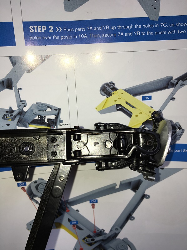

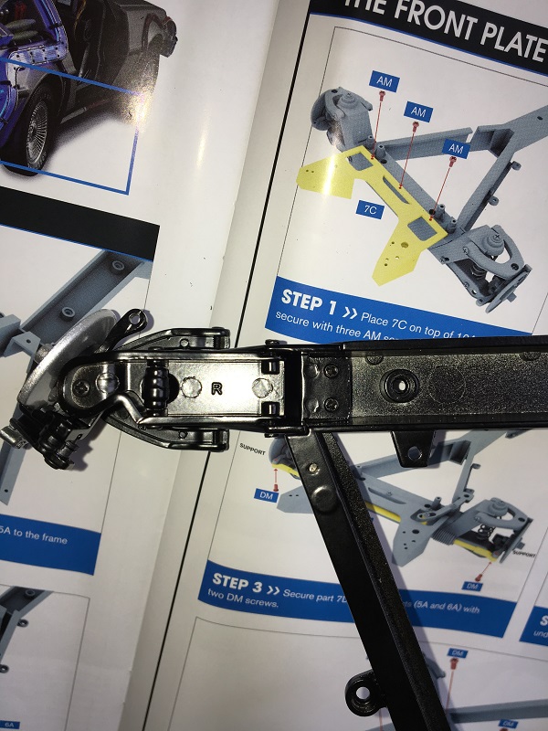

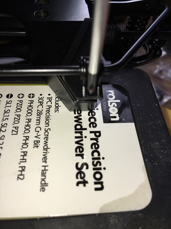

Issue 10
Parts -
Frame
4x AP Screws
4x GM Screws
6x DM Screws
4x BM Screws
3x AM Screws
Screwdriver
spike attached the following image(s):
Building - Suzuki GSX 1300R, Hummer, Ford Mustang, R2D2 Droid, Delorean.
Finished Builds - Nissan GTR, Millennium Falcon.
Other model kit builds - Tamiya RC Trucks, Tamiya RC cars
Thanks for looking.
Duane
spike

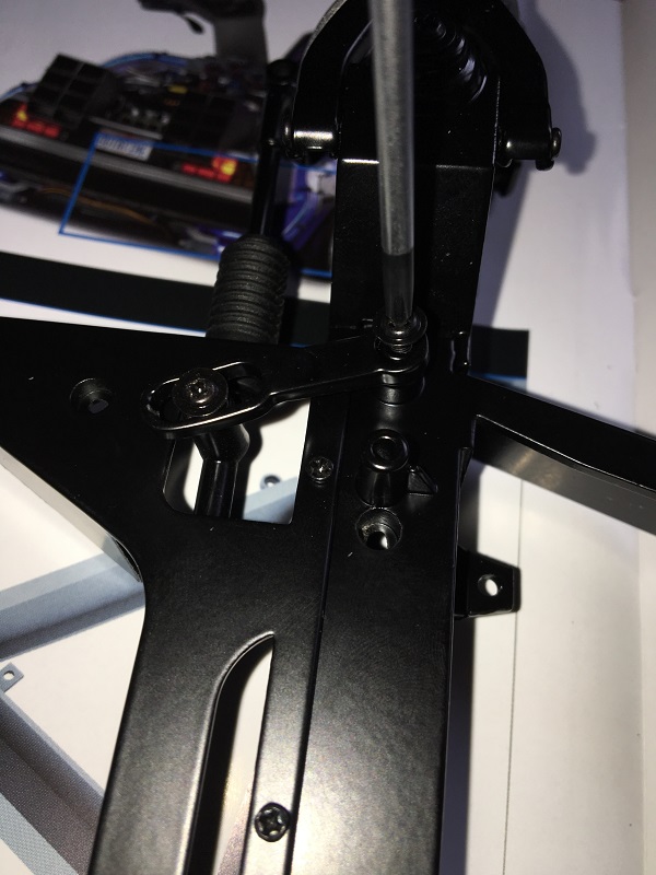

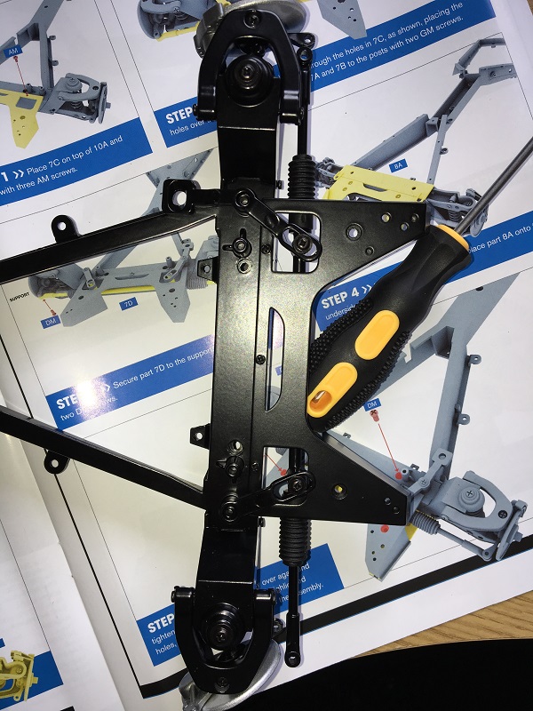

#117 Posted : 08 March 2017 18:03:32
Joined: 04/07/2016
Posts: 297
Points: 897

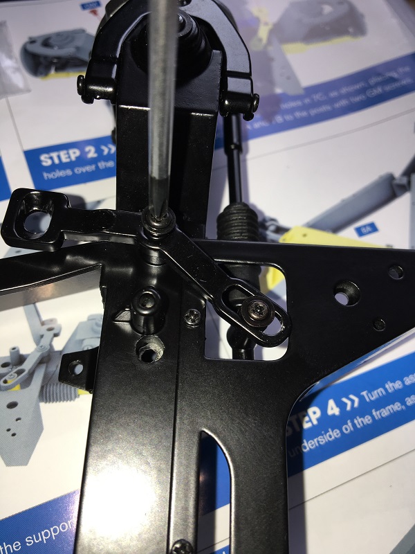

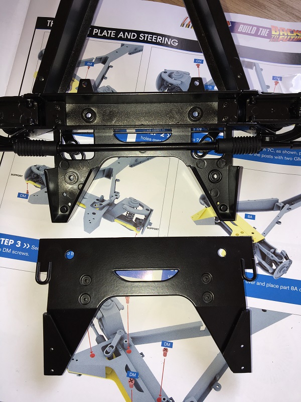

Fit the assembled wheel hub and suspension (Left) into the underside of the front of the frame aligning the screw holes on both parts. Turn the frame over and add 2 BM screws. Do the same for the right assembled wheel hub and suspension.
Thanks for looking.
Duane
spike

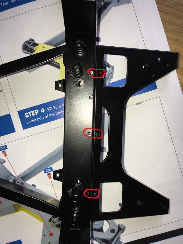

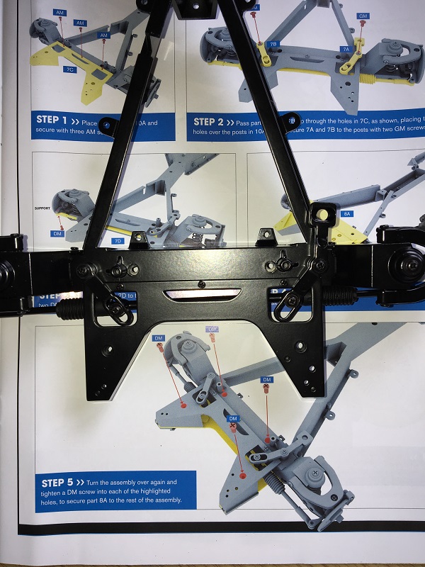

#118 Posted : 08 March 2017 18:21:05
Joined: 04/07/2016
Posts: 297
Points: 897

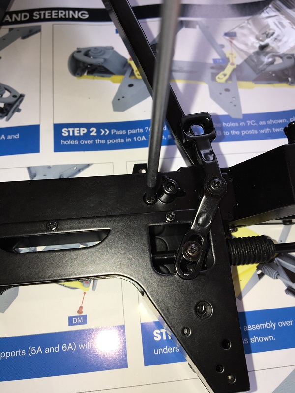

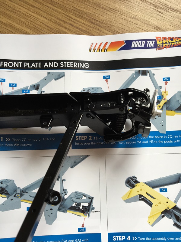

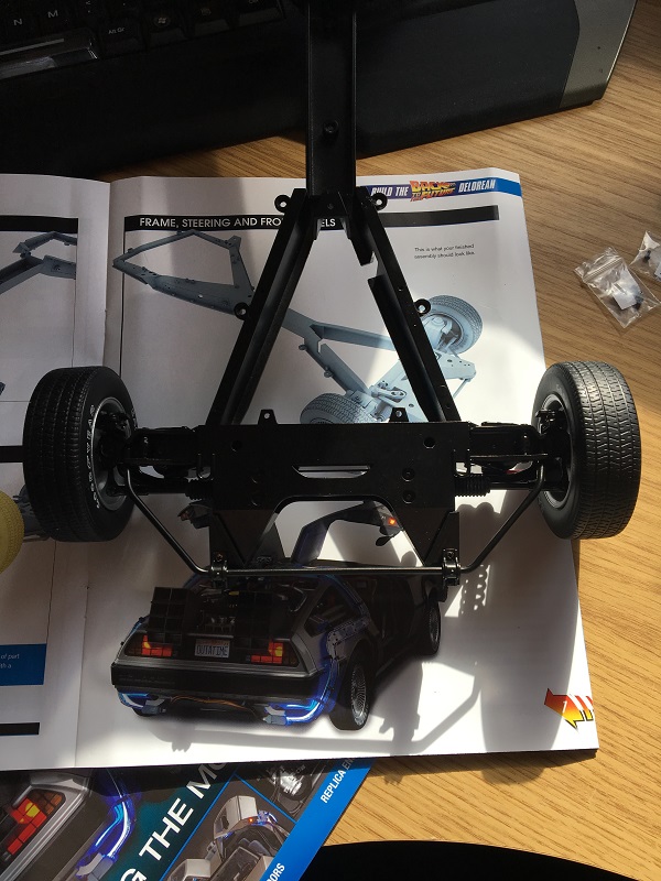

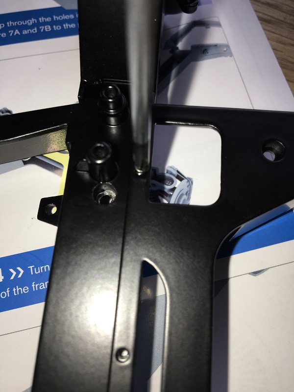

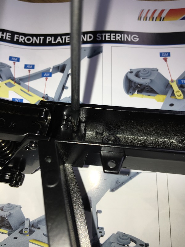

Place the top front plate on top of the frame and secure with 3 AM screws. Pass the Pinion and pull rod up through the holes in the top plate, them place the holes on the pinion and pull rod onto the posts on the top plate. Then add 2 GM Screws. Secure the wheel hubs to the steering rack with 2 DM screws. Check that the steering rack and wheel hubs move freely, if you have any problems try flipping the pull rod the other way. Turn the frame over and add the bottom plate. Turn the frame back over and add 4 DM screws.
Thanks for looking.
Duane
spike

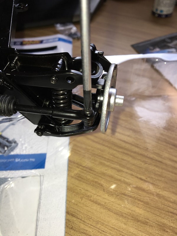

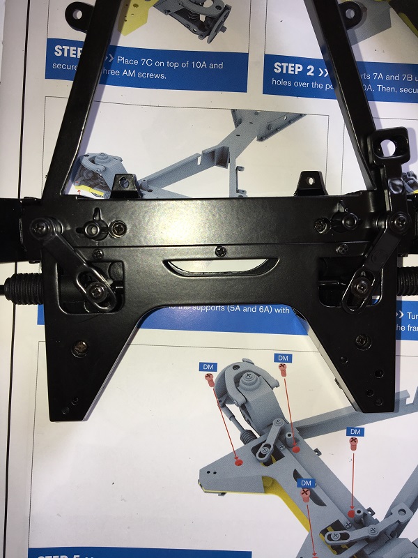

#119 Posted : 08 March 2017 18:37:07
Joined: 04/07/2016
Posts: 297
Points: 897

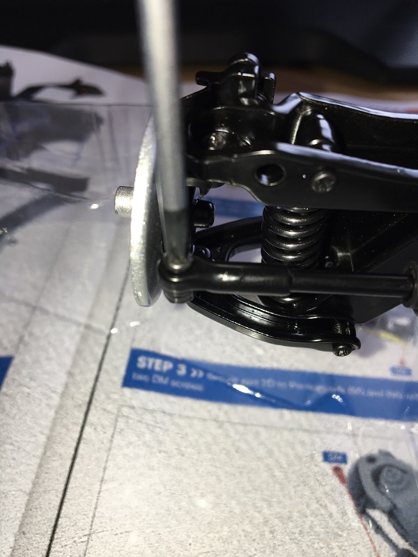

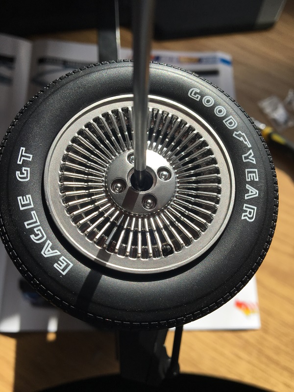

Place the ends of the anti-roll bar through the holes in the suspension assembly's then secure the two brackets to the right and left anti-roll bar base with 4 AP screws. Take the hub cap and washer out of the wheel and place the wheel on to the drake disk. place the washer back into the hole and add 1 GM screw then push the hub cap back in place. Do the same for the other wheel.
