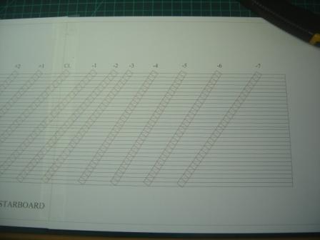

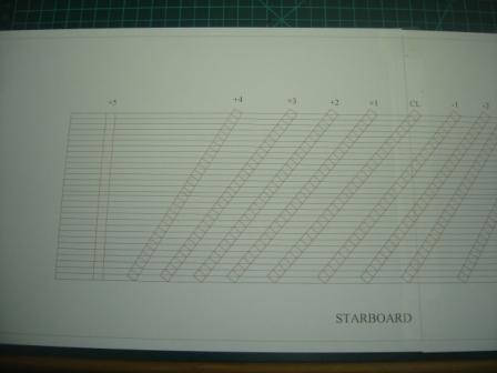

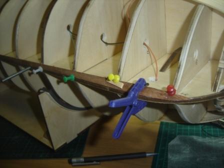

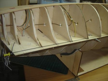

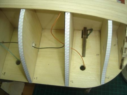

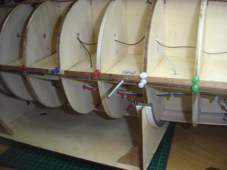

Waiting for the hull planking to arrive..scheduled for Monday. Meantime been busy reading again and I think the planking thing is beginning to make a little more sense not to mention daunting. I measured all the former's and set about making a cad dwg with all the divisions on it, it's here I realized that every plank will have to be shaped, the only place they are 5mm wide is at the center of the longest former (15). This is going to keep me busy for a while, one mystery still eludes me, the "garboard"(why is it called that?) plank shape I've seen on most of the planking pictures. I haven't started yet but with the way I've done the marking mine seems to be evolving pretty much straight, will keep a close eye on it..
Barry

Hi Barry the garboard plank is probably the most important plank you can lay as it keeps all of the other planks in line as it is the starting point. Having looked at your pictures I think you need to fair the bulkheads a bit more before laying the planks as their is a gap near the bow between the last plank and the bulkhead . Hope this helps rgd Martyn
#108 Posted : 15 July 2016 22:53:07
I agree with Martyn, Just a little more fairing to get the planks to sit against a flat surface rather than an edge.
The Garboard plank is a difficult one to do. On my build I used a 10mm wide plank to make it but was a long process. It makes a massive difference to the planking when done though.
Are you going for the correct planking technique using stealers and drop planks?
#109 Posted : 16 July 2016 07:46:07
Not sure why the plank next to the keel has that name
I stalling the garboard plank sets the run of planking for the rest of the hull, some meodelers will use a wider plank, as already stated due to the complexity of the bend and cut required.
One thing you can do is use some thick card to do a dry fit. Once happy it is correct and sits as you want you can use that as a template for your shaping

Thank you gentlemen for your much appreciated comments, I received my sapele planking yesterday P.M. all 5mm wide, 500mm long, I think I will require about 60 per side Deag supplied me with 132 of them, got to be careful again.
After reading your comments I'm going back to basics..although I'm going to copper plate the hull I still need to get a good smooth shape and lines similar to what you guys have achieved so no short cuts here which means using those stealers and such.
As I only have 5mm wide strips I'm going to try and glue 4 of them together to make up the 10mm wide x 1m long Garboard plank, I think I see where that shape comes from after I stretched a piece of thread where the plank will fit. I started 10mm up from the keel at the stern and finished at the base of former 10..see what you mean about a complex plank, probably a weeks work at my snails pace..here's a couple of pics just got to mark the formers..

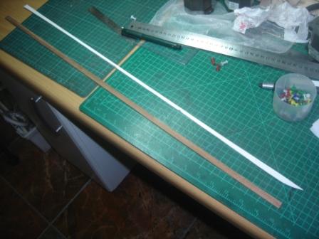

Update on the Garboard plank...Fabricated a 10mm wide plank from my 5mm stock and took Jase's advise and made a cardboard cut out, I'll leave it overnight for the glue to cure, check the cut out in the light of day and then transfer it to the 10mm plank..11:10 PM here time to call it...
Barry

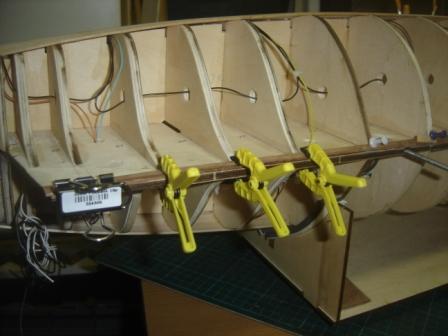

Got the Garboard-Starboard plank cut out and fitted (hope the port one is easier) just needs a little trimming at the bow, the card cut out gave a good indication and once the part was cut from the 10mm sapele only a little trimming is required..
Barry

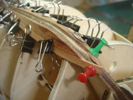

Been busy with the Hull Planking (shudder) slow going but not as bad as I thought though...been down with some flue bug for the past week or so even slower going at the moment...here's a pic of where I'm up to..so far the only planks I've had to trim were the first 3 at the bow but I think that maybe about to change...
Barry

#116 Posted : 31 July 2016 17:52:21
Cracking job Barry looking very neat. Hope the man flu gets better
#117 Posted : 31 July 2016 18:23:08
Some very skilful modelling here.
Looks really good. Hope the rest of the build goes well.
#118 Posted : 31 July 2016 20:12:12
Looking very neat Barry.
Well done.
#119 Posted : 31 July 2016 20:23:03
Your doing a grand job on the planking and dont worry too much if it looks rougher than a bears butt as the sanding back will transform the ugly duckling into a swan
johncal
#120 Posted : 31 July 2016 23:04:05
Joined: 02/04/2013
Posts: 174
Points: 534
Location: Bethlehem PA, USA
Bending those boards back at the stern is no fun.I'm really glad for me that it's a distant memory, ha ha.
It looks really good though. Just keep on plugging away and you'll be done before you know it. You're really moving fast. It's funny how it takes a lot of figuring, but you just kind of figure it out as you go and it's not all that bad as you'd think.
