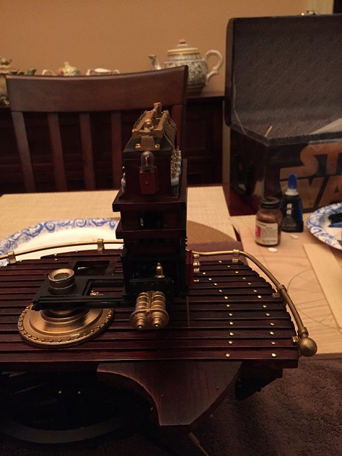

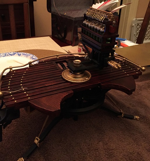

Finally I added the box of jars in to the top of the frame.I have not attached this permanently yet because I dont want to damage it when fitting the time rings and central ball.
Next step is to assemble the time rings.I have hit a major snag because of shrinkage of the resin parts. The parts that attach the glass petals to the time rings are too short.I think I may have a solution and involves my 3d printer!!

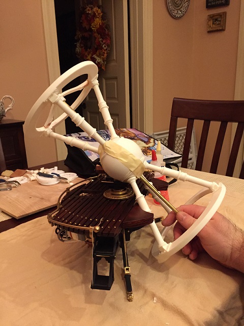

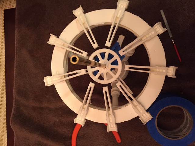

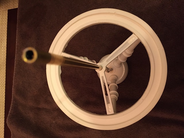

Moving on to the time rings. There is a central support for the main ring.it is slightly smaller than the ring itself so I will use some copper strips to bridge the gap between the support and the inside of the ring.

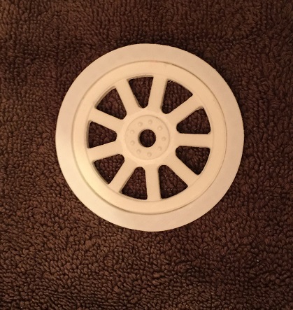

When I test fitted the secondary ring, however, I ran into a bigger problem.The supports for the glass petals are supposed to attach to the central ring but as you can see they are all too shortCursing Cursing Cursing.I would need to add material to the end of each support to get them to reach the central ring.But instead I am going to 3d print a ring which will fit onto the outside of the central ring (like a tire on a wheel) to close the gap.Once I have one ring the right diameter I will make a mold and cast 4 new rings to solve the problem (there are 2 rings at the upper and lower ends of the time rings).

BigGrin Looking good, I know some resins can shrink over time but I have never known resin parts shrink that much. Maybe the guy who cast the kit needs to start using a better resin compound to prevent itCool
#104 Posted : 16 October 2016 19:31:45
Looks amazing Carl Drool sorry about the parts seems wieredConfused but as Andy says resin shrinksConfused Confused but the 3d printer to the rescueLOL LOL LOL regards Phil
#105 Posted : 16 October 2016 19:45:21
yes there is a bit of a parallax error in the picture.They are actually about 3mm short.

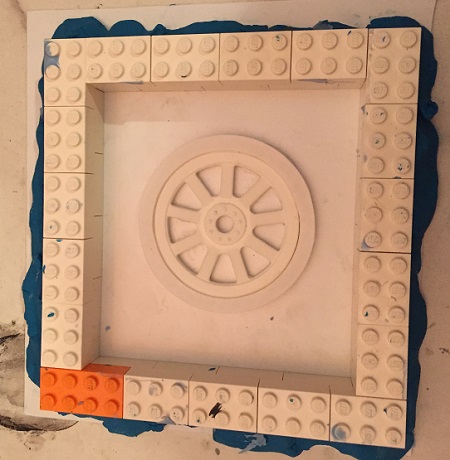

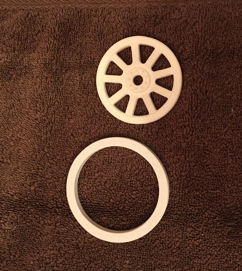

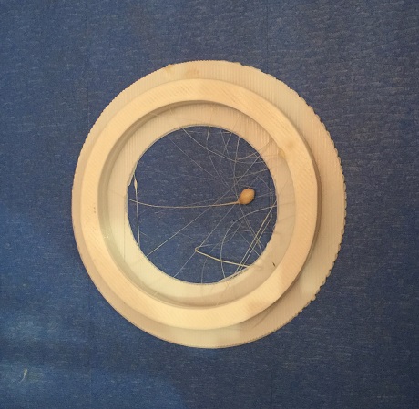

So I made a circle with the 3d design software that came with the printer and printed it last night.Tonight I will fit the wheel into it and then use that as a master to cast 4 new wheels.
The 3D printer saved me a lot of hassle here.

Cheers Dave,

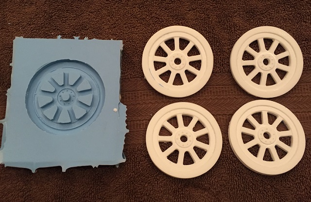

I dont really know what the issue was for sure. The ring fit perfectly over the wheel and I poured a mold for it.Hopefully it should have set by tonight and I cant start casting the 4 wheels.

The rings are now done.Next step is to assemble the time rings and start painting the glass petals.

That turned out very well Carl, looks like you have four very tidy castings, well done. ThumpUp
#115 Posted : 20 October 2016 19:39:30
Nice result on the wheels Cool Cool

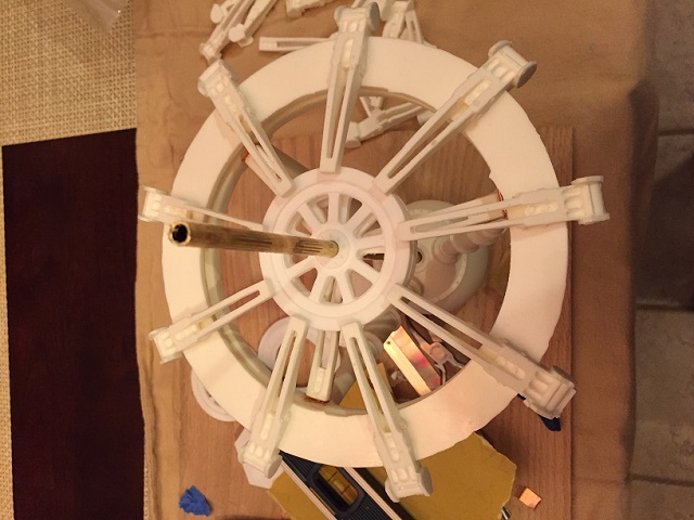

#118 Posted : 24 October 2016 15:31:26
test fitting the new wheels.Now the supports for the glass petals reach the ring.

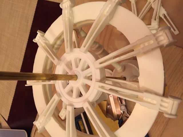

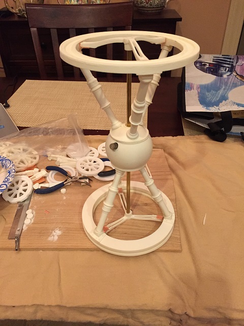

#120 Posted : 24 October 2016 15:37:21
I have now attached the upper and lower time rings.I test fitted the assembly onto the platform.I will have to figure out the exact angle the assembly needs to be at to avoid hitting anything.
The next step is to sand these parts and paint them and then work on the petals (36 of them) that attach to the rings. Then I have to build the chair and the computer and it is done.
