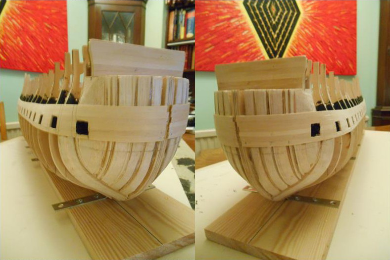

Stern planks have been shaped and stern gun-ports have been cut out along with the first row of gun-ports on the port side, now ready for the next lot of planking and second row of gun-ports.

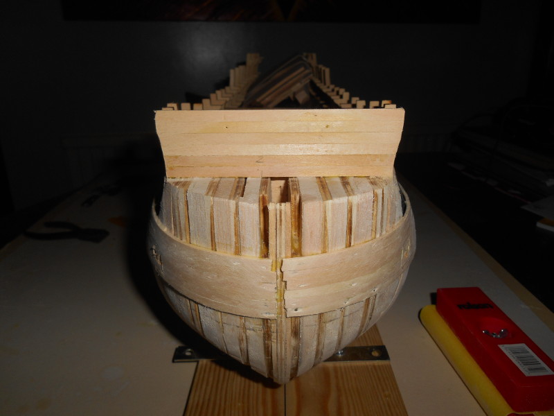

Another small update, forward bulkhead planked and sanded.

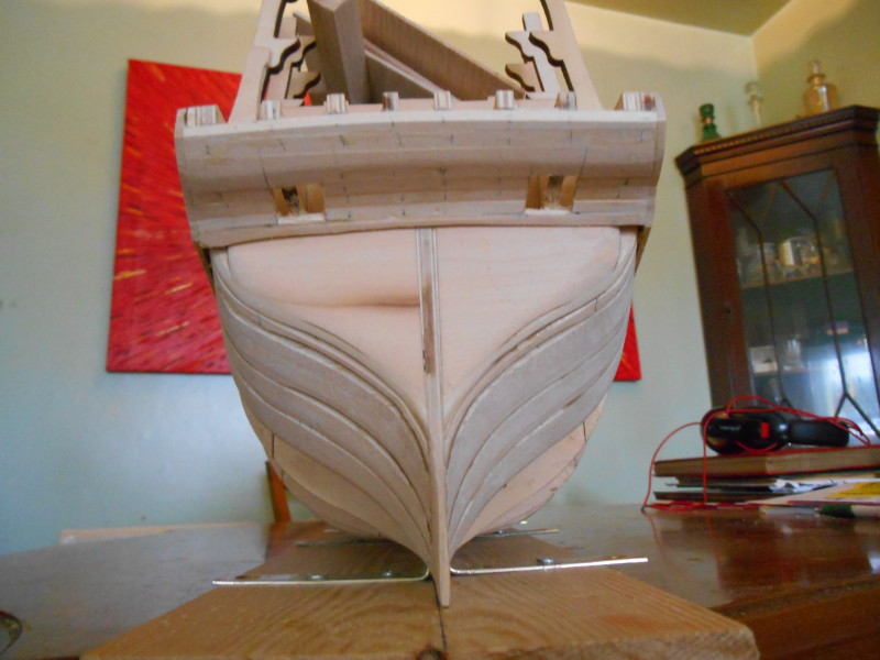

When cutting out the forward gun ports with balsa behind them, cut them out as you normally would cutting the shape of the port with the centre hole and the triangle cross cuts, then using your dremmel with a ball attachment insert it into the hole and start working behind the planking on the balsa from the centre out, bits of the triangles will start to come away, take your time and keep going, don't use the Dremmel on the outside edges of the ports, always work behind them so you don't round anything off and the triangles will just pop out, sand off the sides as you normally would, paint black, job done.

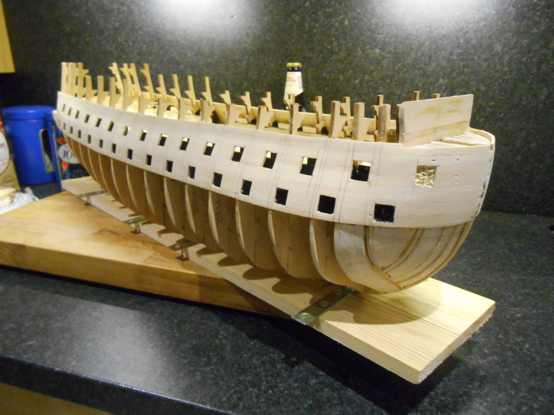

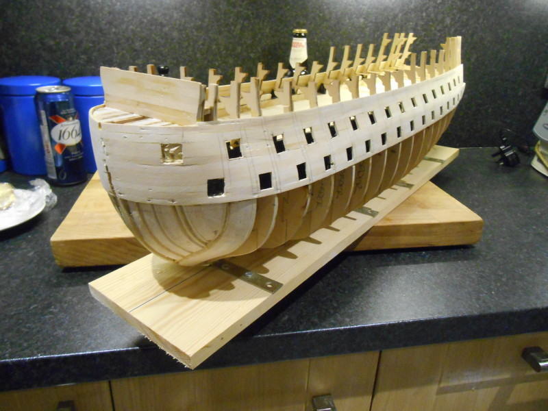

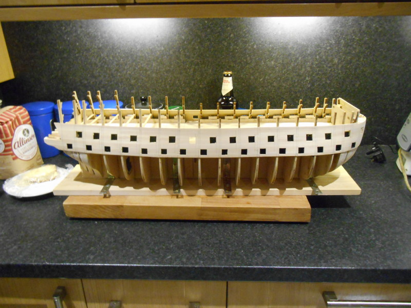

Planking done up to layer 12, dummy cannon supports painted, cut and glued in place, broke the top of a couple of ribs with the sanding block while sanding but easily fixable, and then cut out the gun-ports.
