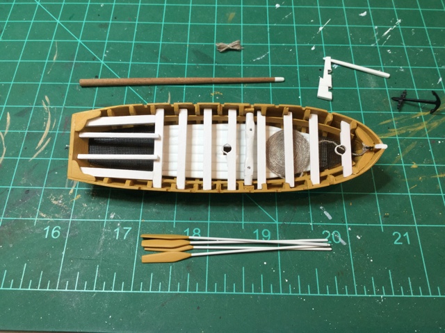

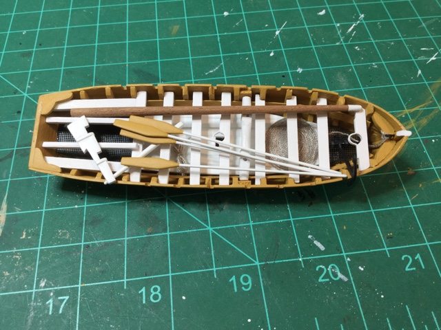

Finished, the launch is finished and I am very pleased with how it turned out. I got quite a sense of satisfaction out of completing that. Here it is empty, and with all of the accessories stowed.

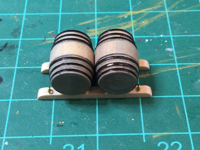

Today I finished the second of the ship's 12 pound cannons and started on the barrels.

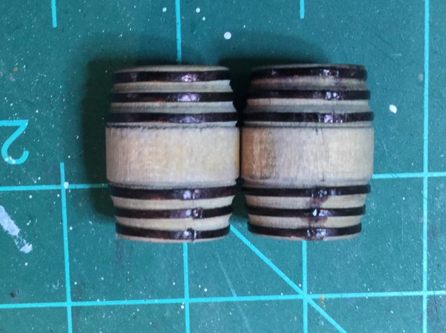

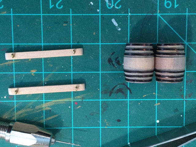

First I lightly sanded the barrels to clean up any fuzz. Then I aged them using Weather It. I got the idea from member Steve_O's beautifully aged deck (credit where credit is due). I really like the way they came out - they look much more like real barrels now.
I am following the suggestion in the instructions about using thin masking tape instead of painting the iron hoops. I started with an 8 inch piece of Tamiya 6 mm tape and cut a few 1mm or so strips. Instead of painting the strips I decided to use a black Sharpie marker which worked really well but...
I wanted to make sure the tape never comes loose so I started to apply a little thin CA with a micro brush. Alas, some of the ink started to bleed into the CA (see the first picture). Luckily I caught it in time and was able to recover by making that the bottom of the barrel pair. Shame because I wanted to add some light rusting to the metal bands.
Here's what it looks like without the bleed over (picture 2). And how it will look when it is mounted on the skids (picture 3). I still plan to paint the skids and eyelets black and add the line to tie the barrels down.
I should finish that in the next few days and by then all of the frames that are being pressed should be dry and hopefully warp free (or at least very close to warp free).

You may also want to consider popping a couple of cocktail sticks in as bungs. Have a look here-
Barrels

John, you had me there - I had to look up what a bung was Blushing but it's a great idea. I'll post some pics when the barrels are done with the bungs installed.
