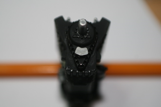

The Merlin`s get more detailing:
As before I`ll only show one engine,(have dragged parts from later issues to continue with this part of the build).

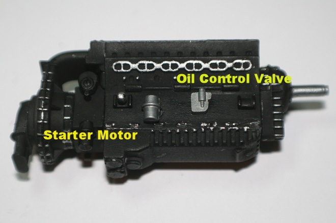

First parts are the oil control valve and the starter motor.Pic 1

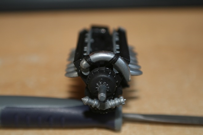

The next addition are the coolant rails.Pic 2

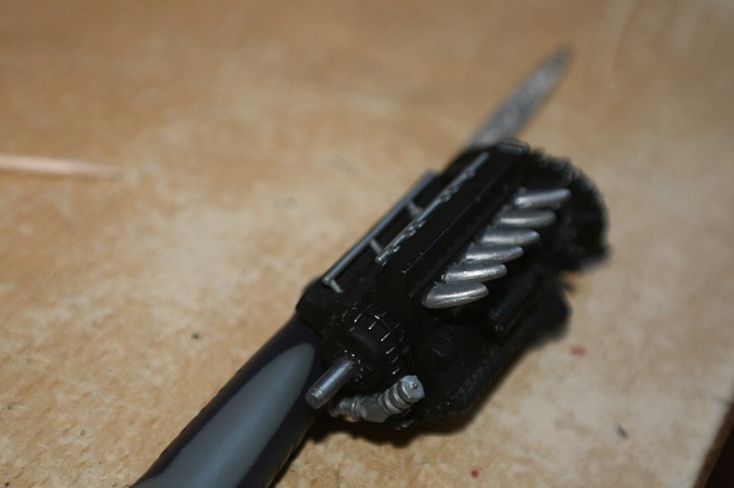

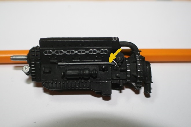

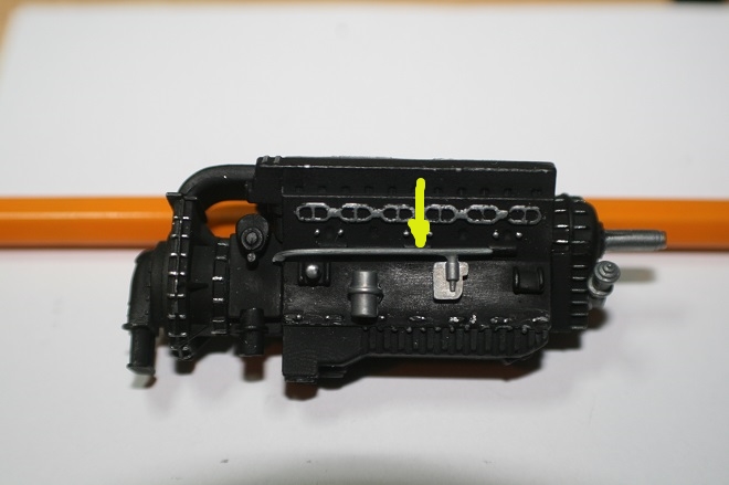

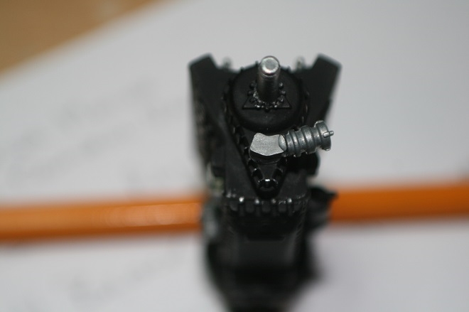

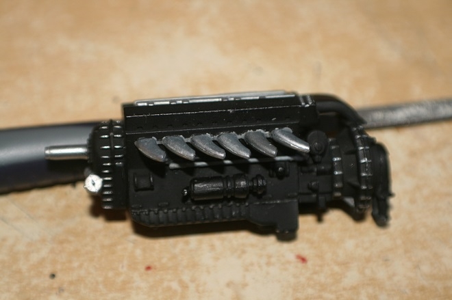

The next parts build a combined unit which includes:
A "V" block
The constant speed governor
and the vacuum pump
(Pics 3-5 in that order)

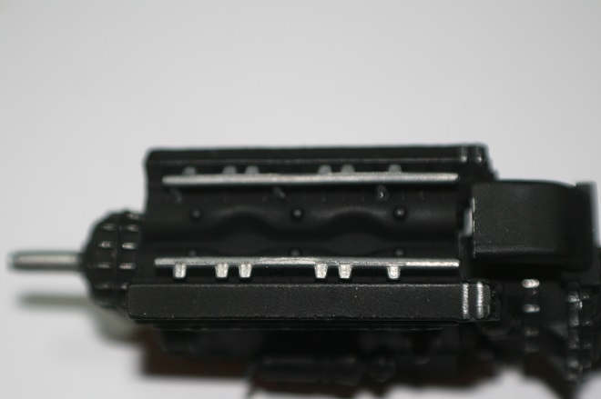

These next parts are a bit of a "fiddly job", the HT wire harness sleeves.(One each side)Pics 6-7

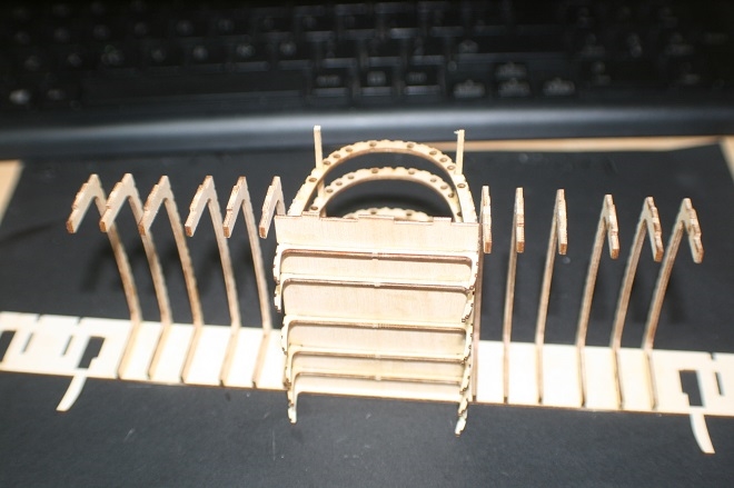

So, issue 9 for starters:

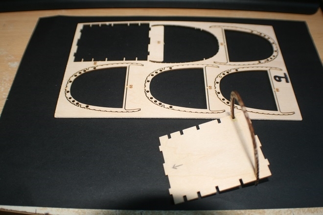

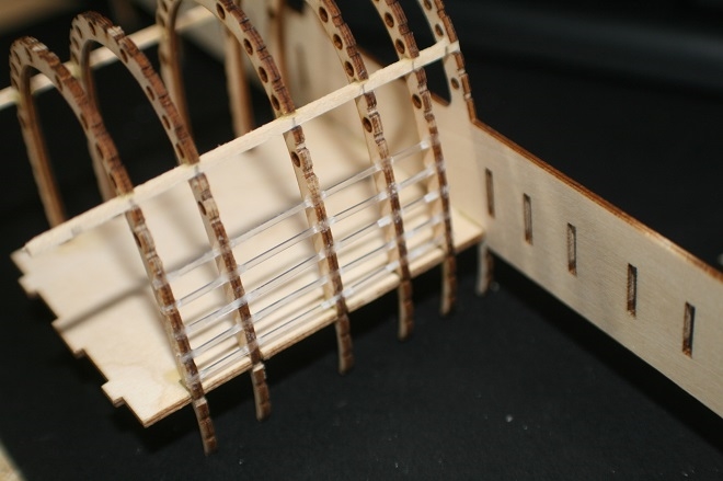

A very basic part of this build and works around the same principles as the cockpit stage, where rib sections are put over the floor section and then turned into their relevant positions.(5 in total)
All of the rib sections must be set at 90 degrees to the floor base.
When that's all set, there are two rigid stringers to be fitted and I used the same method of lining these up as I did with the cockpit area. (The marked piece of paper method).
It is suggested that you mark the floor section with an arrow, before removing it from the fret.(Looks symmetrical to me, but go with it to be safe).
Remove the floor section from the fret and the first rib. Clean off any rough/high spots and fix as shown.Pic 1

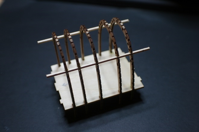

Follow this with the other four ribs by the same method.
The instructions for the two rigid stringers, tell you to leave 15mm over each end. Mine were not long enough for that, but as long as they extend past both ends of the floor section , then there is nothing to worry about.
Five ribs and two stringers in place this is where you are.Pic 2

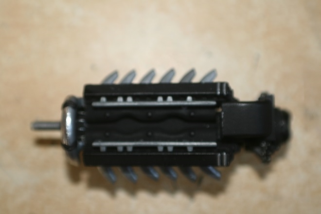

So, onto issue 10:

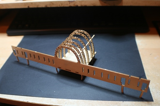

The parts.Pic 3

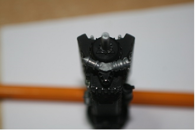

The main central wing spar is removed from the fret and cleaned up for rough and high spots. It is then fitted to the front face of the section made in issue 9.Pic 4
The rigid spar on the left of this pic is in place but has been cleverly hidden by the camera angle. LOL Blushing.

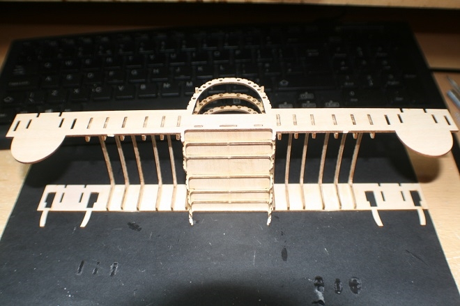

At this point the instructions tell you to start fitting the wing ribs, but I thankfully looked forward in the instructions and realised that fitting five stringers either side of the fuselage section would be a lot easier if done first.
You`ll see why in a later pic, but here`s the stringers fitted, one side in this pic but did fit to both sides.Pic 5

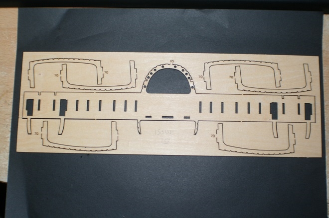

So, with the stringers fitted, you have to fit six wing formers.
Here`s a pic of just two fitted. You will now see why I fitted the stringers first. (They are darn close).Pic 6
Those wing ribs have to be set at 90 degrees to the front main spar.
Having fitted five stringers to each side of the fuselage, I then set two wing ribs either side of the fuselage. (Not six to one side).
