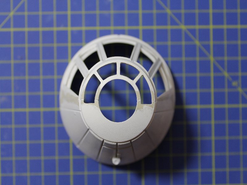

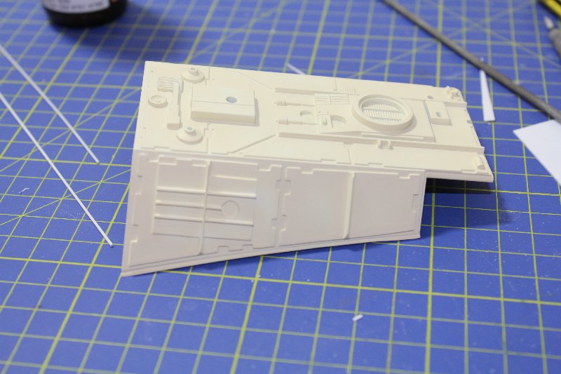

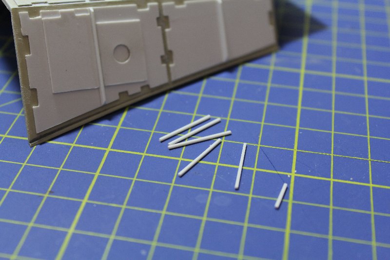

#114 Posted : 08 April 2015 22:03:41

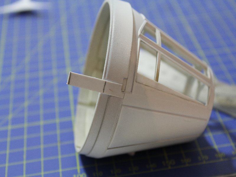

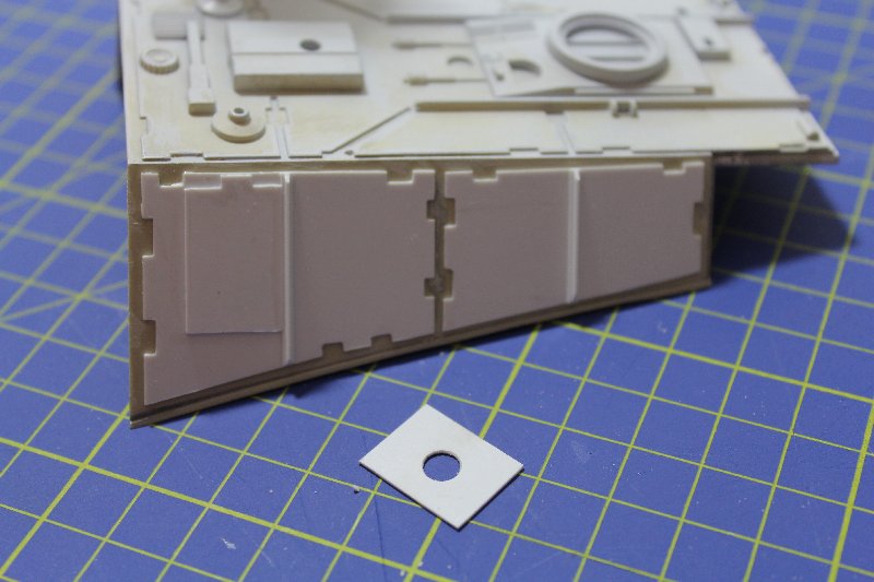

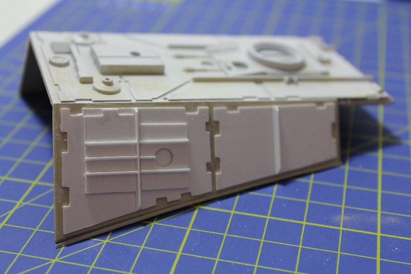

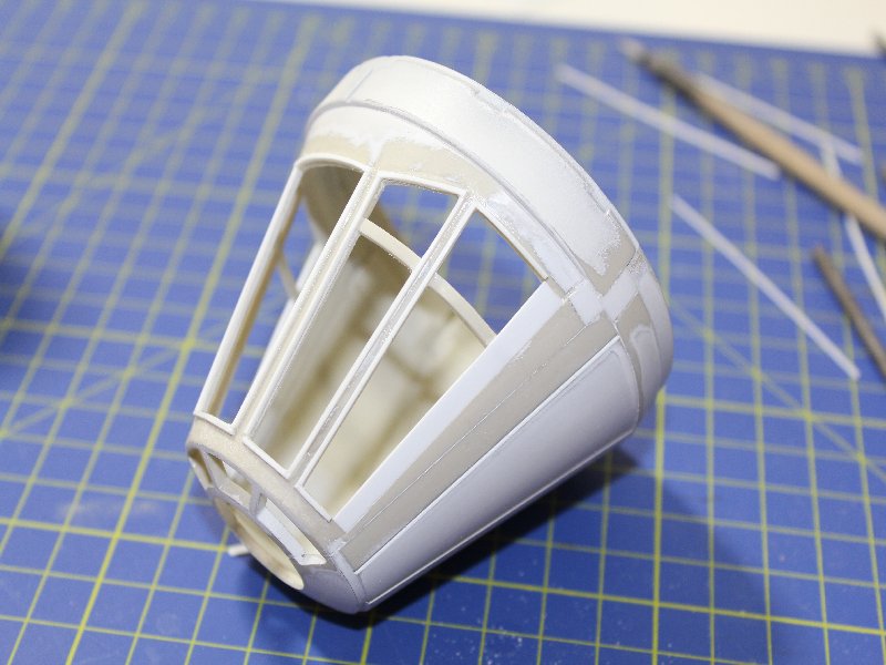

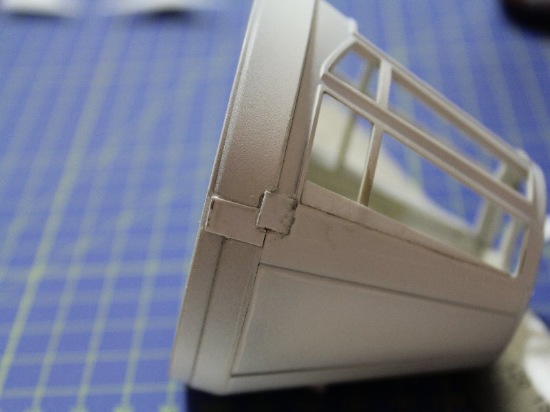

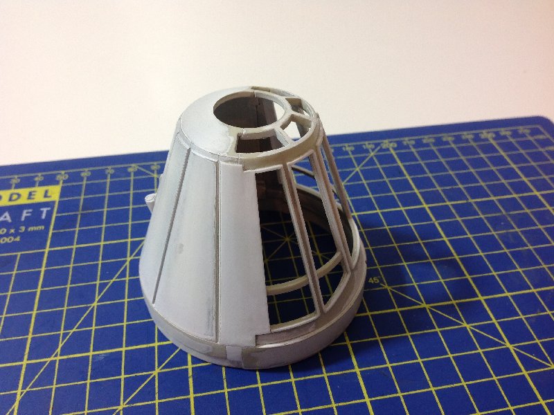

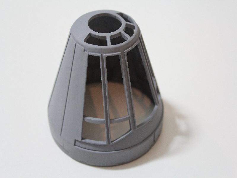

To kick off my custom build I have decided to completely strip the Nosecone of any outer molding lines etc and re-do with 1mm evergreen strip and card sheet. This is not to accurise it but to maintain the look I think it should have. Once this was complete then the interior was given some detail along the inner frame lines. Once again I used some Resin upgrade parts from a 1/32 scale Tornado. The parts although not accurate do give it a more three dimensional appearance.
In the next installment I will be working on the rear bulkhead door into the cockpit and some added details to the instrument panel and cockpit seating.

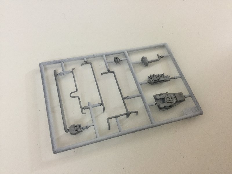

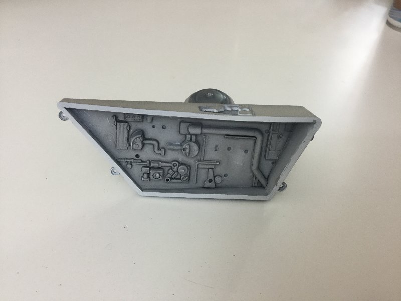

#116 Posted : 19 April 2015 22:05:38

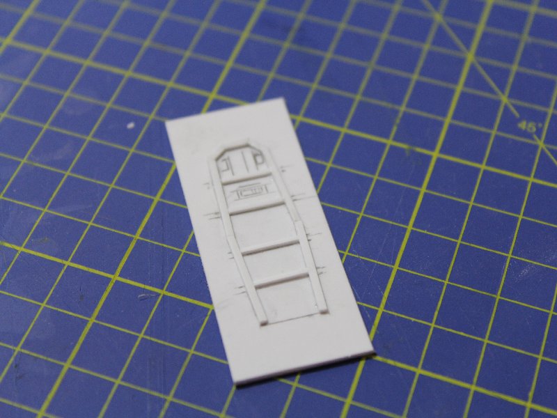

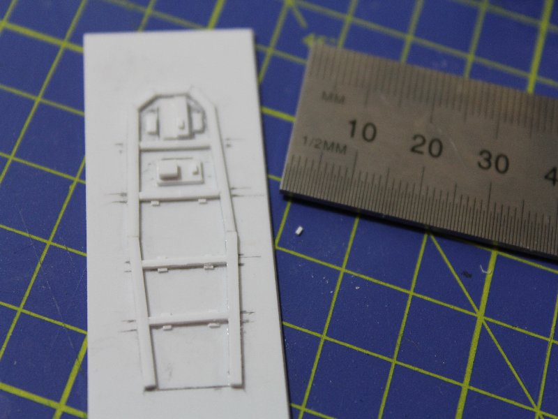

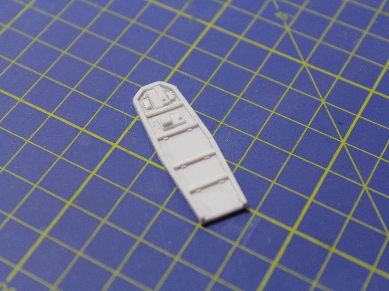

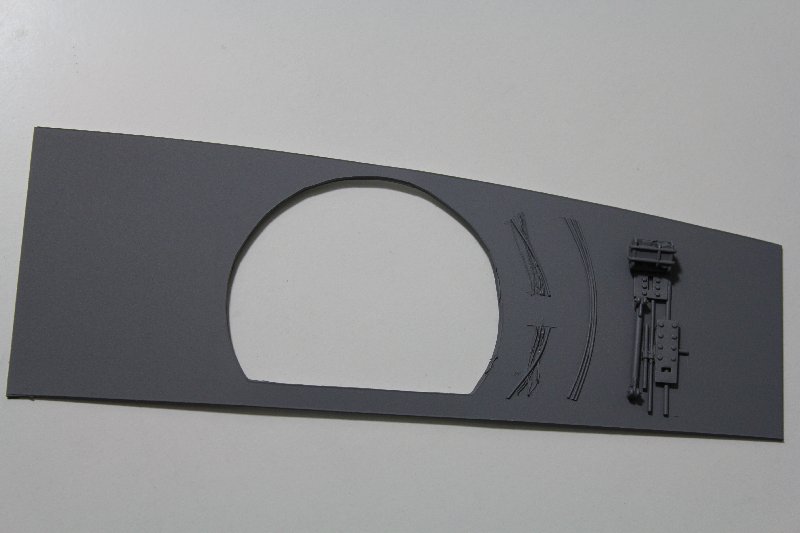

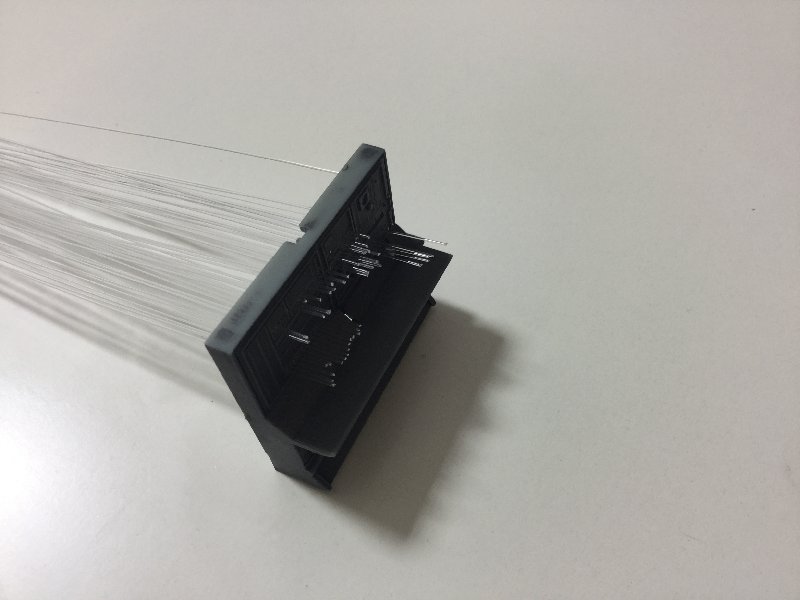

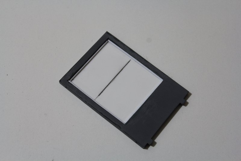

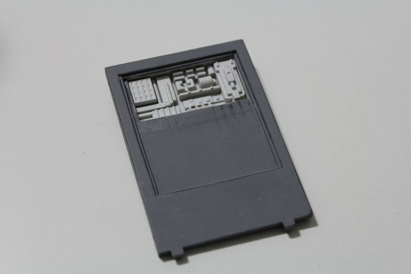

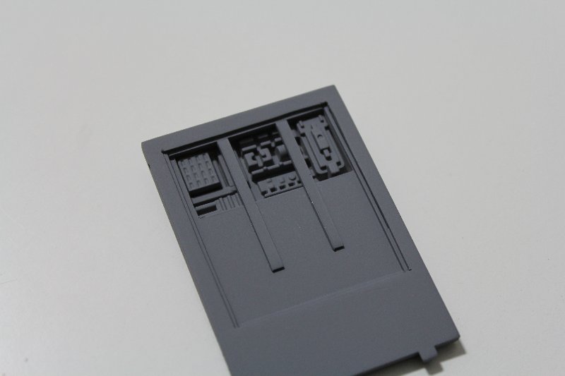

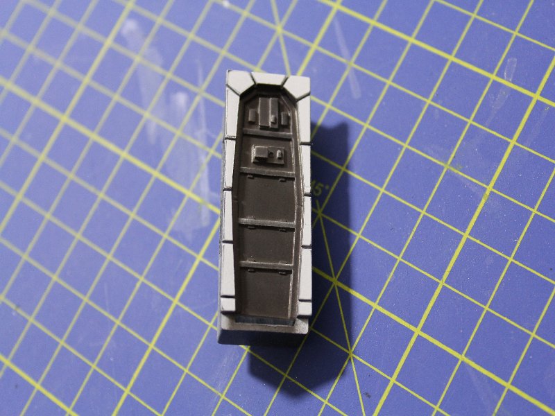

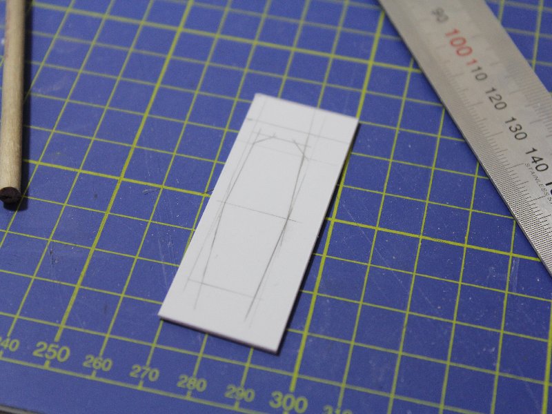

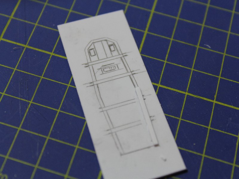

I decided that the sticker just didn't cut it and it needed to have a bit more depth so I decided to scratch build one using 1mm plasticard. The details where copied from the original sticker as it seemed to be accurate enough to work from.

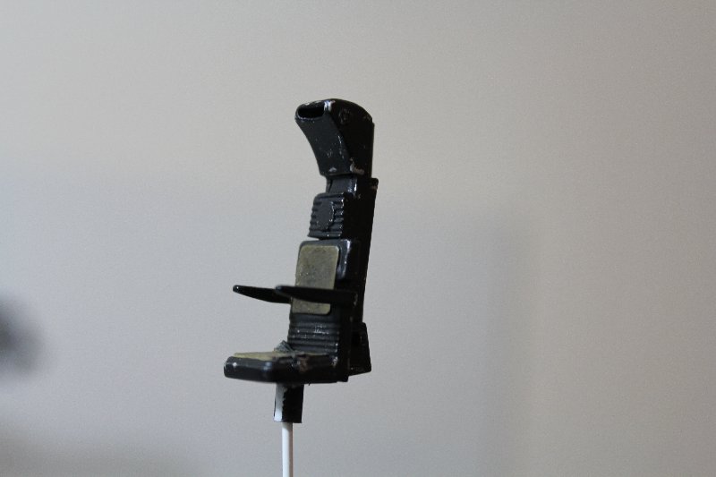

I also scratch built one of the rear passenger chairs from an old Airfix ejector seat (Martin baker)1/48 and pretty happy with the results without having to resort to buying 3D printed parts. (thats not to say that I won't be using such during the course of this build but I will do my best at making my own scratchbuilt parts first)
Also there are some pictures of other areas being worked on while i have certain materials (and idea's) to hand but all this will be covered in future updates.
Thank's for looking in BigGrin
Spencer

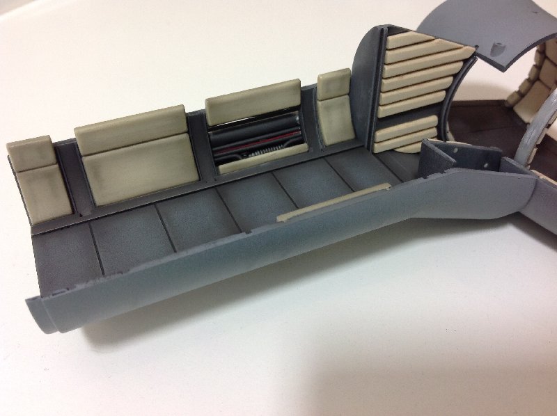

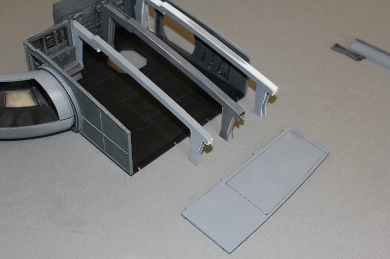

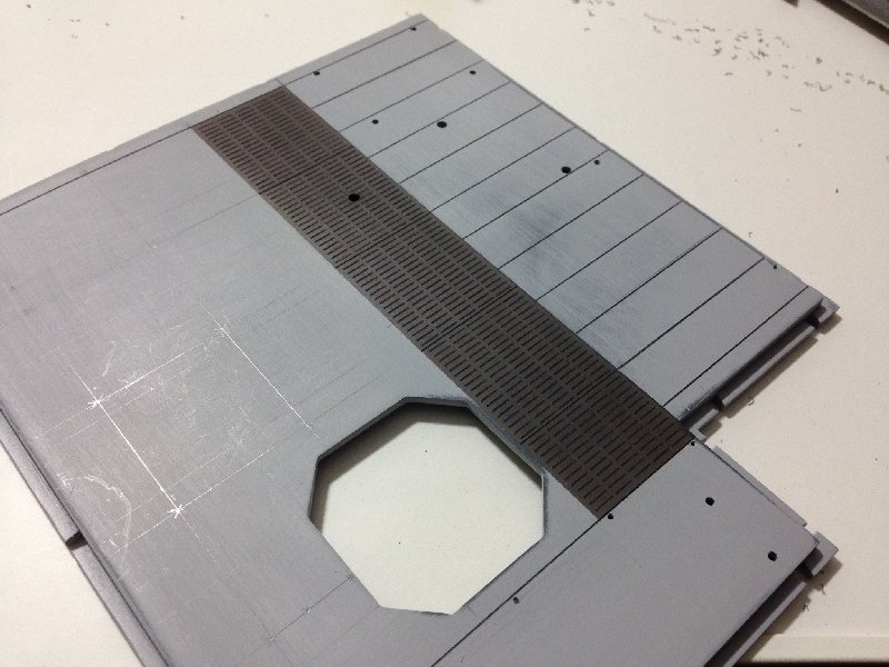

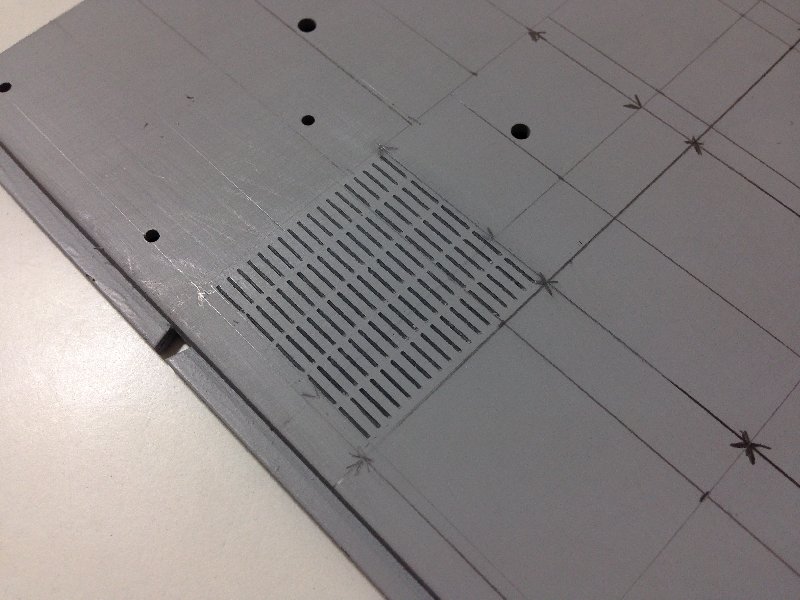

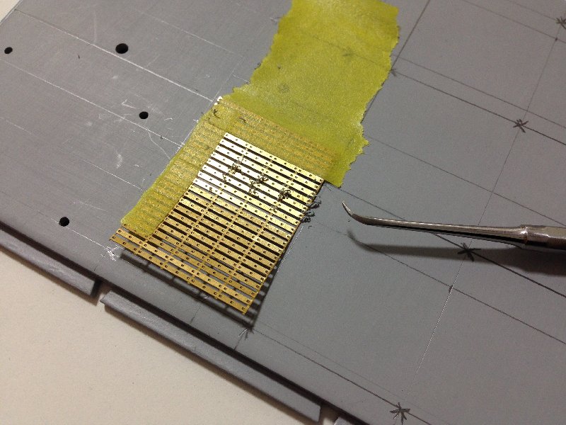

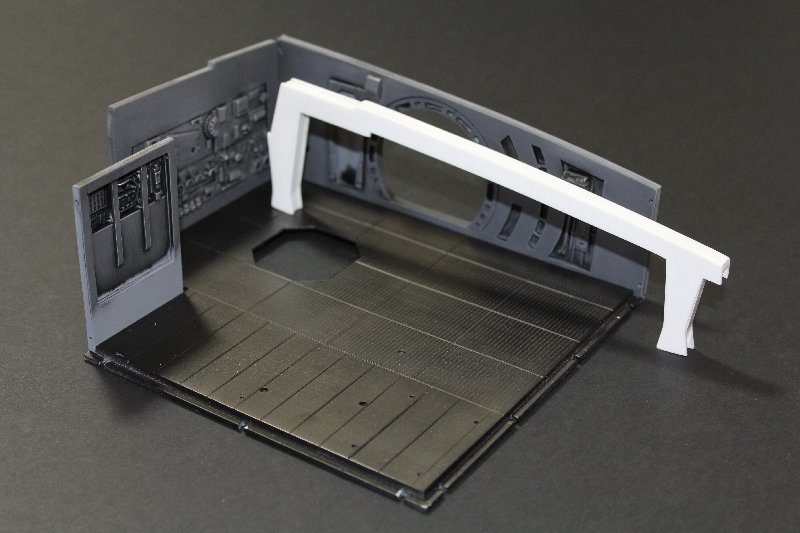

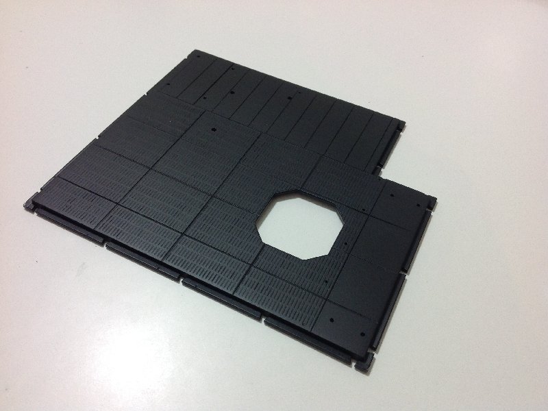

Time for another update on the progress so far and today's update hinges around the cargo hold area. I am still working on the cockpit area but with the small details being added to it i felt i needed to move on to the larger areas that will all come together once the build really starts to move up a gear.
The cargo hold floor has been completely sanded down, primed and then areas marked out to reflect the floor tiles. These where then individually picked out to resemble the grated flooring in the films. I used some photo-etch as a guide and a panel line scriber to remove small amounts of the plastic flooring for which a video of the process can be seen here: Flooring
Once completed the flooring was given another prime and than black winsor and newton oils rubbed in to the recesses and then any excess wiped off.
The cargo hold walls have also had some work done on them with areas cut out and additional detailing added and this is ongoing as is the whole of the cargo hold area with beams being added and additional areas to be fitted.
so until next time!!

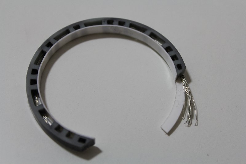

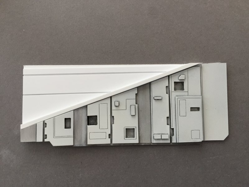

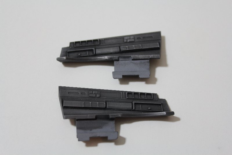

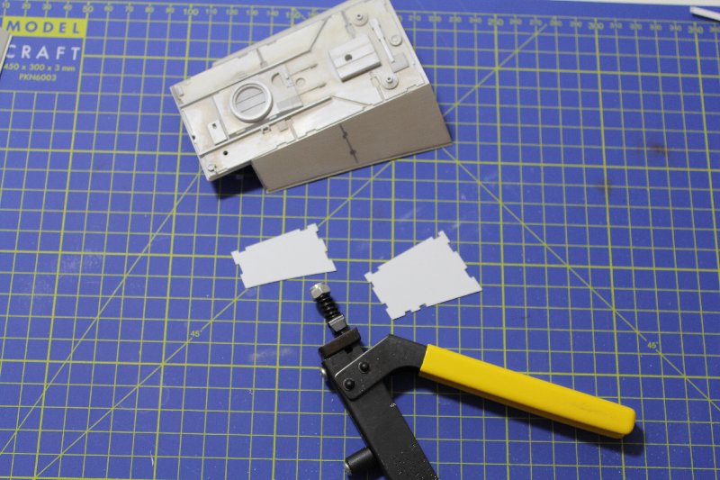

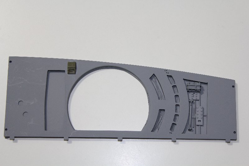

#118 Posted : 10 October 2015 16:52:35

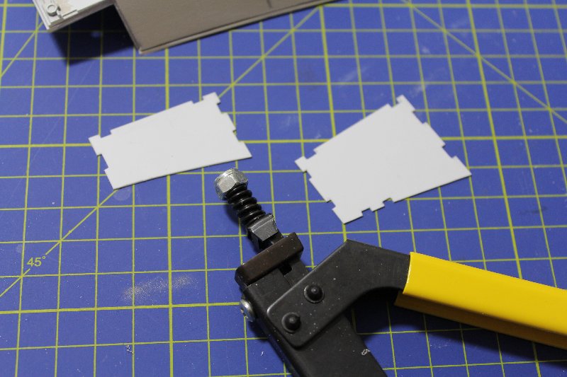

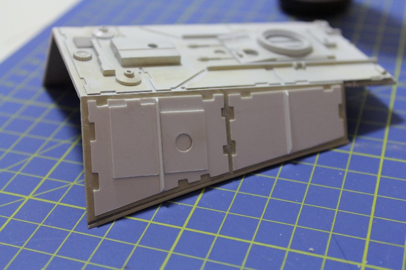

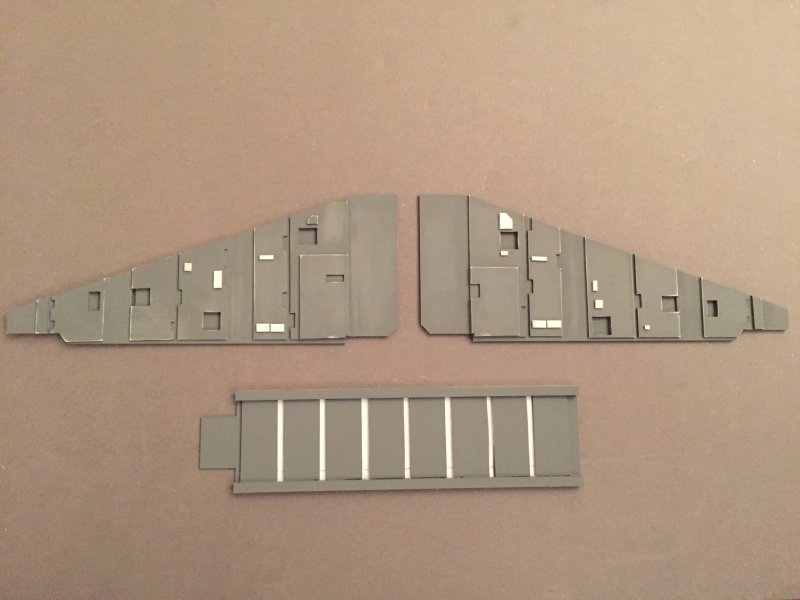

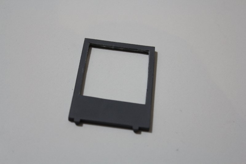

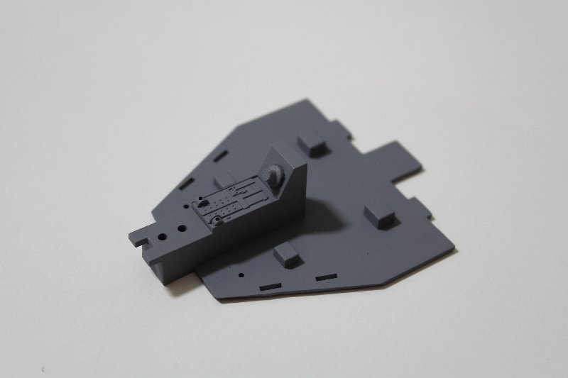

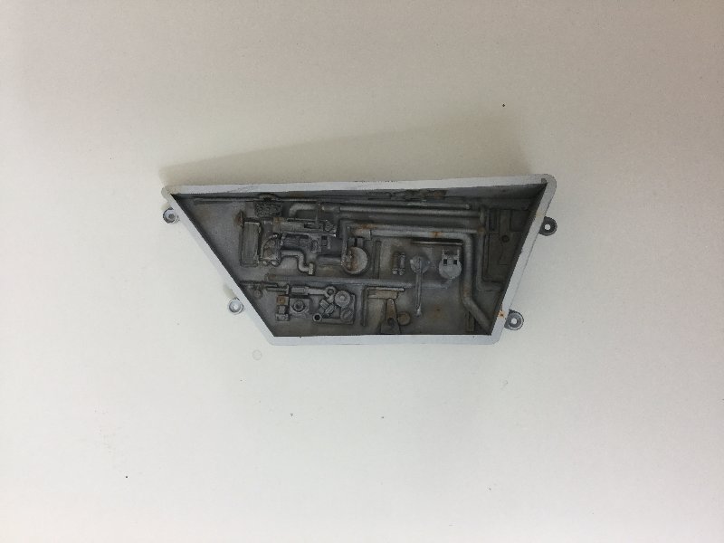

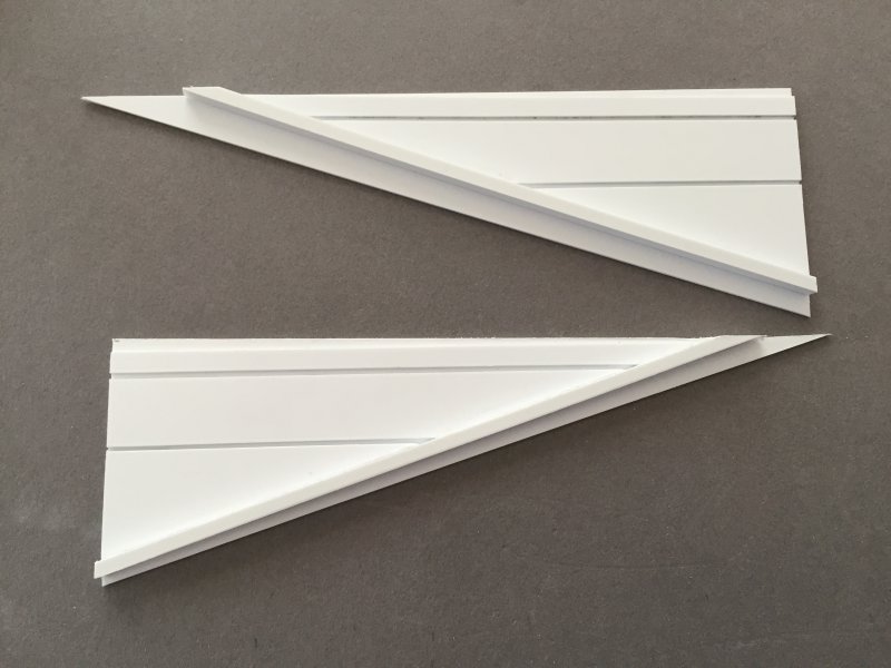

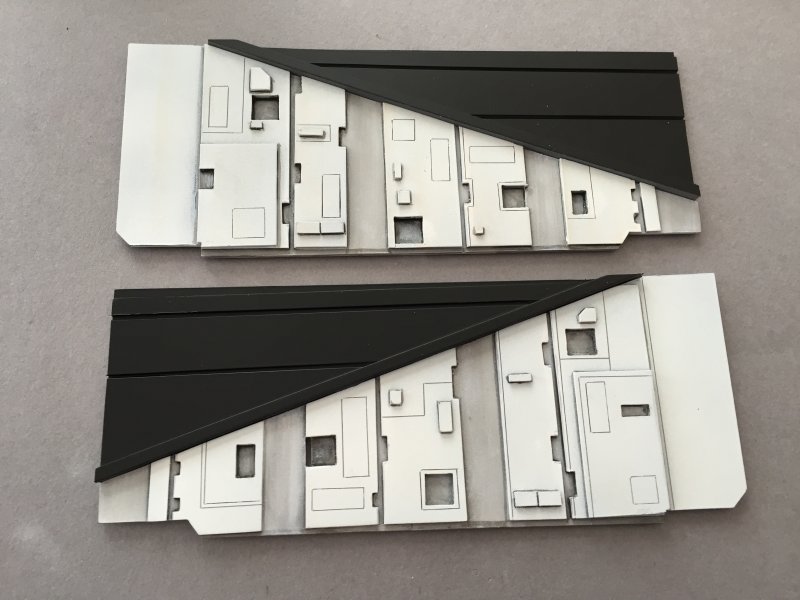

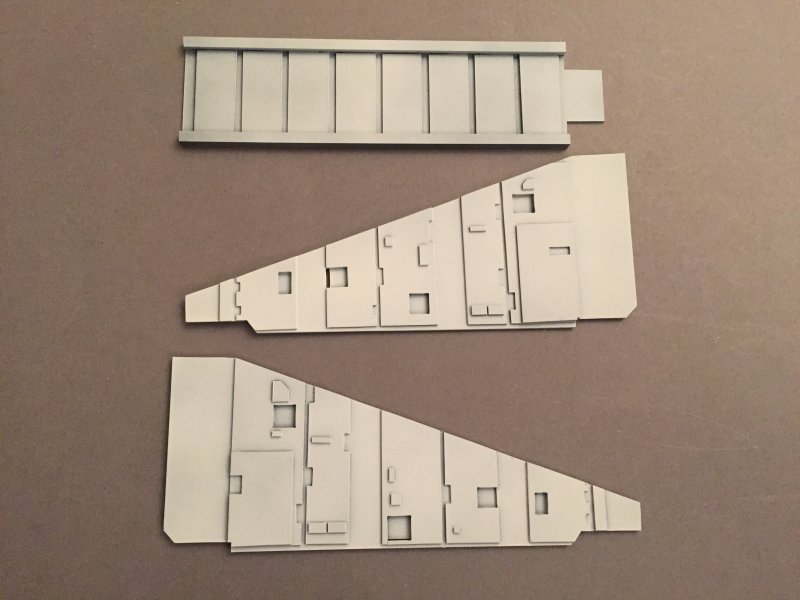

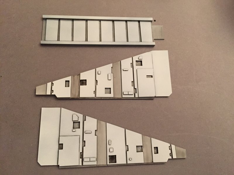

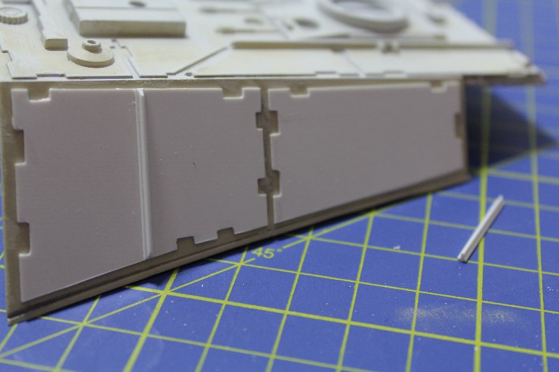

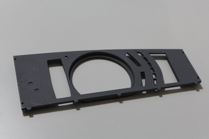

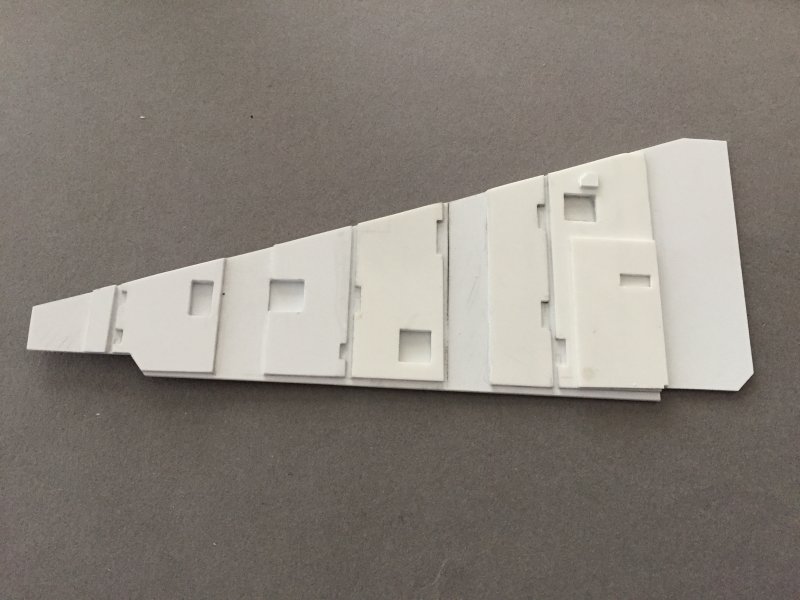

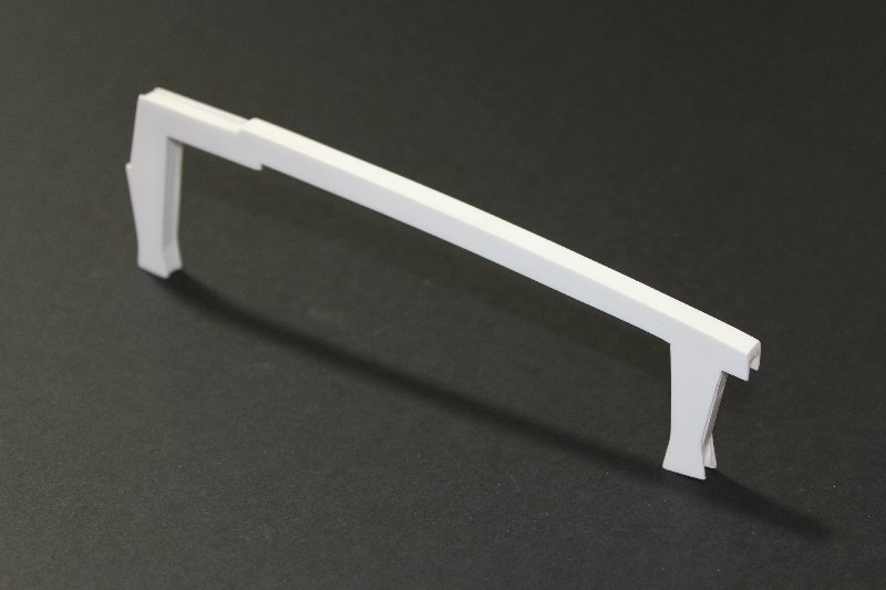

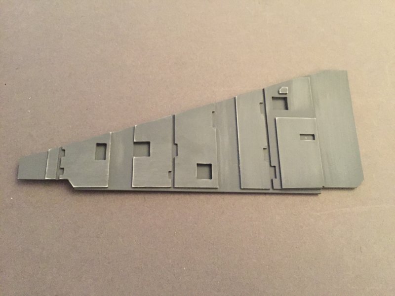

An update albeit a small one as work continues on the cargo hold which will be updated with some info and pictures once I have all the LED lighting required but until then here is an update regarding the side panels of the top Tunnel section otherwise know as TP1 and TP2
Stock evergreen styrene sheet at 1mm was used and a nibbler tool that I got from a well know auction site (£9.99) assisted greatly with cutting out the notches of the said panels. Then evergreen “T” strips where used to match those of the provided parts.
All of the detail was removed as can be seen right down to the base level so to make the appearance of the panels once fitted suitable for what I wanted to achieve.
Other panel details and styrene strip was added to finish off then a coat of white primer ready for my own mix of ESB off white for later in the build.

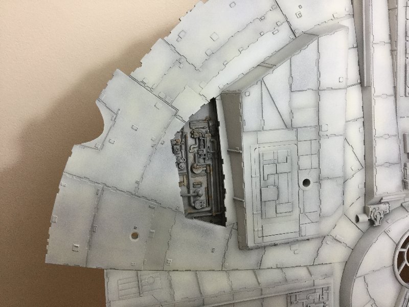

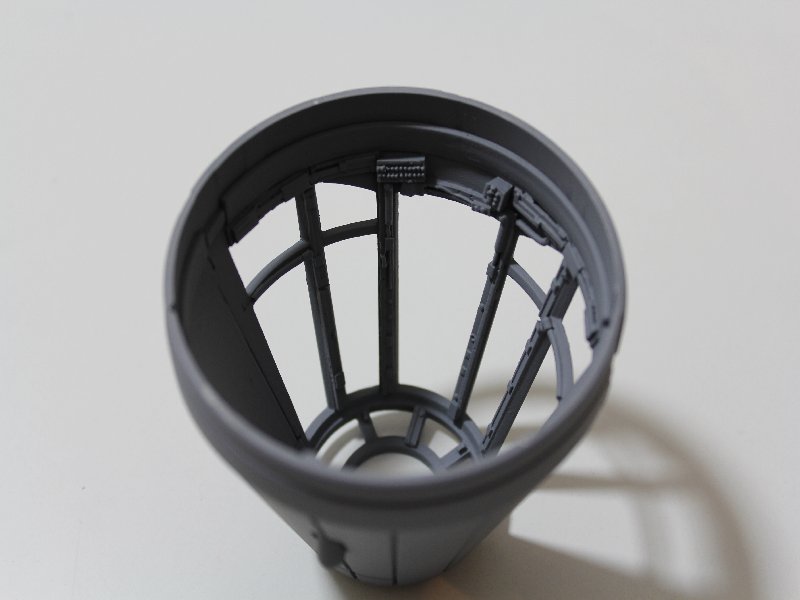

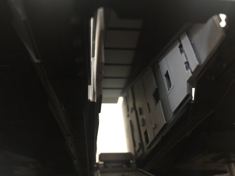

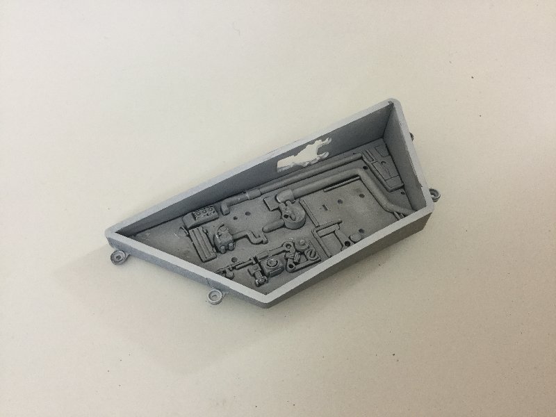

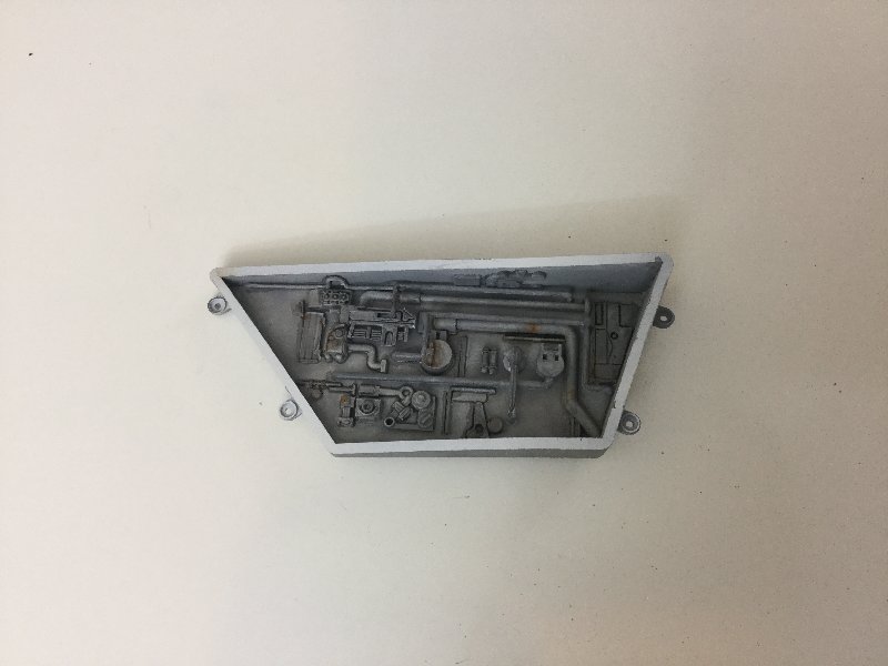

The tunnel has had some small details added to give it a more industrial look with exposed pipes and once again evergreen rod of different sizes and some other kit parts where used for the effect. A base colour of Halfords grey primer was used and a good rubbing over with some black oils from Winsor and Newton for the recesses. A light going over with the airbrush using Exhaust manifold from Alclad finished the deal for that area but more added effects will be added over time as this area is completed.

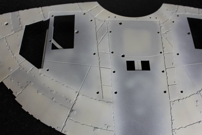

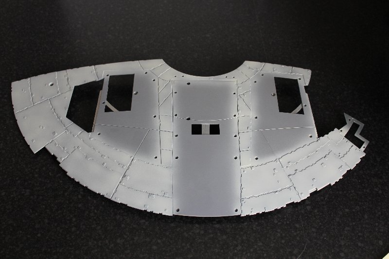

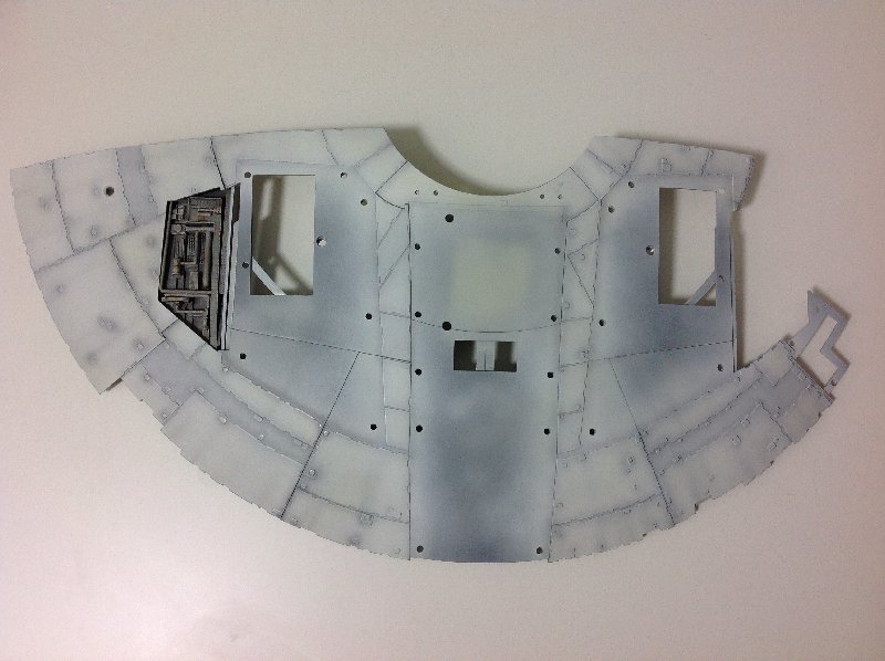

So that I could get a feel of how I was going to get as good a finish regarding the outer hull panels and as a test I decided to prime all the panels in one go while attached to the framework. This was then picked out around areas that would accumulate dust/dirt and other foreign particles to give it a sense of depth and shadows. A light dusting over with Halfords White primer was used so that any panel lines etc would still show through and then a mix of my very own colour was added in certain areas but not all over. Smaller details like streaks etc where then added using the airbrush and Alcads Stainless steel and Exhaust Manifold. Later in the build when all the panels are attached then the fun begins with oil panel colours to match those of the prop and oil streaks and some rusting etc.

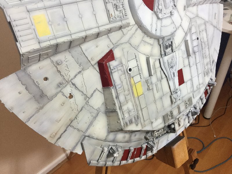

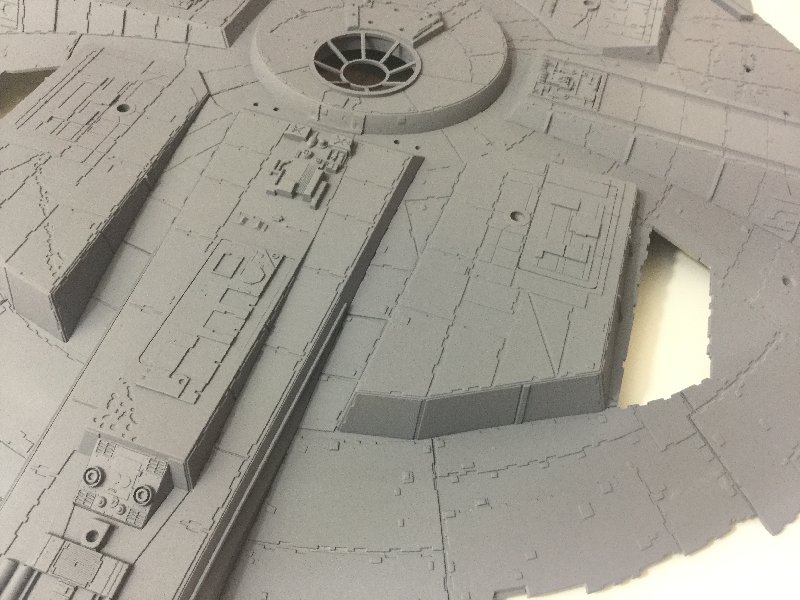

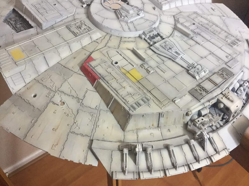

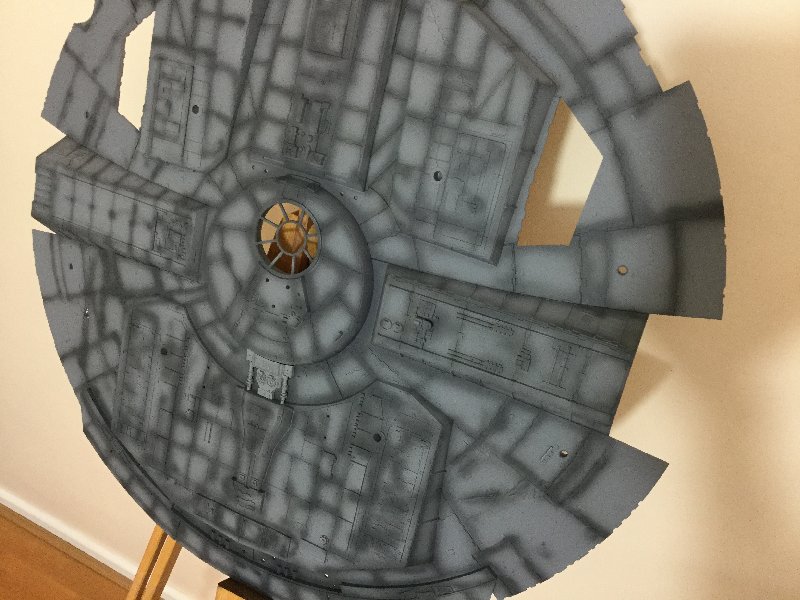

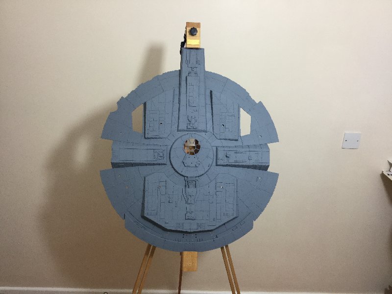

#119 Posted : 16 December 2015 23:19:44

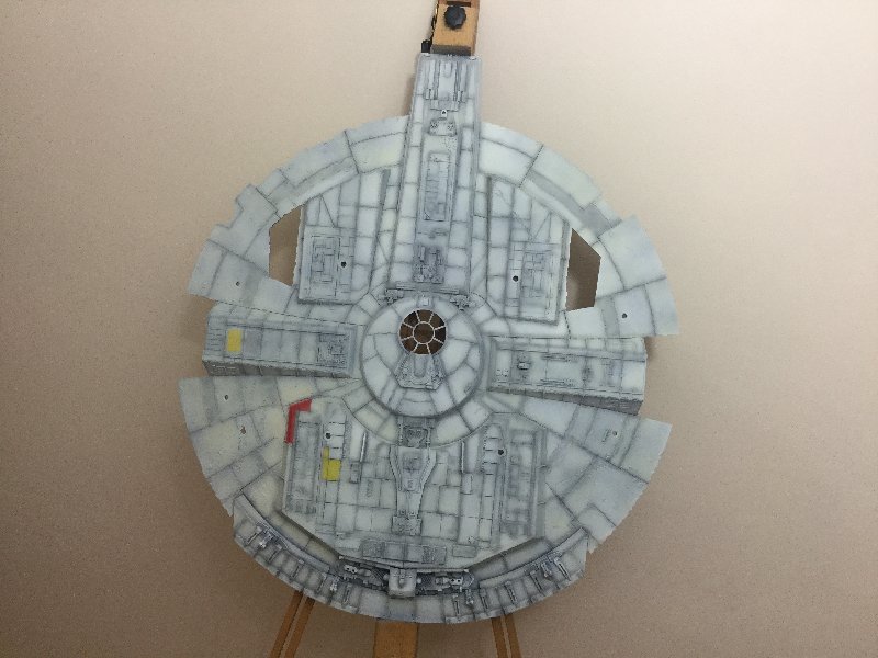

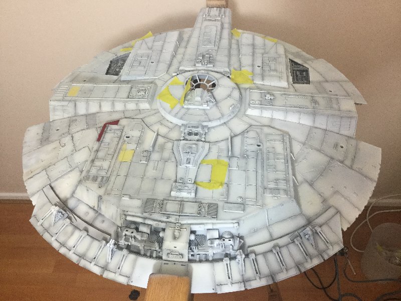

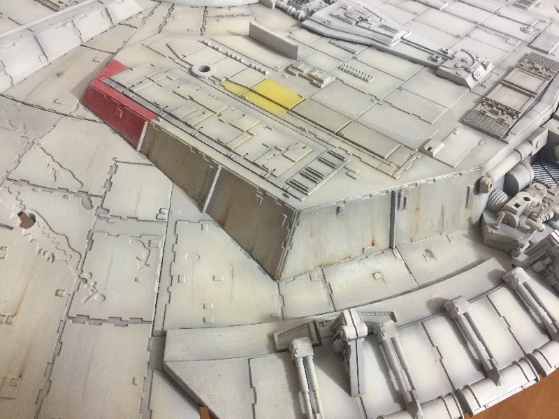

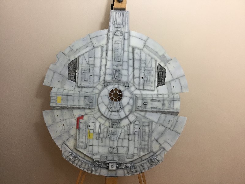

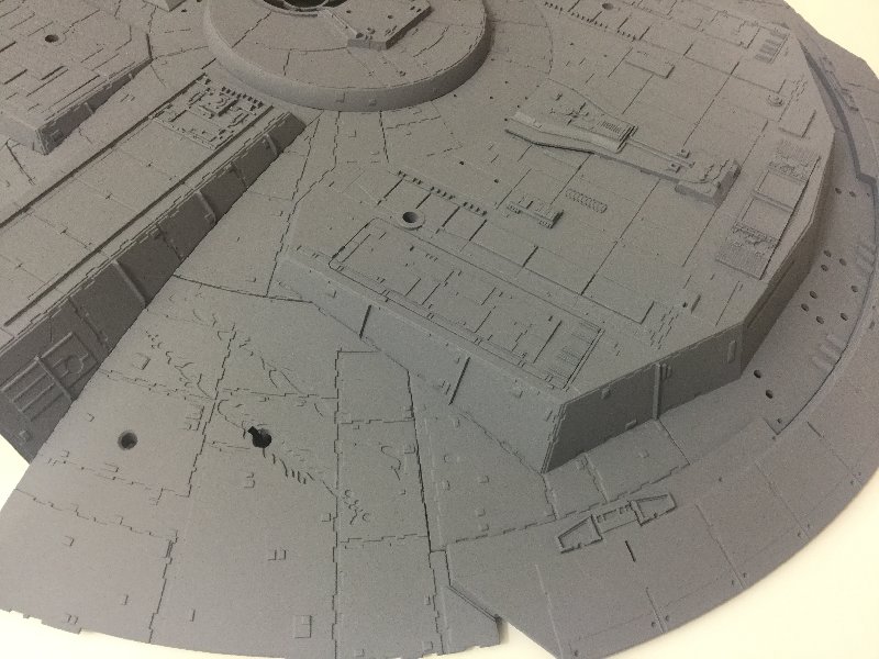

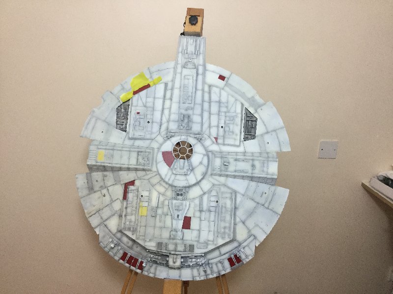

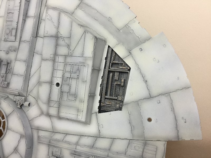

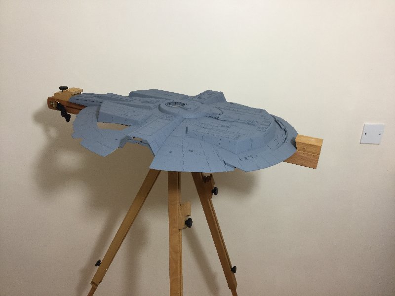

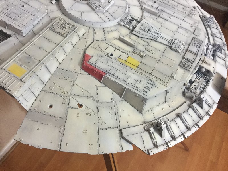

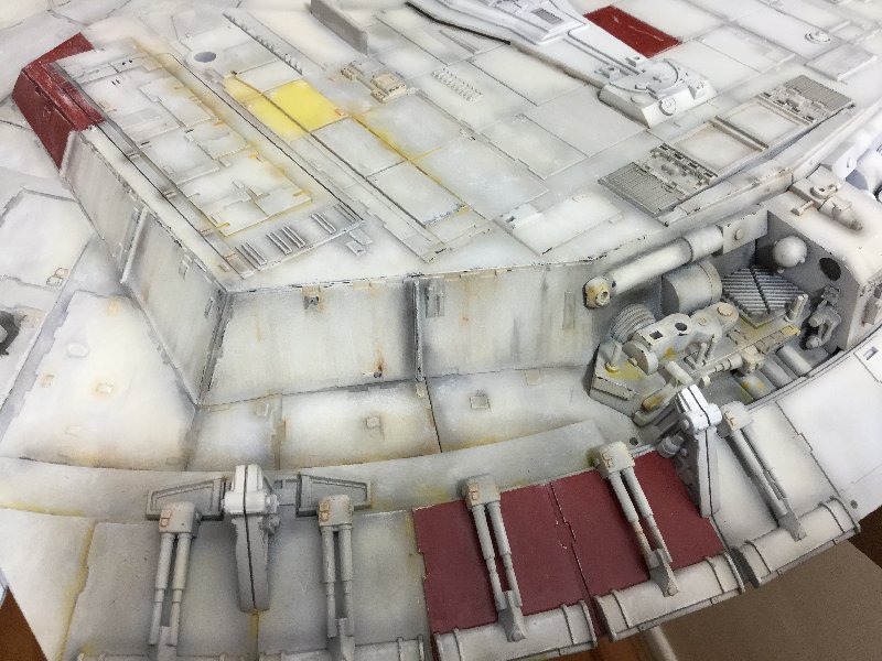

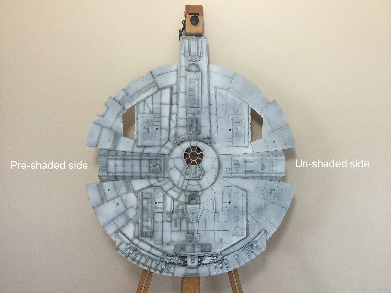

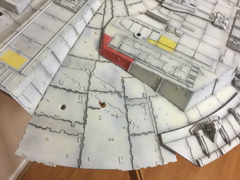

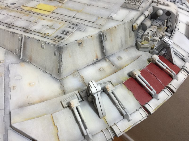

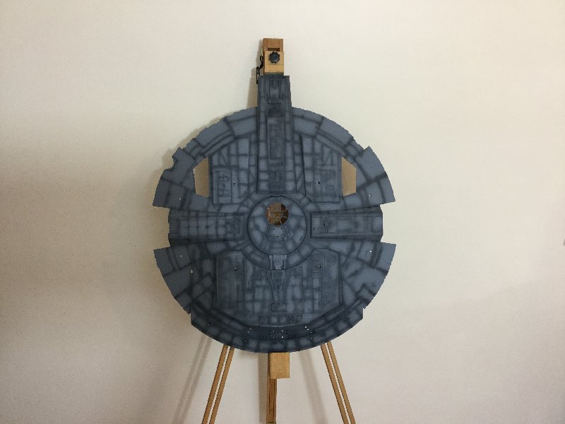

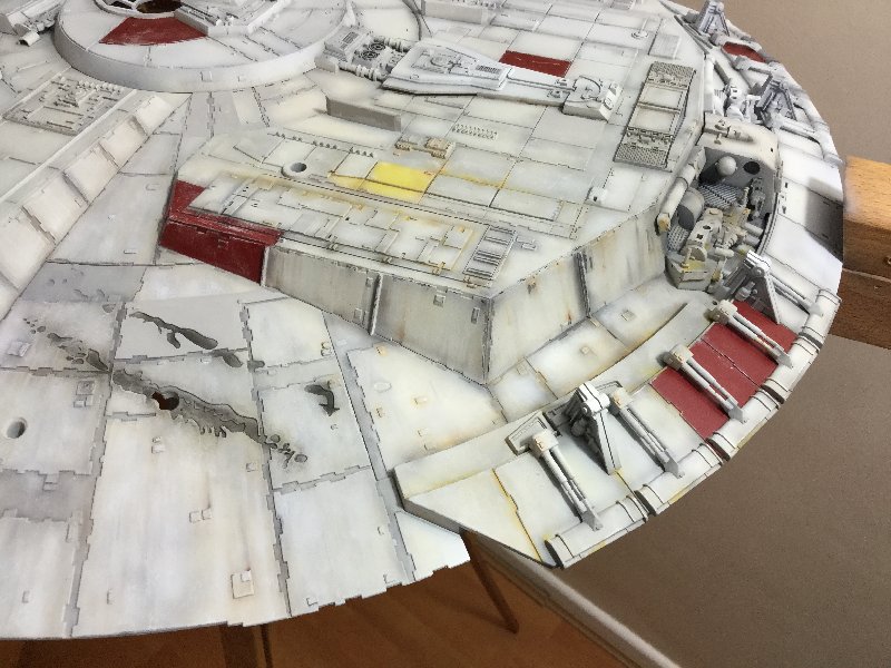

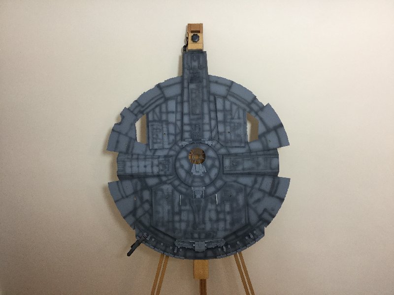

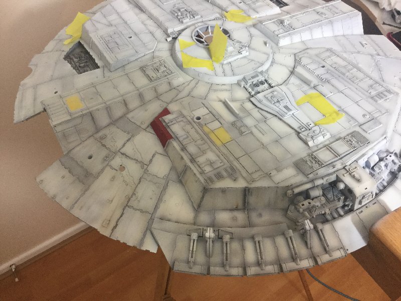

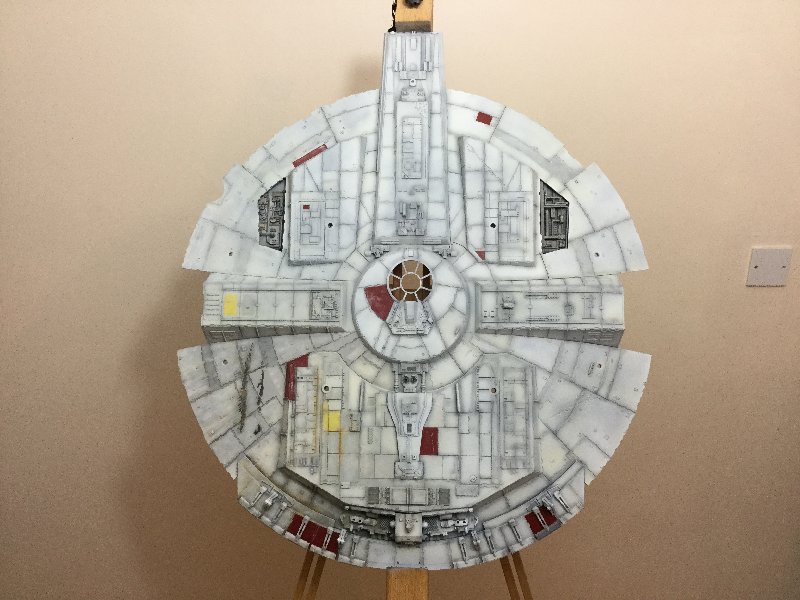

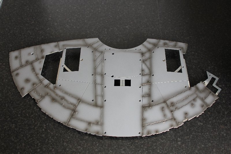

Back for another update and work has started on the lower hull section as I wait for materials and learn more about LED Lighting for the Interior and Cockpit, so hopefully an update on that sooner rather than later. I was going to leave all the paint work until the end of the build but that won’t make for a good build diary so I thought I would start on the lower hull to give me something different to do.
The sections where added to the frame work as per the instructions and then given a few coats of Halfords Grey Primer. This was then given some pre-shading in the recesses etc to give it depth ready for the top/base colour which here I used Halfords White Primer. I light dusting was given to allow some of the Grey and darker panel lines to show through but not enough to add overkill to the panels as this will be added later again using Alclads Exhaust manifold.
I had a “Eureka” moment while I was in an Art shop and picked up the Easel for £20! Bargain and as you can see it makes everything so simple to work on.
I used Zero paints to give some colour to the panels in Yellow and Red but these would not be the final colours used as you will see later in the series of pictures.
Oils and washes where added and then a series of different Vallejo paints to get the “Dirty” look. More streaks and stains will be added towards the end of the build but a section was worked on so that I could get a feel of how I wanted the Falcon to look.
Some dry brushing and some scraping here and there with scalpels and sand paper was added to give it some character.
The “Laser Blast” Damage will be worked on later with a Dremel so it’s closer to the Prop Damage.
Videos of the Lower Hull being painted etc will be uploaded soon and links provided here.
https://www.youtube.com/watch?v=HHrvyqOCJH4
https://www.youtube.com/watch?v=lao1nLZ3l5I
https://www.youtube.com/watch?v=JXgWt0zmbN8
https://www.youtube.com/watch?v=E7c3N_doync
Paints Used:
Zero Paints Rosso Scuderia (ZP-1007
Zero Paints Williams FW14-B Yellow
Zero Paints Grey Primer (some panels)
Vallejo SilverGrey
Vallejo Deck Tan
Vallejo Medium Sea Grey
Vallejo Red (RAL3004/FS30160)
Nuln Oil (Citadel)
Winsor&Newton Burnt Sienna and Cadmium Yellow

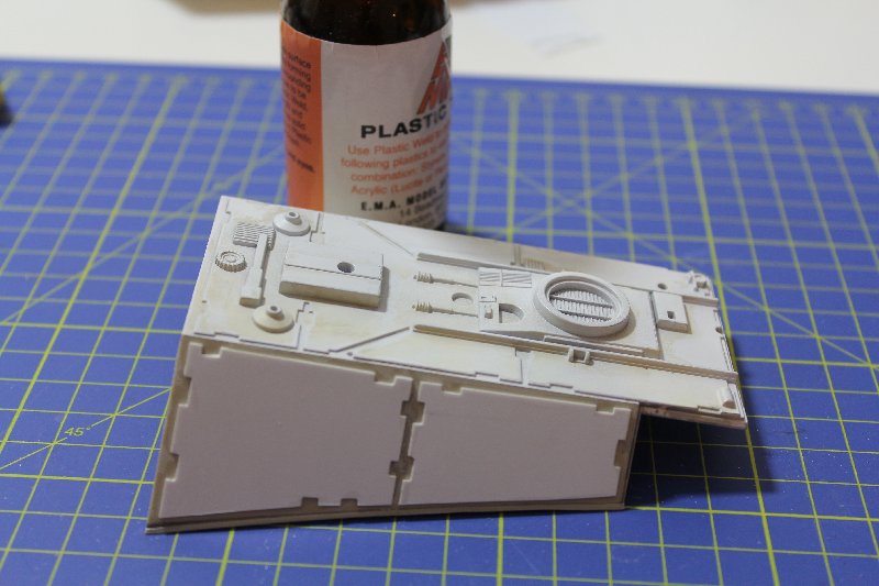

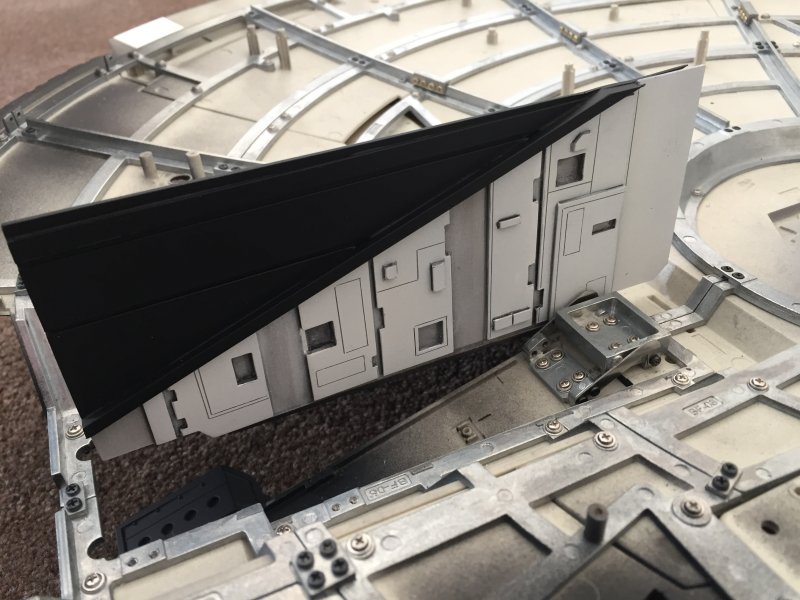

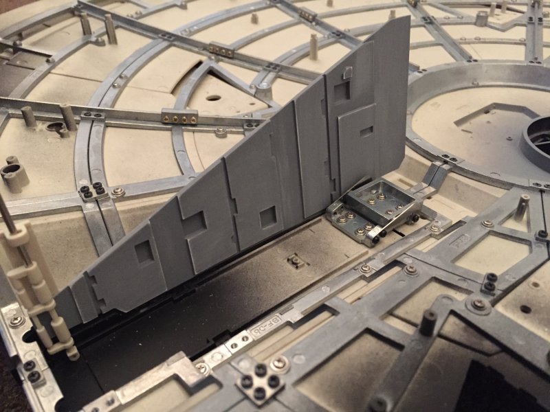

Ramp Access area...
A long overdue update and in this section I have decided to modify the Ramp Walkway access area. There was a lot of cutting to remove the supports for the motor that raises and lowers the ramp and this will also be modified so that the ramp still opens and closes. Later on in the build I will hopefully have a modified motor system working.
1mm thick plasticard was used and I used reference pictures from the films to get an Idea of how I wanted it to look. More details will be added over time including working ramp pistons etc..
Panels where primed and then a coat of white with the usual panel detail etc
