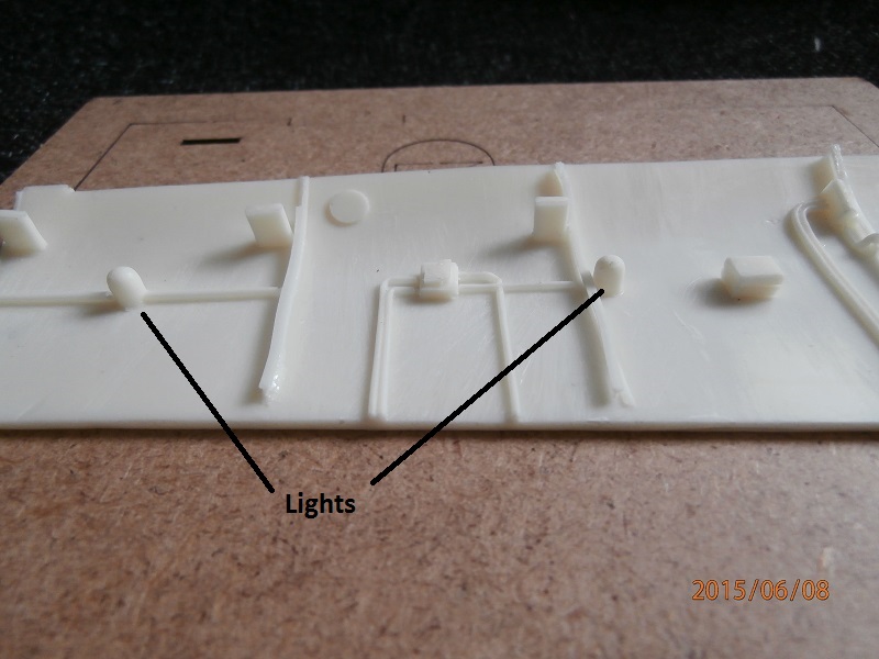

On examining the ceiling part of the torpedo room enhancement (pic below) there are 2 light fittings moulded into the part. I plan on removing these and replacing them with my custom lights.
I was thinking of making one red and one white but then thought I could make the light source switchable and then each light could be lit either red or white - not strictly accurate but a compromise.

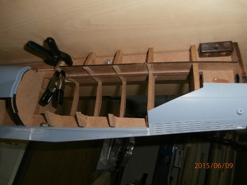

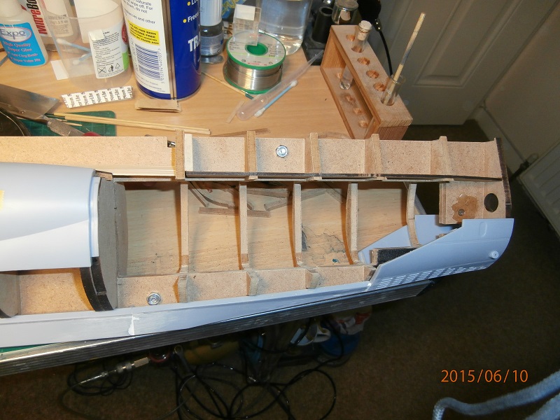

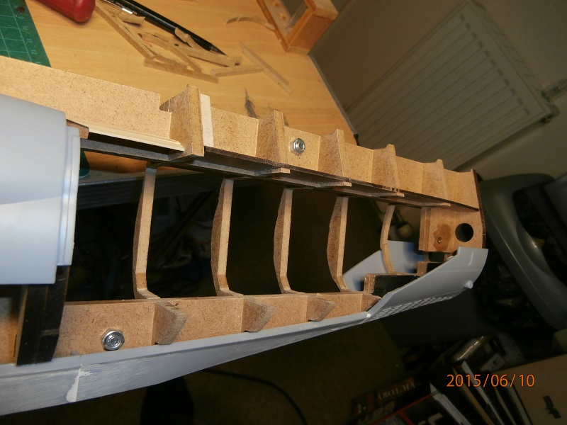

So I took the plunge last night and started to remove the bulkheads for the torpedo room enhancement. After removing the aft 3 sections I noticed there was some lateral movement of the bow section - loss of rigidity. On investigation I saw that the longitudinal supports (parts 84 and 106) were approx 2mm short of meeting the aft bulkhead so allowing some movement.
To stabilise this (until I could plank the port side) I put the hull back in its building clamps and cut a small piece of mdf from an old part fret and glued it to the bulkhead, part 84 and the central longitudinal frame. I then left it to dry overnight.
This morning I removed the clamps and then the hull from the board and everything was rigid again.
I then finished removing the bulkhead parts and sanded them level.
I did this before fitting my fibre guide tubes so I can check the fit of the resin parts and see the best place to run the guide tubes.
I was also looking at the enhancement fitting instructions I had downloaded from the forum at Marinemodellwerft_de and found that there were no instructions for the ceiling parts. On trying to go back to the site I found the forum had goneCursing so I will have to 'play it by ear'. I did notice in the shop, however, that they now have 3 resin figures for the build.
More to follow

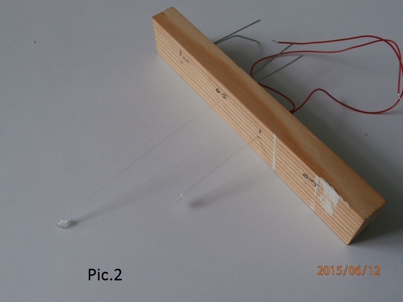

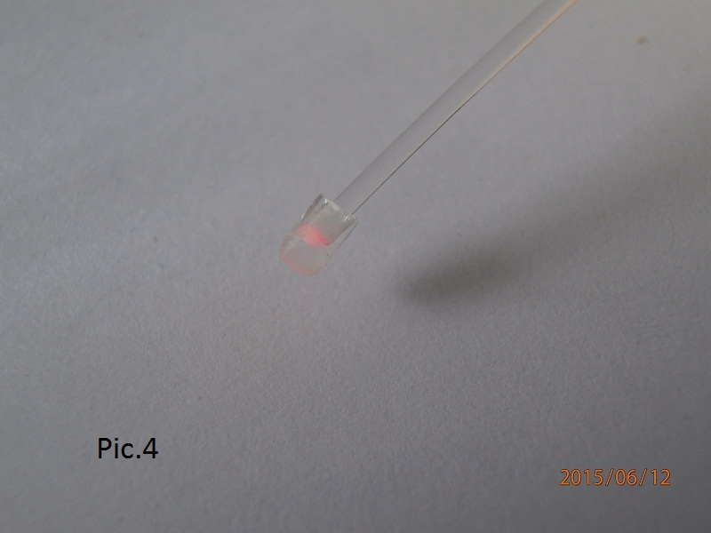

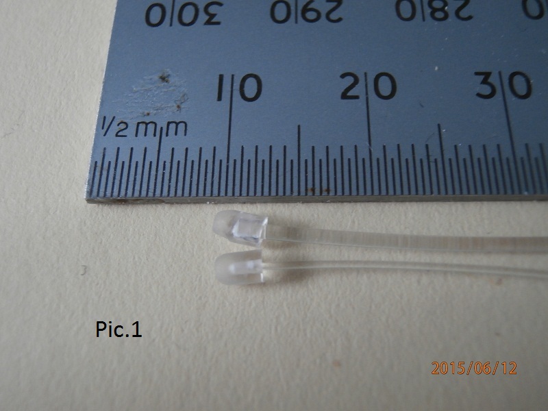

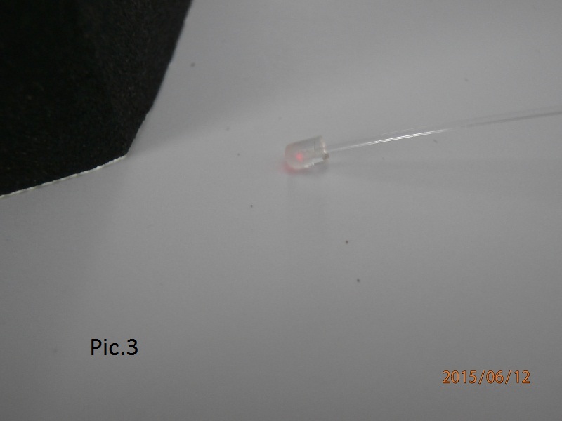

Well I have been doing some tests on the fibre optic lighting. I made a couple of 'bulbs' from 2mm diameter clear plastic rod and drilled a 0.5mm hole in the back of one and a 1mm hole in the other to take the fibre, pic.1.
I built a simple jig to connect the led's to the fibre ends and gave them a try, pic 2.
The 0.5mm fibre doesn't put enough light through to give a noticeable effect, pic 3.
The 1mm fibre isn't too bad - difficult to photograph in daylight but seem quite effective in reduced light, pic.4.
However, as I am hoping to to show all three 3 coloured lights (white, red and blue) where appropriate and I can only get 4 1mm fibres through the guide tubes I will be using, the fibre lighting option is seeming less of an option.
