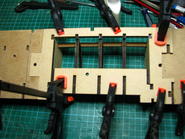

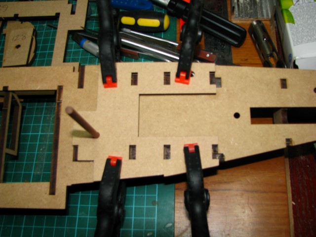

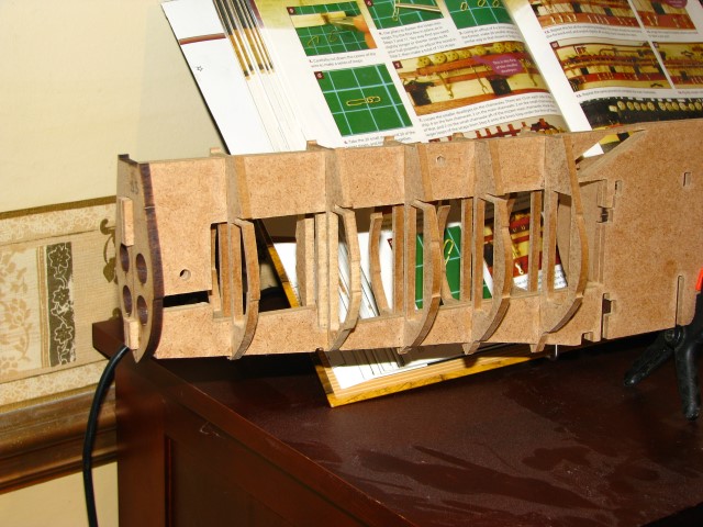

BUILD UPDATE #8
Welcome back shipmates.
This week sees the continuation of the U-96 build with issue #9, which makes a start on the left (port) side of the hull framework.
We are deviating from the official build assembly in that parts 1-L, 128 and 44 will not be used, but substituted with the MDF framework which is part of the forward torpedo room conversion.
First of all, the slots in the 'new' frame needed a little work to square them up with a small needle file so as to accept the transverse frames that come with the 'mod'. as explained earlier, this was because the replacement parts are milled and not laser cut.
Also, the horizontal slot at the front end needed opening up ready to accept future parts.
All went well, but a small adjustment was needed to the frame because after looking at the images I took of the build stage, I noticed it was slightly out of line, so it was necessary to pry apart the frame and re-fix it in the correct alignment.
Then it was only a matter of checking the transverse frames for correct fit and then gluing them into position.
That's all for this week, thanks for looking in and, as usual comments welcome.
Happy building
David

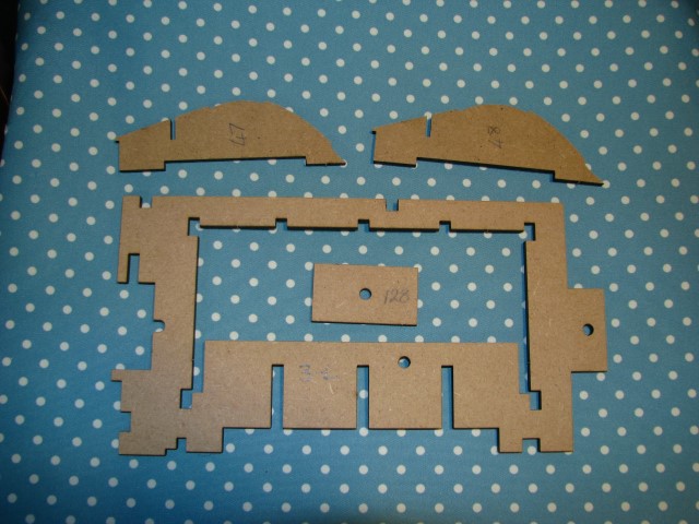

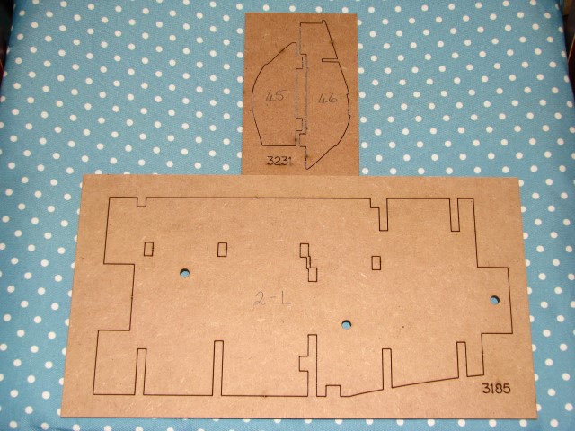

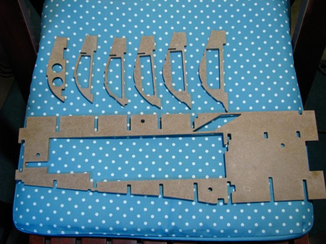

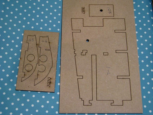

BUILD UPDATE #9
Hi again friends.
This week is issue #10 of the u-boat build. But not so much a build update, more of a review.
The parts supplied with issue #10 (2-L,45 and 46) are not needed here as 2-L was incorporated into the large MDF frame for the forward torpedo room conversion and the lateral frames 45 and 46 are replaced by lateral frames supplied with the conversion kit.
That's it for this week, thanks for looking in and the kind comments from last week. just to finish here's a couple of images of the parts mentioned.
Happy building
David

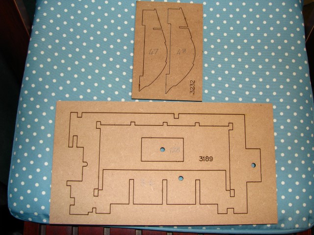

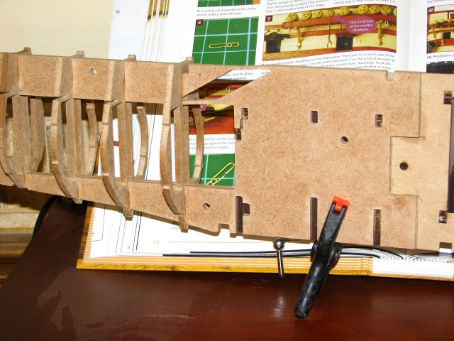

BUILD UPDATE #10
Hi shipmates
This week issue (#11), deals with the fitting of the longitudinal frame 3-L, the left-hand cutaway section for the control room.
Transverse frames 47 and 48 are omitted from this build because the parts from the forward torpedo room conversion are used in their place.
After checking the fit of part 3-L, it was glued and fixed into place and clamped until set. I found that there was a slight imperfection in the accurate alignment of this part and some filing/sanding will be required at a later stage.
A line was drawn between the forward edge of the top slot and the rear edge of the bottom slot on what would have been part 2-L, and part 128 (a reinforcement part)was glued into position, aligning the front edge with the line and using a piece of dowel to centre the hole.
That completed this weeks work. Thanks for looking in and more next week, or whenever my next delivery arrives.
Happy building
David
