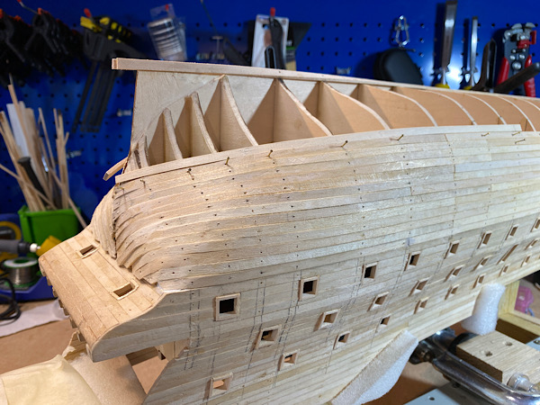

#118 Posted : 24 June 2020 23:25:24
Joined: 28/05/2014
Posts: 82
Points: 248
Location: London
Some quick update shots before I start the last section of plans.
6 years and I’ve nearly finished planking the hull!
It has always been my intention to finish the build, not least because I promised my grandfather I would before he passed away (he took a keen interest) setting up a company does tend to take your attention away from things though.
Anyway back at it and really enjoying the build so far.
Critical input would be appreciated, it would be good to know if I’m walking into a mistake!
I’m a bit worried that the bow and stern ends are planked higher than the middle section. Any suggestions how to get around that, just start tapering?

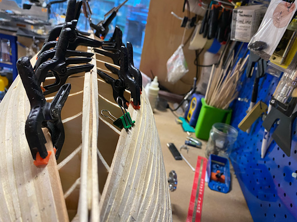

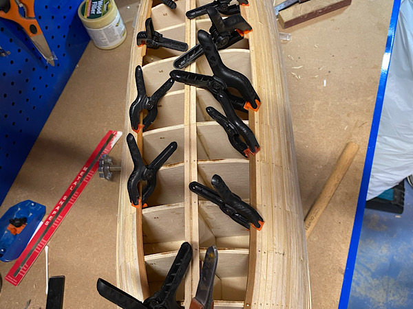

William's Build
#119 Posted : 09 February 2021 16:32:29
Joined: 28/05/2014
Posts: 82
Points: 248
Location: London
Hi folks, quick one.
As I approach the end of the planking, I’m finding that I haven’t tapered the bow and stern planks enough, as such I’ll end up with a gap in the middle.
Any suggestions?
Roeland
#120 Posted : 09 February 2021 16:35:16
Joined: 23/09/2018
Posts: 154
Points: 471
Location: Cape Town
If you paint it you can fill it.
