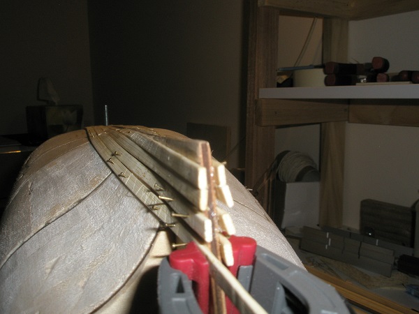

Hi George
Here's a pic of my little prob re lifting planks.
Thanks for the response on your thread...BigGrin
JohnP

George1
#106 Posted : 02 August 2014 05:42:23
Joined: 16/03/2014
Posts: 516
Points: 1,563
John Passmore wrote:
Hi George
JohnP
Hi John. BigGrin
Yes I can see your problem OK. Confused Crying
It has to come down to the glue and clamping to stop that lift. If you don't have the luck with the red or blue top glues then you might need to look at much stronger expoxy types. Your hardware should be able to advise on stronger type glues. Try of course a heavier application first.BigGrin
While it might sound silly just check your planks have no oil or other substance on them anywhere from storage as that is about the only other reason the glue will not take with clamping if enough glue put on. Blink
Check my last reply my thread re planking overhang. BigGrin
George
Building HMS SOTS
#107 Posted : 02 August 2014 08:19:27
BigGrin Hi John You can punch the pins into the plank and leave them in . As long as they don't stick out and just under the level of the plank it will stop them pulling away BigGrin Hope this helps rgd Martyn
#108 Posted : 02 August 2014 10:22:10
Hi John, just been catching up on your build and your comments on George's diary.. Your pic highlights the problem you are having very well and it was an area I had similar problems with. I don't believe it is down to the glue you are using, it is down to you not having applied enough of a twist to the planks before fitting. It comes down to trying to force planks where they don't want to go naturally, relying on pins and glue to hold the twist in position. You need to ensure the twist is fully formed before glueing, to do this I held the plank over a steaming kettle and applied the twist. When I was happy with the test fits then I pinned, glued and clamped into position. It is a good thing the planks are popping off now as I think you would rather have this than to have them popping off much later down the line when it would be a lot more difficult to put right. Just for info, I use alphatic PVA and have found it to be more than adequate for the job of planking.... Hope this helps but if you have any queries then simply just ask.... Look forward to seeing your progress... Cool Cool

John Passmore
#110 Posted : 02 August 2014 14:05:59
Joined: 25/04/2014
Posts: 374
Points: 1,134
G'day Alan
Thanks for looking in and the excellent advice offered. I just carried out the experiment with steam from the kettle, and as you already know it works a treat - you're a legend Alan - you got me out of a bit of a bind there!...BigGrin BigGrin BigGrin
The test plank is sitting on my desk here - cold now - and with a perfect and permanent 90deg twist in it.Cool Cool
Once again many thanks for your valuable input.
JohnP
#111 Posted : 02 August 2014 14:17:51
G'day Alan
JohnP
Hi John, am very pleased to hear the advice has helped you out and you are back to full steam ahead...Laugh Laugh (couldn't resist the pun), I'm here to offer all the assistance I can to you and your fellow builders of this wonderful kit. If I can't help you then I know plenty of members on this forum who can and will also readily assist....Cool Cool

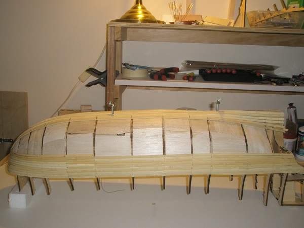

JohnP
PS... I've almost run out of planks as the newsagent gave me a second issue 20 instead of issue 21 and I didn't notice until the following week. So this week I received issue 22 (2 cannons only) and have to wait till next week for issue 21Mellow Mellow

Hi John, it would be really helpful if you could post a few pics of where you are now, that way we can be sure the advice we offer is the best we can give... If I remember correctly, on my build I had no need for the tapering of planks at both ends running along miship area, at least not until later. Let the planks lie where they want to go, don't force them into position, any forcing will just create more problems the further into the planking phase you go..... A few pics would help...Cool Cool

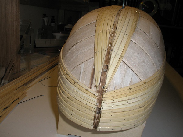

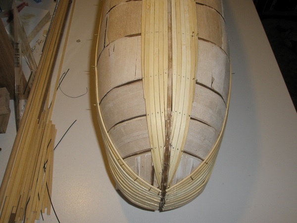

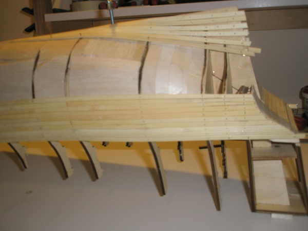

Hi Alan
Thank you for your prompt response to my query.
Here are some pics below; you will see I've got the 6th row bottom plank fitted which starts as a taper between frames 5 & 6 and extends to the stern post. It seems to me that the planking is narrowing down too much at both ends and so might need the additional planking midships only, to fill out the hull a bit more.Mellow Cool
Maybe I'm just an old worrier - like Geronimo...LOL BigGrin
Your thoughts would be appreciated.
JohnP

#118 Posted : 11 August 2014 15:57:24
Hi John, looks to me like you are doing just fine. The small gaps on the bow can be filled in with wood filler when you come to the sanding stage, larger gaps can be filled with tapered planks... Remember also, everything will be covered up by the second layer so what you are trying to achieve with the first layer is a good smooth flow to the hull and a good grouding ready for the second layer... Link below is to the same area on my build and you will see your's is looking very similar so continue as you are.
http://forum.model-space...sts&t=5013&p=22
Keep following the build instructions and keep a close watch on Mr T's official diary especially from issued 22.
Will be watching to see how you get on....

George1
#120 Posted : 12 August 2014 02:56:31
Joined: 16/03/2014
Posts: 516
Points: 1,563
Hi John. BigGrin
Looking good mate. Cool Cool
Yes you will find that there are a number of tapered planks from bow to stern re hull bottom. I checked Alan's and Tomicks builds counting off planks to see when and where to do. A couple do not go to the bow and finish around rib 5 and 7 to the stern which eventuates in more or less a straighter gap between hull planking and bow to stern planking which is then easier to fill in. BigGrin
As Alan says These planks are for cover and shape for 2nd lot of planking so as long as you're happy with the final finish a few pointed strakes won't matter. BigGrin
Does get a little tricky around stern re issues 23-25.I'm gonna' be following Alan and Tomick's build closely. Mellow BigGrin
Re your "Burnisher Query" my thread: You can get from bigger Gun Shops. My son got mine from the Midland Gun Shop, Great Eastern Highway. Don't know name of shop but easy to find in yellow pages under 'Guns or Firearms".BigGrin
George
