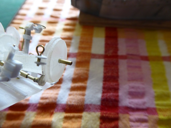

I started by drilling into the base of the lower deck gun to accept a 1.6mm brass dowel.
#1082 Posted : 25 July 2019 22:03:18
I then drilled the corresponding, locating hole into the lower deck.

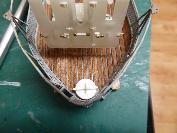

I then began planking the lower deck in mahogany as per the original with 2.0mm wide x 0.5mm thick strips. I used 0.5mm plastic spacers to give me the correct gap. 0.5mm in 1/48 scale is roughly equivalent to 1 inch in real life.
#1084 Posted : 25 July 2019 22:07:45

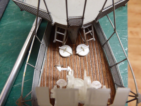

I then ran out of mahogany strip!Blushing Blink. I have ordered more from Cornwall Model Boats, but in the meantime I started to cut away some of the planking to accommodate the rearmost water-tight ammunition container. A little more tidying up to do on this, but it's nearly there.
#1085 Posted : 25 July 2019 22:08:31
The water-tight ammunition container being tested for fit.

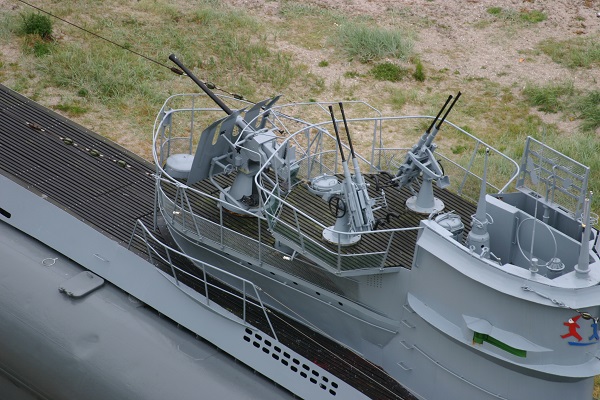

Hi Andy, good question. I imagine there would be cross members. Most of the photos I've seen don't show this detail, so open to artistic license. I've attached a photo of U995's deck so you can see the deckng, however, you can just make out what might be cross members. From a model making perspective, adding cross members would be detrimental to the strength, as the veneer i'm using for the planking is only 0.5mm thick, making it very fragile. Weight applied to any part not supported by cross members would easily break.
Phil.

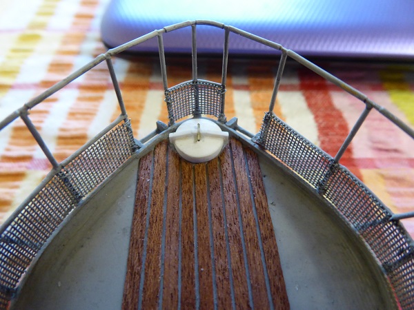

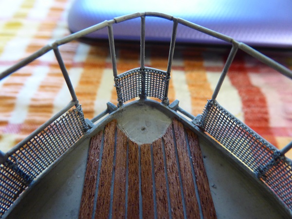

Well its been a couple of weeks since my last post. During that time whilst laying the mahogany decking on the lower deck, I noticed that some of the strips weren't as neat as they should of been, so I removed these and made some more. Plus I spent a few evenings not doing any modelling and just chilled, watching random stuff on YouTube.
Suffice to say that the mahogany decking is now complete on the lower deck with just the tiniest amount of trimming to do; should take a couple of hours next week to complete.
#1100 Posted : 08 August 2019 23:00:46
A bit more trimming of the strips around the water-tight ammunition canisters so they sit flush to the deck; although you can't tell from the attached photo.
